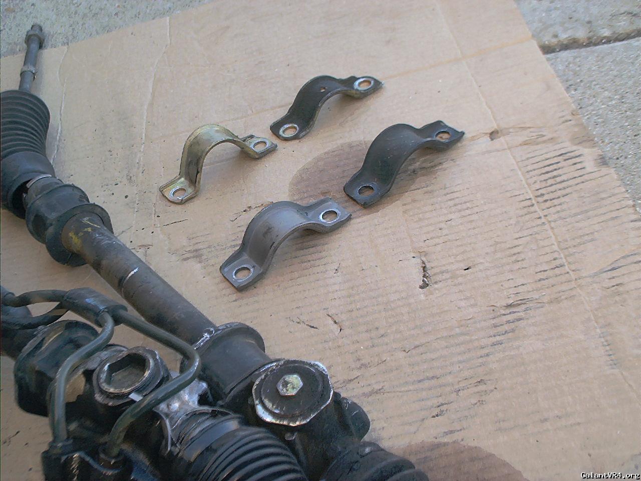

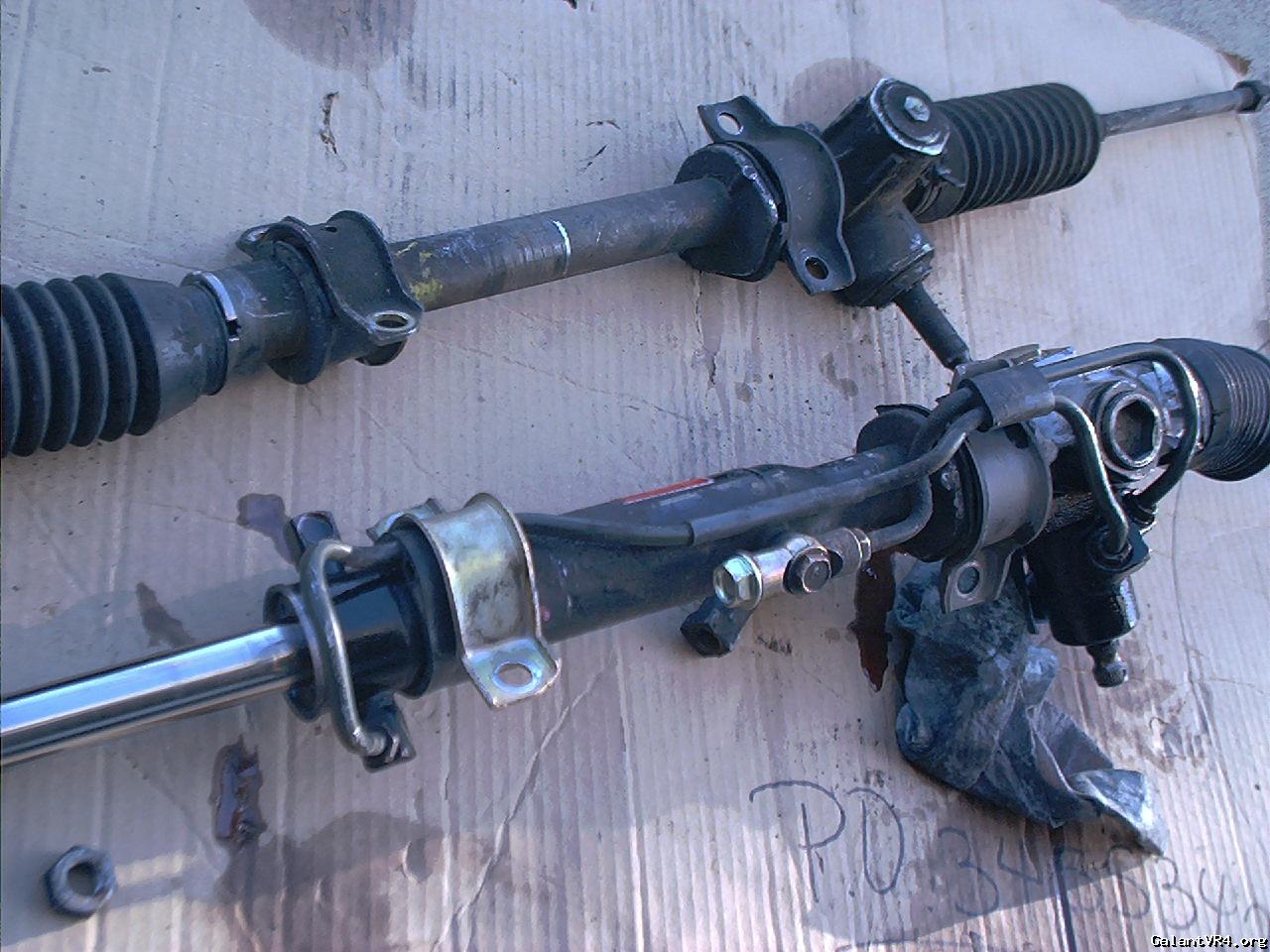

here are some old pix of a manual rack 1.8L vs. 4ws rack.
Driving on the freeway it's ok. Parking and low speed I can deal with as long as the car is moving you can turn the steering wheel. It's worthless for autocrossing. On clover leaf freeway turns as your speed increases through the turn steering effort incresaes. Parllel parking don't even try. On my vr-4 I have adjustable caster camber plates. The alignment shop adjusted the caster to zero degrees to help make the steering effort easy.
The manual rack brackets are the greasy ones.

is it possible to use the GVR4 brackets on the manual racks? or just make them? They dont seem to much different, maybe just wider?
Not wider, just taller. You could possibly get away with using the originals if you retained the stock rubber mounts and kept a couple inches of hardline in there. Only reason I could see doing it is if your buying new/refurbished rack. If your getting a used one, grab the mounts while your at it.
