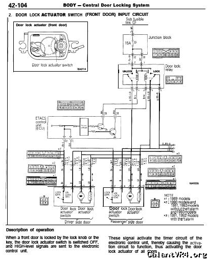

It's been discussed before but I don't remember how long ago. I think it's a relay. I think I remember Jeff having some insight. Try searching with keydiver as one of the guys who posted with some info.
No, it is the door lock activator switch box in the door. Autobahntom sent me one out of a wreck, and it fixed it right up. It is attached to the door lock by a short linkage. When the contacts get old and corroded they go open circuit, so the ETACS thinks you are locking the doors.
It *may* be possible to fix it by opening the switch and cleaning the contacts, but I've never tried it. I need to do that to the passenger's door of my wife's 3000GT, its doing the same thing lately. /ubbthreads/images/graemlins/frown.gif

These are door lock activators, not window actuators. I would imagine they use the same actuator in DSM's also, and any Galant with electric door locks, but you would have to check CAPS to be sure.
