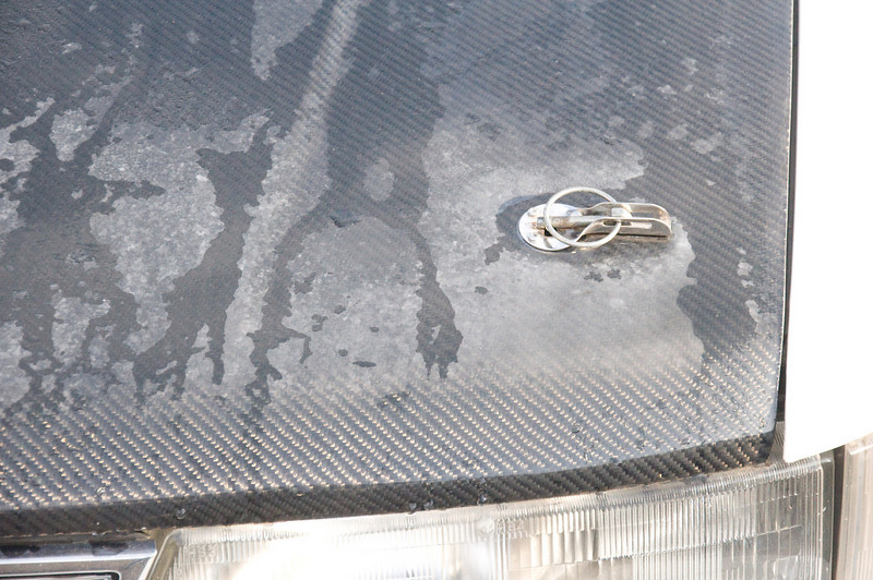

I picked up a GVR4 today (for part-out, #255/2000) and it has a CF hood that needs some TLC. The hood seems to be real "cloudy" looking but still feels smooth. Anyone know if it's ok to use polishing compound or rubbing compound on a CF hood. I assume it's got some sort of gel coating, but Im not sure what/how to go about cleaning it up.
Any advise appreciated.

do you have any pics of the "cloudy" areas on the hood? i can tell you if you can polish it out or re clear coat it.

Just use some hand polish on a small area of the cloudy part. If it gets better there, you can go further. If it doesn't the gel coat is probably FUBAR and you'd just have to paint it.

...and nate I would start with some Megquires cleaning wax and stay away from a polishing compound. I'm sure it won't take much to bring back the shine. I don't know if you are a boater or not but you would be suprised how chalky gel coat can get and easily it can be brought back to a full shine.

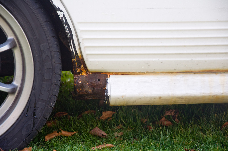

Put it this way, GreenGSX (previous owner) seemed very relieved that the car was going to be parted & crushed. Being an upstate NY car, this one is honestly the rustiest mitsubishi I have seen..bar none. I'll post pics after I get it on the lift to take it apart, but I suspect I will be able to break the shock tower away from the firewall on the passenger side due to terminal rot. Another sign of terminal rot: the sideskirts are stained brown from rusty water. If you were to see the car up close and spent some time hunting around, you would likely come to the same conclusion as me and Tim.

As for the hood, I'll try the least abrassive cleaner wax first in a small spot. If that doesn't work, Ill step up to polishing, then rubbing compound. I bet it's going to shine up real nice with a little work. Worst comes to worst, it gets a coat of flat black. Another option would be to cover it in carbon-look vinyl. /ubbthreads/images/graemlins/rofl.gif

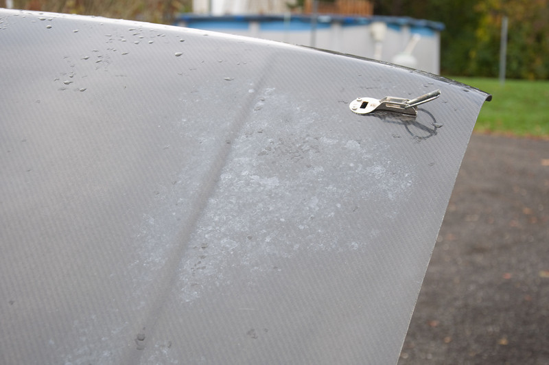

Heres some pics I took this morning:
Hood cloudyness in question:

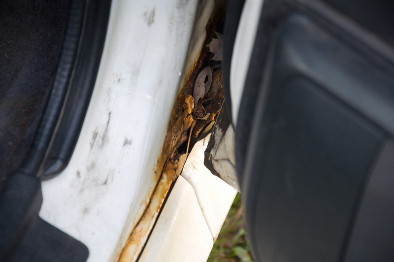

some rot: Ill take another pic after I start disassembling the car, but this dogleg was off the car when I picked it up.
behind pass door jam

cloudy areas often happen when the uv protectant breaks away from the cheap ester based gelcoats/clear coat. You have to determine if its coming from the clear coat or gelcaoat. If its the gelcoat then you have to wetsand with 600grit to 1000grit sandpaper until you hit the gelcoat(pass the clearcoat) and re clear the part or you can continue up to 2000grit and polish.Just be care not to go past the gelcoat and hit the fibers.
