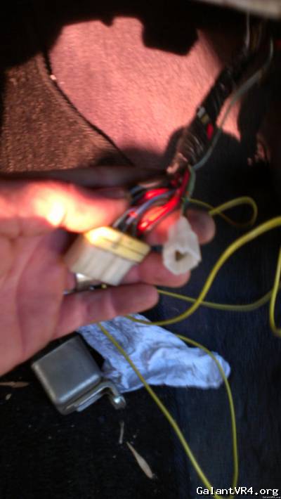

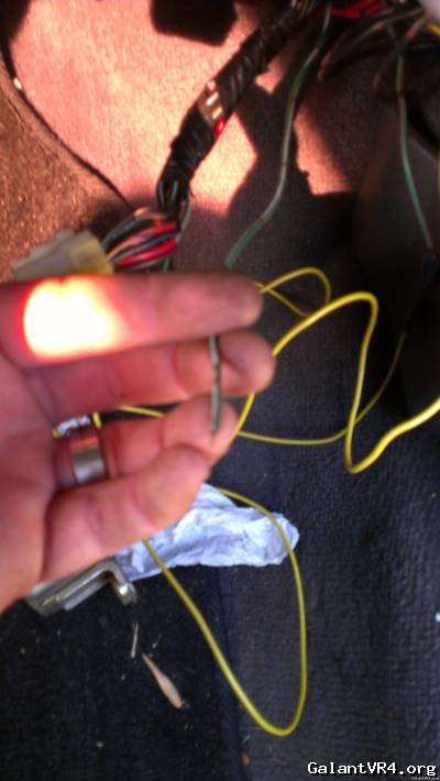

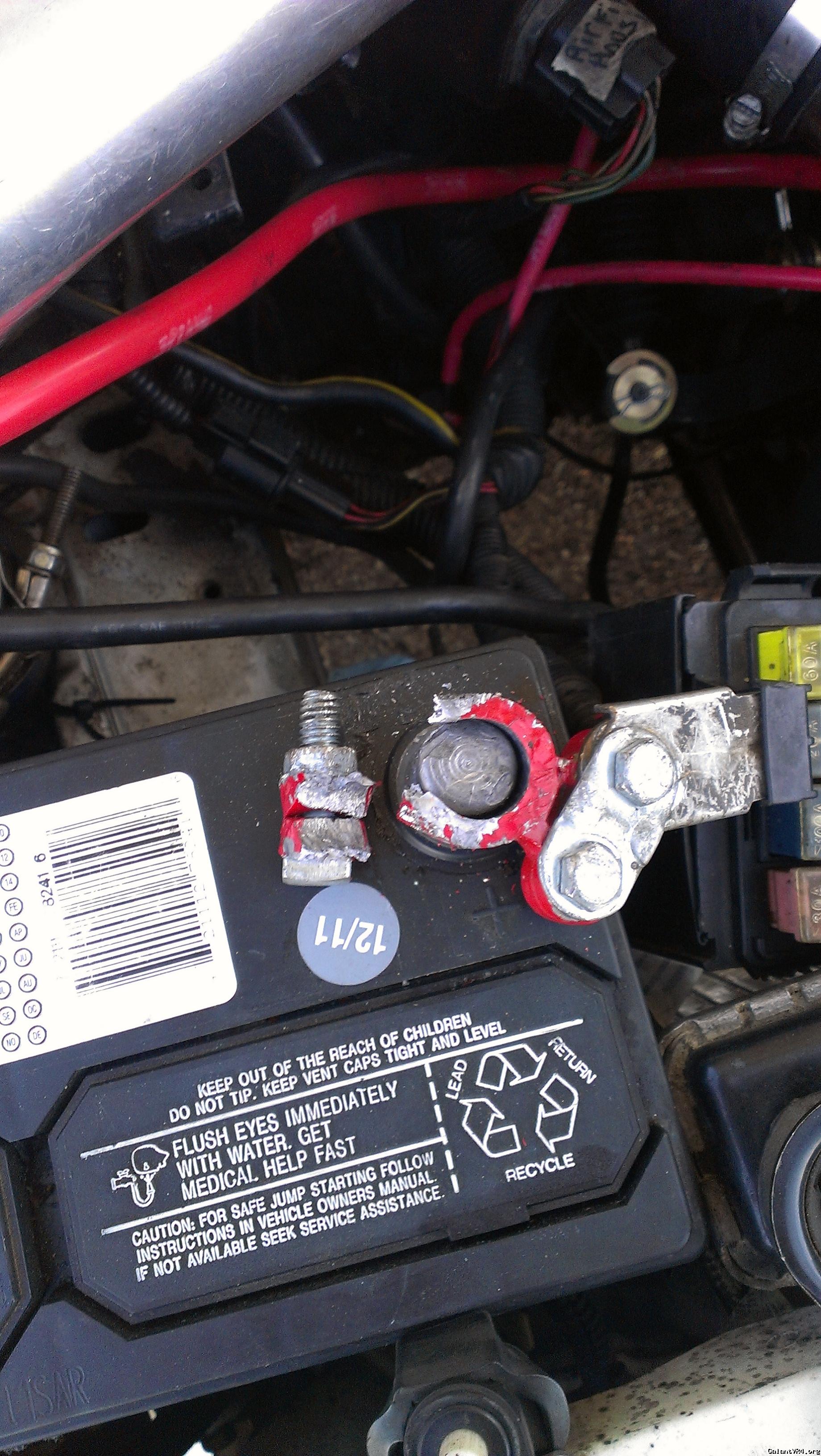

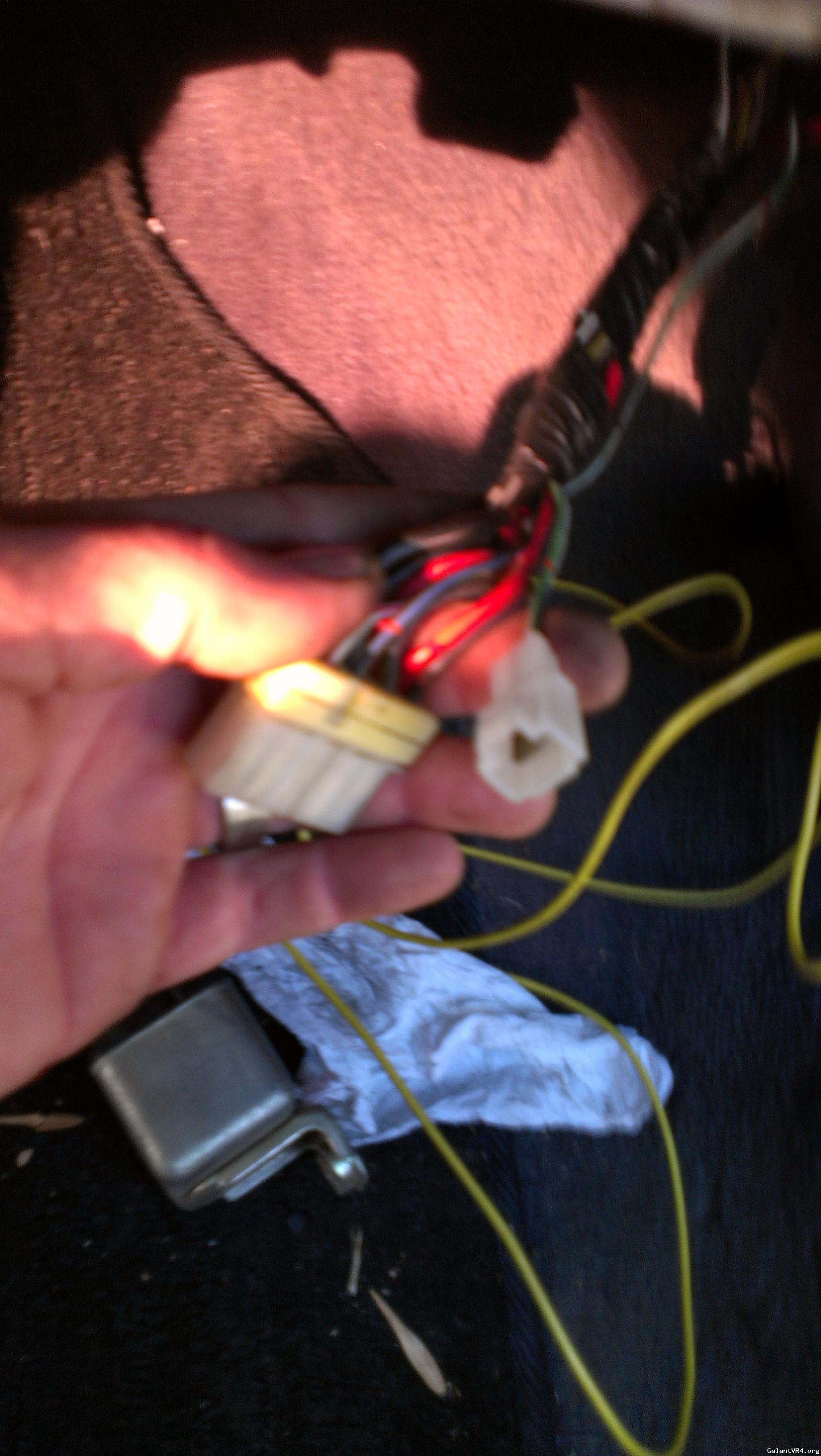

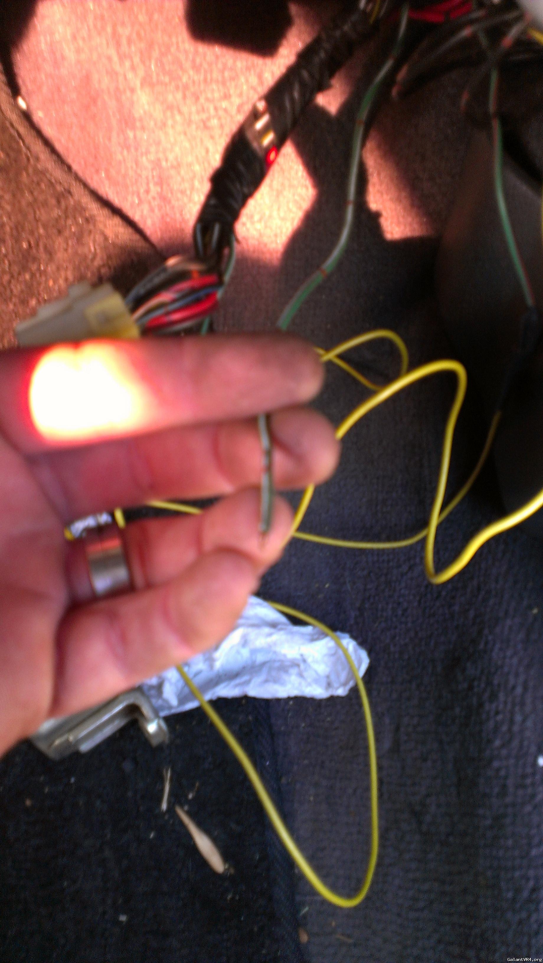

Alrighty. Finally got the car home.. Started checking stuff out in the trunk area. No broken wires or anything that i could find. Everything actually looks good back there. I did not remove the pump/sender assembly to check inside yet. Pulled the mpi relay off and it looks good, no corroded pins or anything on the connector or relay. And all the wiring is intact. Except for the wire in the pic bleow. Im assuming this was a wire for a/c maybe? if you could check it out and let me know what you think it is. With the relay pulled I went to put on the jumper cables after attempting to start the car. Barely had enough juice to turn over, Started hooking up the Positive batt cable and realized it was very loose. Grabbed a wrench to tighten and what happened is what you see below in the pic. Snapped clean off with very minimal turning effort.
So I'm gonna go ahead and start there. headed to advanced now to grab a terminal. Going to install it and put everything back together and start from there. Really hoping its that easy!!

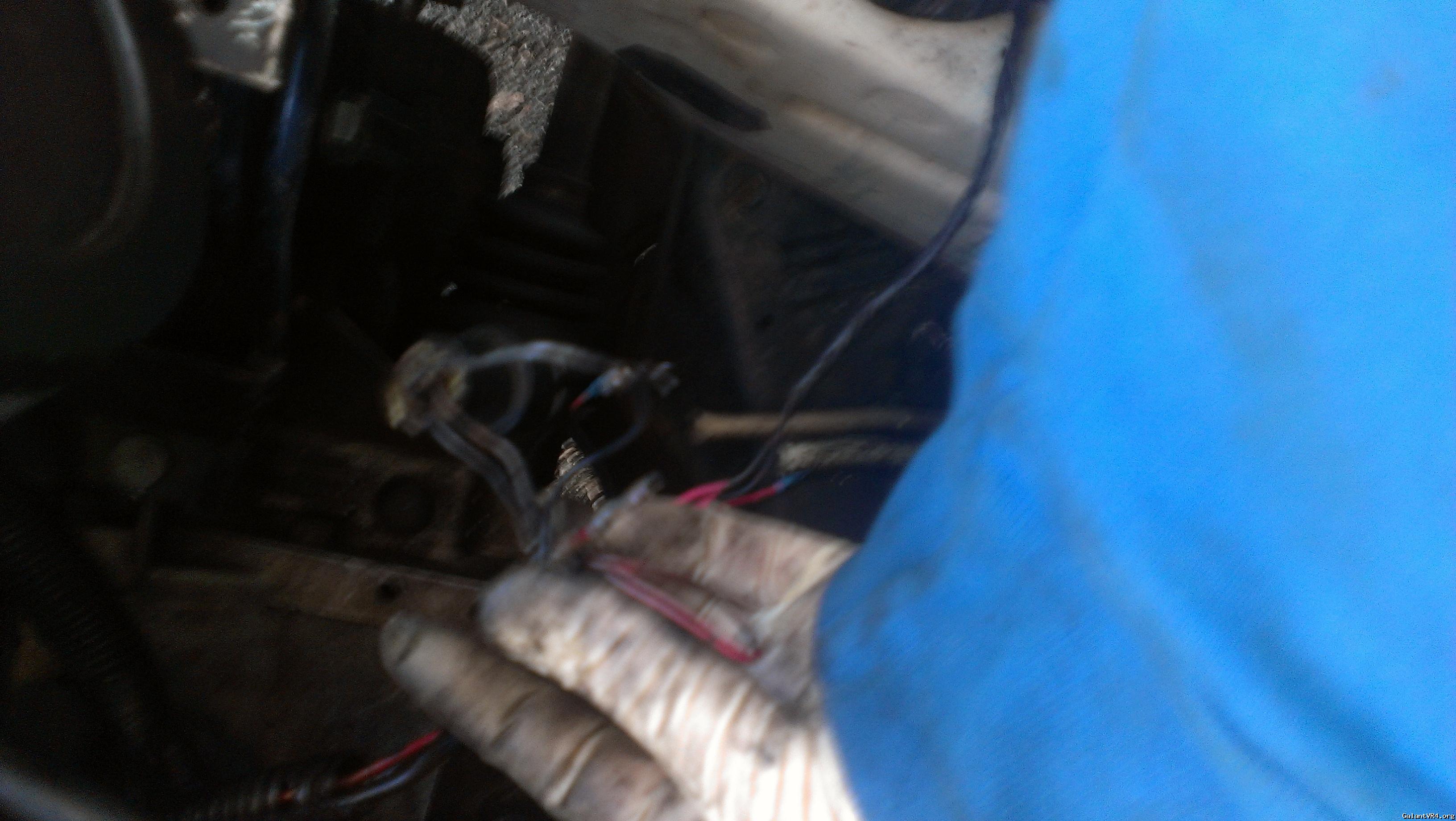

May have found the problem. Check my o2 sensor wiring and found this. Gonna rewire and retest.

got her all wired back up. couldnt find a new o2 connector, so I just picked up a four way trailer connector. Hoping it works out. warming up a little, then go reinstall fuel pump and retest.
