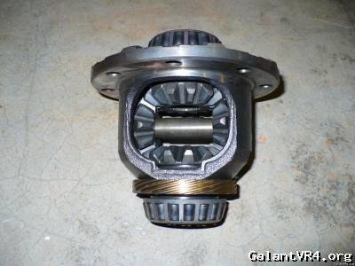

Hi all!
I have a busted drivers side rear axle on my stock 3 bolt.
Is it possible to knock out the remaining stub with a long rod from the passenger side axle hole?
Can someone post a picture viewing straight thru the diff from axle hole to axle hole?
Vertically in this picture:

no you can't because the pinion is in the way. You'll have to remove the diff cover plate and pry it out from the inside, or remove the whole center entirely.

Misinformation in this thread. Pinion is NOT in the way, or the thing could never spin.
The hole is straight through on an LSD rear but it's blocked by the pin on an open rear. If your rear is stock, it's an open rear.

Okay, so taking a pic of mine is pointless then since it's an LSD and his isn't.

Here's what the inside of an LSD rear end looks like, NO PIN, but this is NOT what came in your galant (unless you Swedes got gvr4's without ABS)

Well I just posted pictures of mine, he's got to tell us if he's got an LSD or not.

The pin is going to be in the way then. You might be able to get something bendy around it to knock it out though, as previously discussed. Good luck.
