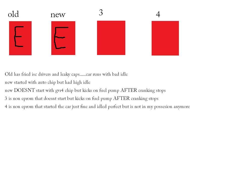

Ok ecu gurus I have a predicament. I'm wondering why this wire is wired in between a cap and the "Coil "B2" for idle speed control motor" connector pin. Obviously my isc drivers are fried and that cap leaked but my car still runs(but with very bad idle). Is there something majorly wrong with my car somewhere because I've bought a replacement ecu with brand new chip coded for my vr4 and the car will not start with it. Also doesn't start with another noneprom ecu I have. Btw terry if you read this I'm trying to get my buddy with the known working ecu that worked in my car before to let me borrow it while I send these off to you.
I made a little diagram for you incase this is easier to read and understand.

Ok. I just need someone that can test some ecu's and see what's wrong with them and then someone that's comfortable trying to repair the one that's burnt up.

Without pictures of the others it's hard to guess what maye be wrong with them. Have you made sure the EPROM chip was installed the right way? Tried swapping the EPROMS between ECUS?
