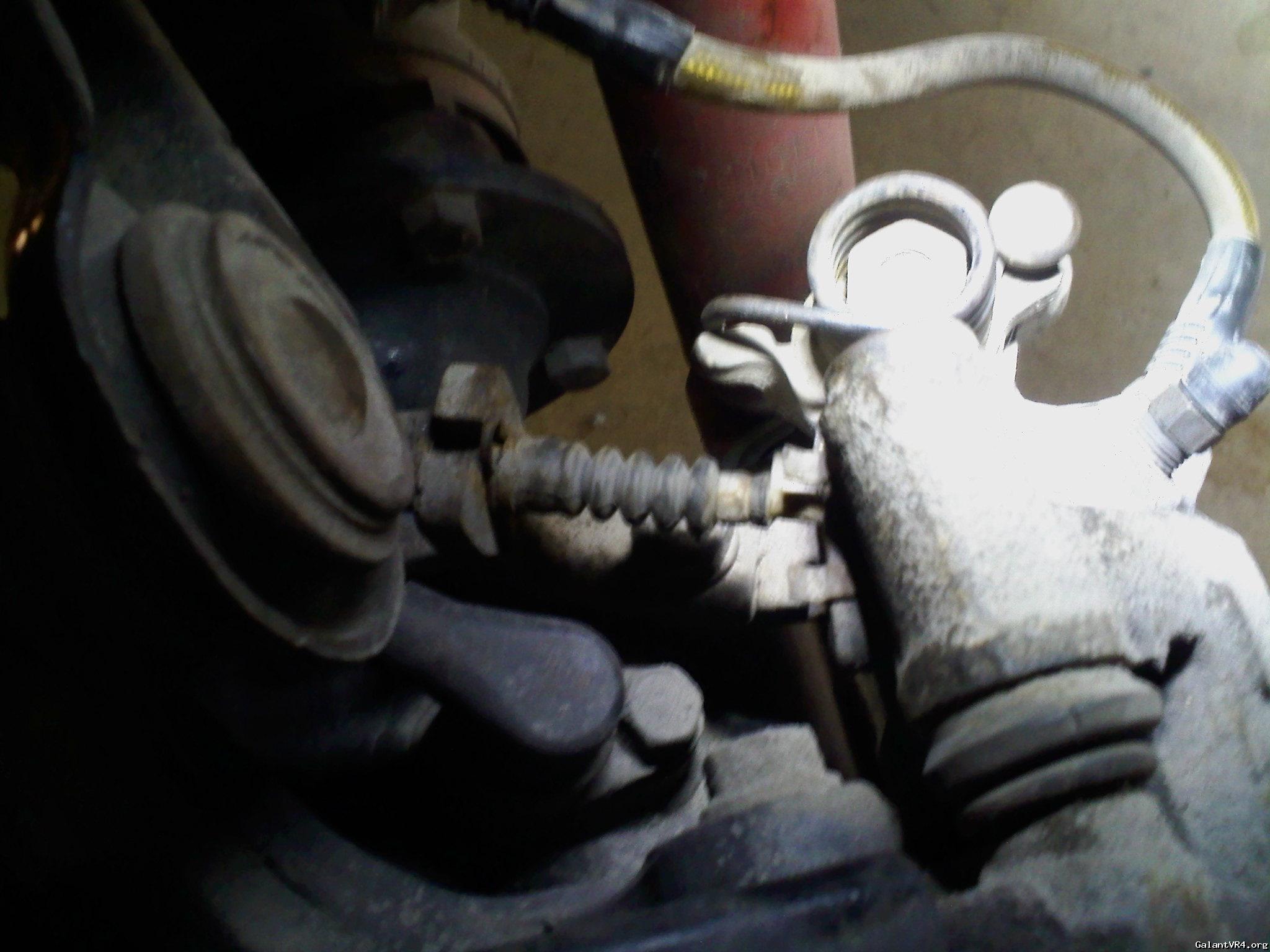

Slap everything together and noticed that my parking brake no long works on the caliper I just replaced. I re-adjusted the parking brake and still has the same problem. Also the parking brake cables are only a year or 2 old.
Here are some pictures to help show the problem.
This is the side with the caliper that I replaced. This is a picture of the parking brake off.

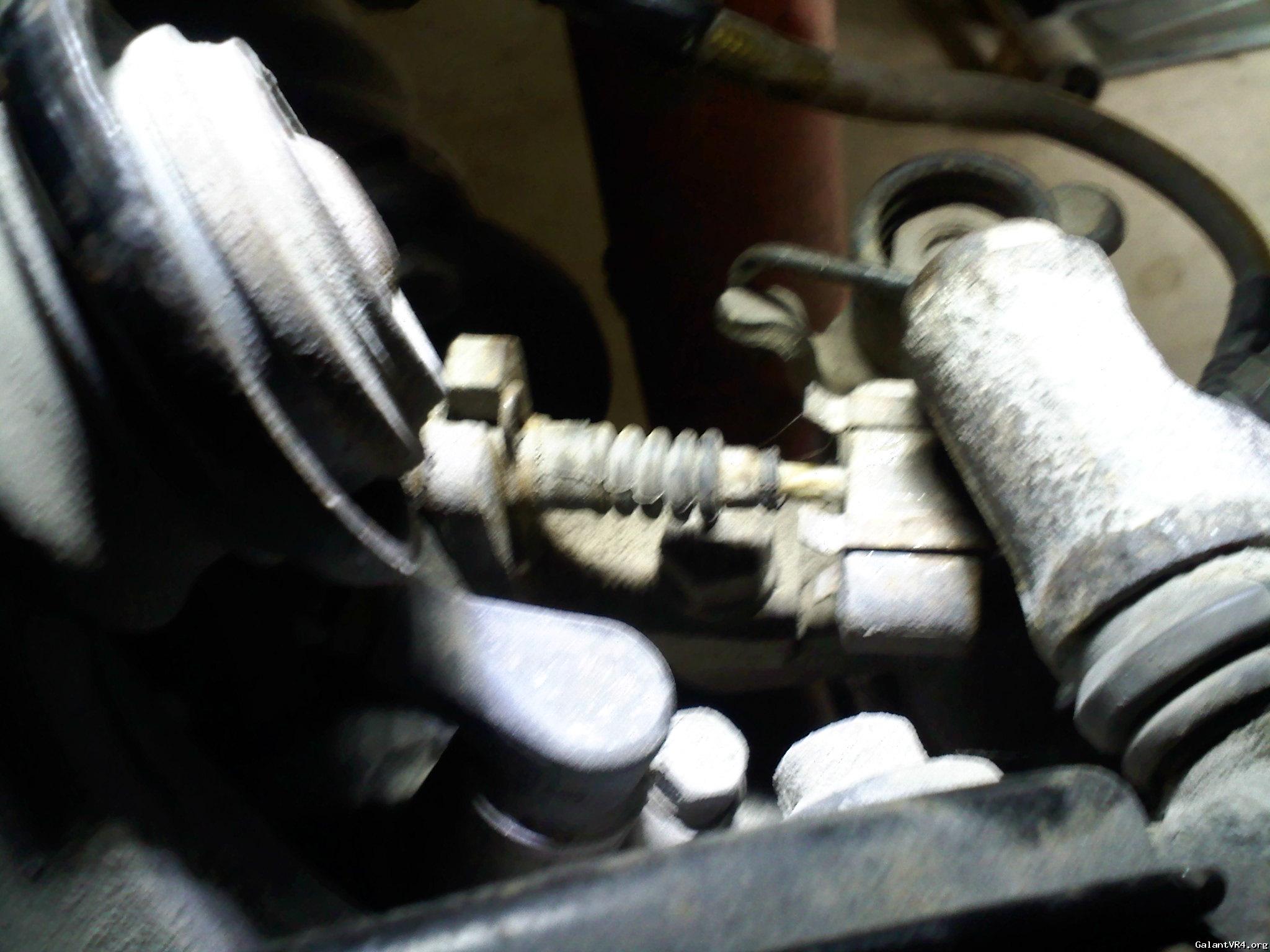

This is a picture of the other side with the parking brake off to compare.

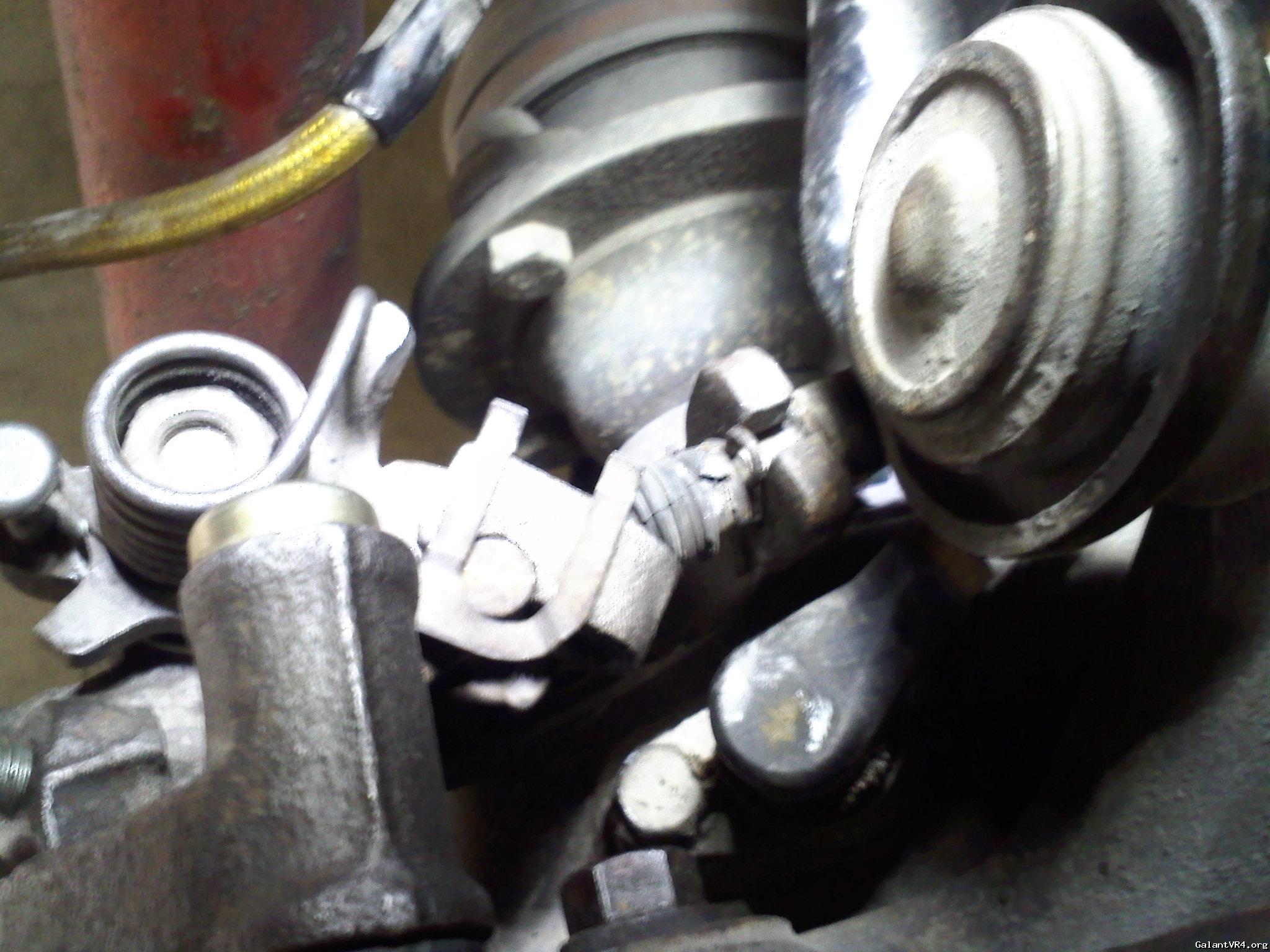

This a picture of the replaced caliper side with the parking brake on. Even like this I can freely turn the wheel hub.

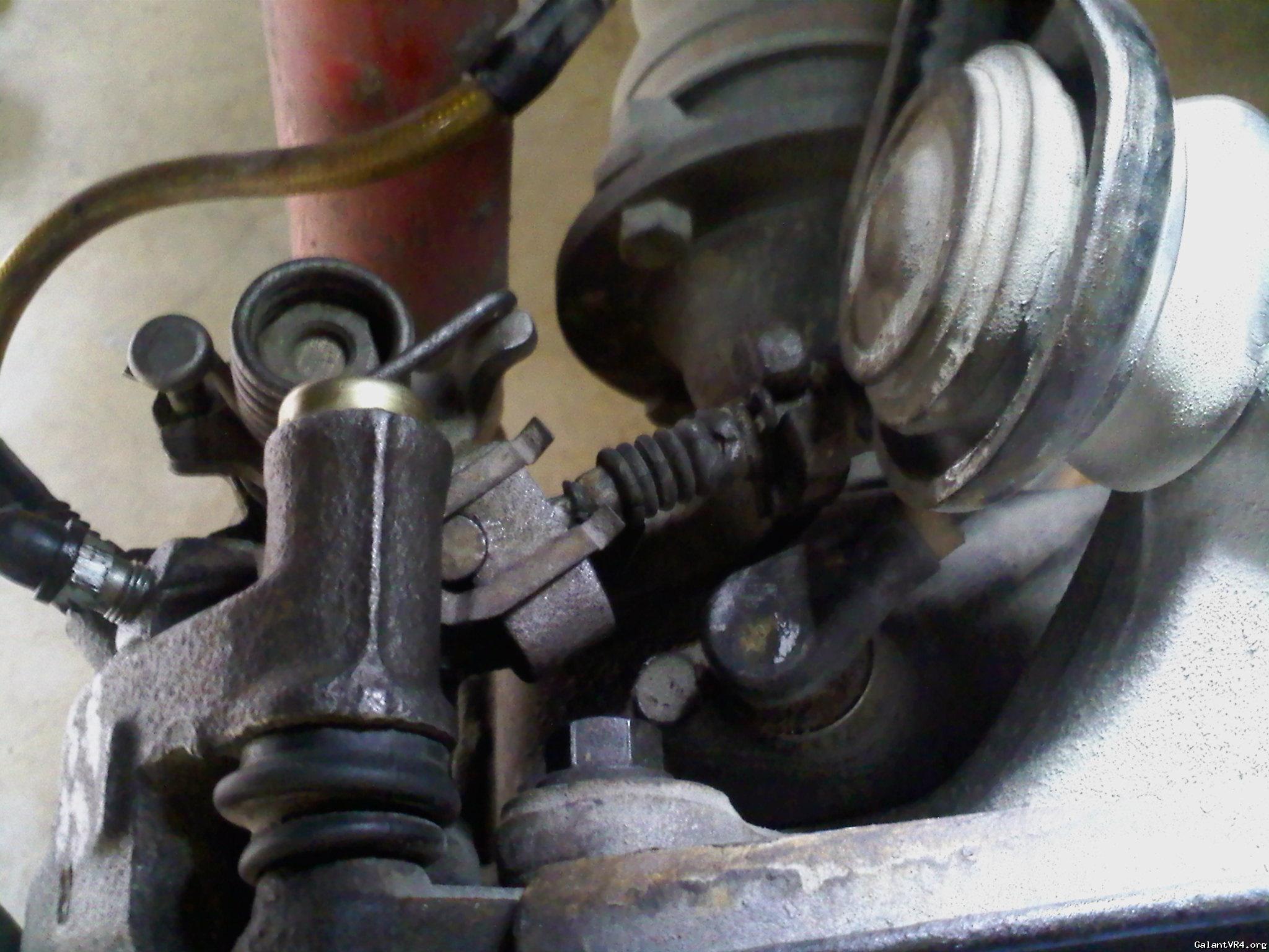

This is the other side that did not have the caliper replaced, with the parking brake on.
Is this a caliper problem.? I did re bleed the whole brake system after this because the brake pedal didn't feel right. But it feels better after I bleed the system. Also the replaced caliper seem to work fine when I push on the brakes.

The e-break is kind of fragile. Remove the cable and see if the shaft the nut screws down on (inside the return spring) is loose or kind of rotates out of round.
Bottom line is it is bad, tell Autozone to order you another one.
