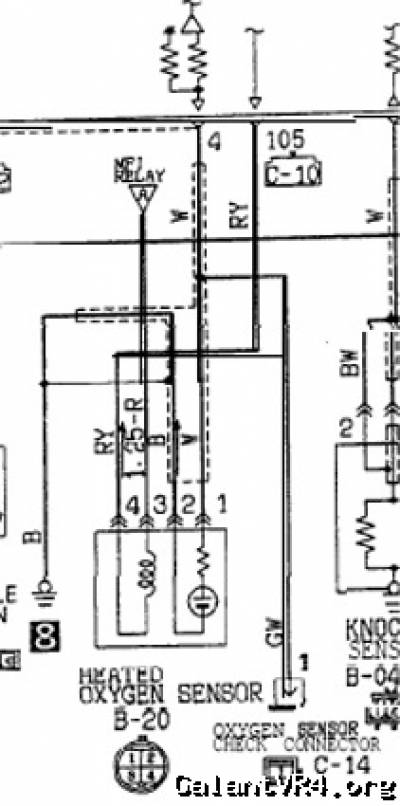

This might help, since it shows the two wires for the heater. The ground is pin 105 and the power comes from the MFI relay. It isn't the easiest schematic to read, but it might help.

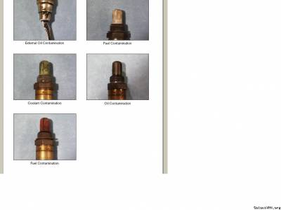

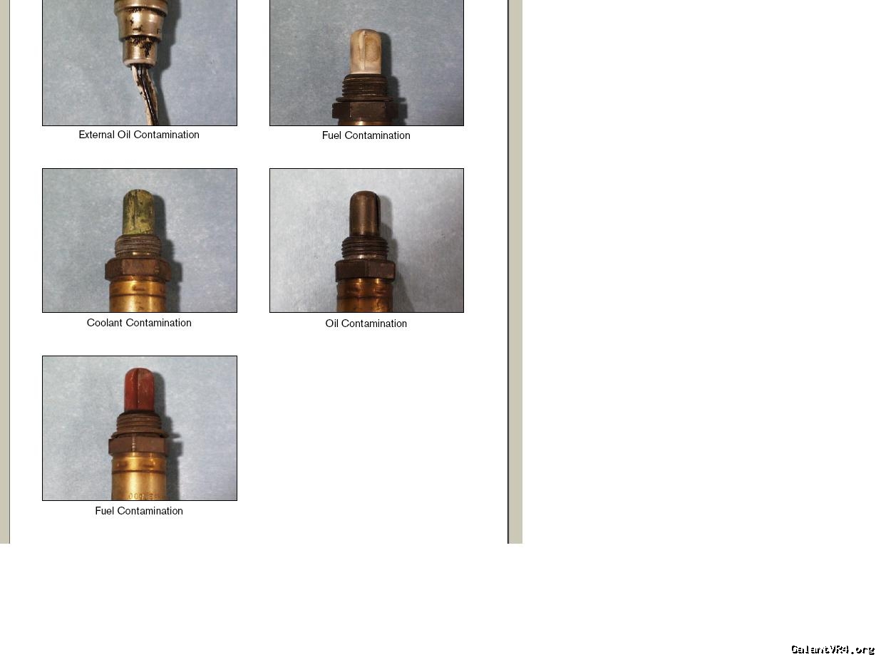

Straight from Bosch:
Mind you that if the ECU is not getting an accurate signal, the O2 sensor will most likely look like the white one in the pic above. That does not mean that the sensor is fouled, per say, especially if it has not been in the car very long. The others I would be concerned about.
I still suggest trying new wiring. I believe the non-cycling would not necessarily indicate a problem with the ECU, but you'd most likely need a known good sensor/wiring to tell for sure anyways.
