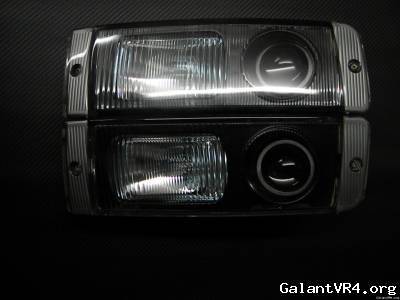

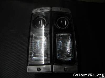

Well I decided to take a few snaps of my HID retrofit I did on my car...SORRY: NO BEAM PICS YET! i haven't powered the car yet as I'm still working on it but i figured i'd show you the pics...it was done about a month ago
Camera Phone FTL!
Lemme know what you think and if you have any questions feel free to ask...Thanks
JSchleim18
Oct 16, 2006
4,801
Long Island, NY
Thanks for the kind words
probably 12 hours into the work on the headlights themselves...it was fun but also a pain...I am scared about the aiming part...my driver side looks a little cock-eyed compared to the one in this pic but if i can get the aiming down i'll be very happy!

Looks good. How'd you do the shroud?
I found that making the shroud and sealing up the rear to be the hardest part.

TSX headlight housing and just trim up the high beam...yeah that wasn't too hard after i figured out what to use for it
as far as sealing the rear or in my case the projector to the headlight i used JB qwik to mount it and hold it, then JB weld to finish it off with a stronger sealant

I tried a TSX high beam... I ended up cracking it, so I gave up on that idea.
You did a great job of it.

i'm gonna try to snap a pic of it tomorrow...it looks aight but it's basically the back of the tsx projector (like a half circle) and JB welded

yes the proper way to add HID to our cars, good job looks really nice, keep us updated on your inpressions on how it performs when you drive the car /ubbthreads/images//graemlins/blush.gif. I thought about retrofit the E36/E46 BMW lights also as the profile looks like it works plus i have people that can get them next to nothing including the audi tt lights too...

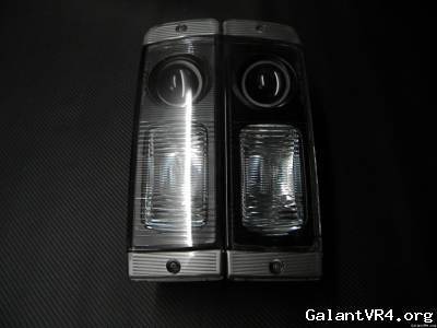

I should have my car running around x-mas...here's another pic but this time of the driver side...it's a little cock-eyed compared to the pass side

/ubbthreads/images//graemlins/applause.gif that looks GREAT imo. Looking forward to details.

BTW looking great JS ... /ubbthreads/images/graemlins/cool.gif Other side doesn't look wonky to me /ubbthreads/images/graemlins/dunno.gif

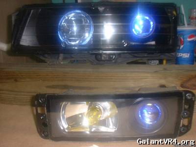

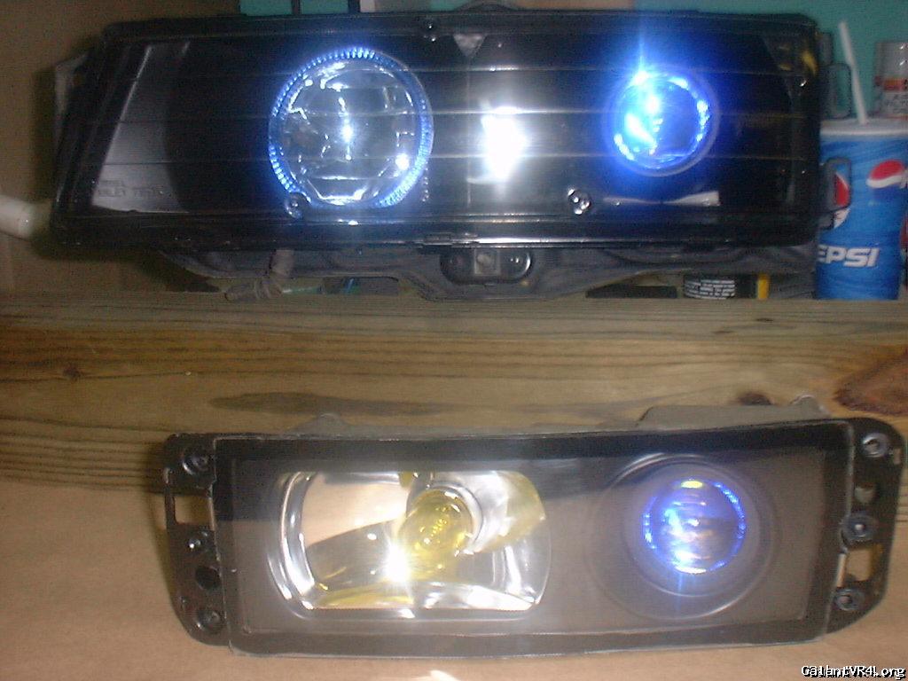

The head lights look BAD ASS!, I would rock them all day, and these Fogs look good too ^
