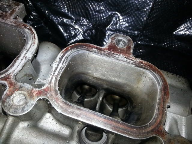

after a looking over back at my place, it had no compression on 2 cylinders /ubbthreads/images/graemlins/banghead.gif was 150 or 160 across when i got the car. so my long time DSM/EVO buddy and i are talking, come up with couple ideals. we agree its probably burnt valves. so quick pull head, reman/valves, headstuds/mls, etc... "or...ill sell you my 2.4L block..."
yup, motor is fucked. not rebuildable. go big, or go home /ubbthreads/images/graemlins/grin.gif (maybe should note i wanted to do this before i even bought the VR4)

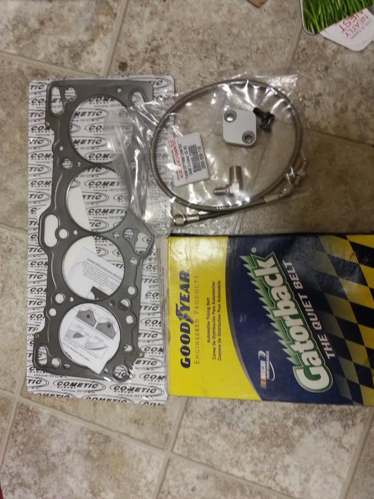

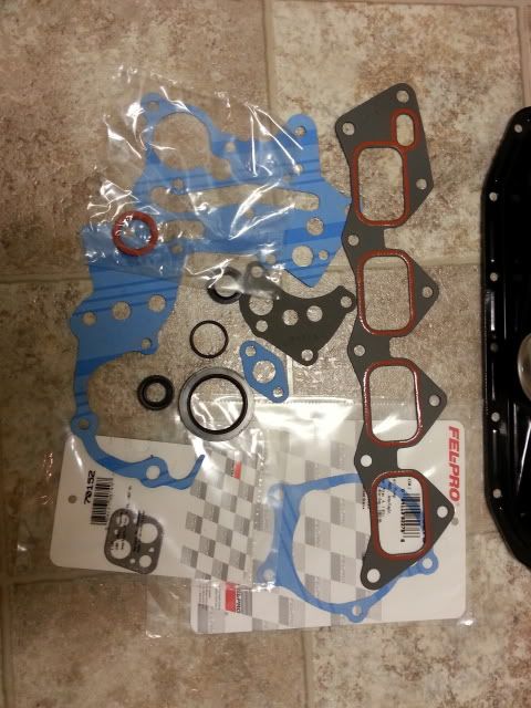

Cometic .051 MLS HG, oil feed line. EGR blockoff, new belt.

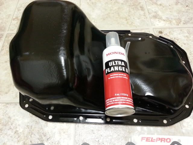

brand new oil pan (mine was dented with a scary looking oil drain)... oh yeah, i work at Honda. we use this stuff for our oil pans/timing covers. works great.

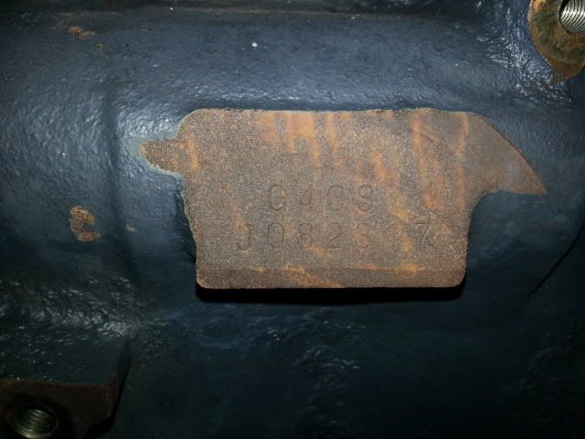

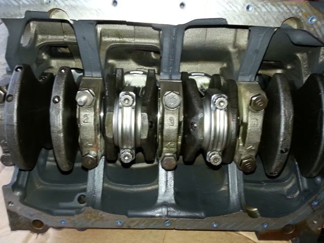

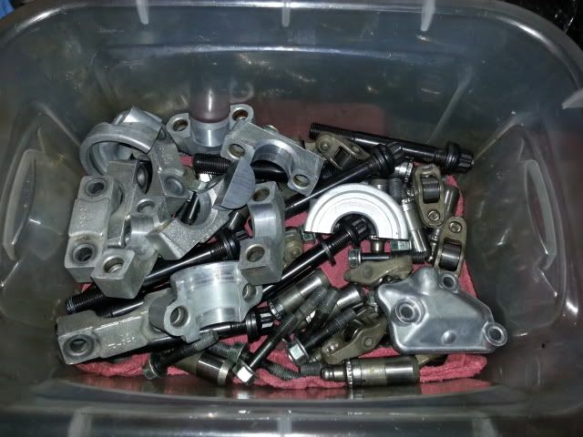

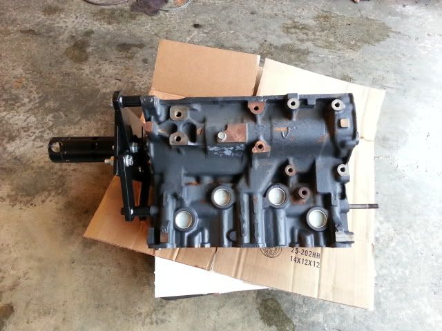

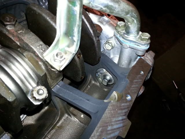

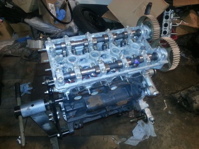

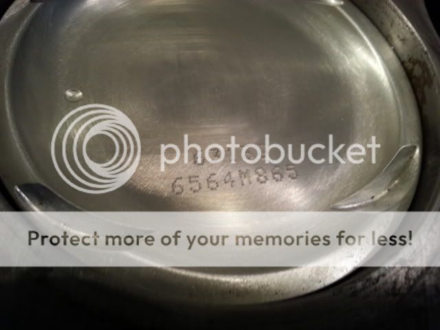

G4CS block, Mitsu 100mm crank, Wiesco 8.8's, Eagle rods, balance shaft delete... pretty standard. new Clevite bearings to spec, rings gapped, everything looking perfect.
normally i build my own motors. but like i said, my buddy was planning on putting this in his car and changed his mind when he saw he could just sell it to me (then threw a stock 2.0 in his car). plus he actually spec'd out everything perfectly.
well, just the block/rotating assy was done. still some work to be done.

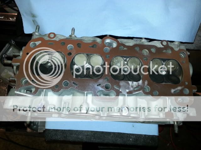

didnt even bother pulling the head, just bought a new one, found a deal.

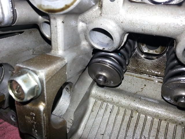

mild porting
Si Valves dual springs

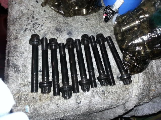

ARP's
FP2 cams
yes, i know, water pump pulley. i do hate that pulley btw.

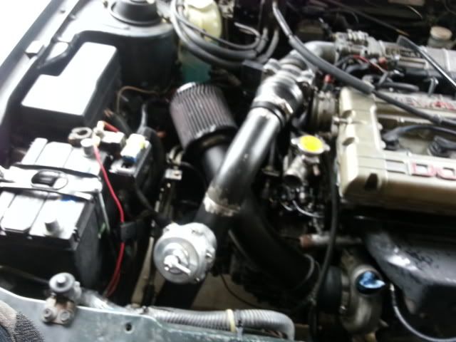

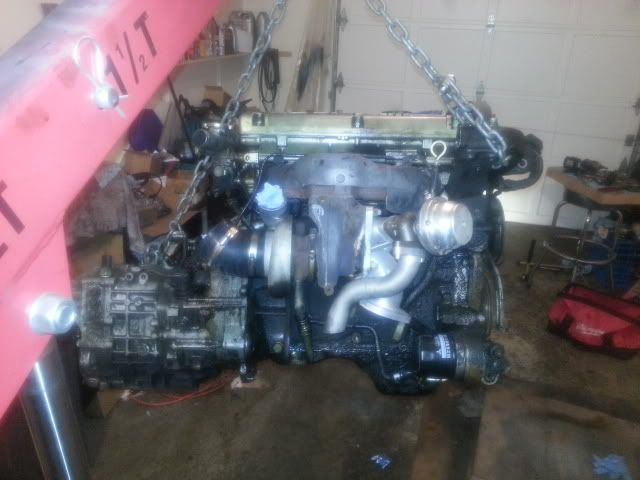

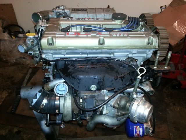

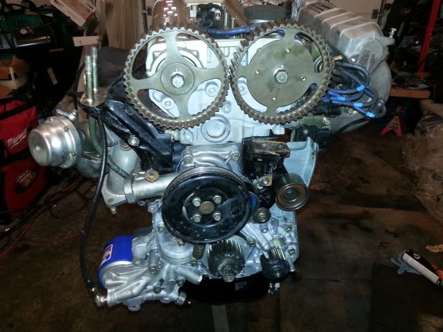

bigblock ready to go in. EVO3 manifold w/oem shield, FP-Red turbo, some ceramic coated O2 housing/wg dump that i can never remember who make/made or write down, TiAL 38mm WG.
oh yeah. that NASTY ass 2.0l coming out. damn. pretty sure it was leaking from everywhere?

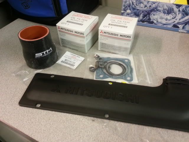

swapped the crushed stock bov for my extra TiAL 50mm. bought it for another project that didnt happen...mostly because to spent all that money on the Galant instead of my Civic LOL. i put the stock bov on my CRX... (ill stop there before i loose ya)
oh look, more parts
for some reason i thought or maybe didnt? that the TB didnt need resealed. found other sh*t on STM i felt i needed too it looks like... and yes those are Mitsu filters sitting on my desk at Honda :p still got one there too.

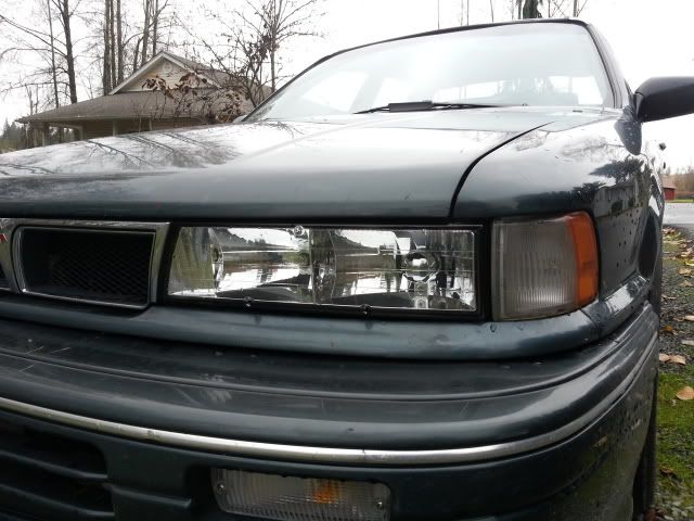

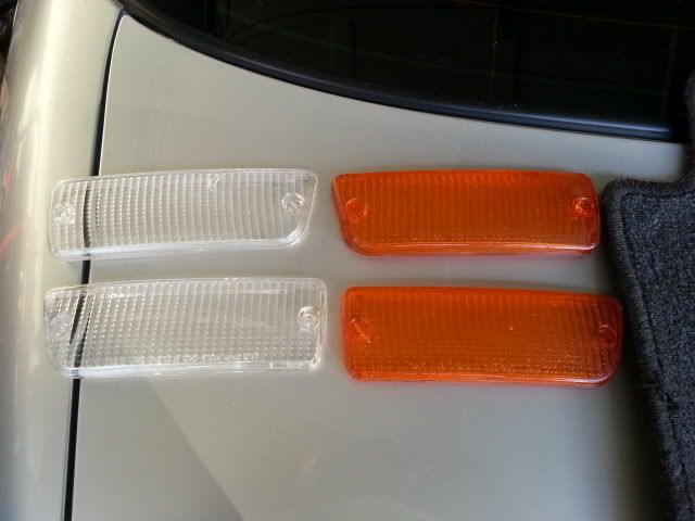

one of my lenses was cracked. got a set of ambers. then got a set of clears a week or 2 later.

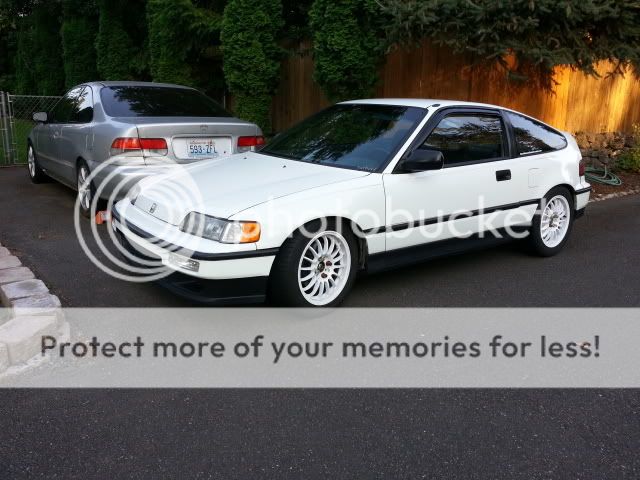

Love that CRX!! Never see clean ones anymore
thanks. that was the plan. spent lots of time on her. tracking down clean parts for build. buying new OEM parts. finding parts to build her the way i wanted in general. lots of effort. probably lots of money. cool car, and build.

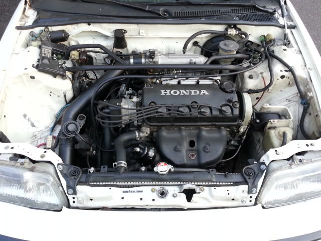

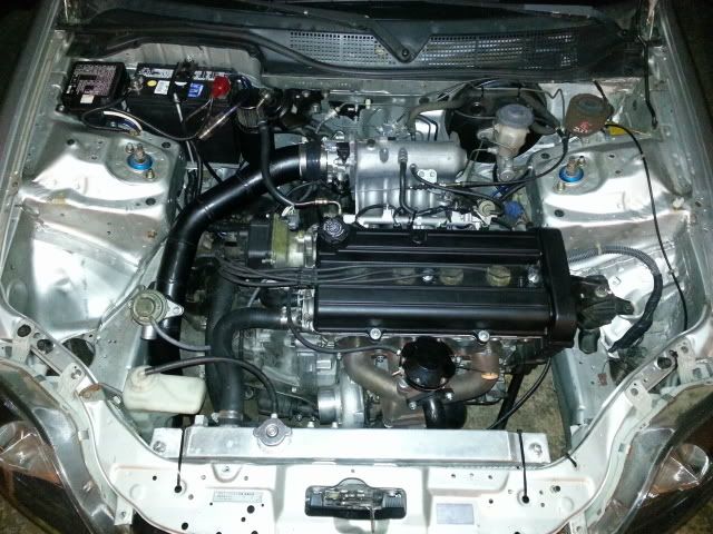

quick highlights:
1988 HF model (lightest)
forged 1.6 SOHC VTEC
MHI 14b @ 20psi...tapering to 17.
EVO8 injectors
bov off the Galant.
oh, and all that running on AEM EMS box lol.
Integra Type R seats
Spoon steering wheel
full coilovers
real Spring Hart CPF-G wheels.
made 247whp/205fttq
chassis is super clean, 100% rust free. oh and has ~315k+ miles on her. i have owned this CRX twice. bought it from the original owner back in 01. was my first real project car. first turbo project. first motor i swapped. sold it to a friend..maybe ill own it again LOL.

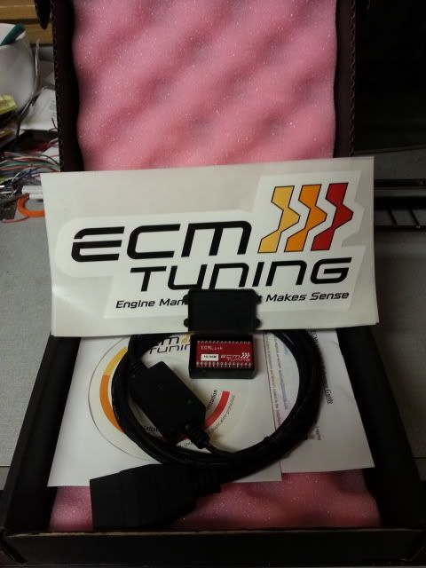

sent my v2.5 in to upgrade to v3. hope its worth it.
tough install. think ill be useless the rest of the weekend...

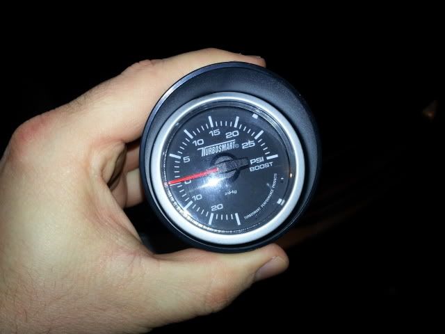

bought another boost gauge
Turbosmart 30/30...

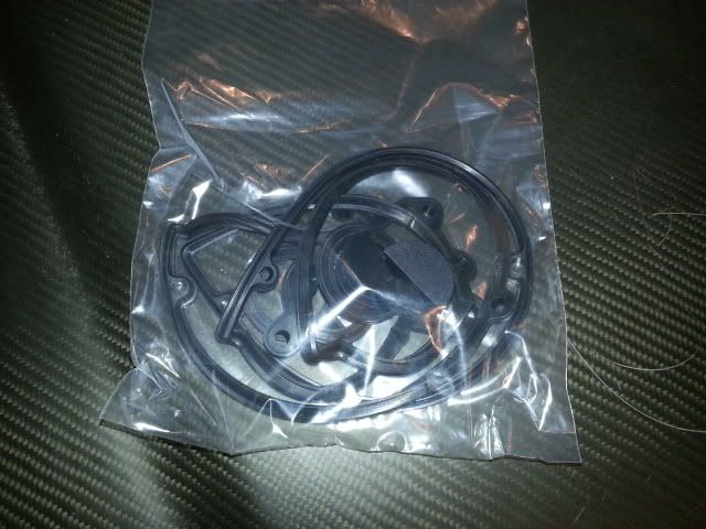

another valvecover gasket. put new one on when i did the swap, think its got a little leak. planning on pulling the valvecover to possibly shave it, but repaint it forsure. will post pics of how it turns out. just need to get off my lazy ass to do it. (its cold out)

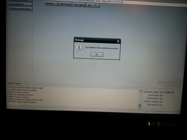

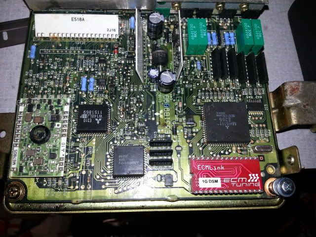

sweet, doesnt work. wont connect. connected fine with v2.5 (same laptop, same car). reinstalled ecmlink and drivers from disc in tbe box. hate.
/ubbthreads/images/graemlins/banghead.gif /ubbthreads/images/graemlins/bawling.gif /ubbthreads/images/graemlins/dunno.gif
strokin4dr
Aug 30, 2005
2,770
Savannah, GA
Make sure the ecu has the current firmware. Usually the problem. Search the dsmlink forums for how to set it up.

wasnt given access to said forum.
i dont see firmware update on ECMLink's site... why would they ship me something 2 days ago with outdated firmware?
i have uninstalled and installed drivers a dozen times. reinstalled ECMLink software from disc, and website.
why isnt my car running on AEM? oh yeah, cuz DSM Link is easier... right. /ubbthreads/images/graemlins/banghead.gif
wtb: AEM box w/SD cable/sh*t?
sorry. its cold as balls outside and him hanging out in my car that wont run and spend too much money on. very frustrated.
oh, one thing i did notice is when the drivers for the cable install. it will popup with new hardware ECMLink cable. then pop up to the install thing. no matter what i do, it looks to be installing from C: not from the disc...?? then once is going threw that it will then call the cable "USB serial cable"

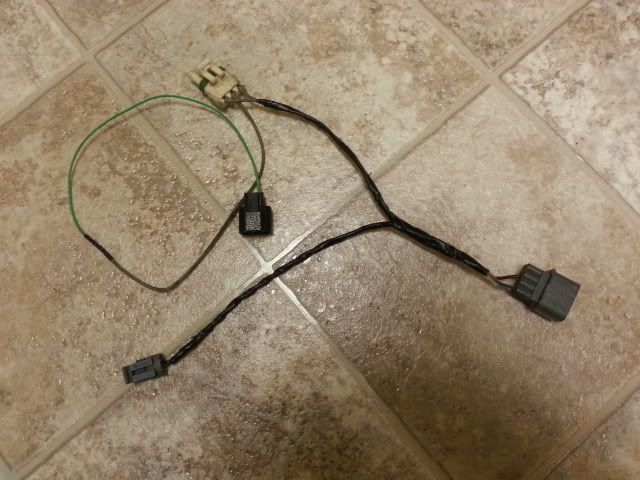

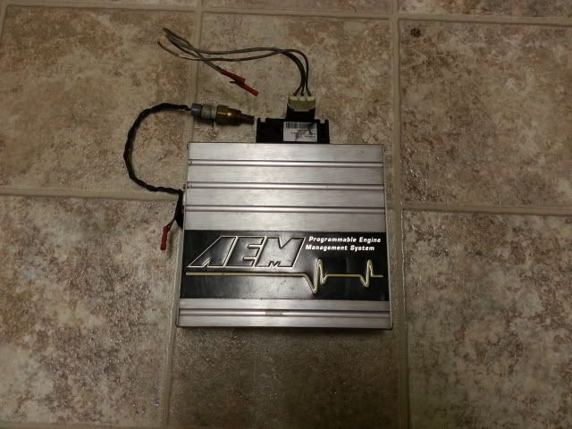

made myself a little harness. hope it works. used RRE's AEM page, and little vfaq.
didnt get a chance to test it, as it is COLD outside. she was frosted over when i got home, so didnt bother to go outside hour or so later. seemed pretty straight forward.

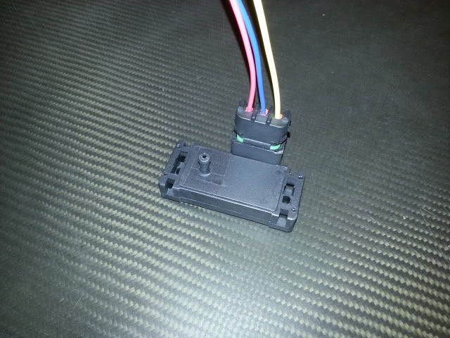

still havent decided what map sensor im going to use. i have both 3 and 4 bar GM MAP's.
hopefully i get out there tomorrow after work to give this a shot. but suppose to be colder out...

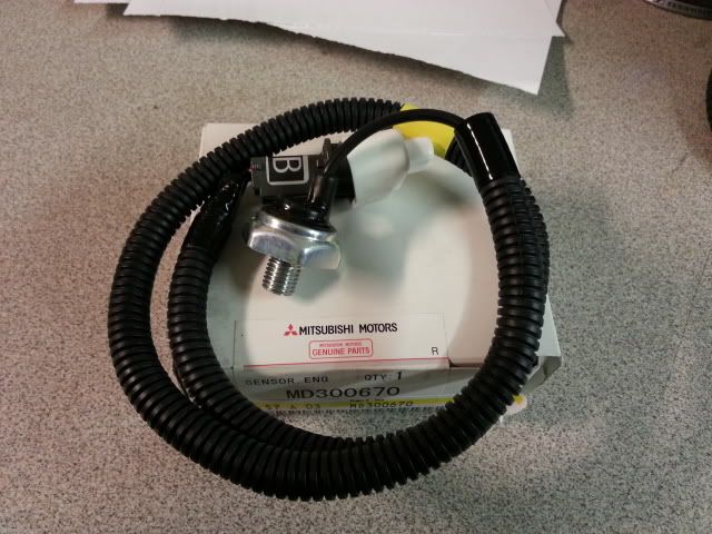

2g knock sensor for the AEM box.
