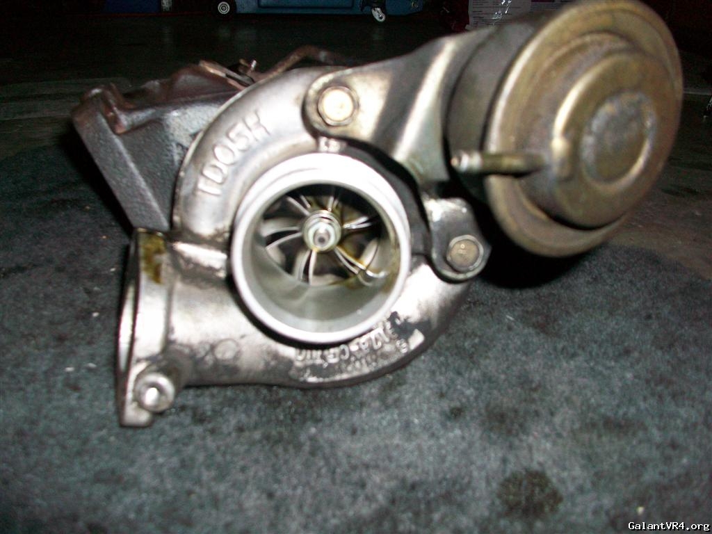

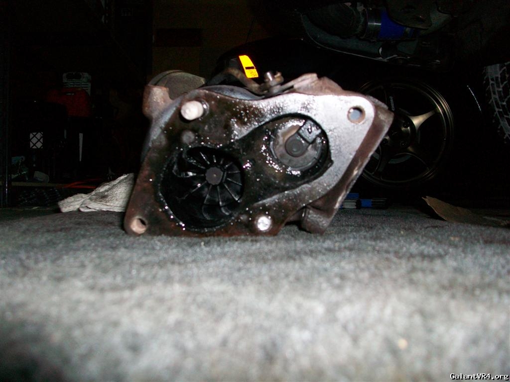

I pulled the turbo tonight. Looks like that's definitely the culprit. Exhaust ports were dry. Turbo exhaust outlet was super wet, as was the inside of the compressor housing. The shaft doesn't have any irregular play, and zero in-out play. What causes the seals to go like this?
Here are a couple of poor pics showing how wet with oil this thing is:
Sooty exhaust ports, but dry:
BTW, this turbo had the section between the wastgate passage and turbine outlet ported away. Weird.
