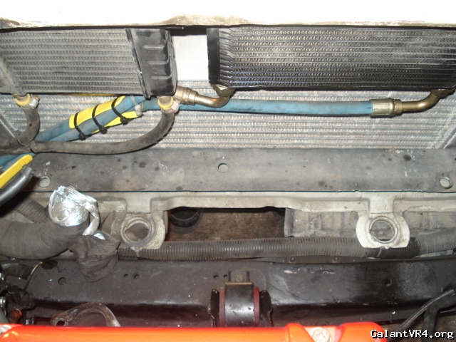

I have a setrab oil cooler for sale. Its the one on the right. You would have to make lines. It still has the line fittings though.

Ive got the RS setup already and its on a rallycar... It is getting the oil a little hot by the end of a stage
IMG_0606.JPG.html
