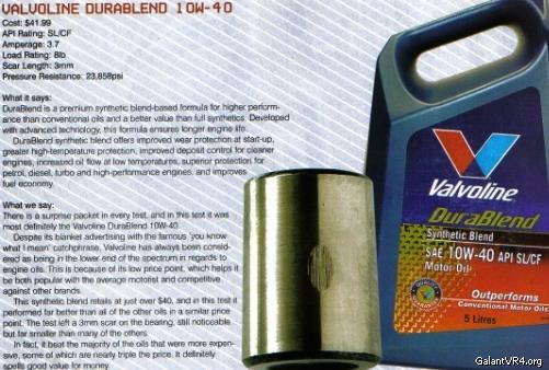

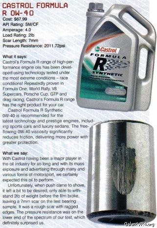

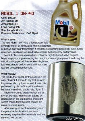

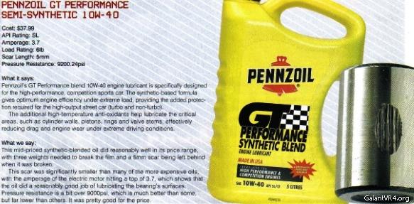

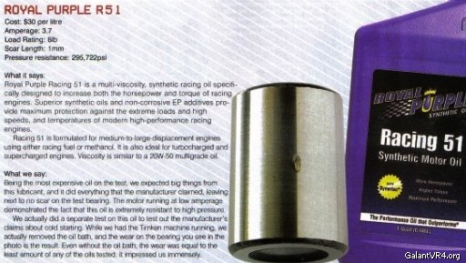

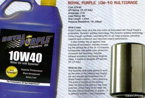

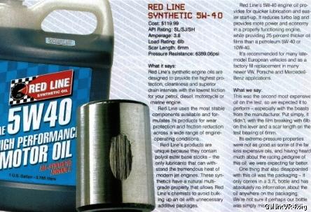

There's a recent test of synth and synth-blend oils by an Australian magazine. Looks like Royal Purple's R51 & 10w40 and Valvoline Durablend are at the top. Castrol R & Mobil One aren't. Sorry but you have to be a member of Rennlist to see the full test. Here are some well-known US oils that were tesed:

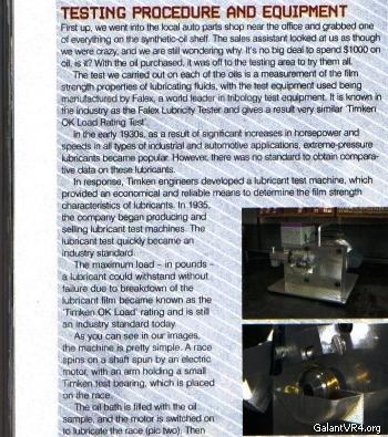

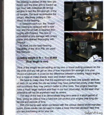

The magazine used the "Falex Lubricity tester" which is very similar to the Timken Bearings standards. See methods below-

The magazine is called, "Street Commodores" in Australia. Assuming there's a website under the same name. Try to google it, issue 108. the one with the gold Commodore on the cover.

What i'm talking about is actual labs analyzing the oil that came out of real world motors. The magazine test looks pretty bogus to me. They test a whole group of oils, and only one has "great" results, one is marginal, and all of the other top oils are complete sh*t? Please.
Sorry. I can see why you reacted with "The magazine test looks pretty bogus to me. They test a whole group of oils, and only one has "great" results, one is marginal, and all of the other top oils are complete sh*t?" I did not post all the other oils they tested, like Penrite (it did well, Shell, Gulf, Fuchs. This test is extreme and when the oil film breaks down, the damage is going to be bad. It only tests just one aspect of oil, not all that's involved in hi perf. driving.
I do challenge anyone to find & post a better test, comparing oils we can buy here in USA.
I would postulate (my big word for the day), that this test is really only testing the oils film strength.
While this is an important factor, it is not the only thing that differs between a good oil, and a not so good one.
And I'd say it has as much to do with the viscosity of the oil, as it does the with quality.
As you can see above, none of the 0w-XX oils did any good, and the best was a 20w-xx.
