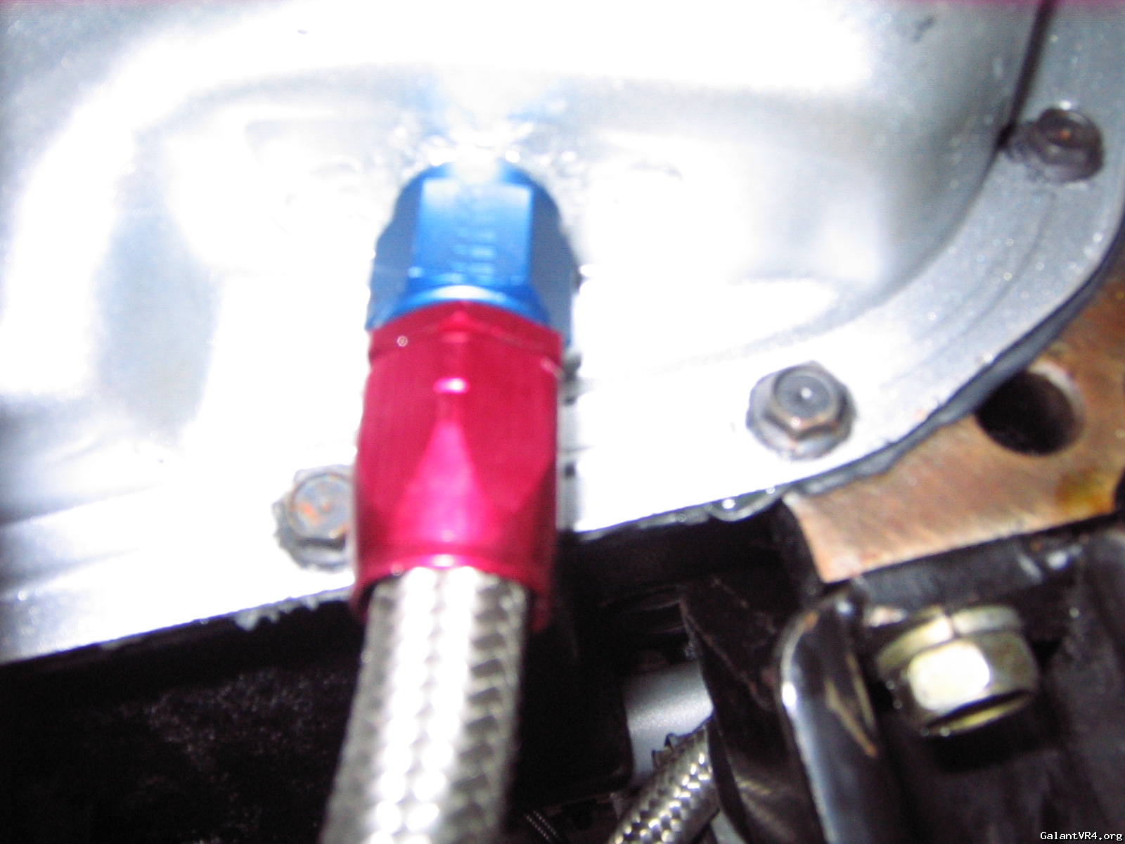

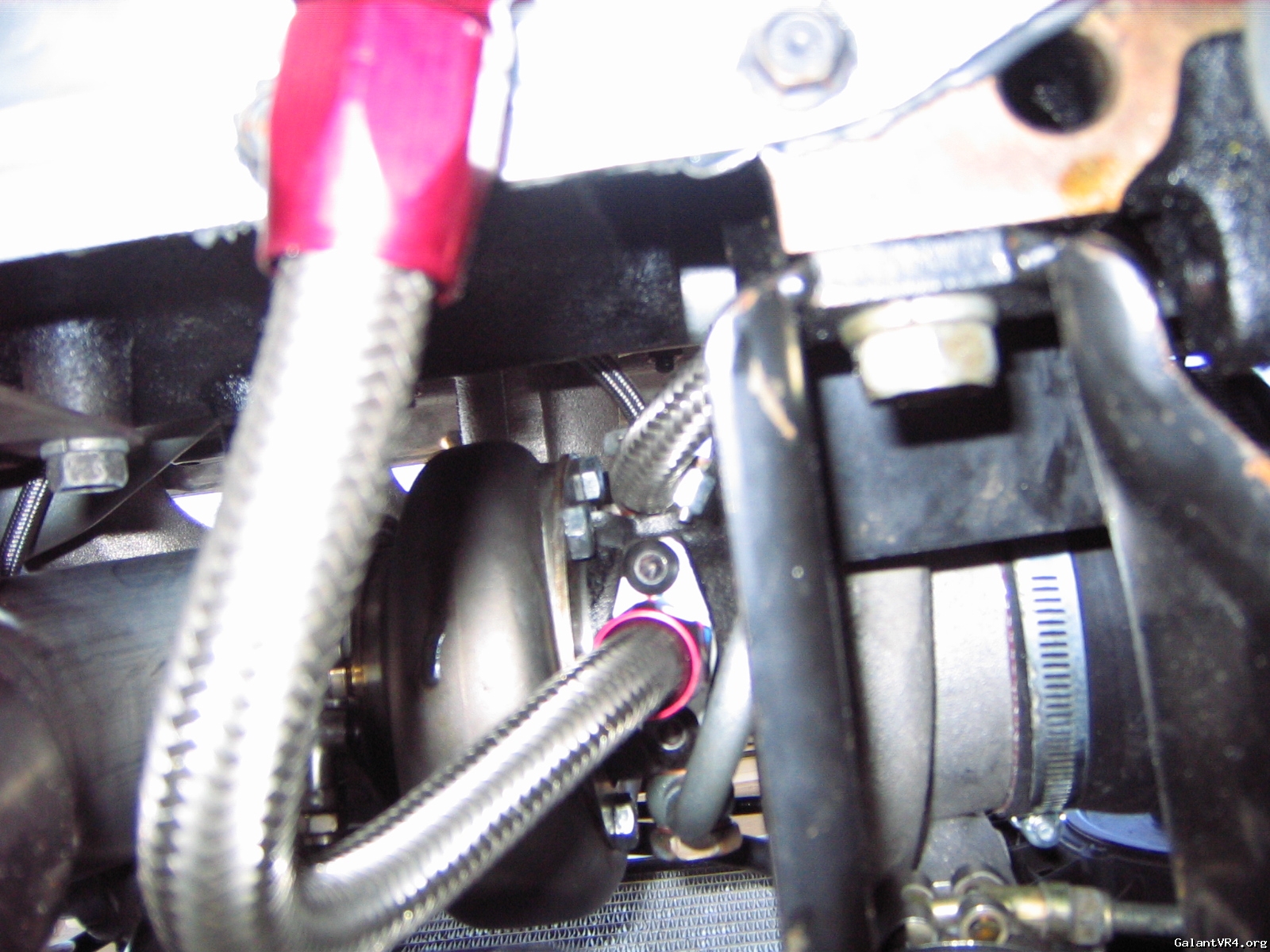

Quoting GVR4_1057:
This is my setup. It is -8 AN with straight swivel seal ends.
What fitting did you end up using for the pan?

I did the same, utilizing -10 instead. I would have used -8, but all the turbo fittings I saw were -10. Are you running a MHI?
I don't think I can get away with two straight fittings. I might be able to sneak over there today to work on it. Thanks for the reply.

I have a FP3065. I made up the outlet by turning a steel -8 to NPT fitting to slip into the oil drain and made up a clamp to hold it on and used a copper crush washer to seal it.
