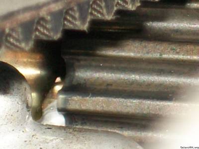

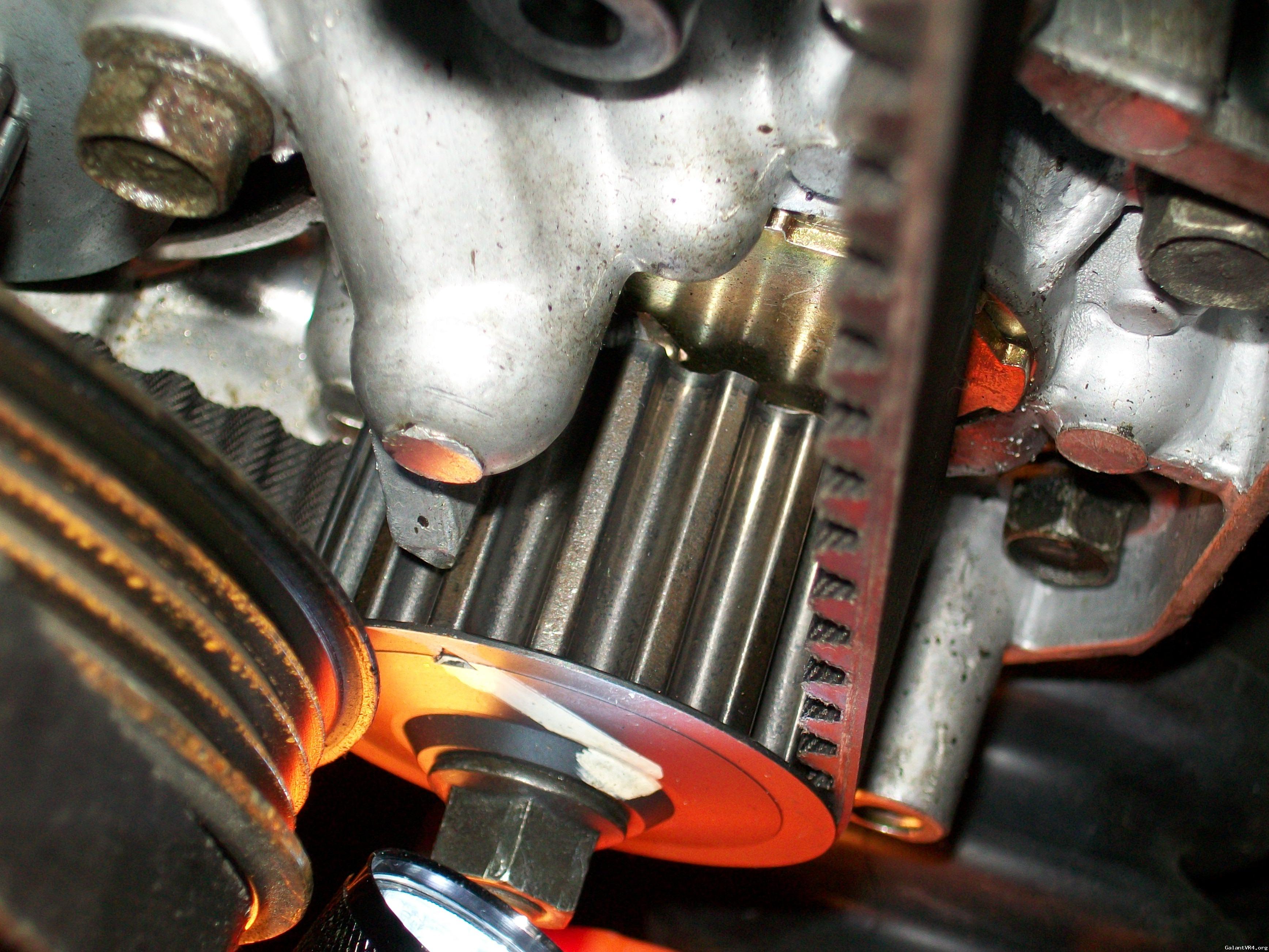

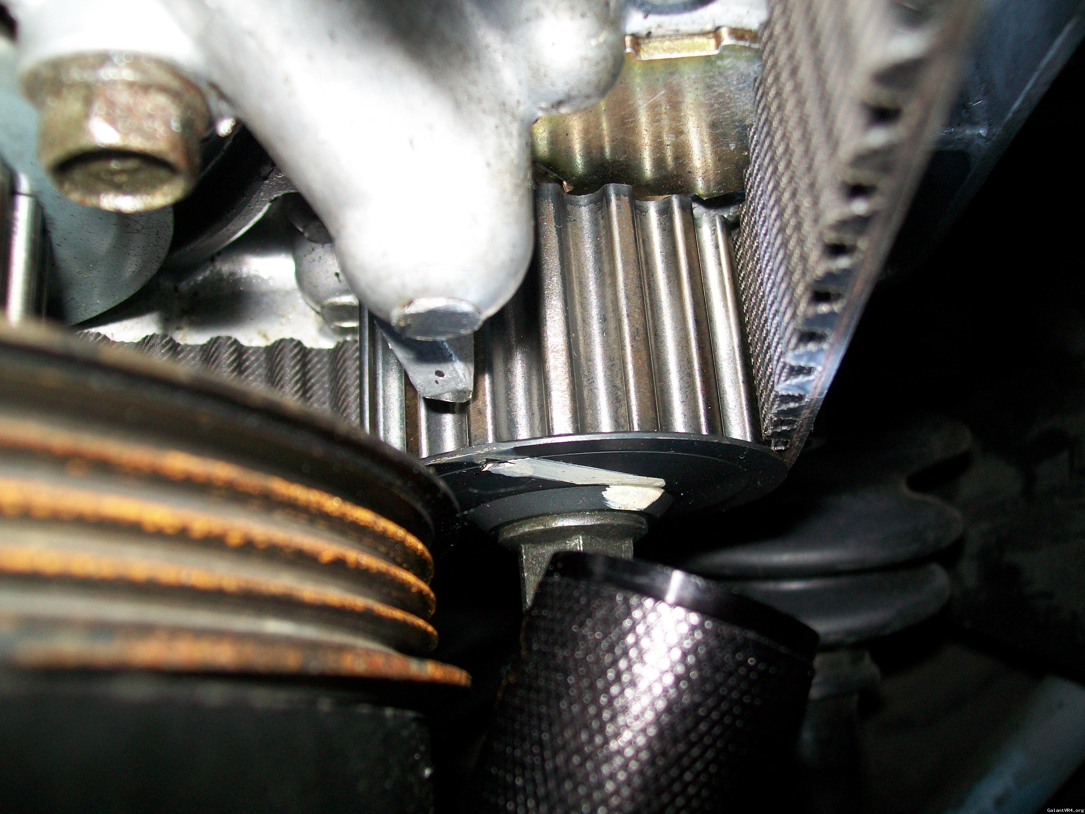

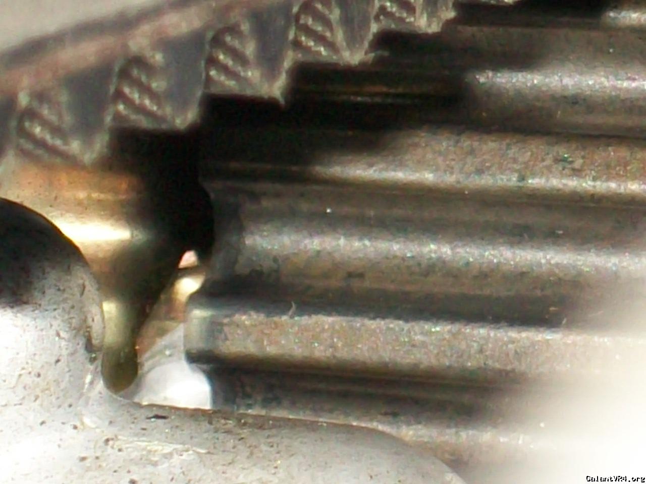

Here`s the pictures per our request...Took me about 30 mins trying to get the right angle. /ubbthreads/images/graemlins/grin.gif
