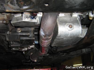

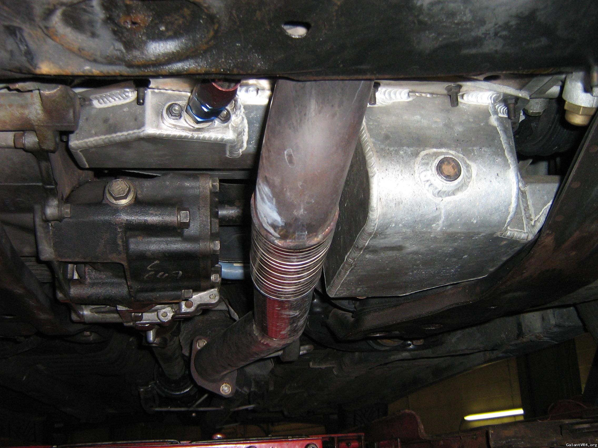

Only thing I think would be better would be a dry sump setup. /ubbthreads/images/graemlins/worthy.gif
alansupra94
Mar 3, 2010
1,909
Wayne,NJ
Thats seriously way overpriced IMO.
If my dad still worked at Kearfott Guidance....god I would be set for life. They have 5 axis CNC machines....15 of them /ubbthreads/images/graemlins/applause.gif Plus they have all the military grade stuff I could dream about. From tons of high-grade billet aluminum, circle disconnect electronic connectors, etc. /ubbthreads/images/graemlins/worthy.gif
I could seriously make a basic model in Pro-E, transfer it over to model generator, check all the clearances and values and then fire away!
