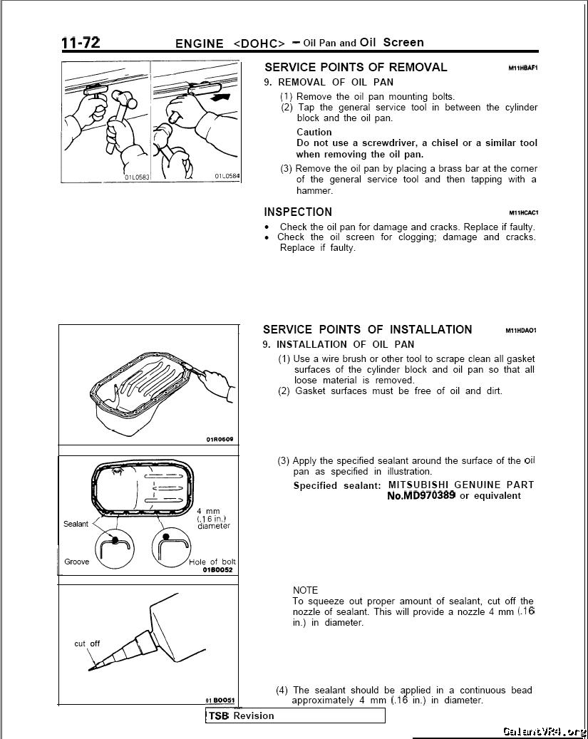

Ok I have a question for the veterans. I'm trying to swap oil pans and am currently removing one but its being a bitch and doesn't want to break free. WHat do you guys use to break the seal?
11,981
Before you go prying on it, make damn sure you got all the bolts. A couple of those bastards are hard to see. I've put a piece of wood against mine and hit that with a hammer in the past, or really careful prying. I think the service manual shows how to do it as well, but with a specific tool.
Thanks man. Putty knife FTW. We were able to get er in there and slide it along and break er free along with gentle taps from a hammer.
Also, you can use a gasket with the moroso pan. Harry had one on there along with rtv sealant and that sucker was on there good. No leaks. I only changed it cause I found a crack in it and to have a male bung welded onto the new pan, which is also a moroso.
I think I may have tightened the pan on too soon before letting the new sealant dry. How long do you typically wait before bolting it on? I squeezed it out onto the surface and it seemed to start to dry quickly so I got it up on there and start tightening all the bolts starting one at each corner and working towards the center. Just wondering cause I don't want all the gasket sealant to seep inside. I used Hondabond.
11,981
I mentioned this in another thread, but I usually install the pan right after running a bead of RTV around it. No need to wait.
Nice. After looking at the old gasket/pan I might remove the new pan during the week just to see how my gasket took shape. I dunno.
