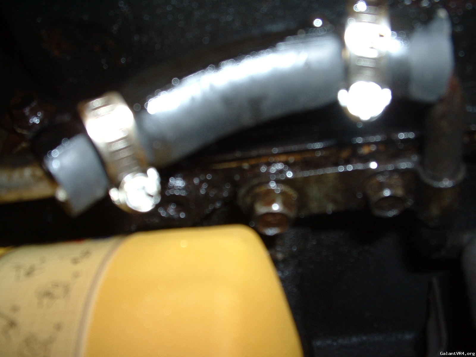

Most of the oil seems to be collecting on this short coolant hose. I replaced it a few months ago, cause the original one busted.

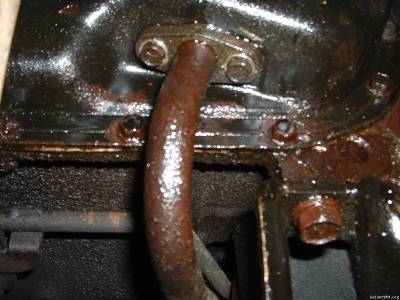

Oil return line doesn't seem to be the source. Maybe a tad wet, but no collected oil like other places.

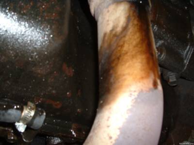

Oil on the DP. I'm afraid this can catch fire.

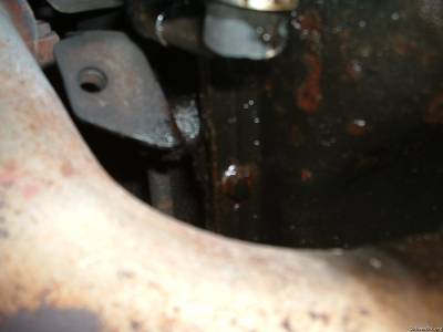

Note, above the oil pan seems pretty dry. The valve cover gasket is new and dry. I really don't want to guess and replace the oil pan gasket, but I might have too. I hope I can find a true source this weekend.

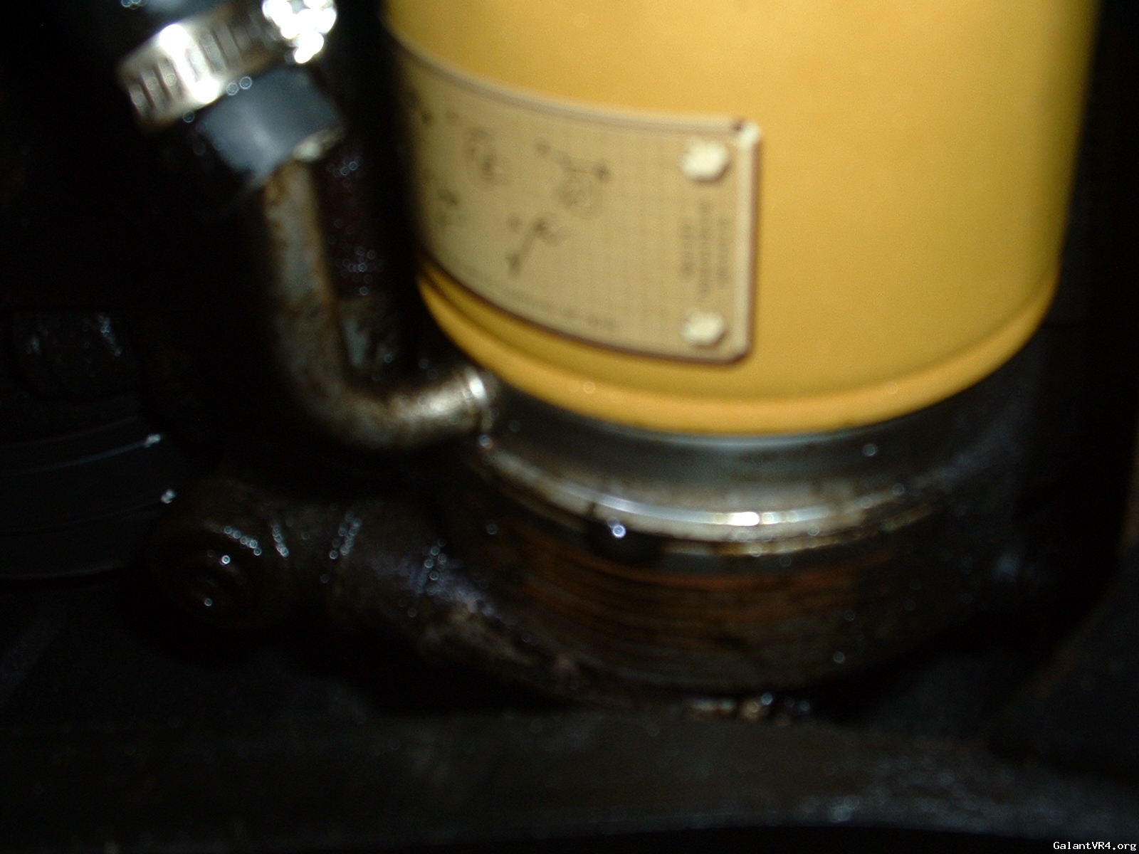

Could this be a case of the stock oil cooler crapola thing? While I still can't find a source, most of the oil seems to be collecting around that area.

Is the oil return wet all the way up? If it's leaking under pressure (There should not be any pressure to speak of in the return), it'll throw the oil and collect in places where it can pool...
I'd be inclined to double check the turbo drain. Could also be a number of things, but this seems to the the most common. I'd also recommend cleaning the areas well, and firing it up/ taking it for a VERY short drive, and see what you find.

Look up to the turbo end of the oil return line, it shouldn't get that wet (assuming it's in front of the leak when moving) that far up.

I can try that tomorrow. The pictures didn't turn out so great, cause the camera didn't have enough light to focus. I'm just wondering of the drop of oil right behind the oil filter is a sign of the oil filter housing/cooler starting to fail. I know it's a problem and I never did go to the 90 style setup. Most of the oil seems to be coming from that area and spraying on the down pipe and that short coolant line has the most oil pooled up. Why it wouldn't leave one damn drop while I was watching it with the car running is beyond me.
11,983
There is a seal within the oil cooler that may need to be replaced. It's pretty easy to do. Don't blame the oil cooler, there's nothing wrong with it. sh*t just gets old.

Could be oil pan seal, turbo oil drain, oil cooler, any of the seals on the front of the motor like the crank and oil pump seal, cam seals, or even the valve cover gasket. If you let it go long enough that sh*t will seep all the way down to the bottom of the motor. Check the lower middle exhaust manifold stud as well since it threads into an oil drainback in the head and needs to be RTV'd when installed.

As turbowap said, the oil seal behind the cooler could be leaking, but...There is a problem that I have seen a BUNCH of times with these. If the oil filter gets over tightened, it will crush and deform the face of the cooler. When this happens, you will have a void where the oil seal seats, and the oil will leak out. The one thing that usually makes it worse, is people will try to tighten them up even more to get the leak to stop. All that does, is makes the leak bigger.
