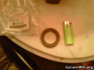

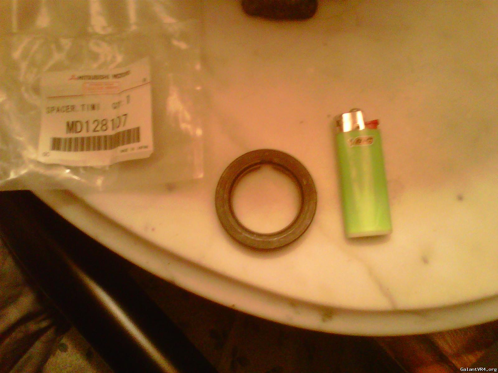

I just picked up this spacer for the bs belt pulley. Pretty cool for 6$

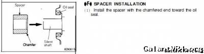

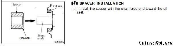

If you wouldn't mind, when you replace that seal - I have a question regarding the spacer that slides on to the end of the front balance shaft, sitting in the center of the seal. One side has a straight cut edge while the other side is beveled. I'm wondering which side faces in (or out for that matter). I didn't remember when it came time to put it back on so I checked two different engines I had access to and that piece was installed both ways. I'm wondering if it even matters which side faces in/out...
The beveled side of the space goes in towards the seal. It's to lessen the possibility of damaging the seal during installation.
If you installed it incorrectly but didn't damage the oil seal you are fine.
Here's the illustration from the service manual:
