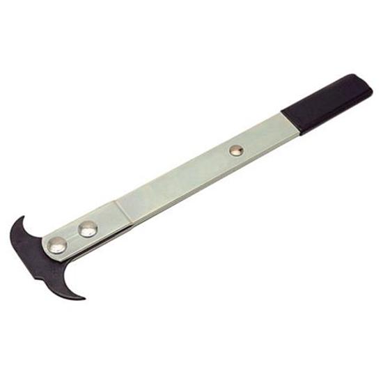

Use a seal puller, DON'T SCRATCH THE CRANK or oil case.
