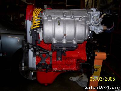

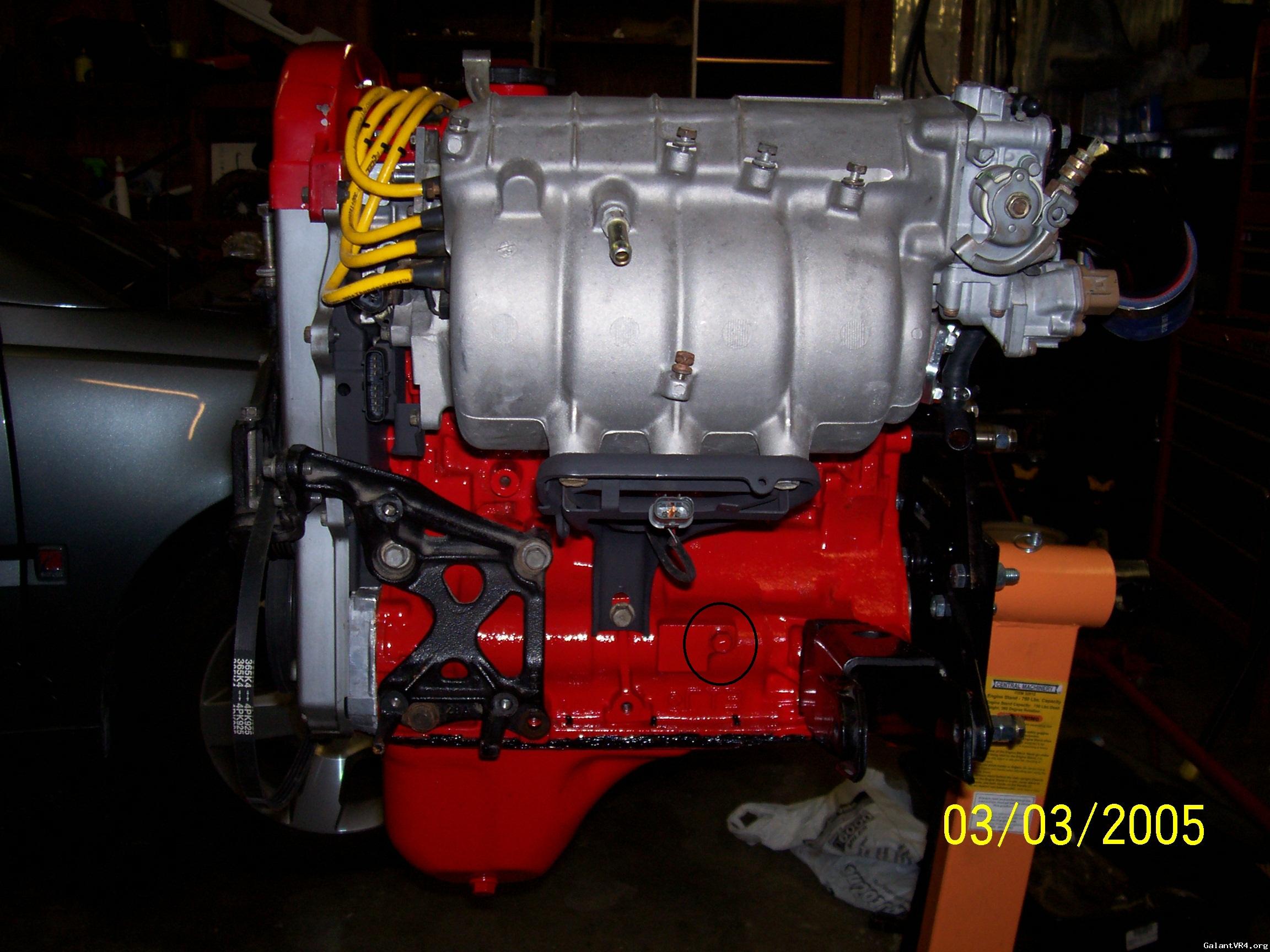

There is a bolt on the back side that allows you to stick a screwdriver in and align/phase the balence shafts during t-blet/b-belt service. It may be missing.

I can't think of anything on the backside of the block that would be leaking than the bolt Terry mentioned. I can't imagine the head gasket being screwed up in such a way that it is leaking.
Other than that, oil could be leaking on the side of the engine, and then flow down the back. In that case I would suspect the following: valve cover gasket, cam angle sensor o-ring, intake camshaft seal, front main oil seal, oil pump seal, front balance shaft seal.

I'm all for the missing plug for the BS. But, also a split CV boot could sling grease onto the exhaust and back side of the block.

The bolt that supports the manifold bracket also passes into the crank-case. I accidentally left mine out once and I was spraying oil onto the rear-subframe until I figured it out. If that bolt is missing you'll have PUDDLES of oil under the car... not just smoke.
