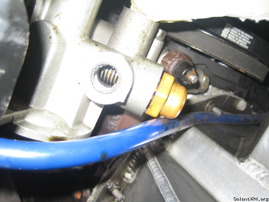

Ok so I had a leak at the oil cooler lines right by the filter housing. I bought a new B&M cooler with AN fittings per this thread.
Parts arrived and I began to disasemble the old stock oil cooler. I figured while I was under there I would take care of any other leaks so I removed a AN fitting with an elbow that wasn't in use, port 3 seen in this photo. After removing it I noticed pieces of some material breaking off of the filter housing threads.
Is this material teflon paste? Its breaking up and in small pieces which I'd rather not have mixed in with my oil.
Is there any way I can get the rest of this crap out cause I'm close to just buying a new filter housing and redoing all the lines.
I've never worked with this "teflon paste" before. Edit: Actually I have but it was long ago. I figured this stuff was jb weld but wasn't absolutely psotive.
What is the consensus on regular old teflon tape for sealing up oil ports? Are there different thickness tapes? What would you guys recommend to seal up all the ports on the oil filter housing? I don't want a drop of oil on my garage floor.

That does look like thread paste.
I don't use thread tape at all anymore, thread paste is much easier and more reliable IMHO.
If it was me I would pull the oil filter housing off the car and then clean the threads up.
That way you can port the relief valve area too /ubbthreads/images/graemlins/smile.gif

If it the port I think it is that is not thread paste. (again I am guessing here) It might be JB Weld. It never needed to come out ever again so I used a little to "glue" in the fitting so that I would be sure it would not back out. I would clean it out to be safe.
I used only white teflon tape to seal any fitting that would need to be removed in the future.

Teflon tape is for plumbing pipes and threads at home, for automotive use please use teflon paste. Teflon tape will break into little pieces and get stuck everywhere.
Use a piece of teflon tape on your fuel system and have a piece of it came off and get stuck INSIDE your fuel injector.
Use a piece of teflon ape on your fuel system and have a piece of it came off and get stuck in your main or rod bearing.
PLEASE dont use teflon tape on any of the critical oil, fuel or water connection on your car.
I use Staybond S592 for this purposes. It is pipe sealant with teflon. It also resists oil and solvent. click
AN fittings will need no sealant, because it seals on the taper of the fitting.
NPT or other taper thread fittings seals on the tapers and will usually benefit from pipe sealant on threads.
Metric or Standard straight thread will seal on the face of the fitting and will need a washers.
Please use the right way of sealing the different fittings and connections.

He is right, however, the key to tape is which direction and how far up the thread it is applied.
Yes, paste is more foolproof and 'more correct' for EVERYONE to use, just like you shouldn't use you mouth to syphon gas either. /ubbthreads/images/graemlins/smile.gif
