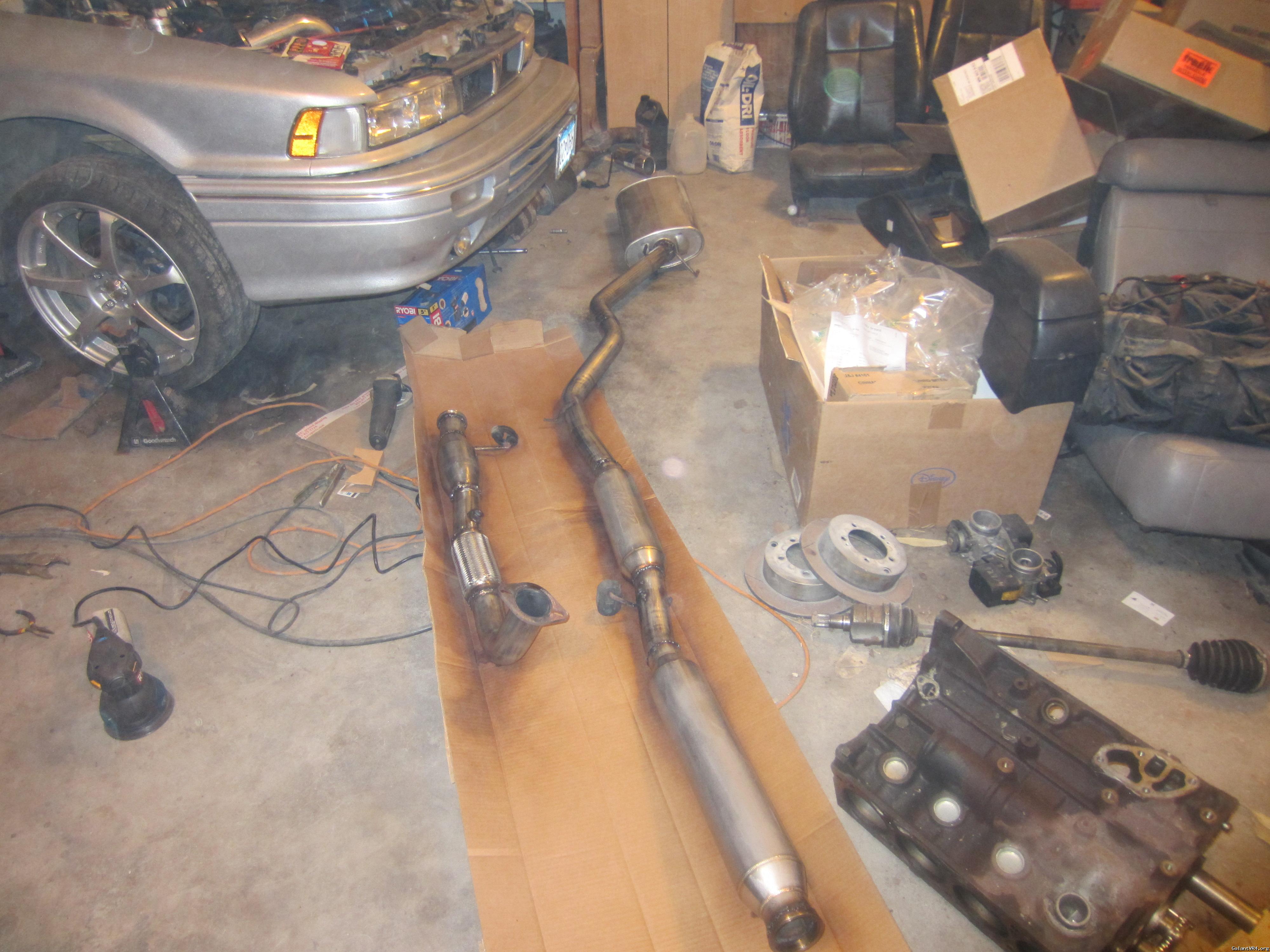

So I went ahead with my plans but kept it 2.5 all the way until the muffler where I increased it to 3" to maximize the flow of the chambered dynomax super turbo muffler which is huge and barely fit. Here's a pic after welding the biggest resonators I could fit along with a 100 cell high flow cat. I'm waiting for the clear coat to dry but will report back on the noise levels.

So I haven't been able to drive it much since f*ing around with the suspension. It's a lot quieter for sure but you do still hear it when you get on it. I can't even tell if it's idling inside the car when I come to a stop. The only problem is I can now hear other sounds that were previously over powered - fuel pump and differential. I forget to rev it from a stop and the thing just rumbles to no end like a semi trunk until the rpms get over 2k.
