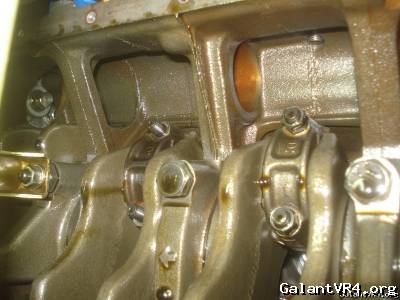

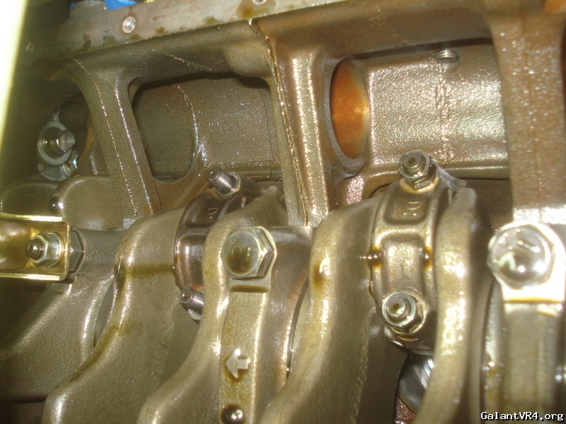

Hello people. I am farily new to the whole rebuilding engine process. Recently I rebuilt my engine. I have driven it around 450 miles when I ran into some Rod Knock. I have detatched my oil pan and found that it was number 2 making the noise.
Now, I have taken the 2 nuts off the rod bearing, but i cannot take the cap off. i am worried I may damage it if I struggle with it too hard. So if there is anyone out there that could offer some assistance, that would be awesome!
Here is a video of my problem and where I am at with the project.
You can kind of see it moving forward and backward. Also, I am posting an image here for people who would like to see exactly what I'm talking about. The cap with the knock is the one without the nuts on it on the left.
Any help or advice would be appreciated.

Turn the crank so that the rod is at the bottom of the stroke. Once you have done that put the nuts back on the ends of the rod bolts and tap up with a dead blow hammer. That will free up the bottom cap. Once it is lose pull the nuts back off and the cap will come with it.
