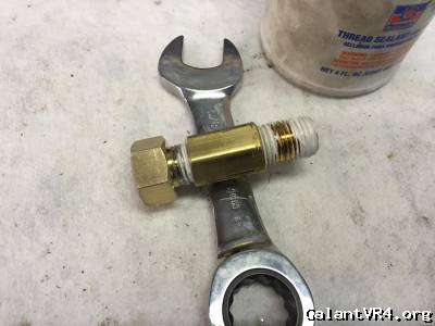

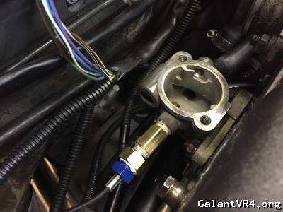

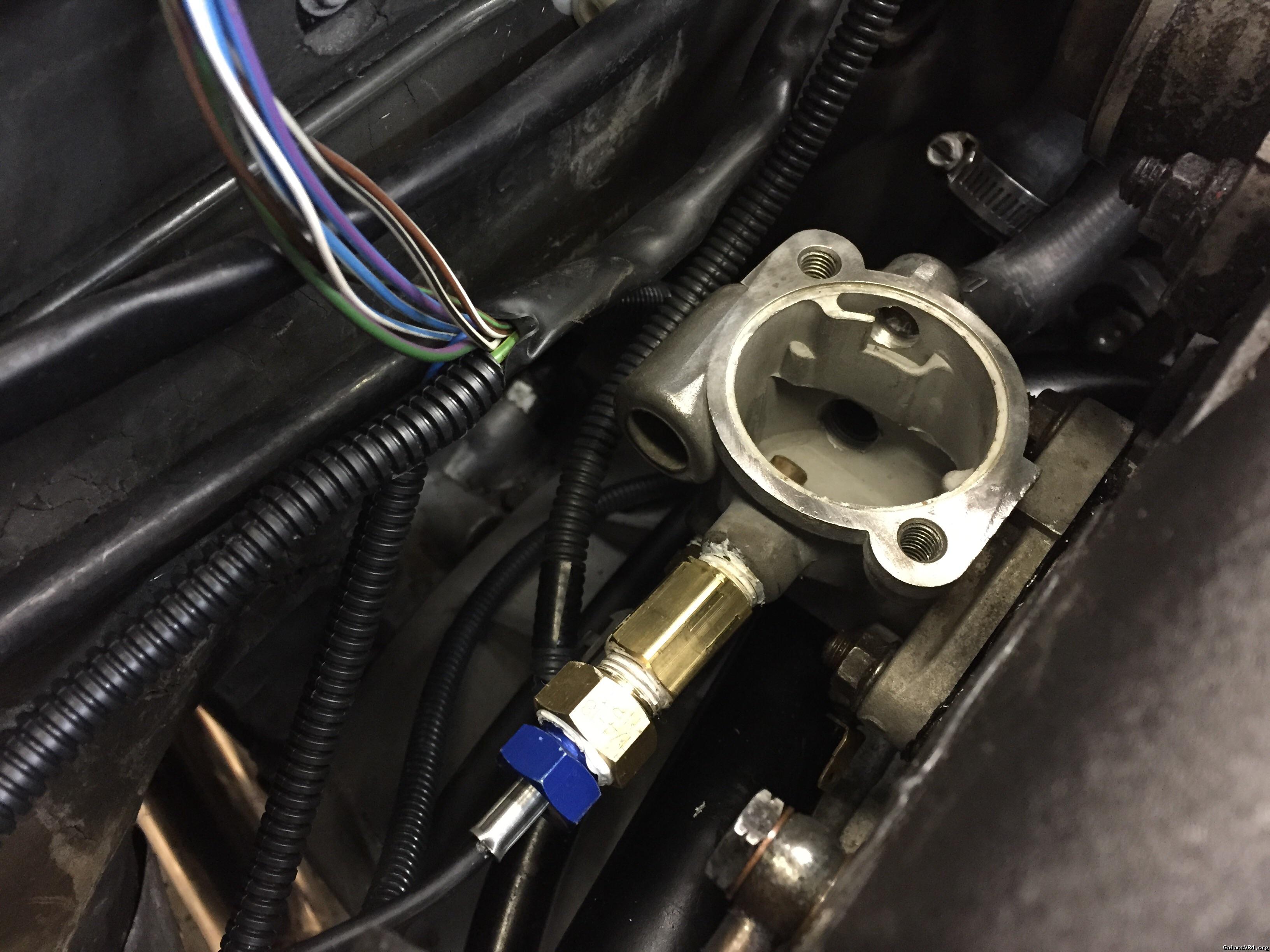

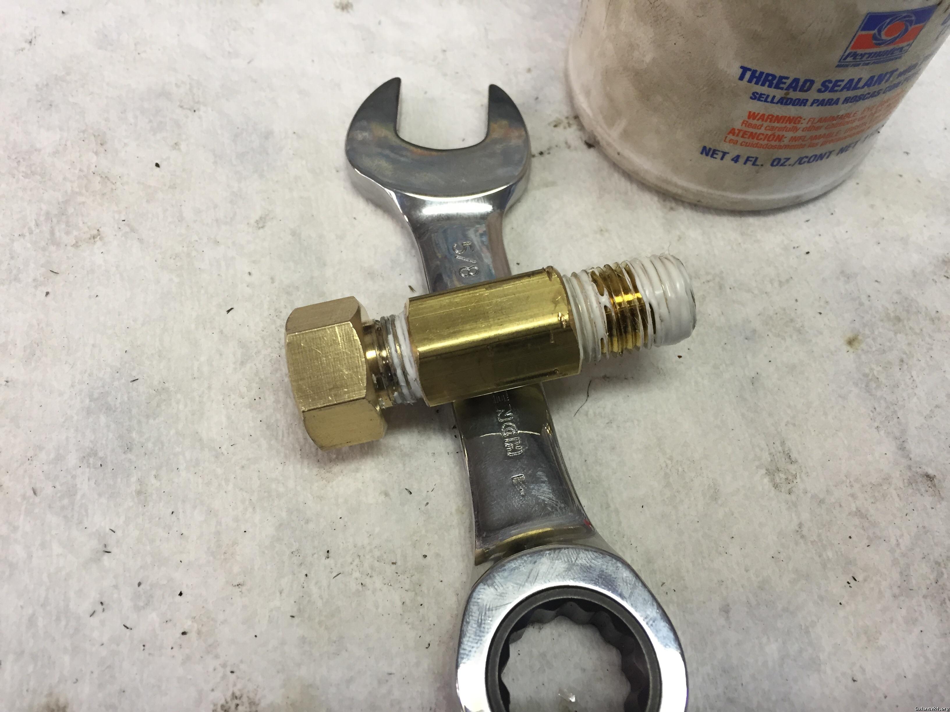

Stopped and got fittings after work today. They didn't have exactly what I wanted but I think what I got will get the job done.
Now I'm a little concerned that there doesn't seem like there's any room for water to flow around the sender inside the hex shaped fitting but I think as long as the end of the sender is in the water it'll be fine.

Looks nice. I think it will work. Coolant show flow around it enough to get a close reading. It might read a tiny bit off? perhaps, but I'd think it's going to be ok.
11,016
It may not read super accurately because the moving coolant will not directly contact, but I agree it will likely be only some small percentage off.
