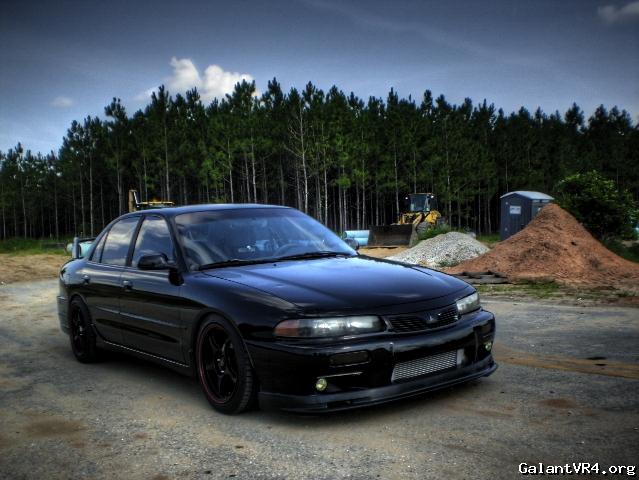

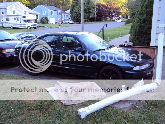

Hey guys. I'm Chris and i have had my 96 Galant since 07. We have been through a lot together. Currently is is 5 speed swapped, rear disc swapped and converted to the 7G VR4 facelift body style which includes the front bumper, side skirts, spoiler, tail lights and head lights. I swapped from single pistons to 2g GSX calipers with GVR4 rotors and have done a lot of other stuff and am in the midst of a big project to come with this thing.Multi colors ATM as i swapped on new fenders and a carbon fiber hood
no that is not my GVR4 either that is Dynastylcd's old vr4

hahahah pic of 73/1000 officially JSB in the driveway /ubbthreads/images/graemlins/grin.gif
welcome to the board little brother!

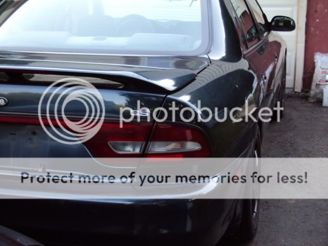

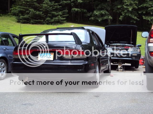

And to the other galant, nice 5 lug swapped, vr4 preface lift bumper with rare projector fogs and 1 piece JDM head lights. Now for the fenders, did you modify for the signals or actually get the JDM fenders for it? That car looked nice man. What year and setup ended up in there?

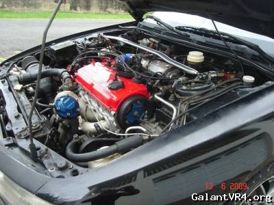

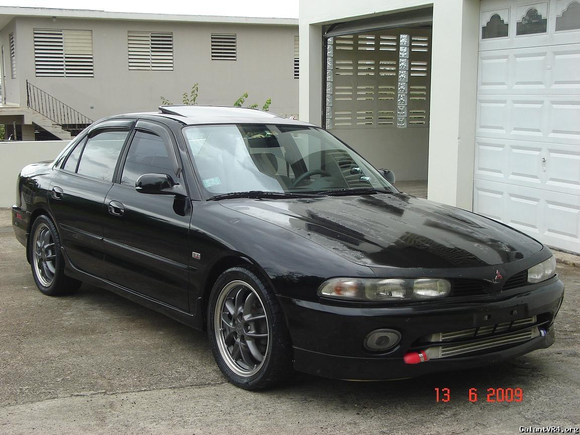

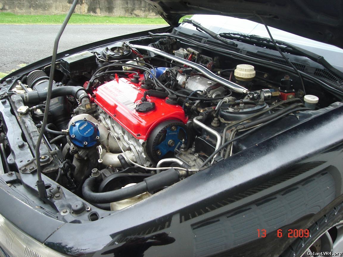

I like your car too really nice ride. About the lights on the fenders the previous owner did it. That was my daily by that time, 1997 galant ES
Specs
Garret TO3/TO4 turbo (.60/.63)
Turbo Smart 38mm Wastegate
Greddy front mount intercooler with custom piping
HKS SSQV
Custon exhaust manifold with ceramic coat and 3" exhaust
Nippo Denso (supra TT) in tank fuel pump with Bosch external pump -6an line Aeromotive fuel pressure regulator
Evo 8 injectors
Aeromotive Fuel pressure
ARP head studs
4 layer mitsubishi head gasket (2003 4 cyl eclipse)
Clutch Master 2600 / 6 puck clutch net disc
Apex AFC
HKS Turbo Timer
Greddy EGT with memory and warning light autometer fuel press and boost gauges
MSD 6AL With External MDS Blaster coil
5 lug conversion (96 eclipse GST)
Eclipse GSX 94 2 pots front calipers and discs
Rear sway bar
KYB GR2 shocks Eibach springs
2003 eclipse rims
JDM front conversion
Numers 337hp/353tq 11.3 a/f 19 psi on pump gas /ubbthreads/images/graemlins/wink.gif

Wow that sound really good pretty nice set up i think about do that too (AWD) but i was having my VR4 with 400hp plus and this one was my daily with a\c and everything so thats why i decide not to do it.
The only thing that i couldn't find was the rear bumper it is super really hard to find.... Have you tried to see if you could find one?

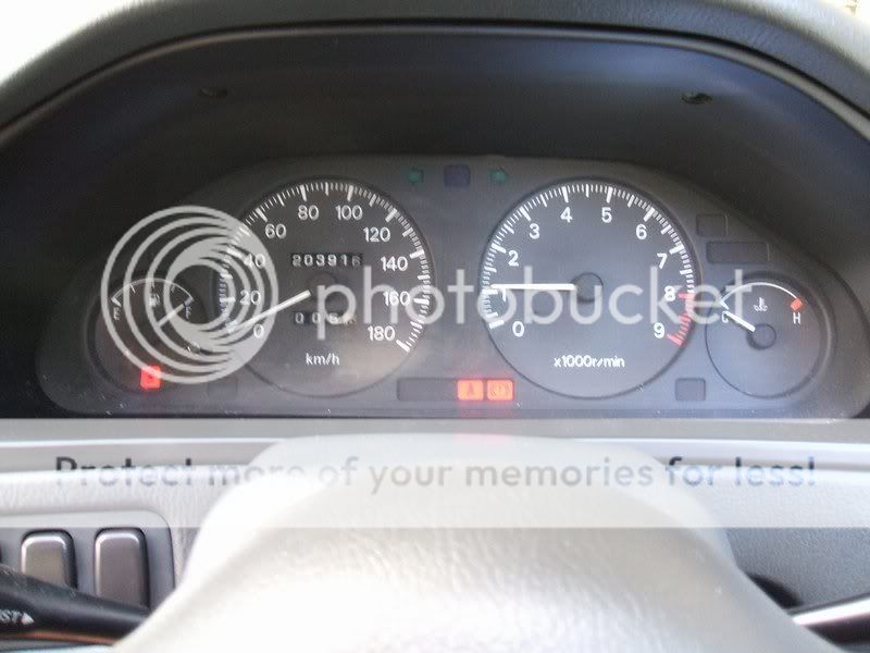

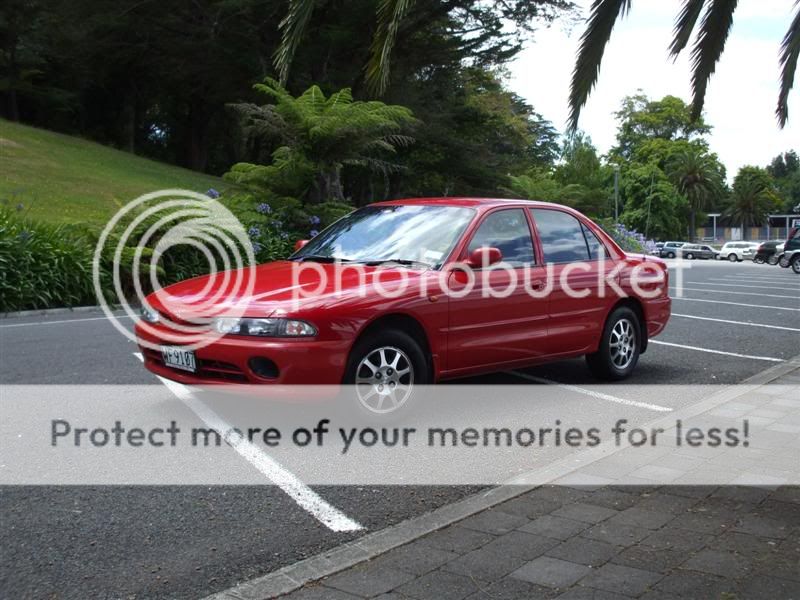

my 7G's
a 1993 VX-R 5spd man
note the 8000rpm redline..
factory fitted with the 6A12 DOHC 24V MIVEC-MD V6 engine - 200hp from a 2.0L N/A engine
a 1994 (facelift) VX-R auto
and lastly a 1997 GLXi 2.0 daily beater

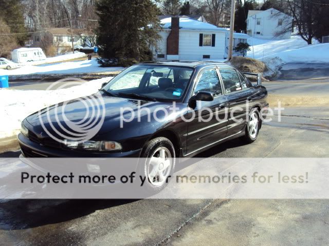

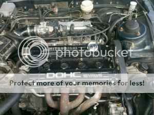

here was the GS i had last summer. fun thing stock 4g64 2.4 DOHC

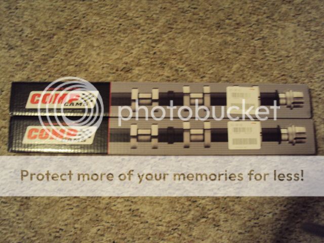

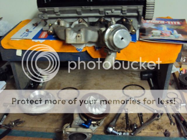

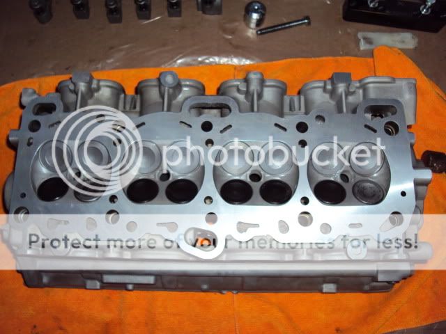

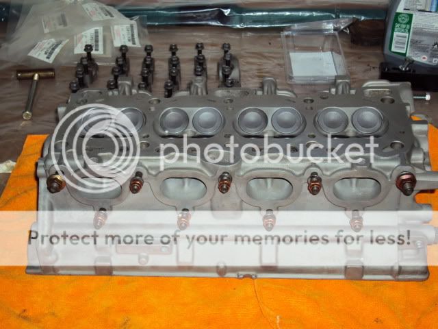

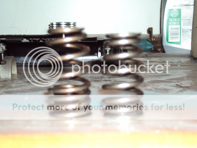

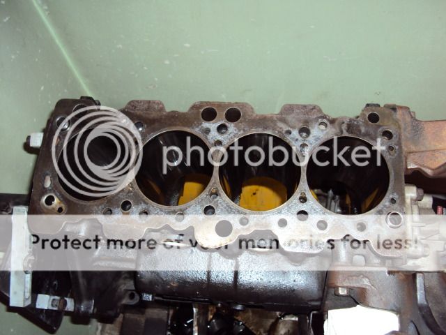

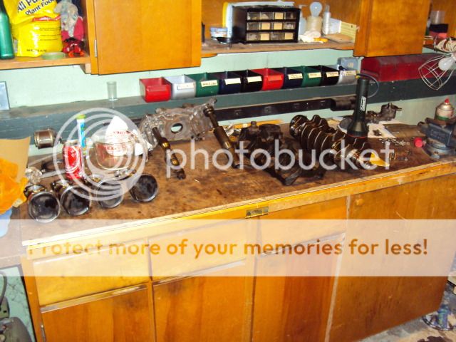

here is the motor build. The head i finished a few months back. The motor was rebuilt with around 40k on it but i built the head and recently dynastyLCD and i took the bottom apart for a BS delete and found a good amount of bearing wear so now im going to build the bottom end
Comp 101300s(FP3s)
FP Beehives
Bare block right now

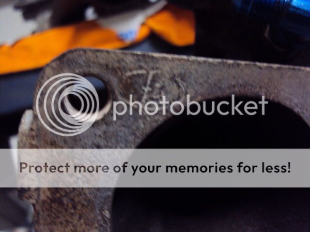

Part of the new turbo setup, Converting the Green to a 25g with antisurge cover
