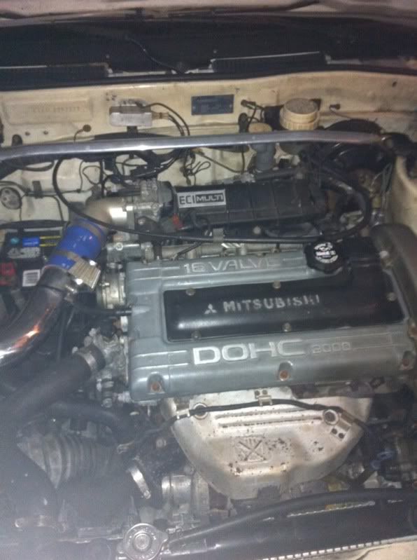

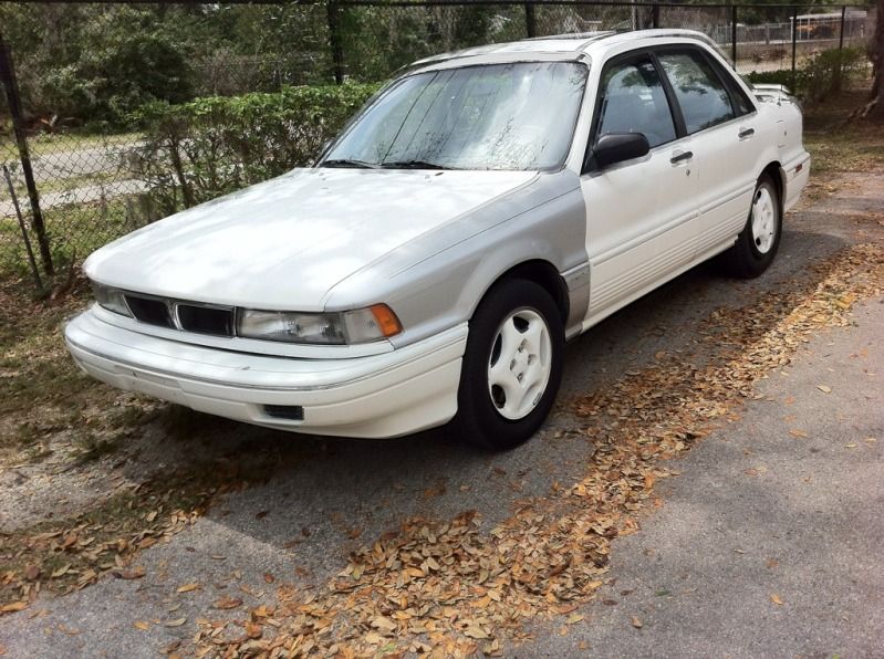

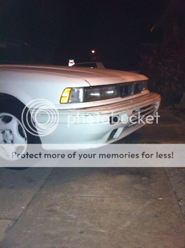

I recently bought a 1990 galant GSX with a complete swap from a 1g eclipse GSX. The car is a mutt, it has some galant GSX parts, some vr4 parts and some DSM parts. So the car is pretty much a VR4, without the awesome #xxxx plate. Everything was rebuilt 20k miles ago and it has the tried and true 14b pushing a weak 9lbs.
Here's what I know his been done before I bought it.
Poly mounts
EBay bov
Hard uicp
Straight pipe exhaust into a lame magnaflow muffler
6puck clutch setup (previous owner didn't know brand)
No name coils in the back / 1g suspension in the front.
Big brake upgrade.
Vr4 front bumper and side moldings.
On to the pictures, caution, their lame phone pics.
