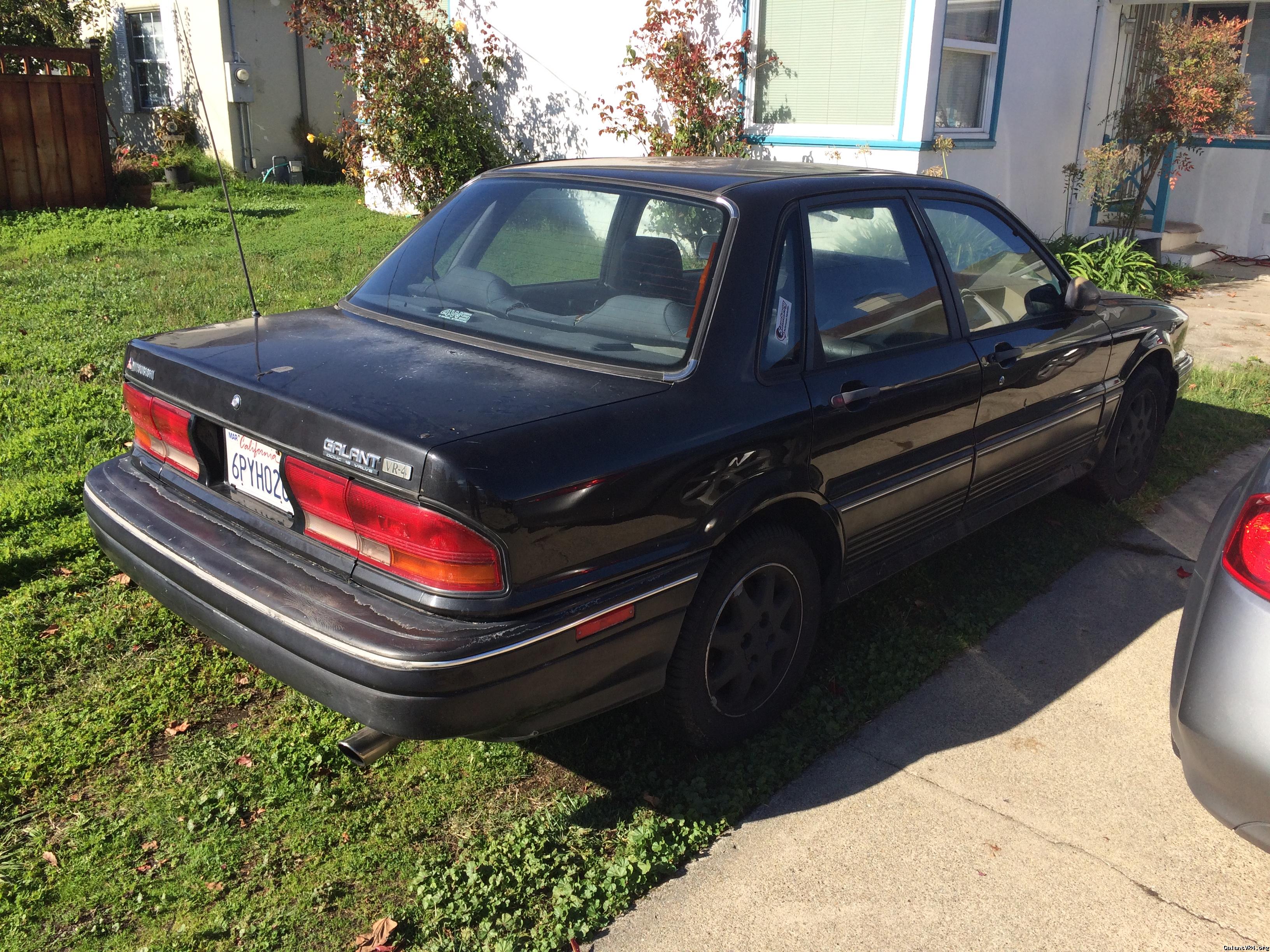

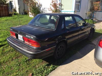

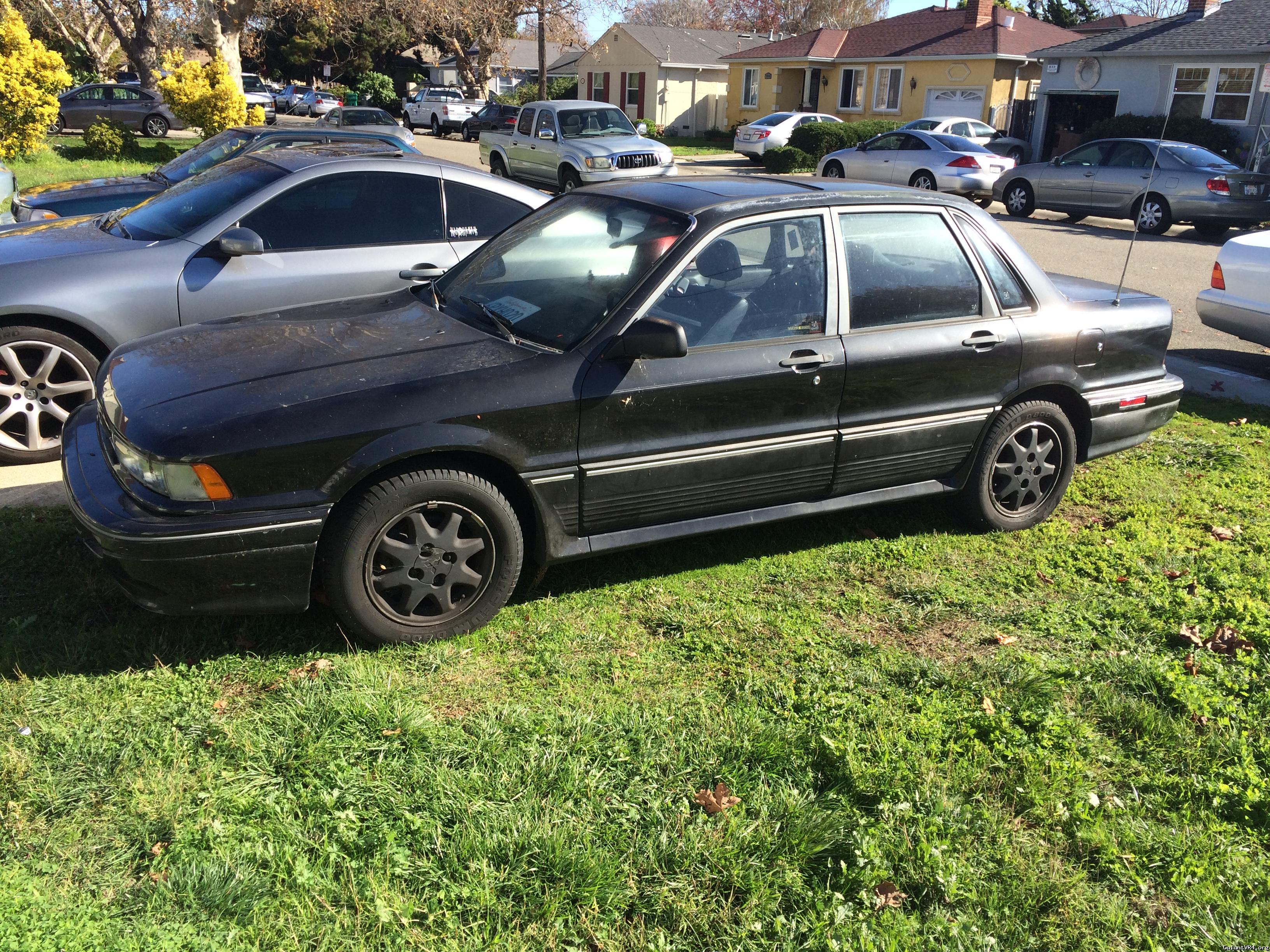

yea definitely a project, only bought it for the snow season and daily drive,over heated according to previous owner,been sitting almost 2yrs now. planning on doing hg this coming week. still on the fence about mods. i come from a toyota JZ engine back ground but i suppose an engine is an engine and they all essentially work the same. just gotta put in a little time into research and see what mods would get me to 320-350ish to the wheels.

i think this ones been on Craigslist for a while, on and off. he said it had a blown head gasket but it looks really straight! congrats!
