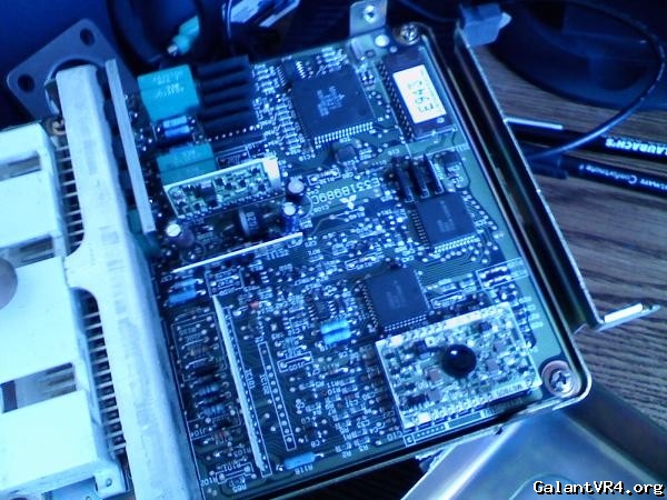

ok well im completly stumped now. Tried a different coil pack and transistor and it didnt work, tried a Brand New CAS and still wont start. Pulled the ECU out and that looks fine to me as well /ubbthreads/images/graemlins/banghead.gif /ubbthreads/images/graemlins/banghead.gif /ubbthreads/images/graemlins/banghead.gif
WTF why wont this damn thing start!!
