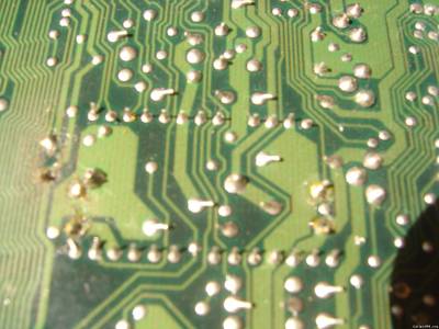

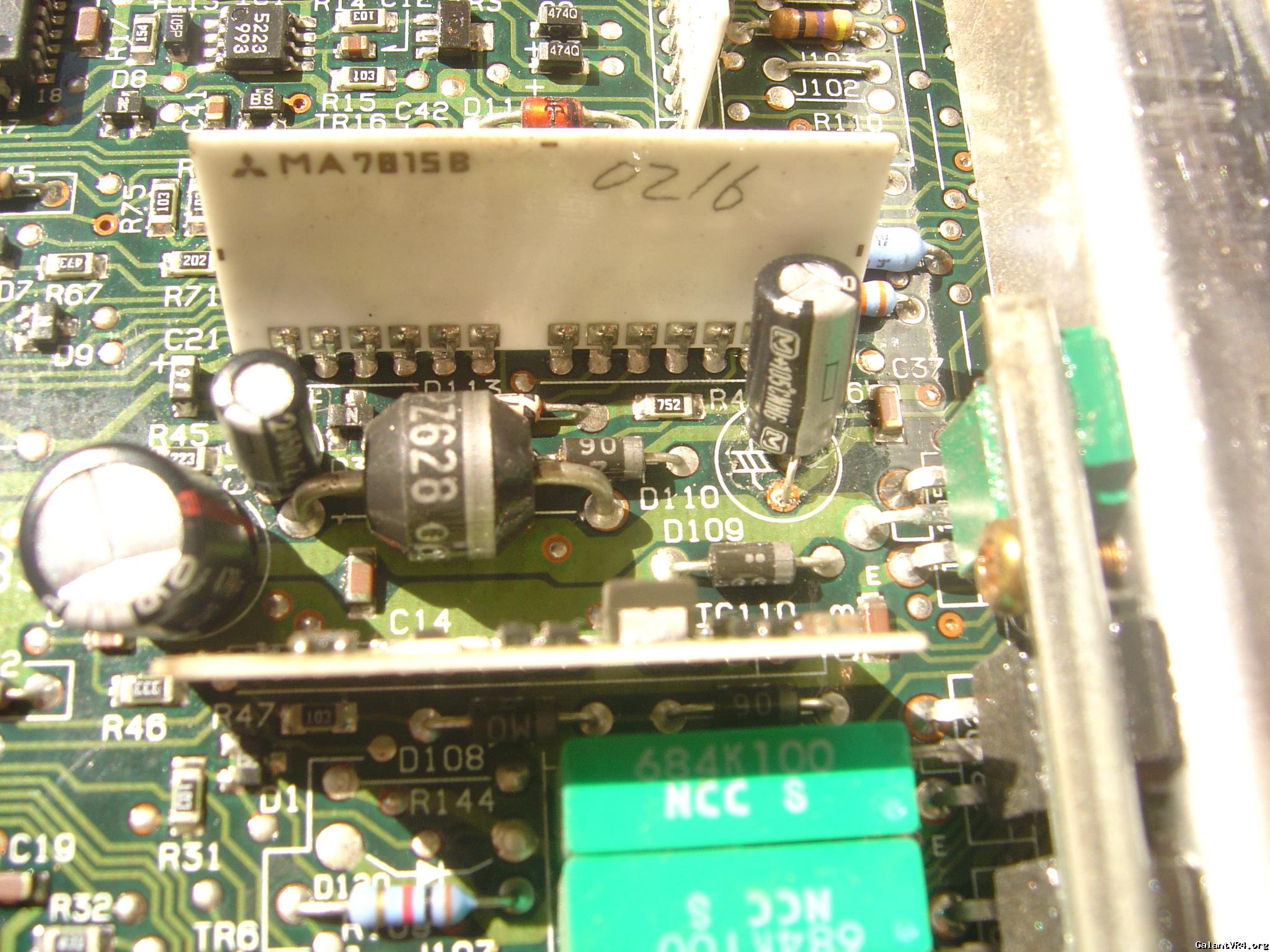

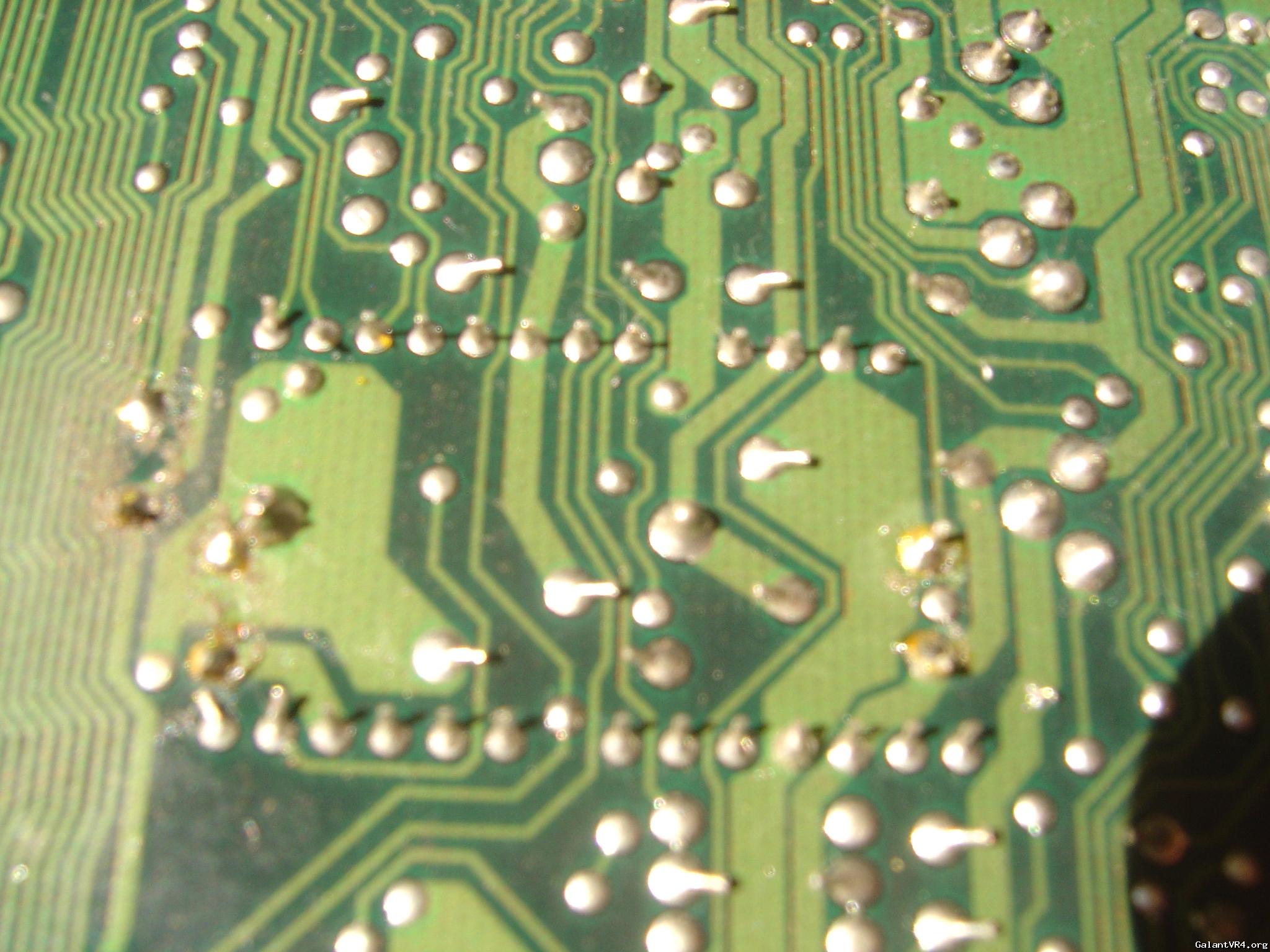

I am beginning to lean towards blown MPI relay, but its just a gut feeling. This is what the caps look like. I think they were replaced, but I don't know if that is replaced caps or acid burn. The guy I got it from had replacing caps info from VFAQ in the paperwork he gave me. What do you guys think?
