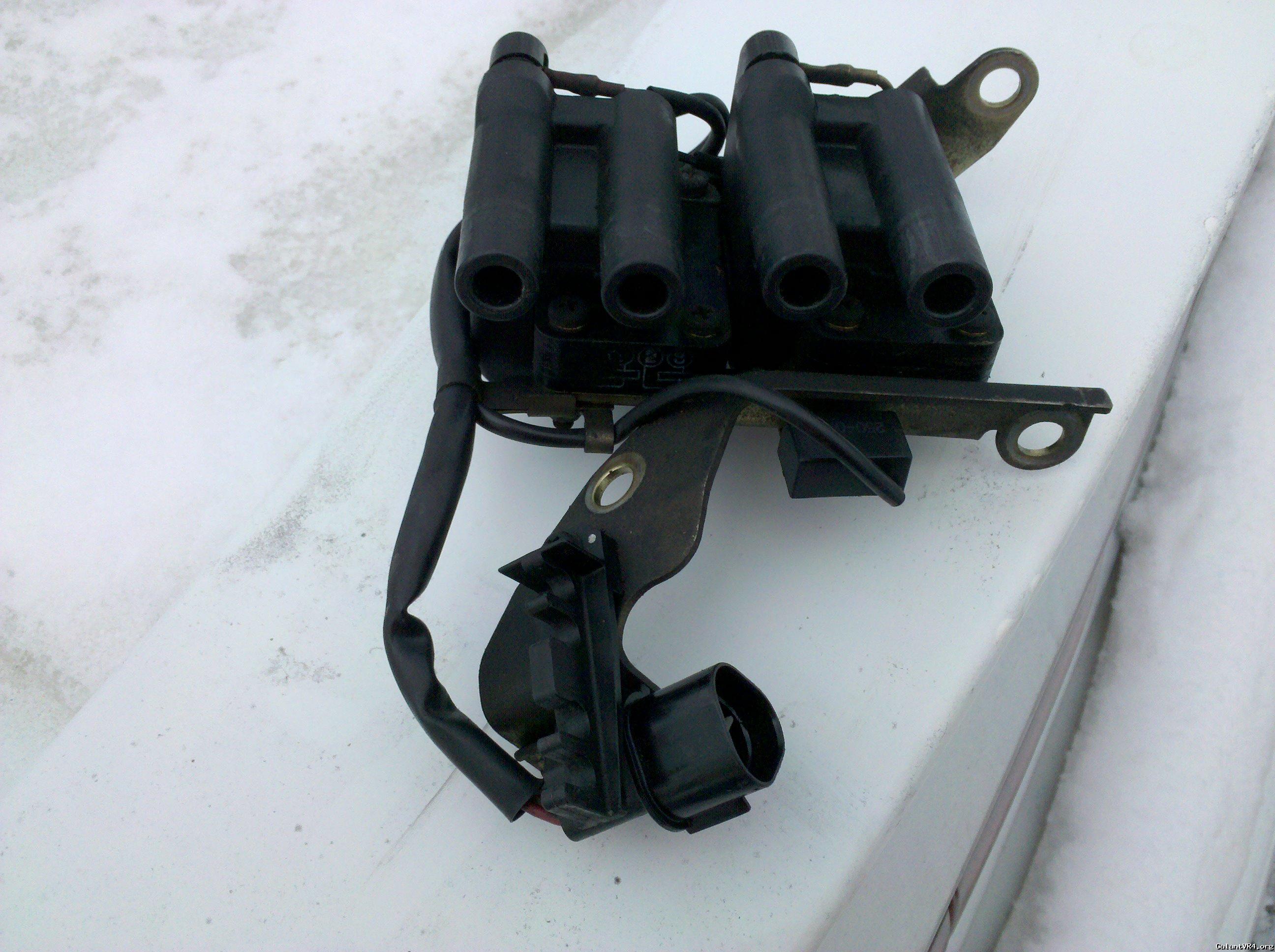

does anyone have a pic of a normal usdm 91-93 coilpack for reference?

Hey, i JUST had this problem....was drivin fine one day, went to "punch it", suddenly felt like a tractor. found cyl 1 & 4 no spark. Replaced PTU, still did it, replaced coil, boom shes her old self again...I got the USDM one off ebay for like 50. Oreilys and autozone sold new coils for around $118 A PIECE!!....anywho i have an extra PTU, if u need ill part w it...I have my old crappy coil pack too ill post pics of tomorrow mornin when i get off work so you can compare...idk if the coils are interchangable....like if you can piece together 2 coils for the number 2&3 cyls to make a good coil pack (i dont c why not) if you can ill part w my pack too if you want...lemme know. (When i say part with i mean some REASONABLE compensation would be appreciated) I had a DSM buddy also suggest CAS...however i swapped the one off my Talon so that helped a bit...
