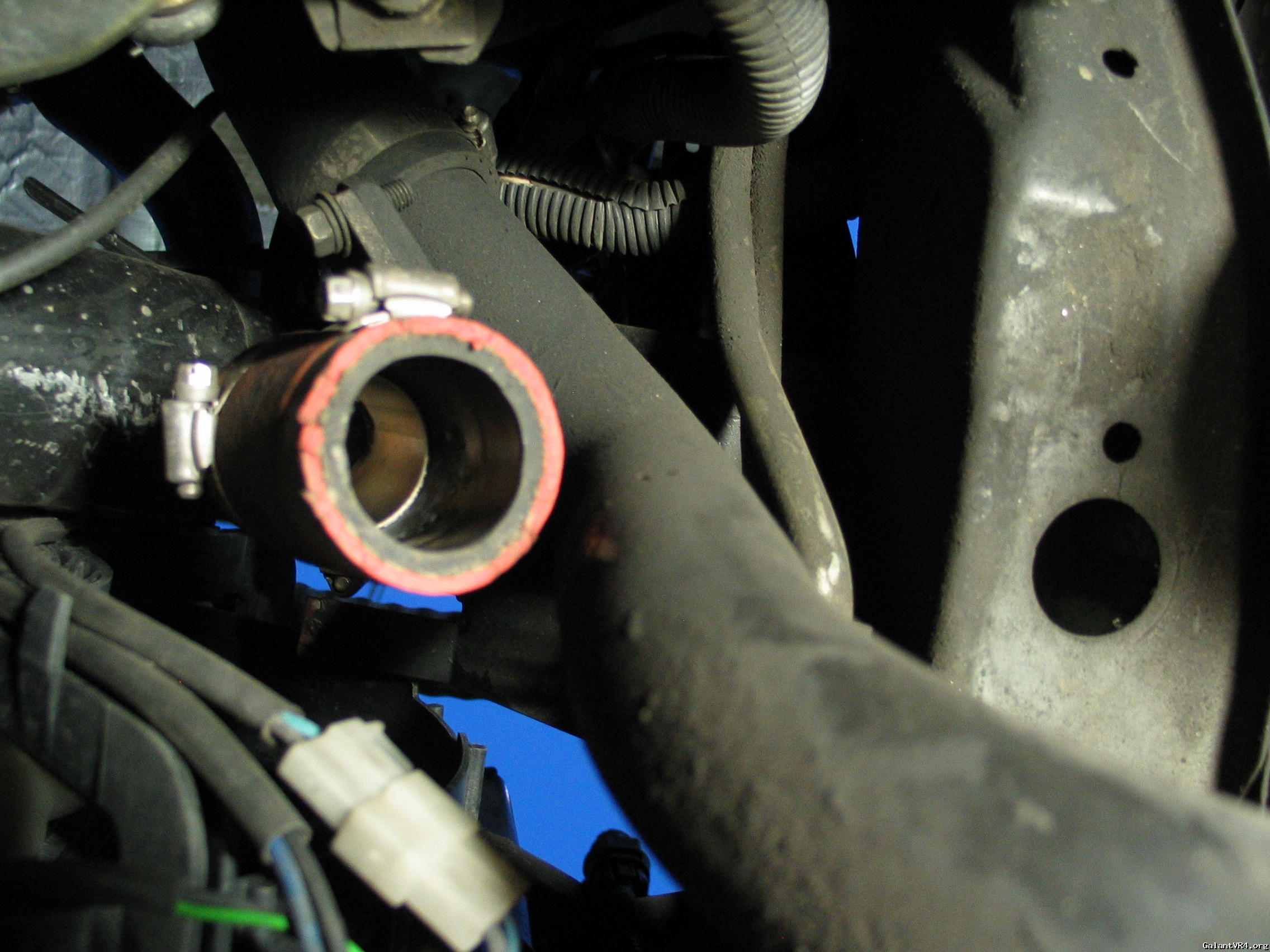

Hi all you guys, I'm very pleased with all your info and advice for everything related to my car. I drove my car back home yesterday back from the car shop and after work today, I jacked up my car and I found a plug that was missing at the rubber hose (see the Picture). I put that house on after I modified the turbo intake several years ago.I temporary sealed the hose and started it up, thanks all you guys, my car can start up having no problem. By the way the ECU I already replaced some leaked caps and one IC that for idle control couple years ago.
Thank you very much all you guys.
