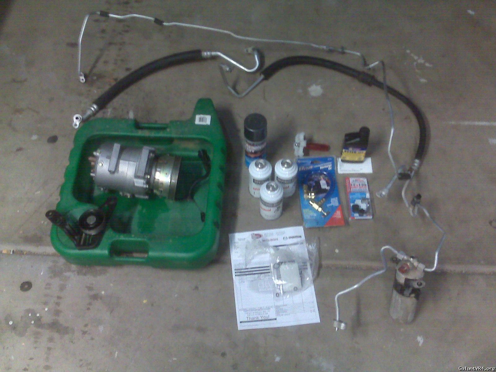

Here's the bulk of my goodies. Three cans of lighter fluid /ubbthreads/images/graemlins/uhh.gif, a bottle of ester oil (OEM compressors ship with Sunisio 5GS oil, a napthanic mineral oil - got it at NAPA since Autozone only carries the PAG synthetic stuff for R134 systems), fittings, hoses, new o-rings from the Mitsu dealer, and the compressor, draining in a pan. Not shown are the condenser core (I need to clean it tonight before bed) and compressor bracket (still installed in 195).

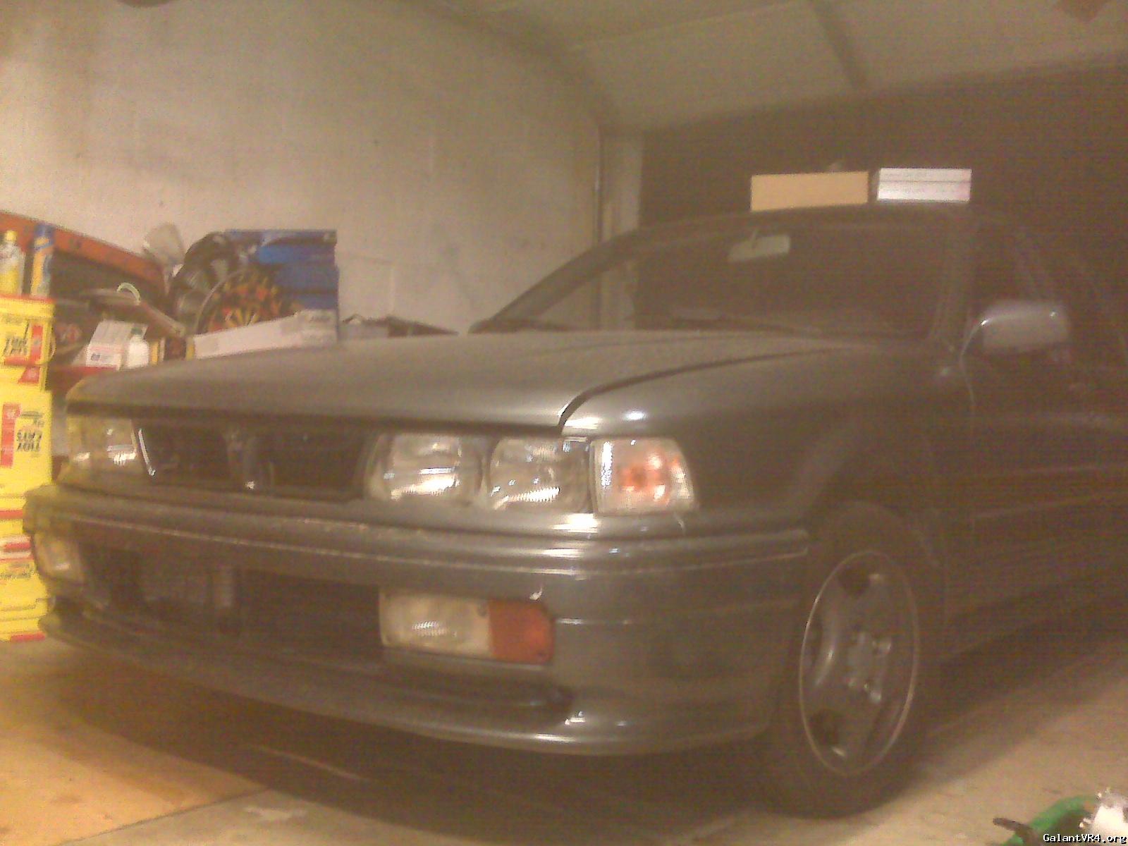

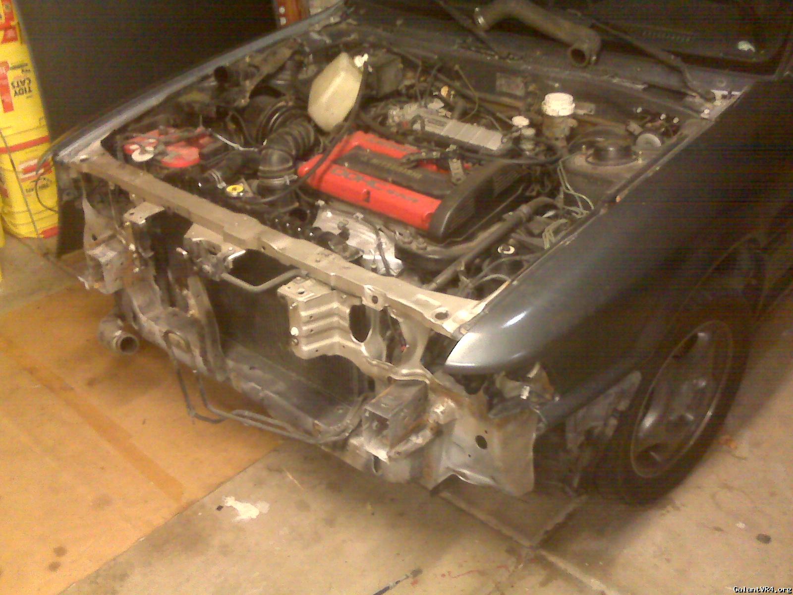

This is what I started with tonight. You can't really tell from the fabulous blackberry cam pics, but the grille is actually Belize Green. Ironically, the grille in 195 (which was Nile Black and is now flat black), was Summit White. Guess you could say I have love for all the colors. (But black is the fastest, right?) /ubbthreads/images/graemlins/rofl.gif

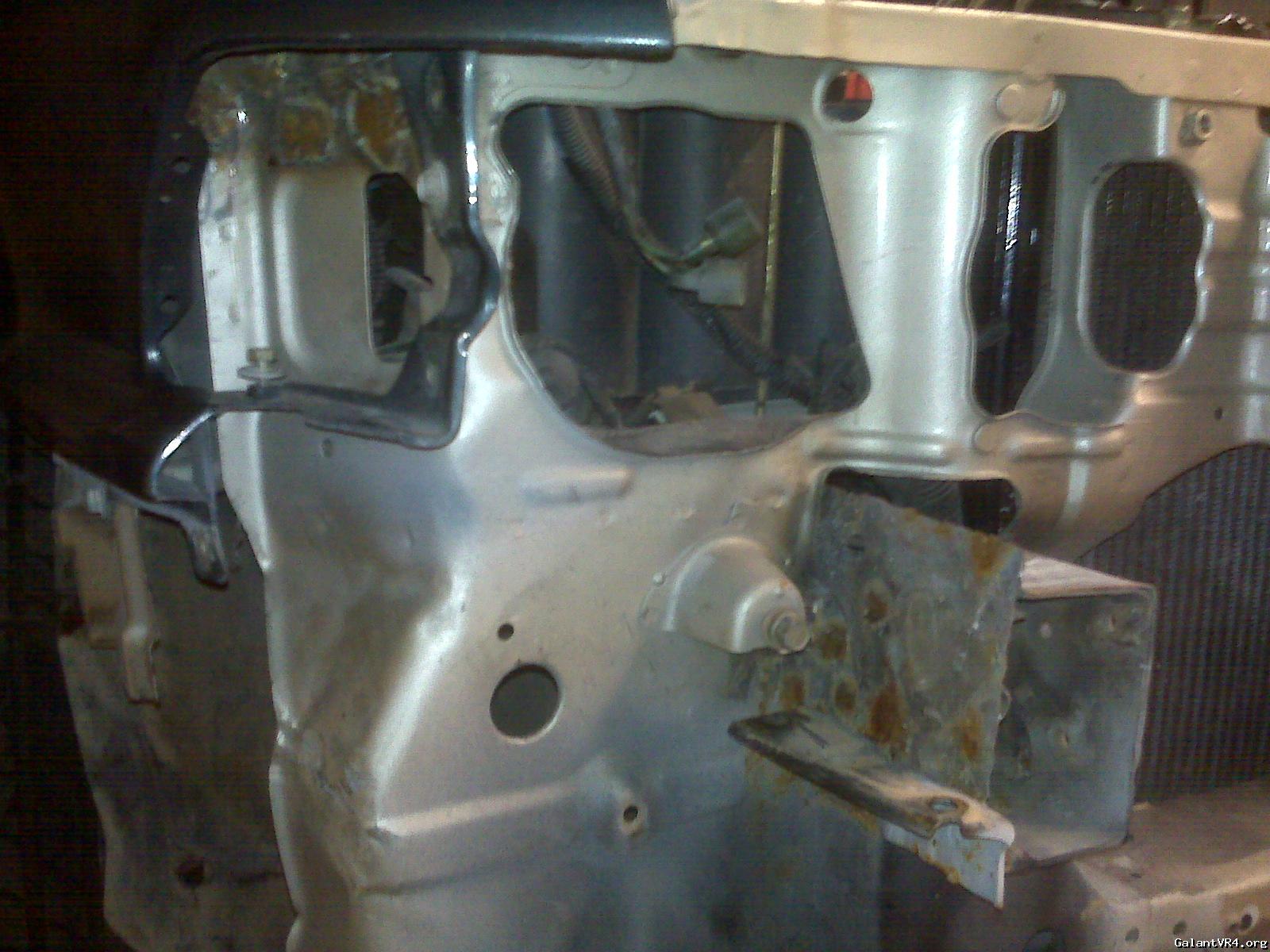

Detail shot of how the new core support was installed on this Galant. Notice the lack of paint on the welds, resulting in rust. I took a Dremel with a flap wheel sander bit to all the rust before spraying it all down with brake cleaner to degrease and clean it prior to paint.
It doesn't matter how clean I might get the engine bay, when the hood's up and you see the core support is a different color than the rest of the car, it throws up red flags. You guys might appreciate that this is what it takes to save a special car, but other people will see it as a hack job on a rice rocket buzz bomb. The champagne support has bugged me since day one.

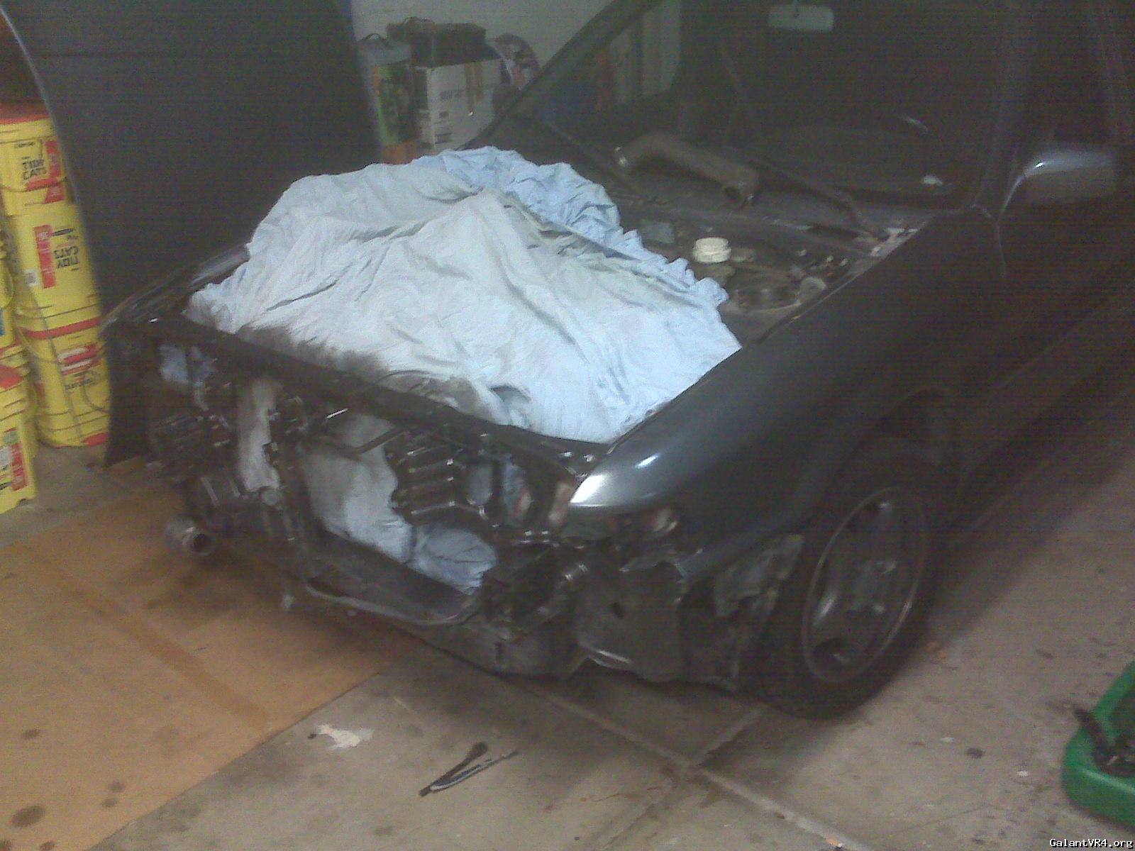

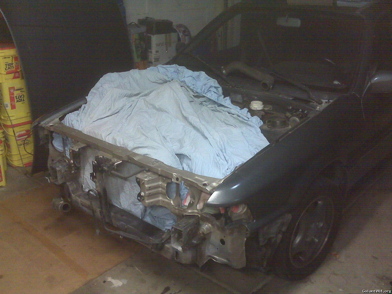

That said, if I'm gonna pull all the front end bits off to install a condenser core (and rewire my headlights), might as well do something about it, right? Here's a tip: Never, ever throw away your old bed sheets. Especially not the fitted ones. They are extremely useful when painting on the car, as well as packing or whatever. Just throwing it out there.

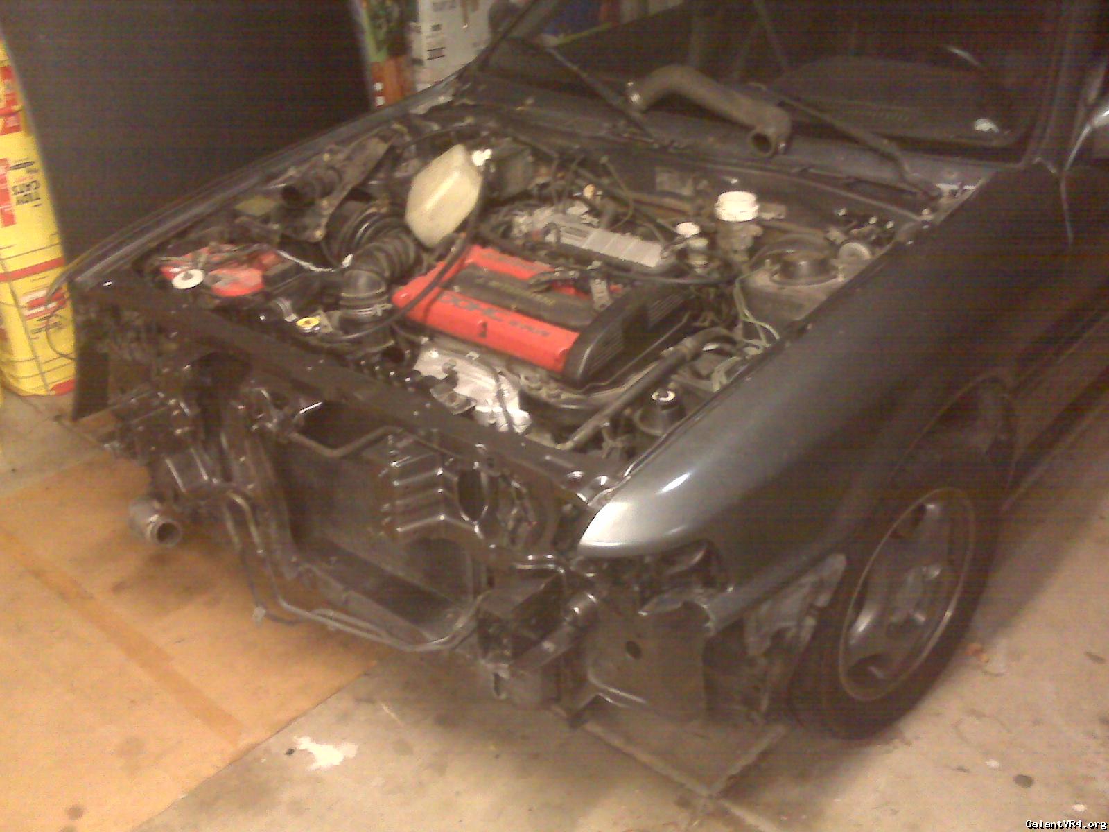

I used Duplicolor Truck, Van and SUV touch up paint in the spray can. Code is T299 "Dark Shadow Grey." It doesn't quite match the original Kensington on the roof (the only place it's left), but it matches the darker gray in the engine bay pretty good and looks a million times better than it did.
And here's the results. I'm happy with it. Very happy, actually. I can finally feel good about popping the hood and showing it off.

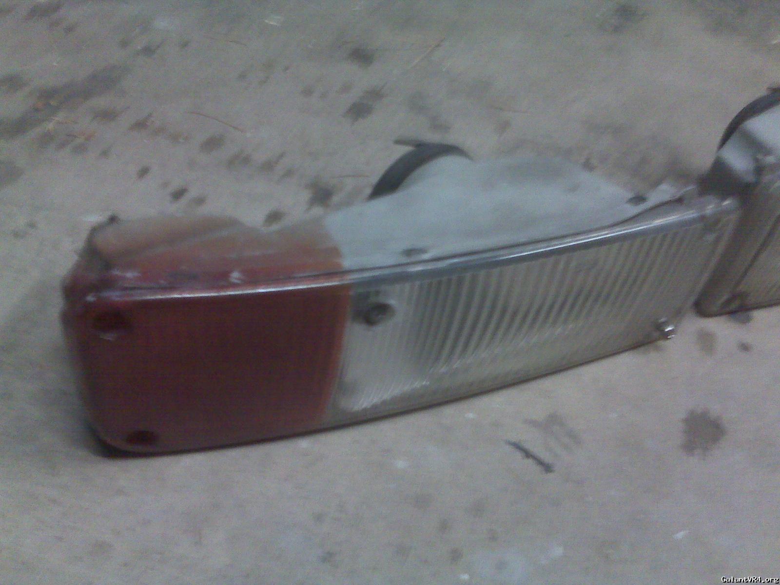

One more bit before I call it a night, check out the orange paint on my turn signals. Isn't that odd? They still have the amber lenses in them, so I don't know when or why this was done. Go figure.
