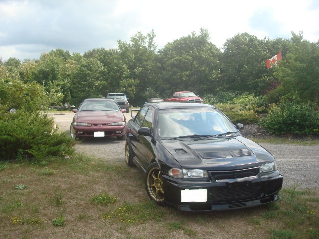

Hey guy and gals
New to the site, so thought I would say hello from Canada!
Don't own a VR4 but my Evo III is powered by a motor that was once in one. Does that count?
Make's pretty good power now, but plan to get it up to around 450-500whp by next spring and have a better power band. Going to be adding intake manifold and different turbo. Still looking into which way best suits my needs for a daily driver
Anyway's a couple pictures

Welcome to the board nice looking ride wish we got those in the states.

Nice looking car. Toronto eh? Nice. I'm in Buffalo and my brother is in Tonawanda. We always talk about heading up to Canada so if we are ever in the area I'd love to stop by and check her out or something!

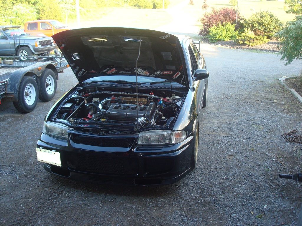

Story behind the car... Well it started off life in Japan where it was modified from nearly day one with suspension, intake/exhaust, chipped ect. It also had a crazy integrated GPS type system with a flip out TV right from the mid 90's. Computers, antenna's, and 100lbs of wiring harness.
Then I bought it about 5 years ago and imported it, and the modding began @ 61,000km or so. First motor made great power with some minor bolt ons until I broke a rod and it came through the block....... So then came a replacement Evo II motor (slightly lower compression but better for boost) so I put that in and ran it at 22psi all day long for 2 years and lots of track days. Ran like a champ but got tired over time and power dropped off
Well then I got bored of the power and started looking into building the motor to handle more boost, however being every 7bolt I came across had loads of crank walk and no permanent fix. So I decided to build a 6bolt, and that's when I stumbled across this click
So I ended up picking up the complete longblock, and since then have just been power happy. Its never enough....
Fully built/forged 6bolt
-Kelford 272's w/HKS Cam gears
-TD05 20G hybrid
-HAFE Exhaust manifold
-Full turbo back 3.25" exhaust
-Upgraded piping
-Tial 50mm BOV
-Tial 38mm Wastegate w/screamer
-Walbro 255LPH
-Fuel Lab regulator
-FIC 690cc
-300M COP
-ACT flywheel
-Exedy stage 2/4 Frankenstein clutch
-Devils own water injection
-DSM link V3
and more I can't think of
Handling/braking mods
Evo X BC coilovers
EVO IV Lower control Arms
Evo IV front hubs
Evo IV Front Sway bar
5x114.3 lug Conversion w/ARP extended studs
Advan RG 17x8.5 w/225/45/17 Rcomp Continentals
Brembo Blank Rotors
Hawk HPS pads
Rest is all stock Evo III trans/ transfer/ diffs

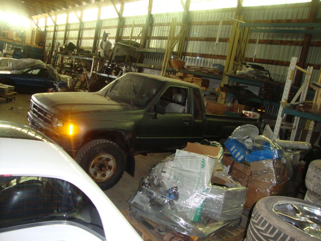

You mean one of thses Hilux /ubbthreads/images/graemlins/smile.gif
1986 LHD, 2LT turbo Diesel. Very rare truck, unforchantly I didn't have the funds at the time to restore it so I sold it to someone who had the only other LHD one I had ever seen in person. They were sold here in the 85 & 86 Model years. Very few sold even fewer are left. I bet less than 50 in the entire country and probably less then 10 still driven on the road

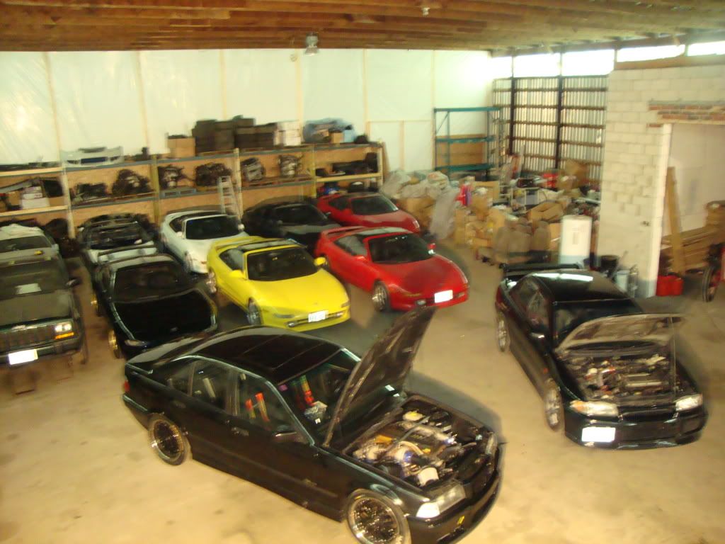

Any time your in the area, more then welcome to check out my shop/collection. I also have a built RHD MR2 Turbo track car, MKIV Supra, LT1 Powered Jeep Comanche street truck, and my brothers have a few neat toys as well including a Supra powered BMW E36 /ubbthreads/images/graemlins/smile.gif

Wow nice car man! The only two cars I was considering putting that motor in was a evo 3 or a conquest glad to see it made it. Super jealous of your car /ubbthreads/images/graemlins/wink.gif
Is that your workspace/barn?
Man - that is an awesome space to work on cars! Nice Evo as well!

Yes that was my old place. It was a pretty big. Big barn out in the middle of a field lol, had a work shop in there. It was to big though so in order to save costs I moved everything into a 1000sq ft shop. Much nicer place though for working on cars in the winter lol
Ill half to take some pics of the new place

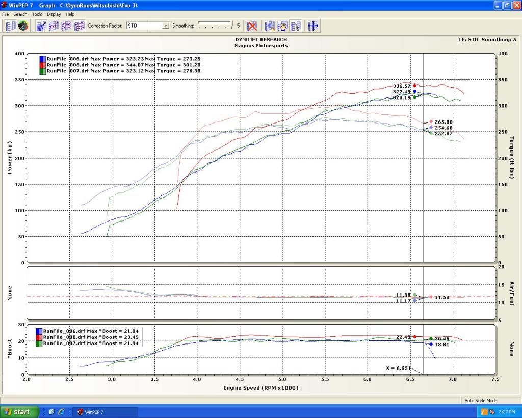

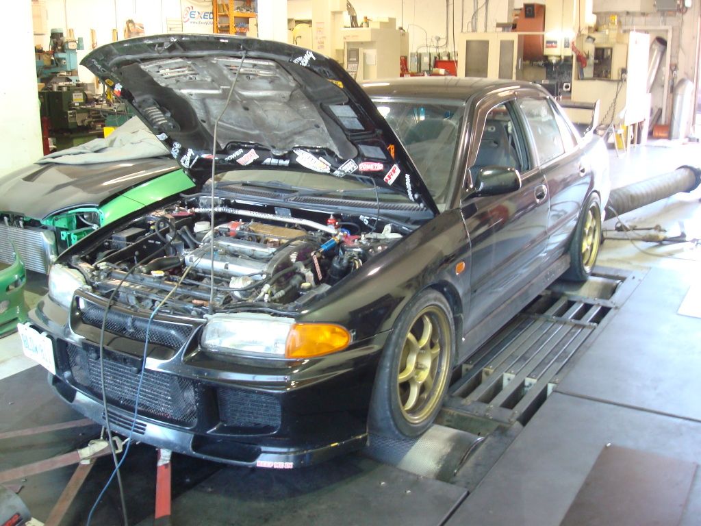

I would like to repaint it this winter also but well see I don't mind the character. Im more concerned about it being faster then my brothers car lol. I went to the dyno the other day. I had it actually running pretty good for street tuning it and learning as I went along with dsmlink. About the only thing I did was Leveled out my a/f's a bit and put down 344/301 to the wheels @21psi... Ran out of injector, still 650cc with 3gph water injection 50/50. So I got some 750's I am going to toss in there and 5gph nozzle and run 75/25 meth. That was also on 91 oct. With more fuel and more boost 4-5lbs Id like to get 380-400 at the wheels? I don't want to go over 450 just simply that I would rather spending money to get over that hurdle on another car and my current turbo won't get me there.
Dyno reads 2psi higher then was its actually.

As for the hilux they are super rare here nowadays. Like I said mine was only 1 of 2 I had ever seen in LHD in my life. Original Canadian Truck. When I saw it I had to have it. But here they call them the Toyota Pickup here lol. But you could get a turbo diesel in those years here in Canada with a 5 speed. Were not very popular. Slow as balls, always started and never stopped. Body falling off could still go anywhere. And if you could find one it is legal for import into the states. When I was selling it I had people from all over the world calling me for a rusted out 26 year old truck all over and wanted to ship it to south america lol

I like that dyno plot. Pretty dang linear, nice broad torque curve. I imagine it's good fun.
