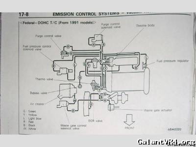

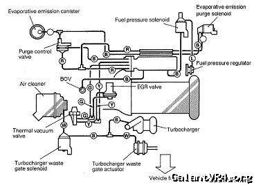

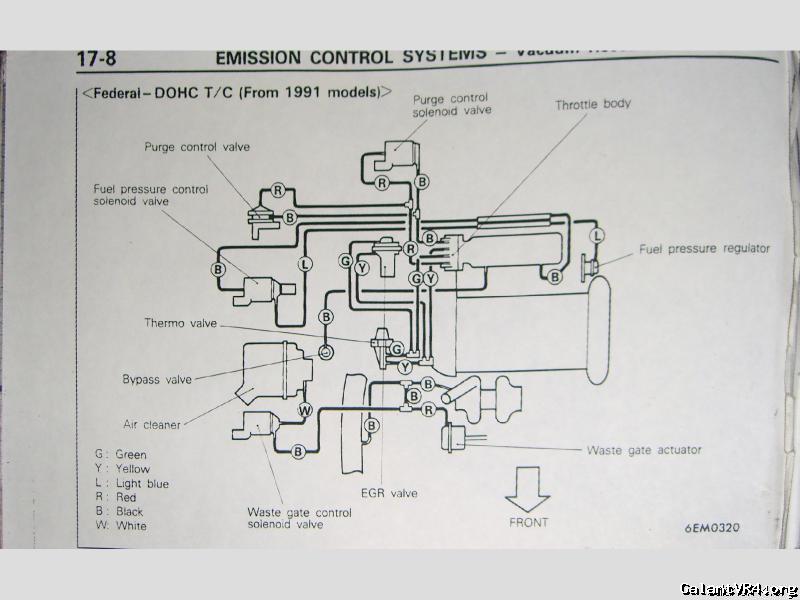

Heres a Vacuum line Diagram
and i believe the vacuum line ur talking about (comes out of the valve cover side of the intake mani, about midway) goes to the BOV...Hope this helps.
