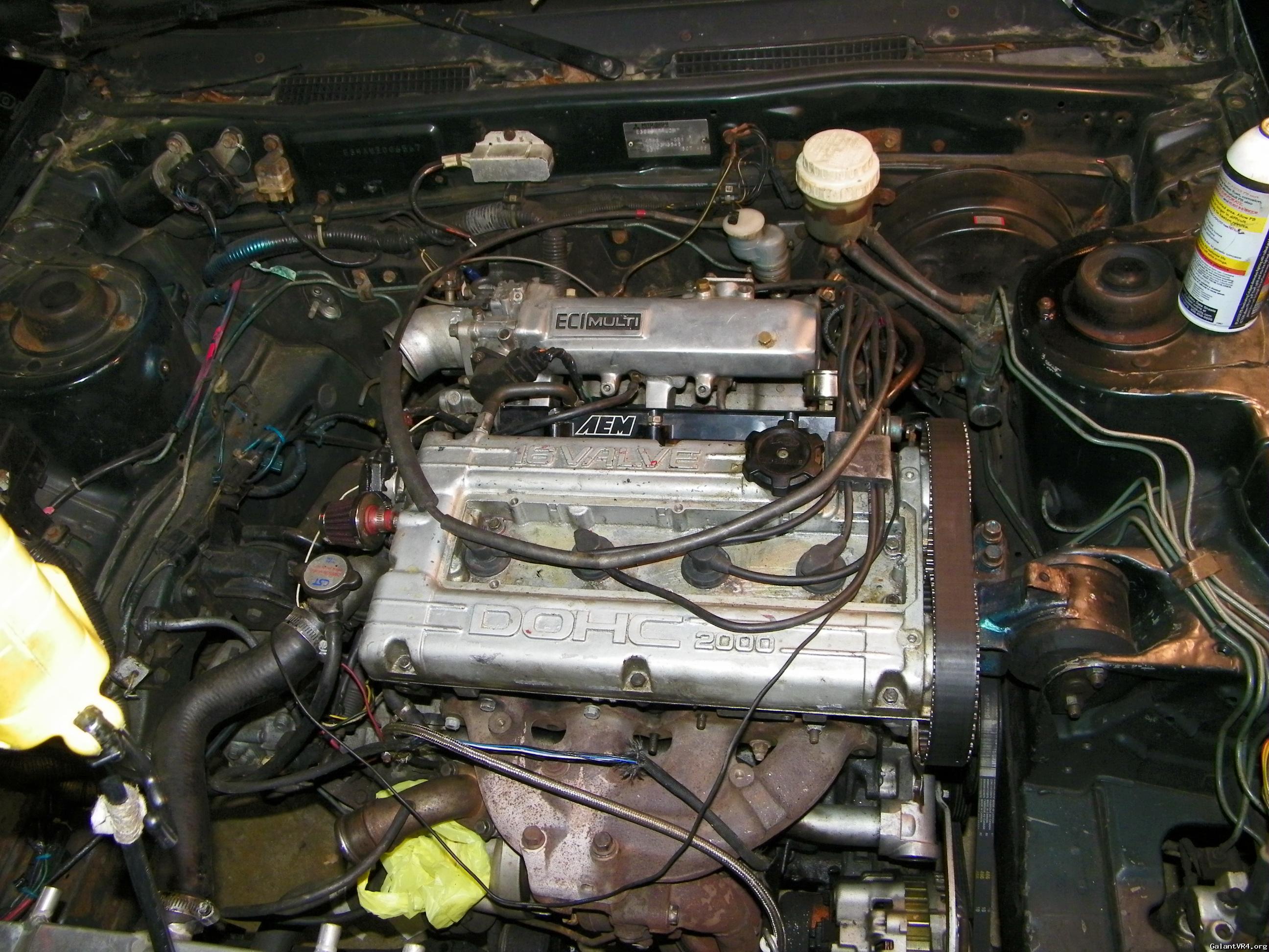

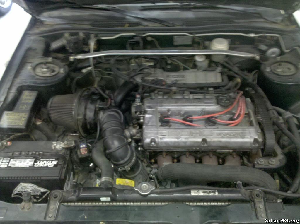

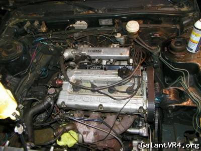

Enough with the introduction, here is the car I got myself into.
Mods
Small Evo III 16g
Evo III exhaust manifold (can anyone verify this?)
650cc FIC injectors
AEM Fuel Rail
2g intake manifold (can anyone verify this?)
HKS throttle body
2g Short Throw Shifter
Battery Routed to rear
GM MAF with Translator
HKS Blowoff Valve
Tubroback 3” exhaust
ACT XX00
Aftermarket FMIC
No intake, turbo is open
AC Deleted (only compressor)
ABS Deleted
Power Steering Deleted
No Cat in exhaust

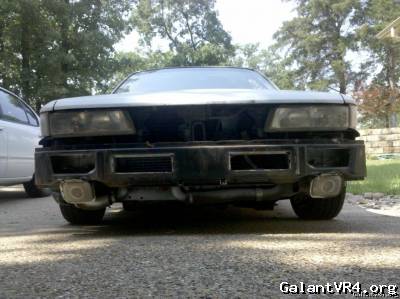

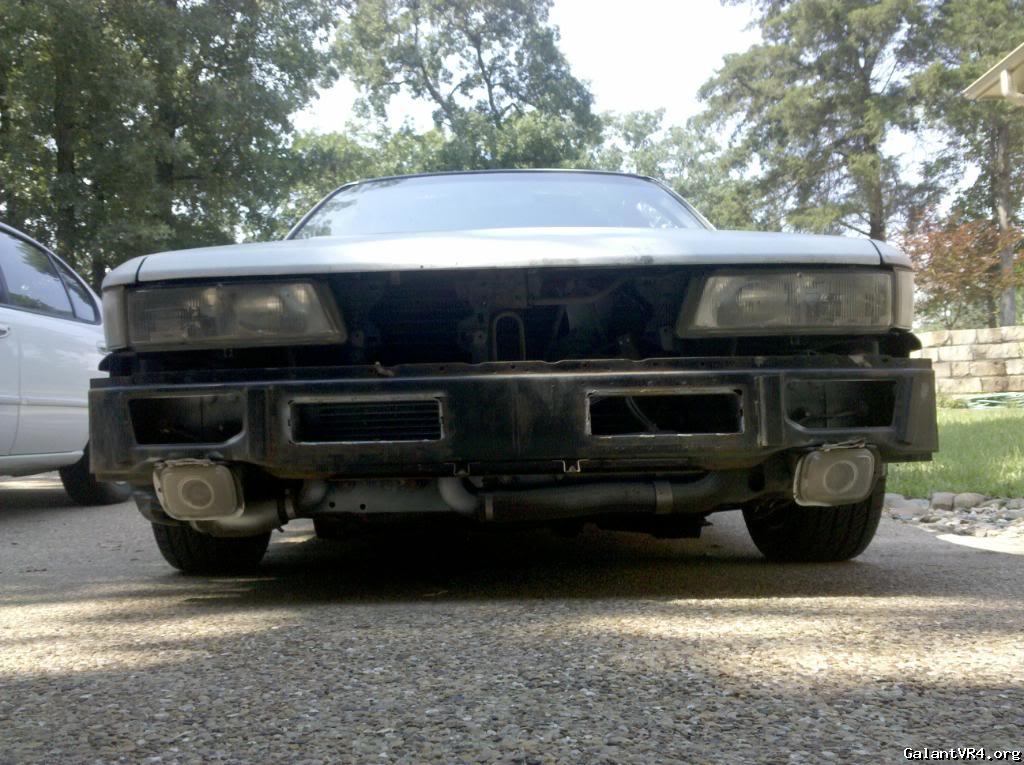

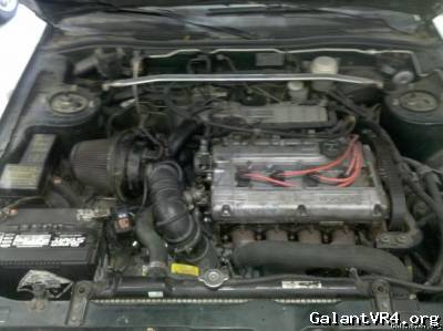

So this is what I’m working with…along with 4 rims that don’t fit the car….also when I picked up the car, noticed at home that my boast controller was missing /ubbthreads/images/graemlins/frown.gif also the rims he swore he put on that fit…didn’t. He left the caliper disconnected so it jammed up the rim locking my front axle. From the trailer to the garage took an hour and half thanks to this problem. Worse part is running a CarFax revealed this car was in an accident in Queen NY in 2003..and a mileage was disputed. Car went from 180,000 to 130000 in two years /ubbthreads/images/graemlins/frown.gif.
I know it’s not perfect, but I can’t be picky with my budget. I am not looking to cut corners, just make a fun DD out of it. The recent picture is the most recent one after I removed certain parts that where not secured down properly. With a friend We decided that in order to use the turbo and injectors that I would really feel comfortable using something like DSMLink. Since I cannot afford that now, the plan is to convert the car to stock and drive it that way. I was given everything stock, minus the 1g MAF with Belize was nice enough to give me at an amazing price..so thank you.
I also want to add the power steering back...all that was done is the pump was removed, so there is no mechanical advantage. So it is INCREDIBLY hard to move.
Let me know what you think of this plan. I'm hoping with this approach I can not worry about a tune and just drive the car real soon to find what other problems are hidden. Any comments, suggestions will help. Thank you

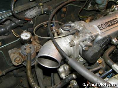

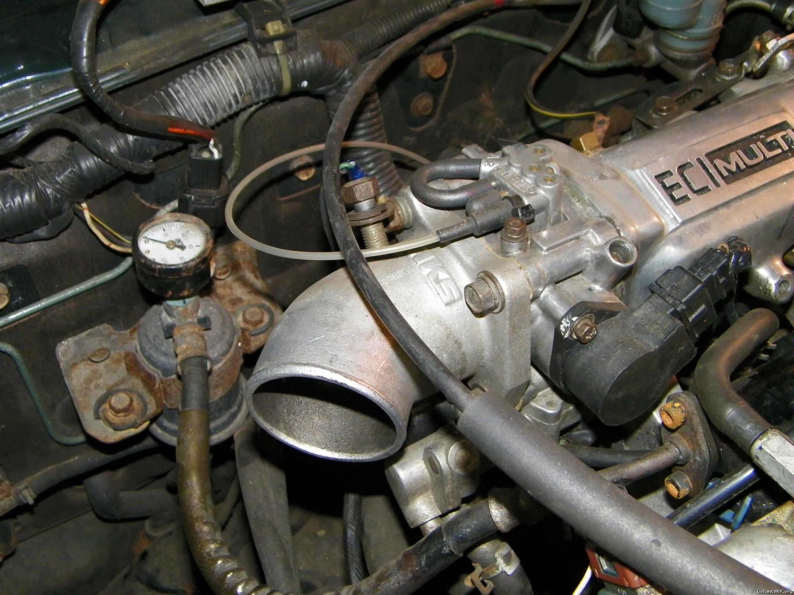

Here is list of problems I've noticed in the car, and could use some advice.
1. Can I run a stock tune and injectors with an upgraded fuel pump? I apparently an upgraded fuel pump, do not know which one though.
2. Throttle body and Intake manifold have many screws in them plugging holes, does anyone know the reason?
3. Power steering pump was removed only. Is it as simple as just finding and re installing pump? What do I need to look for?

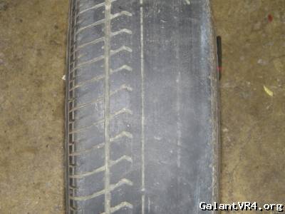

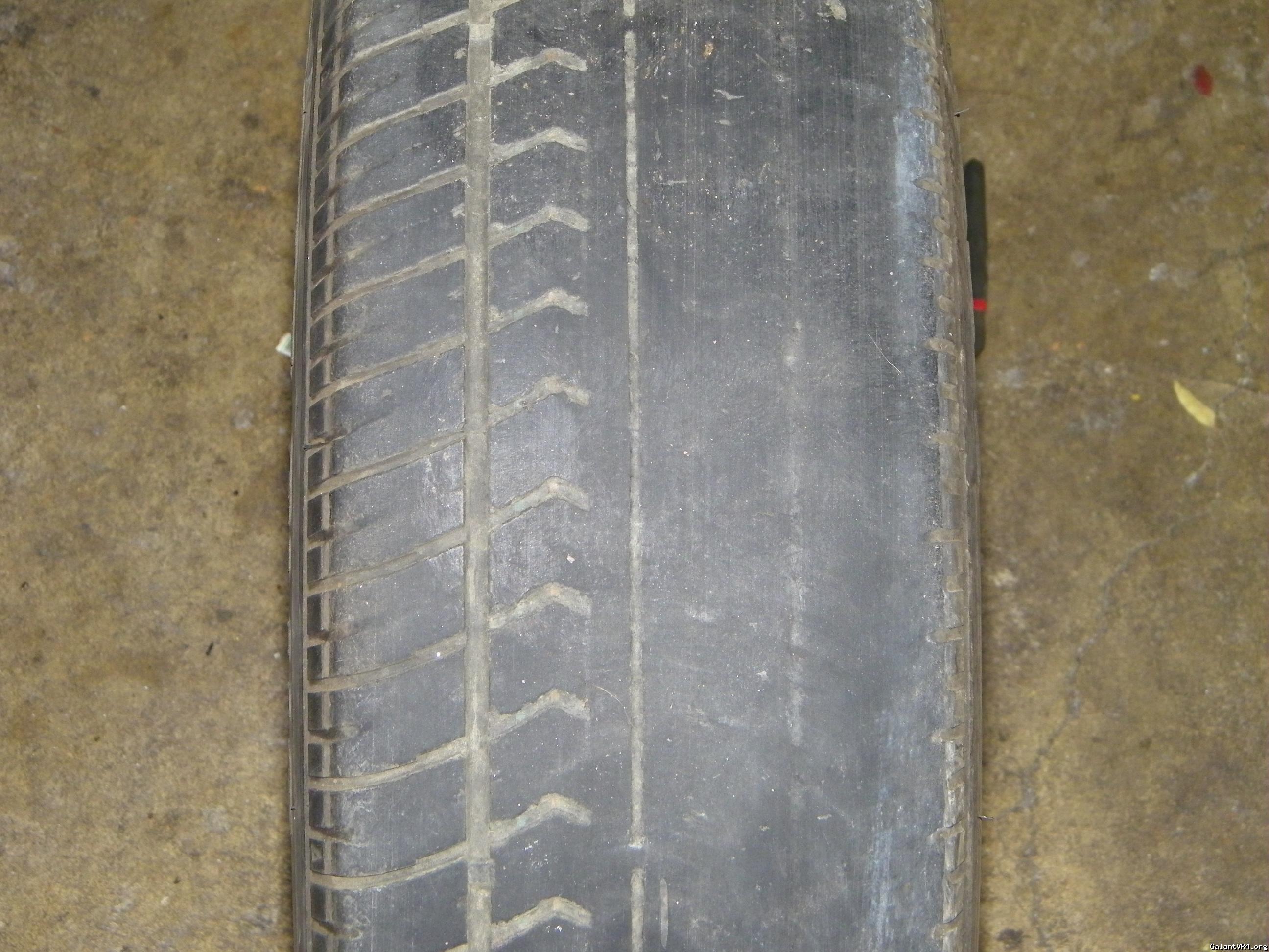

4. Rims are from a nissan and don't fit...but one side sat crooked. Below is the tire that was on that rim...if the car did cause the rim to be crooked and ruin the tire, what should I look for?

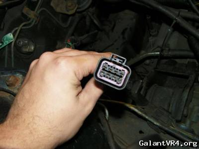

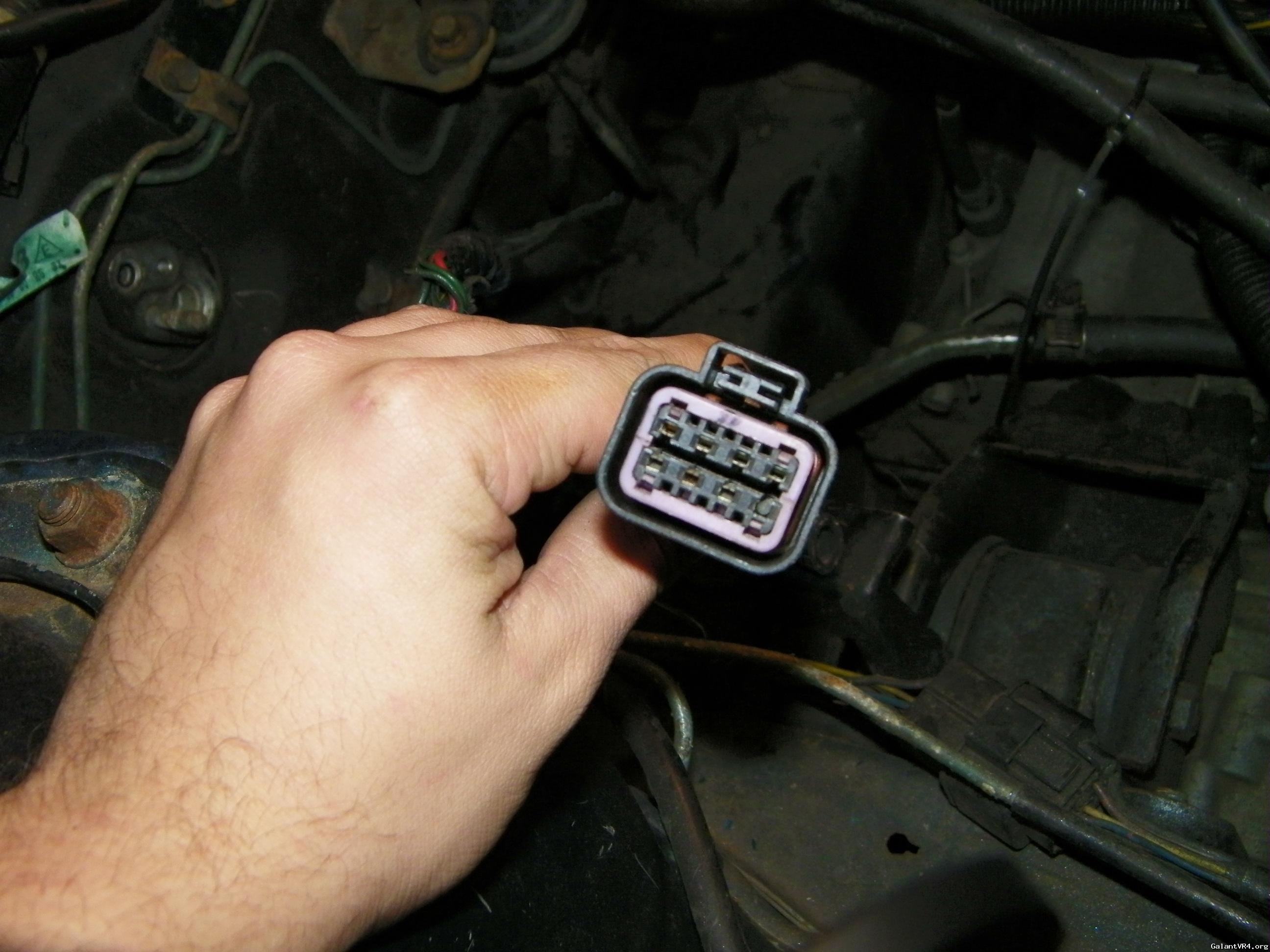

5. Is this a 1g connector for the MAF? Going stock I will be using the original 1g MAF.
6. Anything else I should look at in general?
fuel
Feb 23, 2009
2,166
Toronto, ON, Canada
if that's a 2G inlet manifold, make sure you are running a 2G head otherwise the port sizes are going to be mis-matched between the inlet manifold and the head.
dsm10o0
Jun 16, 2010
685
San Jose CA
The intake manifold is the stock one. They just shaved the lines.
good luck one this car man.
rgeier11
Sep 26, 2004
726
Chicago Suburbs, IL
Okay, some things I have noticed.
1)The car does not have an ABS delete. I can see the ABS pump near the front driver's side headlight.
2)Those vacuum lines at the throttle body are OK if recirculated to each other or plugged off. One of them, I see, is a plastic line. This is more than likely the line that goes to the back of your boost gauge. Use this guide to tap it at the fuel pressure regulator vacuum line. This will give you more accurate boost readings as well as a cleaner engine bay.
3)Don't worry whether or not it is an Evo III exhaust manifold, lets try to get the car running first. Besides, the difference between it and anything else is negligible.
4)Remove the 650cc injectors. Keep them since they will be great once you start to up the boost and have a way to tune them. Install some stock 450cc injectors until you have the knowledge to go faster. These will cost about $50.
5)Remove the GM MAF and Translator. If any original wires have been cut in the car, be sure to reconnect those with solder or some sort of wiring connector. The Translator and MAF can be reinstalled again after getting the car back in running condition. Yes, that is a 1g electrical plug for the 1g airflow sensor. You will need the MAF can/air filter/snorkel that leads to the turbocharger (about $45).
6)Remove the HKS blow-off valve. Install a BOV that can be recirculated back into the intake tube that you should buy in step 5, such as the original 1g BOV ($15 and holds 20psi unmodified).
7)Power steering. More than likely, he removed the power steering because the rear power steering lines were leaking. I would not worry about this problem until you get the car running and driving. This is more for comfort than necessity, so let's focus on you getting down the road.
8)Brakes. It sounds like they were just removed to clear the shitty rims. If you do not know what parts you need to get the brakes back together, just post here again. Odds are, you will at the least need to lube up the slide pins since it sounds like this car has been sitting awhile.
9)Front mount and piping. Obviously, secure the front mount as best you can. Find some metal strap at ACE hardware or Home Depot along with some bolts that fit into unused holes in your car. The piping will need to be dealt with if you are going with the 1g BOV I talked about in step 6. A proper flange for the 1g BOV will be needed. You can get piping from just about anyone on here. A whole factory piping kit with the original intercooler is probably under $100.

Yes you can run everything stock with an upgraded fuel pump, but depending on what size the pump is you will probably exceed the capabilities of the factory fuel pressure regulator (you will run very rich). You would be best to fit an adjustable fuel pressure regulator to keep things under control.
It doesn't appear to be a HKS throttle body, but the removable throttle body elbow. I don't think the stock US VR4 intercooler pipes will fit it.
I don't think you can identify a 1g vs 2g head without taking bits off /ubbthreads/images/graemlins/dunno.gif
Nissan wheels wont fit, their center bore is smaller than Mitsubihsi (66.1mm vs 67.1mm). That tyre looks like it's had too much camber, I guess you could have the same effect from a wheel not being fitted propperly.
Doesn't the steering rack seize up if you just remove the P/S pump?!

^ What do you mean remote location? That brake fluid reservoir is in the stock location. You can run a Power rack with looped lines or as a dry rack. The dry rack version is pretty hard at first, but gets easier with time.

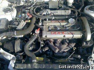

Except that DSM and GVR4 IC pipin is different off the turbo....The DSM has a Jpipe that routes down by the rad while the GVR4s pipe routes off the turbo, over the exhaust mani, down by the driverside headlight, and across the front rad support to the IC...the Talon is a smic while the GVR4 is a kind of fmic...stock that is.
My gvr4
You can see the IC piping along the bottom run up to the IC placed behind the L hole in the crash bar.....

Hey everyone, first off thank you all so much for all the help so far! This build would be taking so much longer with out it!
So here’s the updated on the progress of the car so far. Thanks to my good friend Throughfaith here on the forum (we go to school together) I got a ton of stock parts!
I mounted the I.C. and noticed that the frame has quite a large ding there..probably from the accident in 2003. I was able to use 2 out of three mounting holes which will do for now. This is just a temporary set up, but it is very secure. When I install the FMIC that came with the car I will make sure to properly using every mount possible.
I am using the J-pipe that came with the car but fabricated an intermediate piece between the turbo and pipe so I can use the stock I.C. piping.(when I get pictures I will show the piece) Also have installed all the stock piping and secure them using most original bolting location. A few parts near the bumper were altered for previous FMIC which gave me more work to make this work. Stock BOV is with the set, and a rubber adapter was used to from the stock piping to the HKS elbow. I don’t’ know how well this will hold up to the pressure or if I will have a leak from it.
I now have an air filter! Also a 1g MAF and stock aircan with all the stock intake piping installed instead of an exposed open turbo /ubbthreads/images/graemlins/smile.gif
