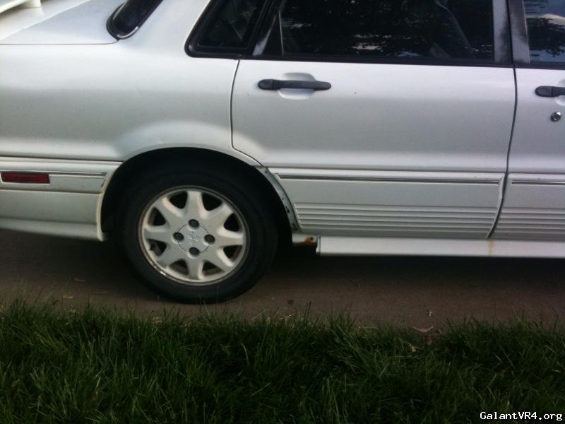

One last thing, sorry for all the questions. I have a problem with the wheel camber on one of my rear wheels causing the tires to wear extremely unevenly wearing out the inside edge. Is there an adjustment somewhere where I can fix this?

4) shaking and your worn wheel are quite likely the same issue, unbalanced/uneven tires cause all sorts of shakign/noise at speed. Do you have aftermarket suspension of any sort? On that note, what's this car all about, what are the relevant mods for these q's?
