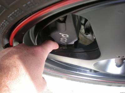

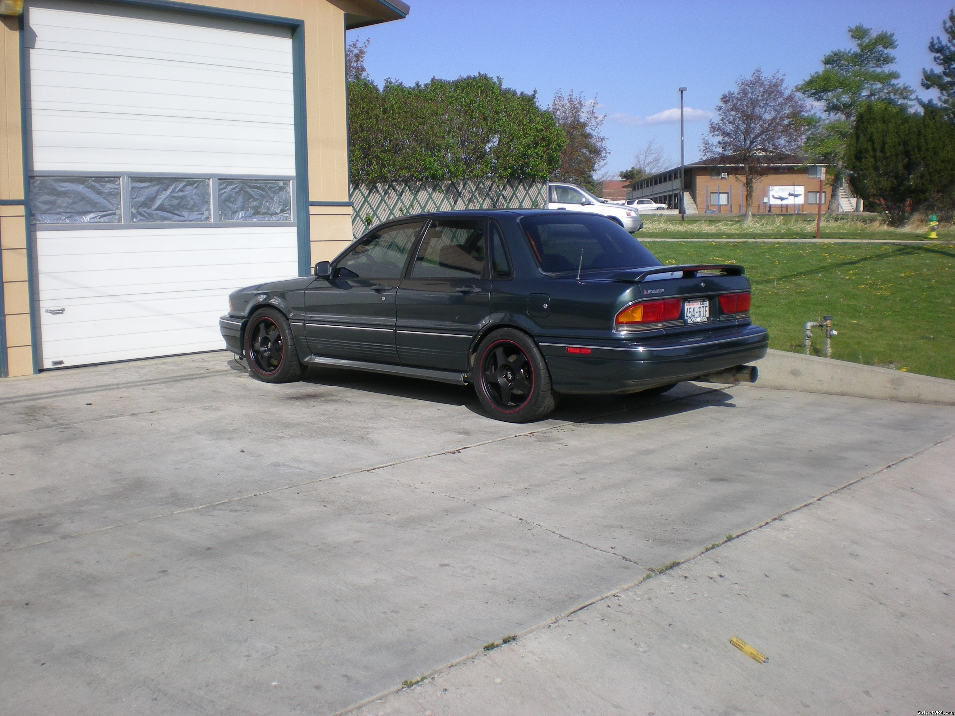

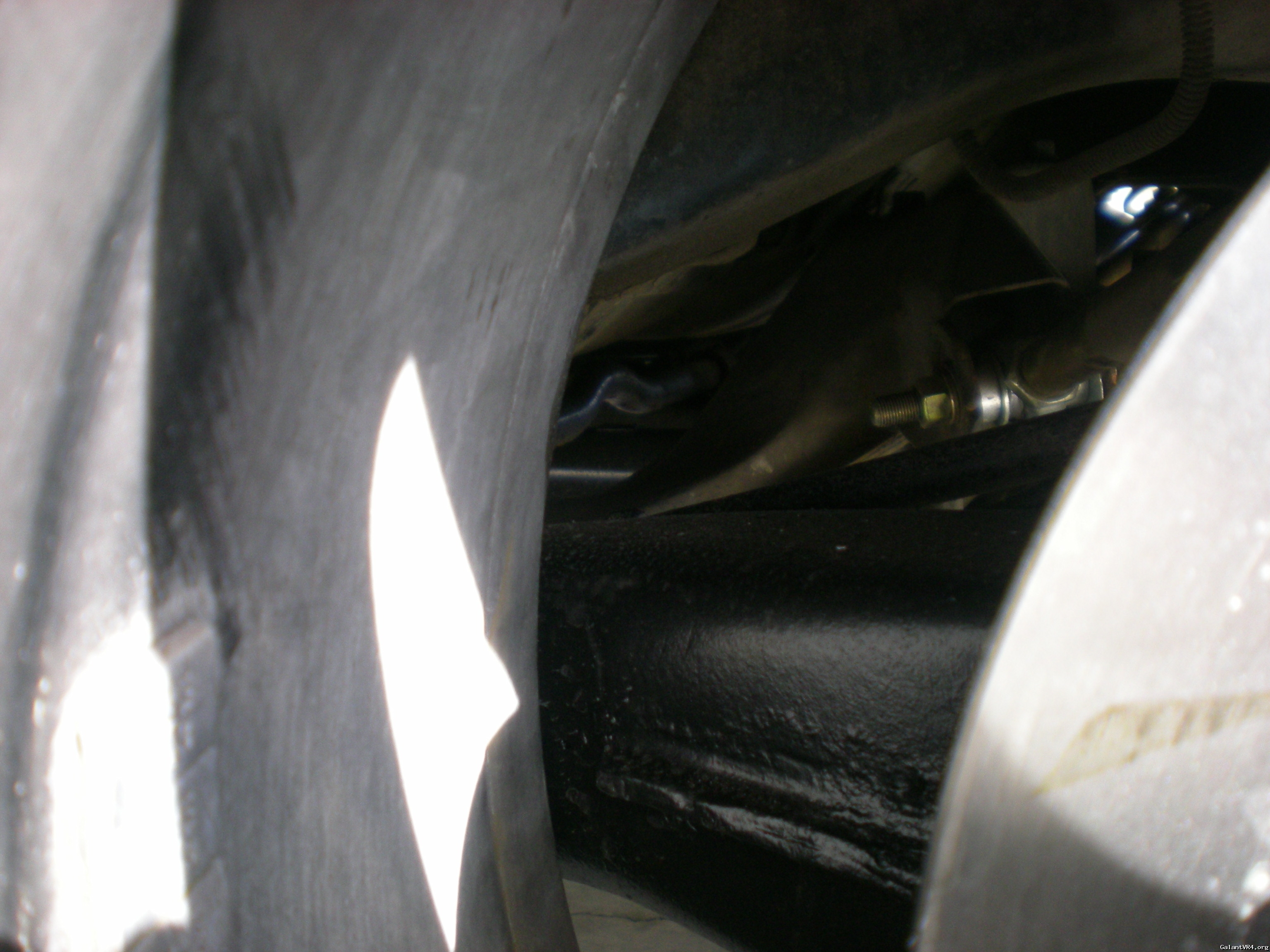

These are the galant's new wheels and tires. Specs are 17x8.5 @ 48mm and 255/40 falken azenis. This setup is from an STI. First of all, this setup doesn't work without some grinding and welding in the rear similar to what Luke did with his RX7 wheels. I have yet to start the car and test drive it or check full lock and bump rubbing in the front. Right now with the lip ground off the lower arm in the rear The car will roll, but I think its too close for comfort, so 5mm spacers will be used.

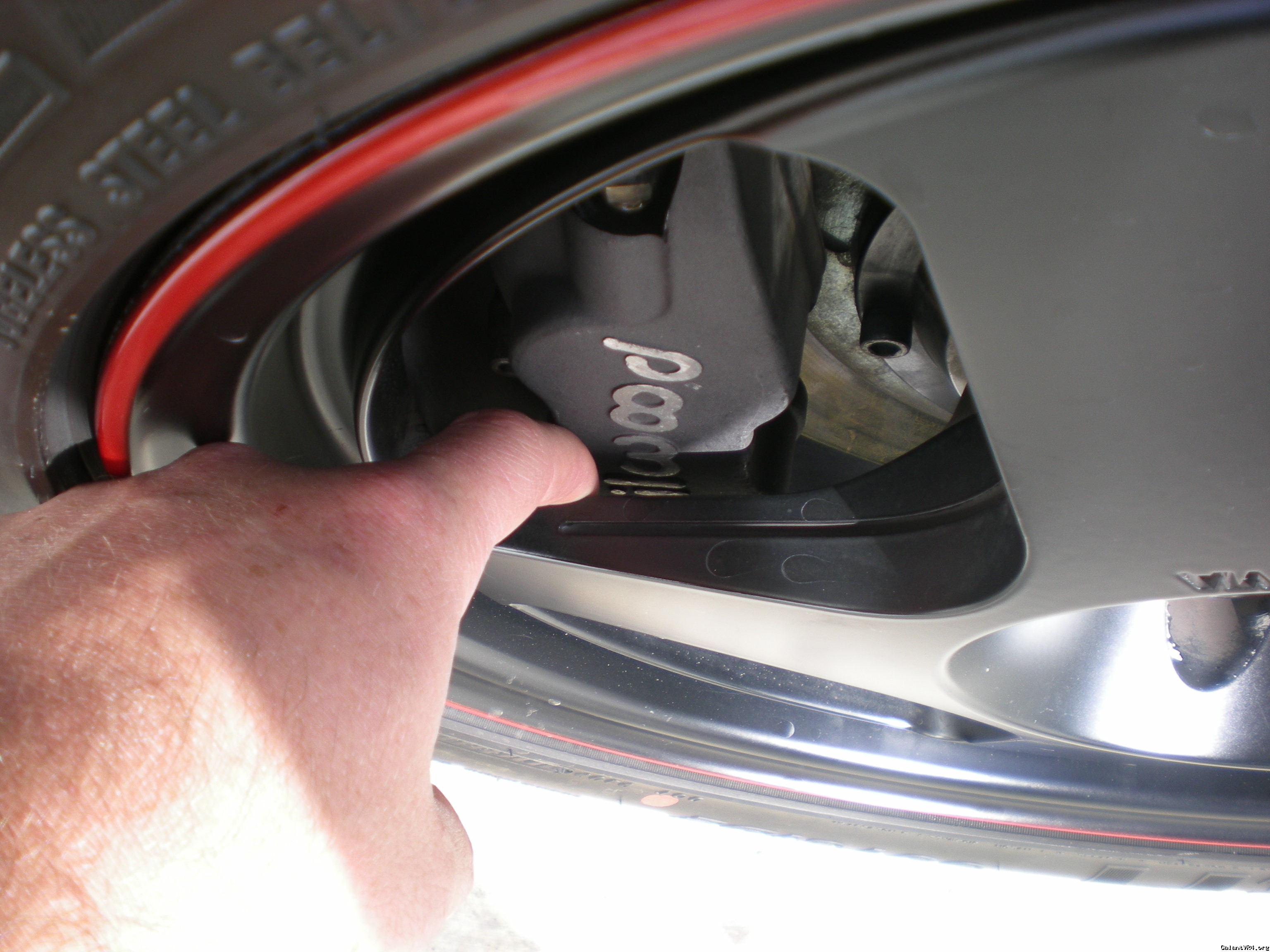

In the front my camber is maxed out on the plates, but I have my camber bolts full positive so that the wheel/tire don't rub on the lower spring perches on the coilovers. Miraculously these wheels clear the wilwoods with room to spare. I'll post more about this setup later once I actually drive it and make sure everything is perfect.

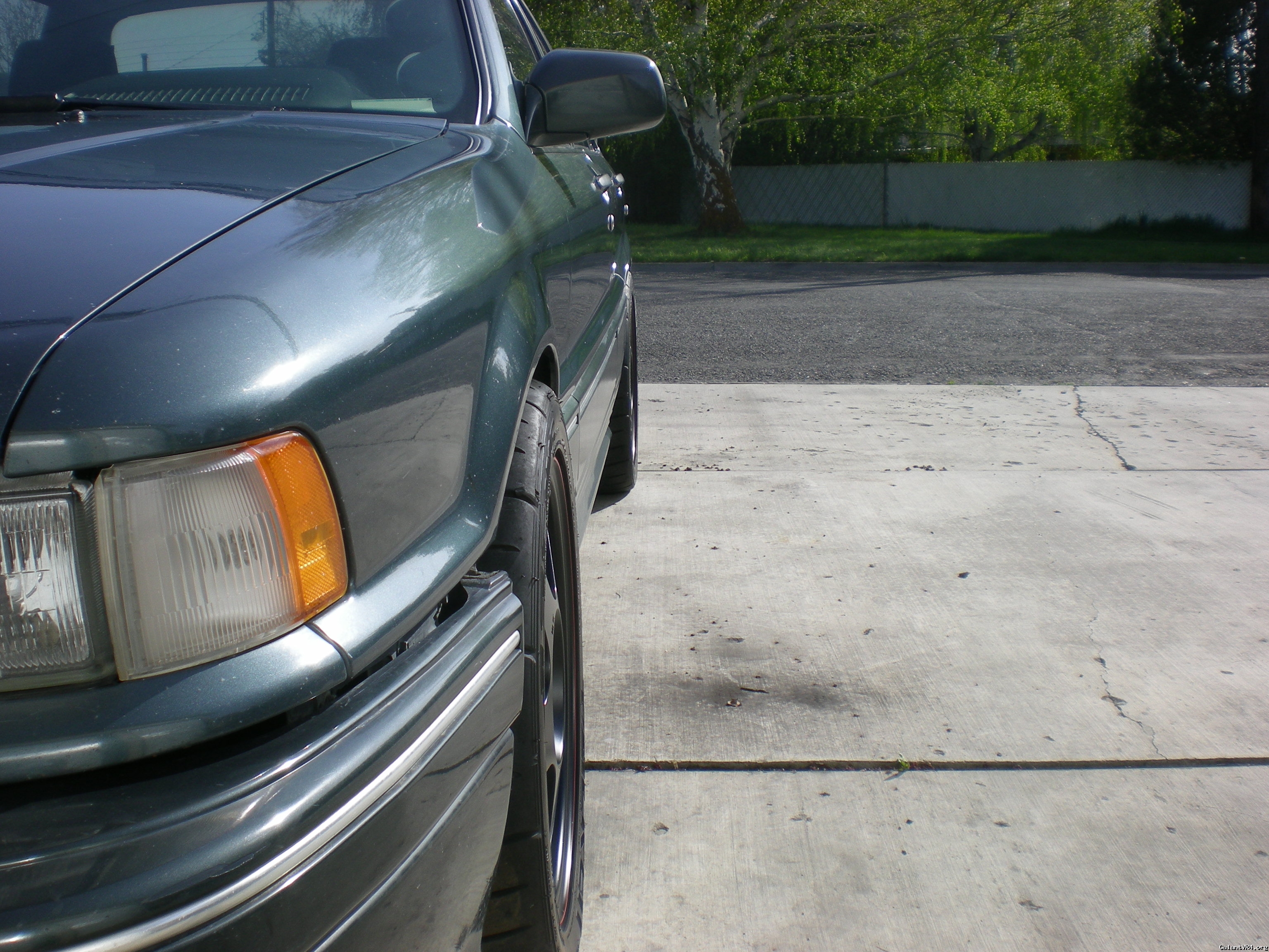

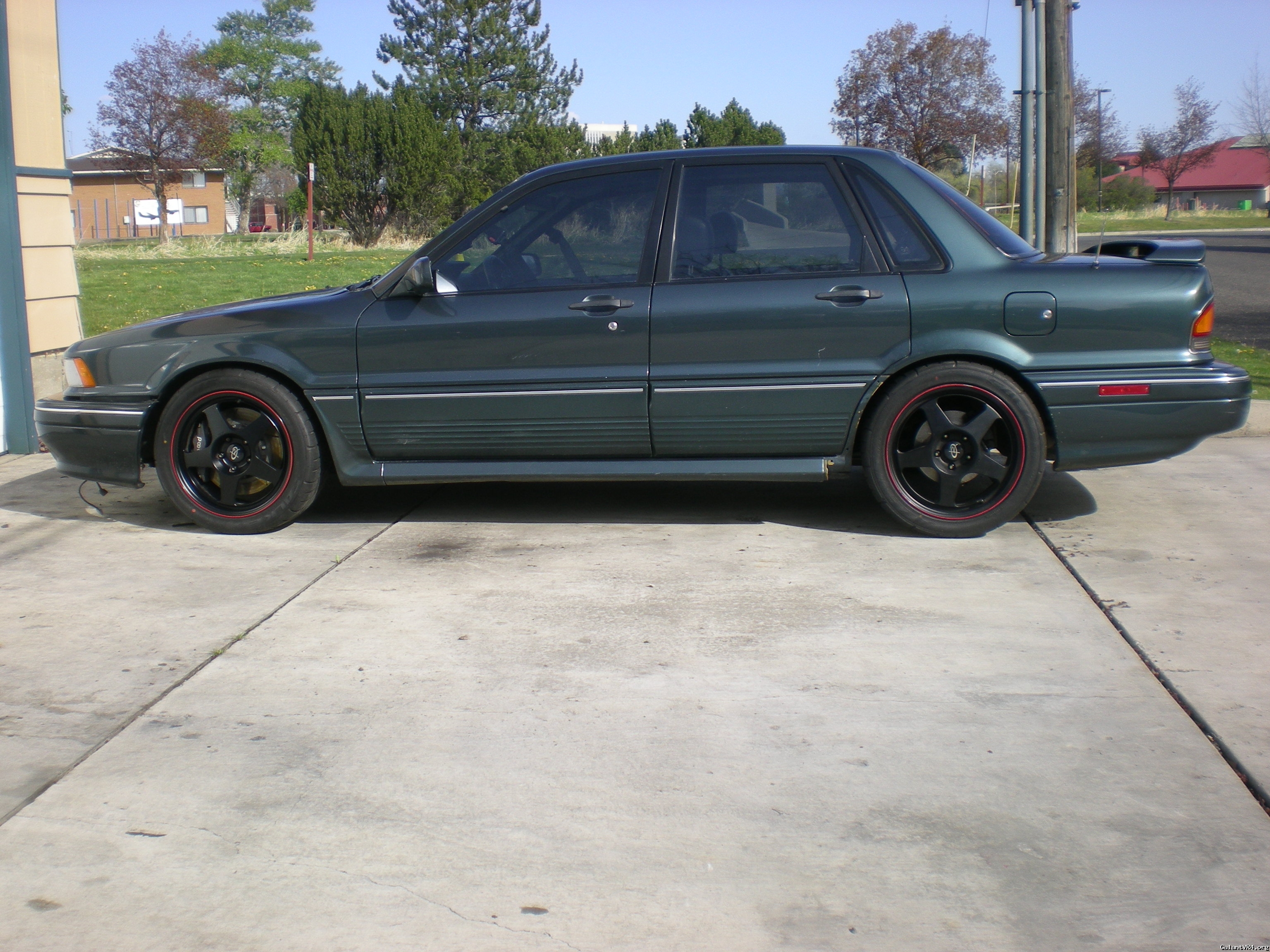

/ubbthreads/images/graemlins/applause.gif The front tires stick out less than the 245/40R17s 17x8 38ET do on my car.
That rear trailing arm clearance is a little sketchy but with the 5mm spacers you should be good to go. Plus you'll even out front and rear track a bit, which isn't a bad thing.

that seems like it really shouldn't fit but it does and looks pretty sweet

I put on some H&R 5mm spacers and everything seems to be ok. So far I haven't had any rubbing in the back. The front sounds like it rubs on the inner fender area at full lock (I never go full lock anyways)
So, for an 8.5" wheel the back needs to be close to a 40mm offset and some minor lip adjustment on the trailing arm.
The front should probably be more like a 40 or 44 offset. 48 is too high, but will work. Eventually I need to get some spacers or a different offset wheel so that I can get some more camber in front.

If its a good deal do it. The car sticks like glue. So far I haven't had issues with anything. No significant rubbing, and the hacked up rear arm is doing fine.
