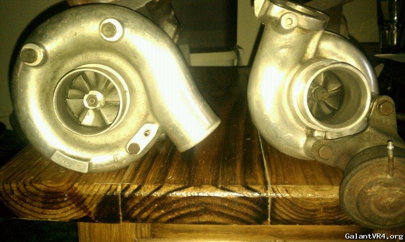

So I sold my E316G to a member here and I sent it out and got it back in the mail, so I was able to get a side by side shot...
FP20G vs E316G
It is externally gated and I have an Ebay 38mm V-band Wastegate for it but dont plan on running it for safety factor that I WANT to know the spring pressure..

You can hook it up to a compressor to see when it opens. Or just order your desired Tial spring. They usually fit and work just fine.

I think I have a spring or two laying around, it could take a few days for me to get out to my shop to grab it, Im not sure I remember what the rate is... (I remember putting 2 in for like 18psi) so that must have been the og spring... anyway if you pay for shipping its yours.
