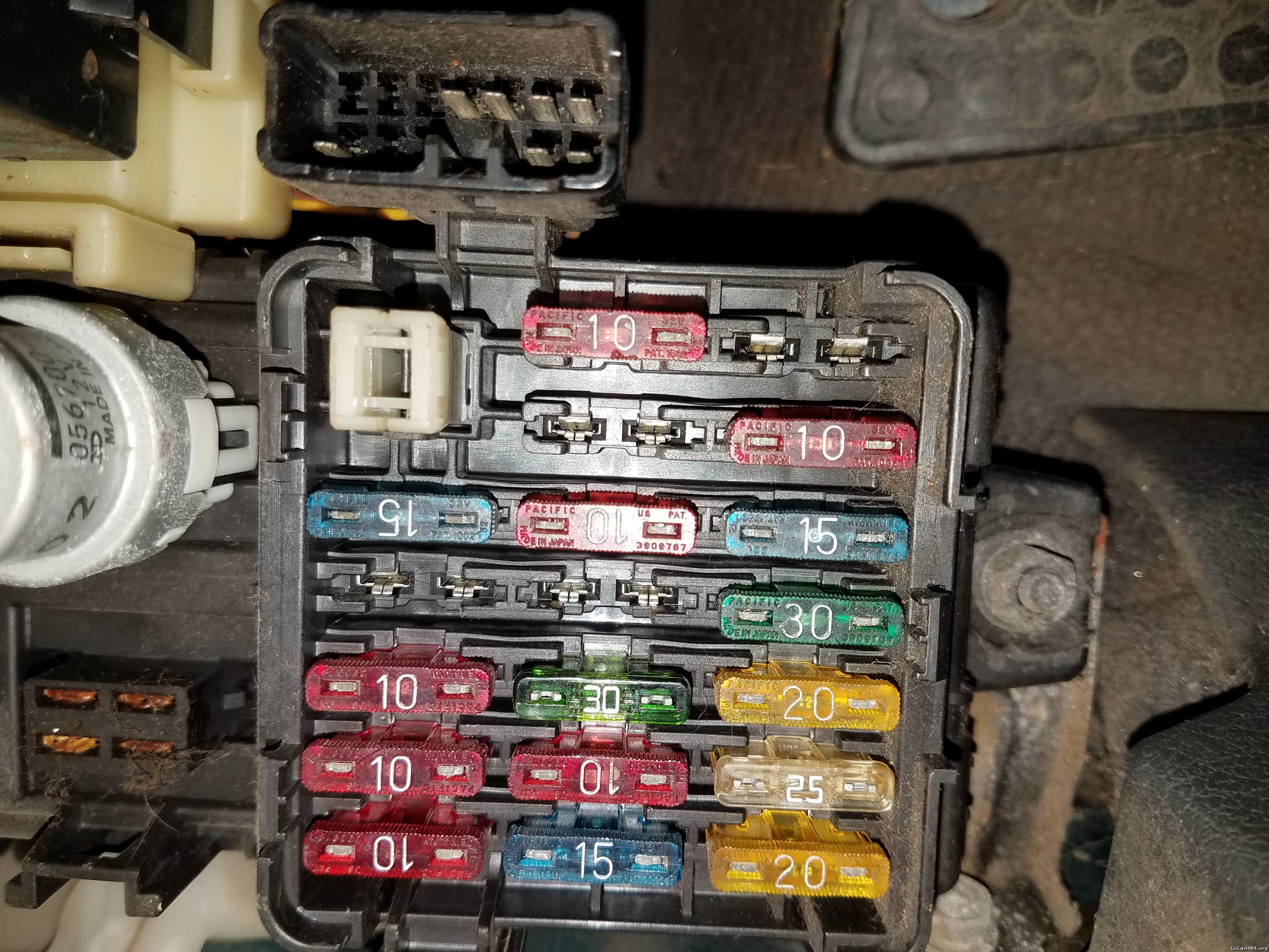

Was able to spend a few more minutes in the car and decided to see what the under dash fuses were doing. I disconnected the ignition switch at the connectors. I then started to check continuity to ground with the fuses in and all were getting signal. I then pulled all of the fuses and started to test the connectors, the missing fuses are the ones that I was getting a ground signal to. I then replaced the other fuses and didn't have signal to them anymore. So, according to the fuse box lid, the missing fuses that are getting signal to ground are:
Radio (10amp)
Gauge (10amp)
Wiper (15amp)
Room, Clock (10amp)
Mind you, last time I was poking around these fuses with my multimeter, I had a battery hooked up in the engine bay. After I found out that my grounds were feeding a 12v+, I stood up from the floor next to the car and then the wipers turned on and my passenger seatbelt retracted up as if it was locking a person in. I quickly shut the battery off

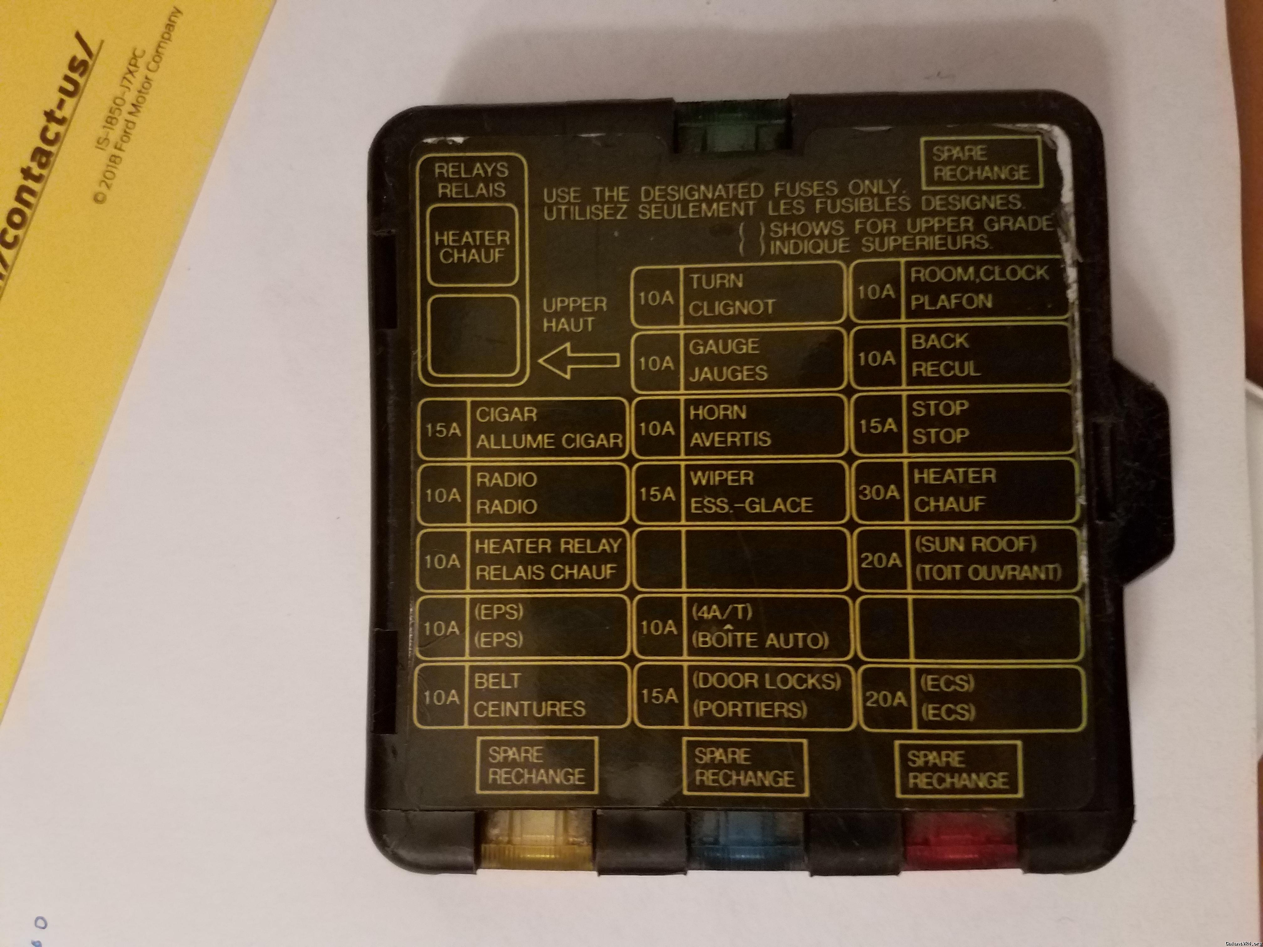

side question:
I see the on the layout labels that there are 2 blank spots. I then noticed that I have a 30amp fuse in the middle row blank spot and then a 25amp fuse in the lower row. Anybody know what these are going to? Are these normal fuses for these spots?
