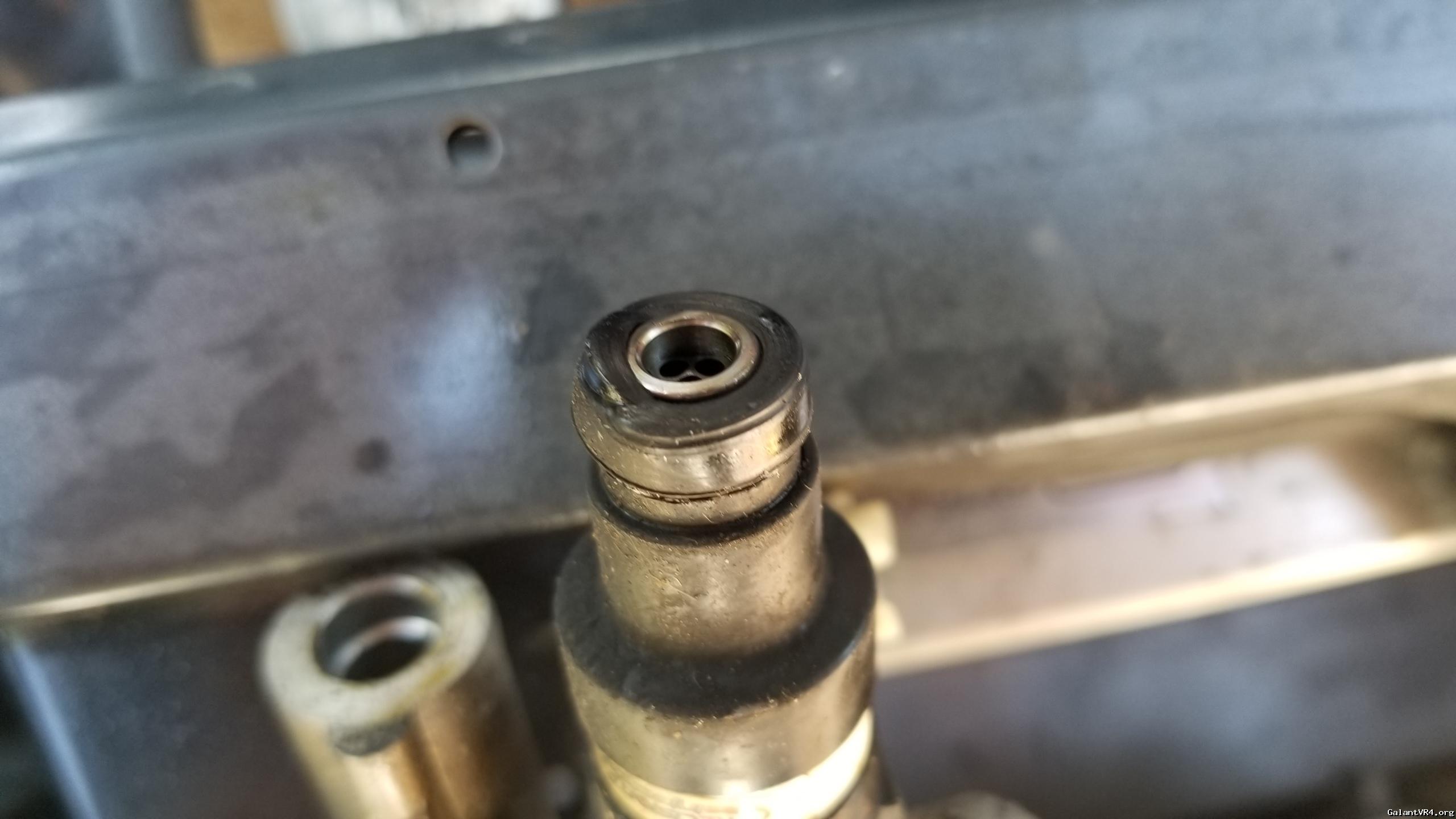

Well, I didn't wait long enough. Stumble came back. Had my son sit in the car while it was idling and I injected brake clean at the base of the injectors and found this on Injector 1!!

Yea, so I ordered a PTE injector specific set. So, I am not really sure what is causing the -40° reading for the IAT, but that can be bypassed and troubleshot at a later date. Not tom mention, it will be easier to work it if the car runs right first.

Injector seals didn't fix it. Looked closer at my logs and saw that my Baro reading was -9.8inHg with the engine off (I am at 1100ft, so it should have been zero or positive. I heard may rumors about the OmniPower MAP sensors having quality issues (mine was only 10 months old) so I replaced it with a new AEM 3.5 Bar and she is al good now.
