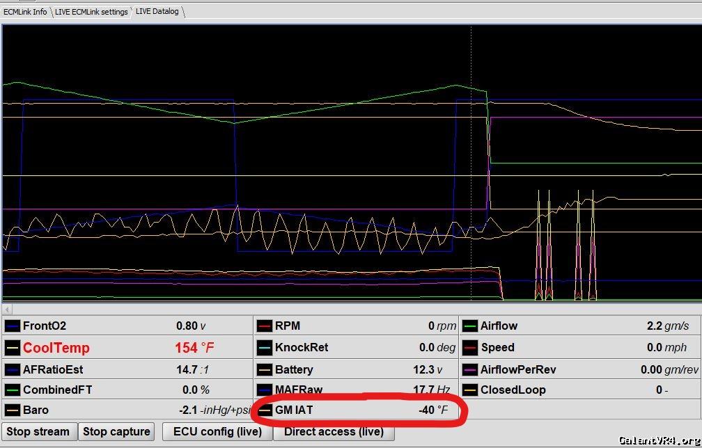

Started my car the other day and found it is now stumbling on the initial press of the accelerator pedal. If I push it fast, it stumbles and leans out. If I press it slow, it is fine. I verified the TPS is reading correctly and it idles just fine. This started right after being started. I can't find a boost leak anywhere. I made a log and it can be seen HERE. I am stumped.

I have a go IAT. When I log (the link to the log is on the first post) it reads 40 all the time for some reason. It is connected with the ECMTuning kit and has always read that way, but a bad gas does sound very plausible.

I verifies that I filled up with Shell the last time so gas should be good. I just ordered another sensor since it is reading 40 degrees VA the normal 70 to start. Only $12 for a fast sensor

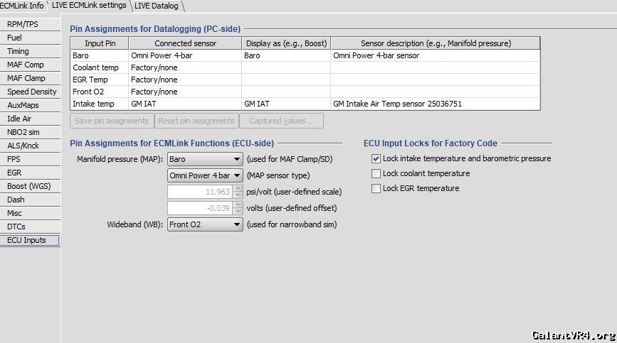

IAT setting does not exist on the MISC tab.
Found a setting on the ECU Inputs tab. I locked it:
Even locked, IAT shows -40° and problem persists.

I would have to change everything below 3500RPM, not really willing to do that when I know I have a sensor that is reading -39°/40°, which indicates a bad sensor per GM. At least when I get the sensor I will know for sure it is good and adjust from there.

Changed out the IAT sensor and the ECU still see's -40° for intake temp. Would a shorted wire cause this? I am using the ECMTuning plug and play kit to a 2g MAF plug (Car had a 2gMAF plug there already, so I bought the complete wiring kit from ECMTuning for that plug). I have no problem checking the connections to the plug itself, but I just can't find much information on what would cause an issue like this, where the IAT is seeing high voltage to throw it to -40°.

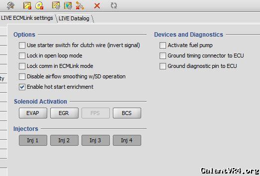

transparentdsm
Jul 27, 2011
3,690
Cherry Hill, NJ
so i finally had some free time to check out your log. try disabling the airflow smoothing w/ SD operation in the MISC. tab, its the one thing i can see.
edit: im not sure this is going to do anything to help or hinder you and probably wont change anything with your IAT's, but it is something i noticed.
