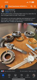

Update: Neat Gearbox responded to one of my Facebook comments saying that pre production sales WILL open up this week, this is the Facebook group to join if you want in on this IMG_2908.png
