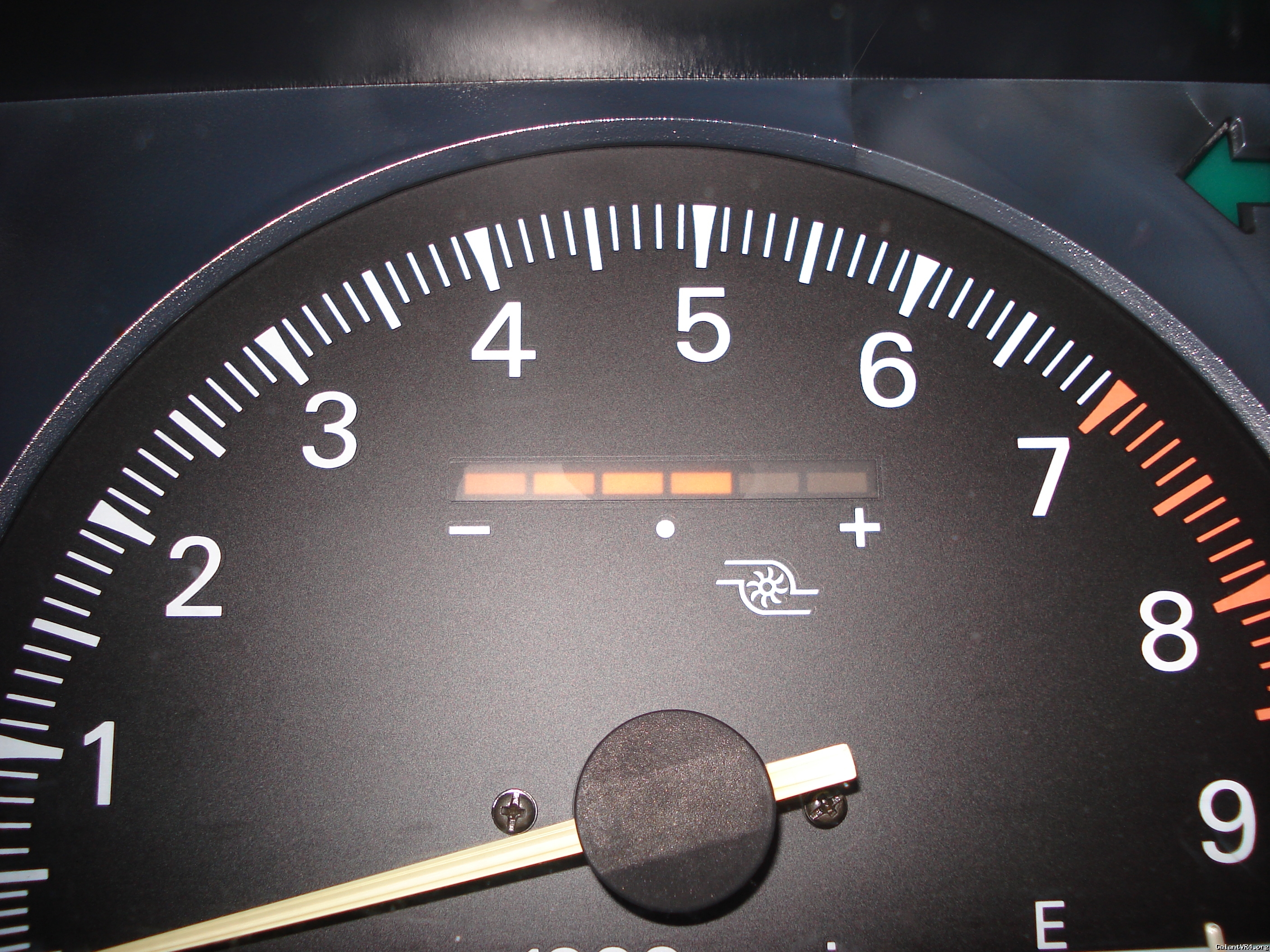

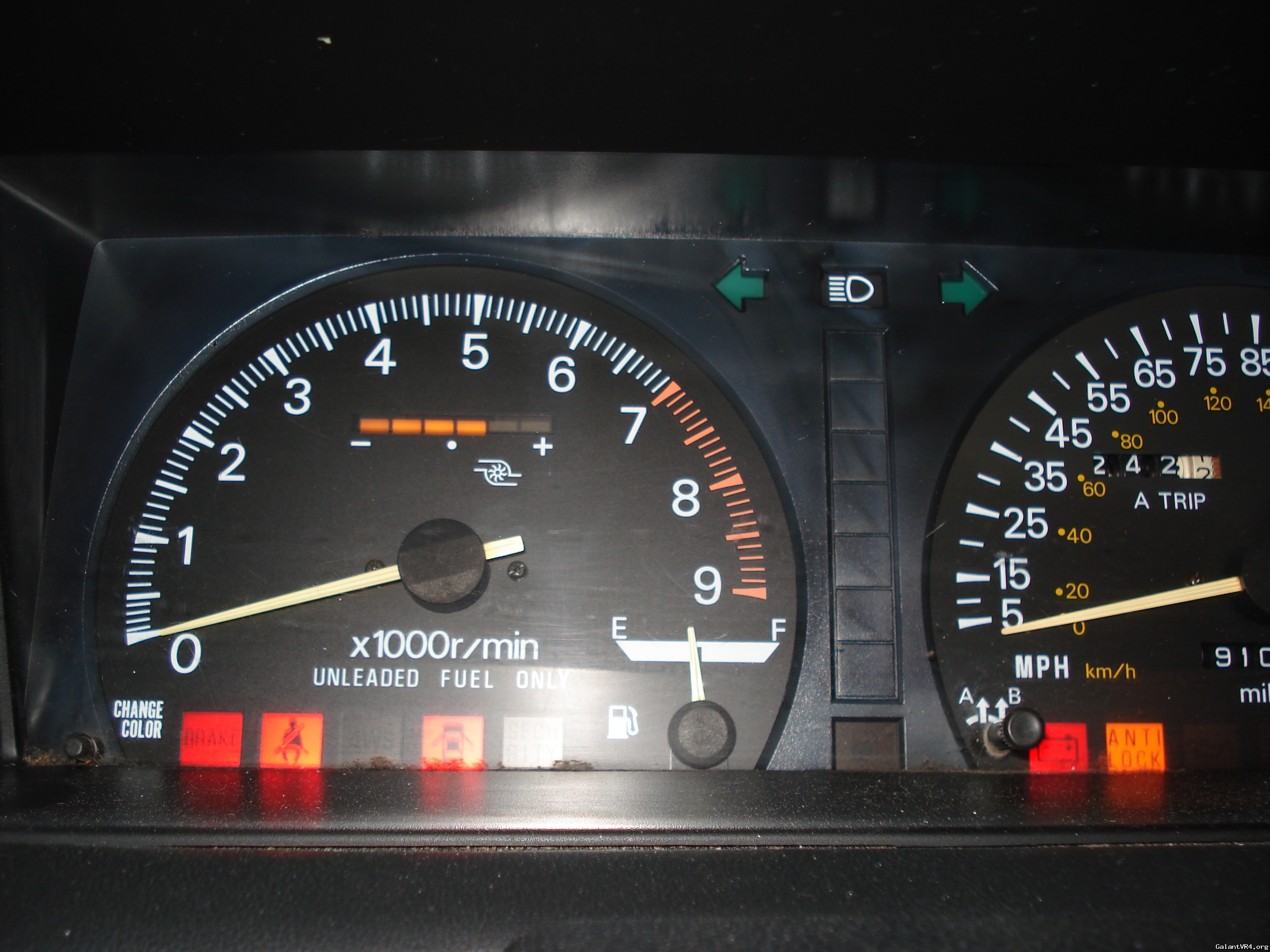

i notice the gauge in the center of my console go from negative to positive??

If the car has a DSMchip the stock boost gauge is used for seeing what the stutterbox is set to. Is you ecu stock, or chipped?

The boost gauge moving just means you are tapping the gas pedal, changing the stutterbox setting. Ignore it.
