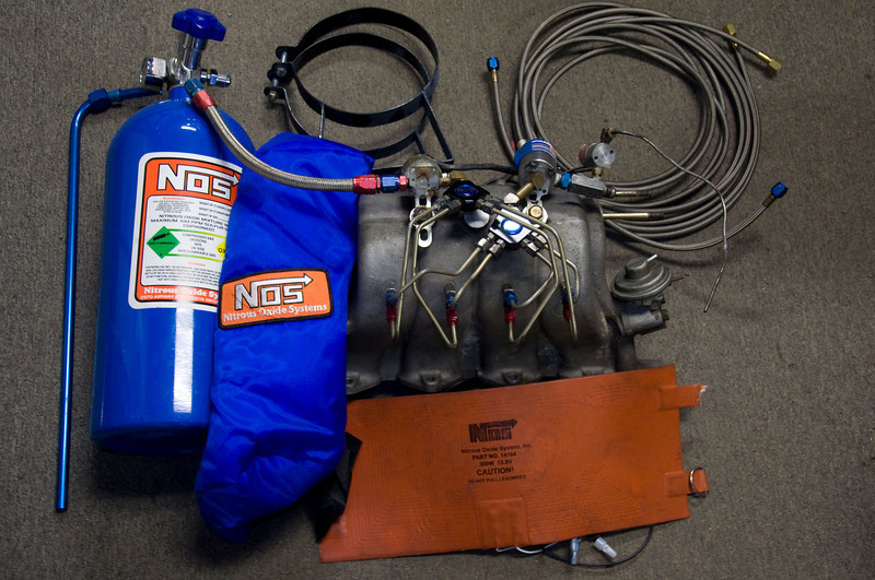

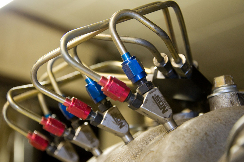

I need to find some small items to complete the kit. I picked it up with some bartering, and just have to deal with the wiring and some missing/wrong fittings:
a set of ball ferrels on the pipe to distribution block fittings are missing and the inlet fittings for the solonoids need to be changed to -4 to fit the lines I have. The kit was never actually used. I also need to pull the noids apart and check the seals to make sure they aren't contaminated from sitting open for a couple years. Obviously will check them out with bottle pressure/fuel pressure before the intake is installed in the spring.
It came with .018/.024 jets for 120hp, should be a nice complement to my current 16G "typical streetcar" setup. /ubbthreads/images/graemlins/devil.gif

Looks like a nice purchase/trade, those hard lines make those setups look great.

Yeah, direct port FTW. In my opinion, there's no much point for me to install a single fogger, as I'll end up at 100-125hp jets anyway. The 18/24 jetting is super conservative rich for 37psi fuel pressure. When I had those jets in my talon that was tuned for 12.0 AF, my first runs with the direct port were off the chart rich in the 9's but still picked up 11mph on a much faster car (131mph turbo onlybto 142mph on first n20 pass.) So, Im not worried about starting out with 120hp jets and that's usually the thing people are concerned with on a 4 port setup (minimum shot).
I would guess my current setup should do a 12.5@110 to 12.2@113 with stars aligned and this kit would get me to the 124-125mph range which should be plenty of mph to get myself booted for lack of safety equipment.
The only bad thing is if it's literally in the 9's for AF, Ill have no choice but to go to .026 or .028 nitrous jets to lean it out or drop the fuel pressure a significant amount. And Im not so sure a totally stock 6bolt is going to hold a 300hp 16g setup + 150hp of spray so I'm likely going to have to do all all of the above within reason and still run it stupid rich.
But yeah, Im pretty psyched with the deal. I think Im going to plan to install the intake in the spring when I do a Tbelt/BSE kit and have one side of the motor all apart for more access.
