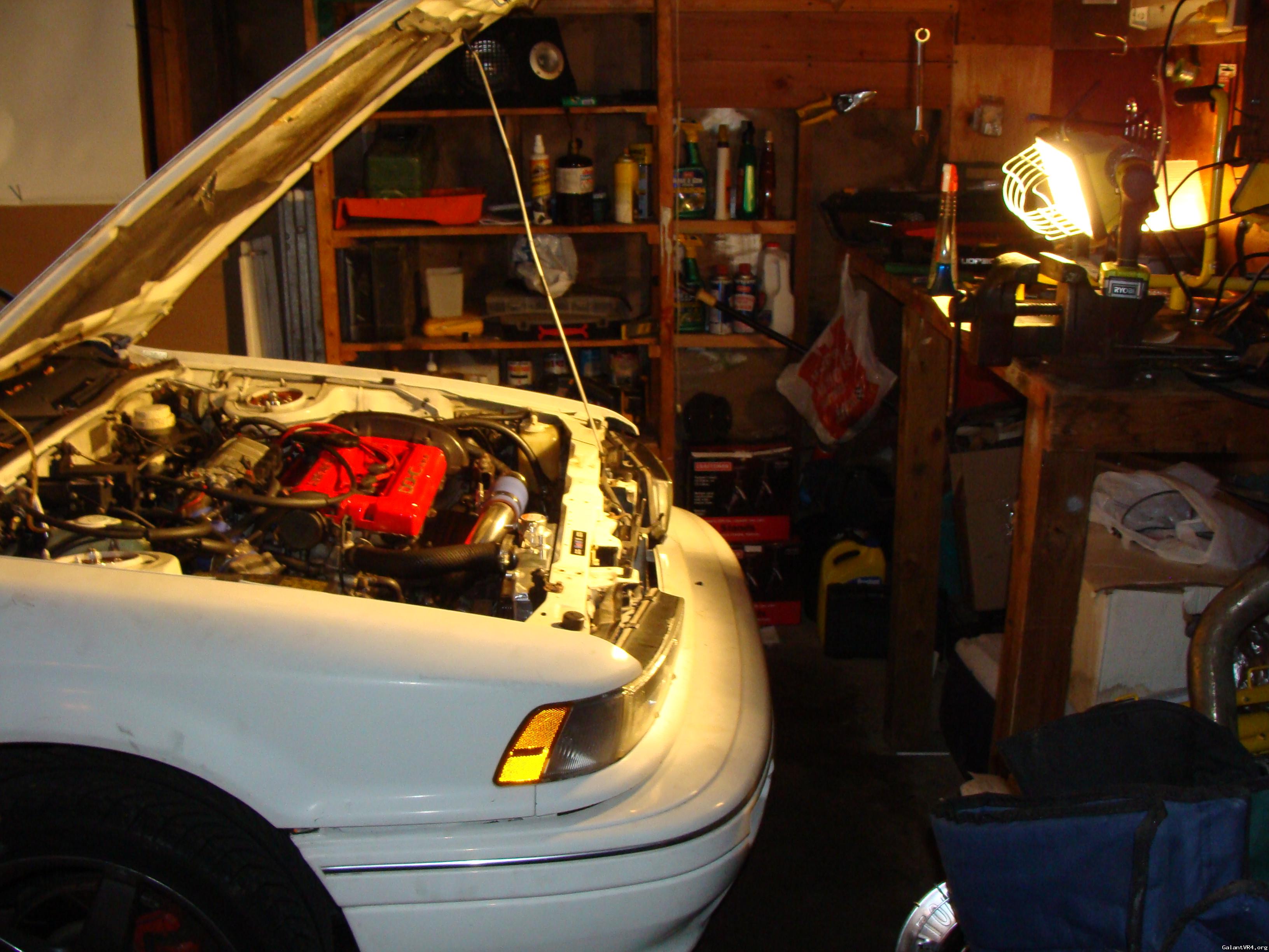

So its been a little while since I purchased 1942. Theres been no driving of her because of certain reasons, But spring is coming soon and theres no reason to rush it. I've been busy with her latly, cleaning, replacing, paiting, understanding. Its been cold but I work through it. even in the tight space, lol

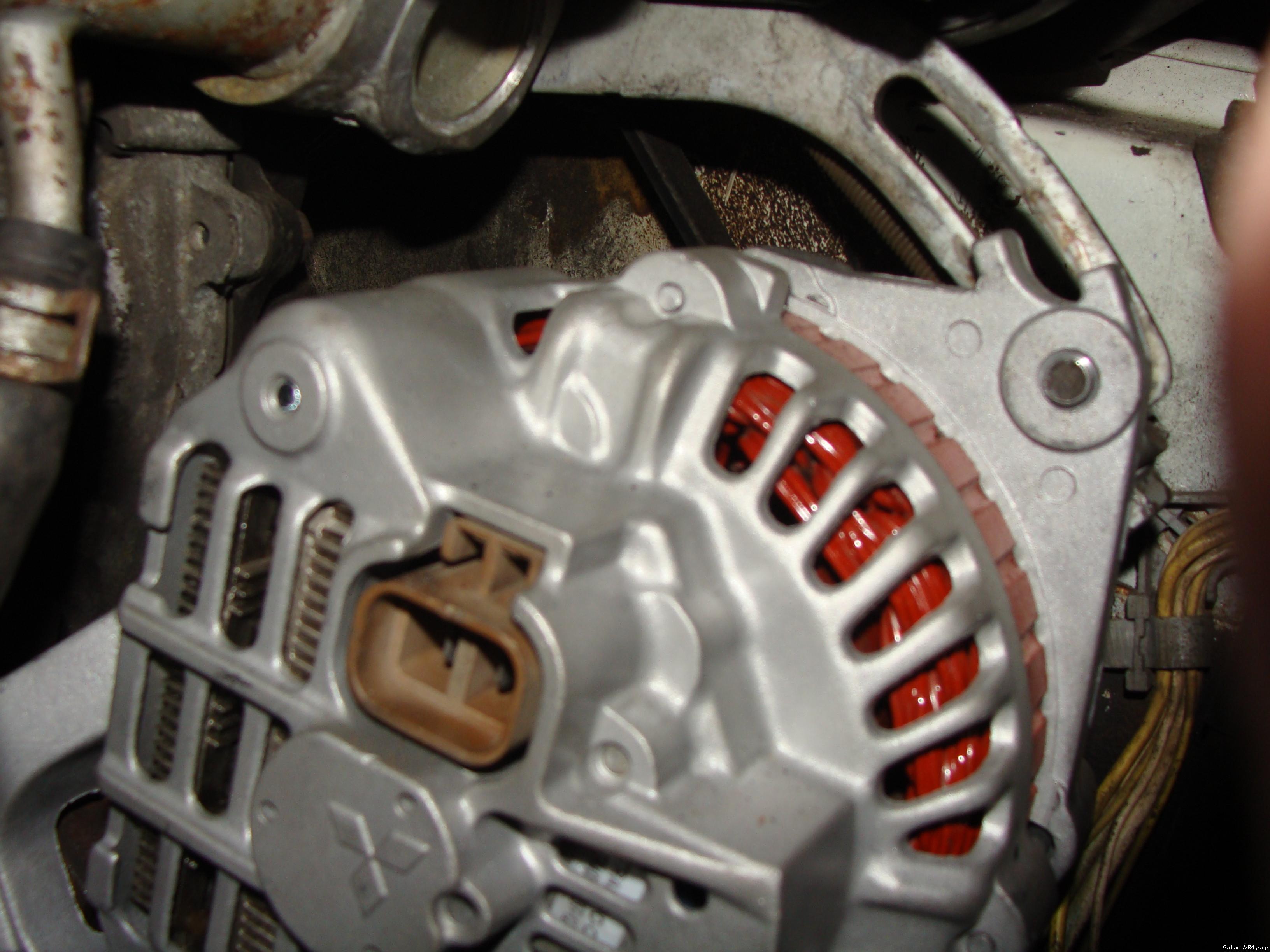

So Ive replaced a couple of things battery, intake, radiator, an another alternator /ubbthreads/images/graemlins/banghead.gif
I purchased a Adavance Auto 90amp, and it was a bad alternator from the start! WTF.

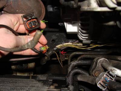

So I took advice from a previous post on a high output alter. and purchased one.
The picture above is a pic of the alter. wires, I know where the green plugs/wires go, im just not to sure on what this fourth wire is(red) would this be a ground? does it mount to the alt.?

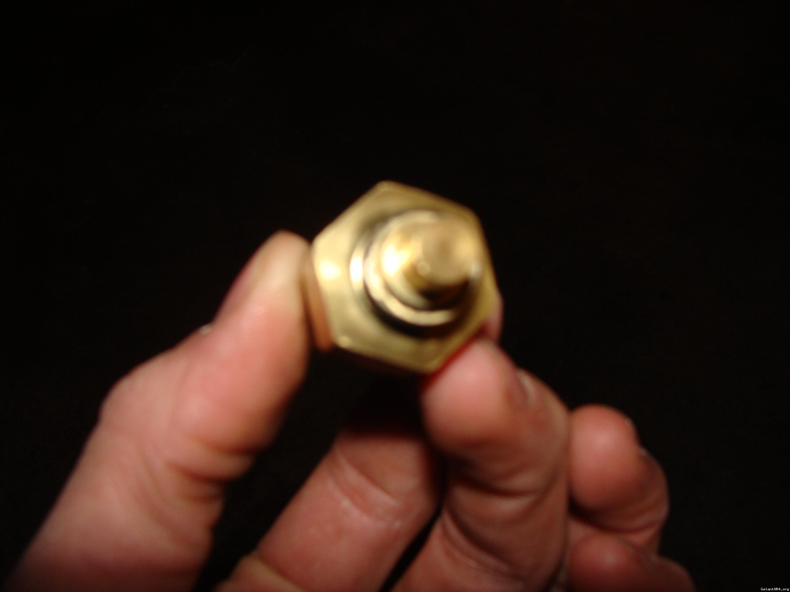

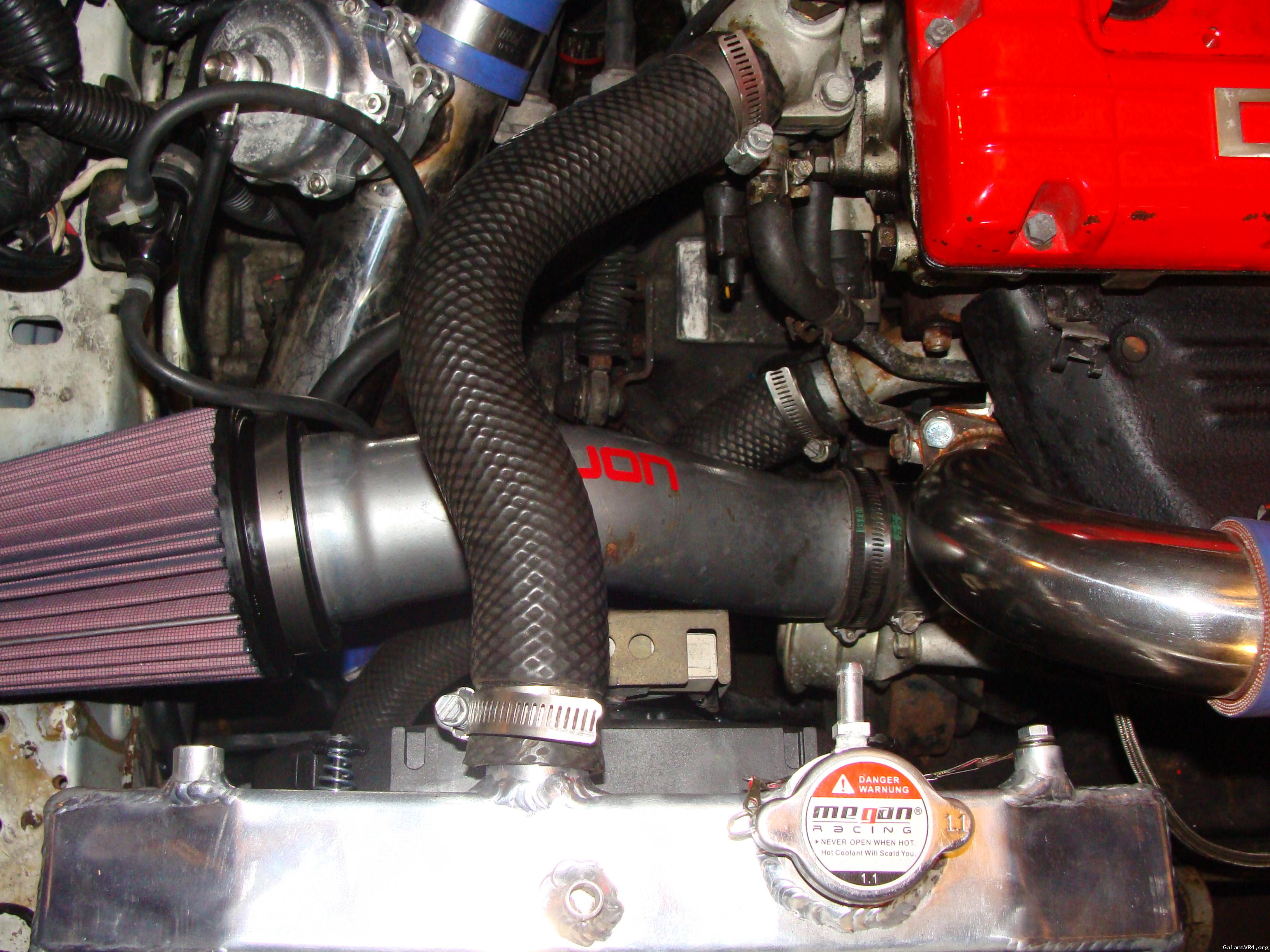

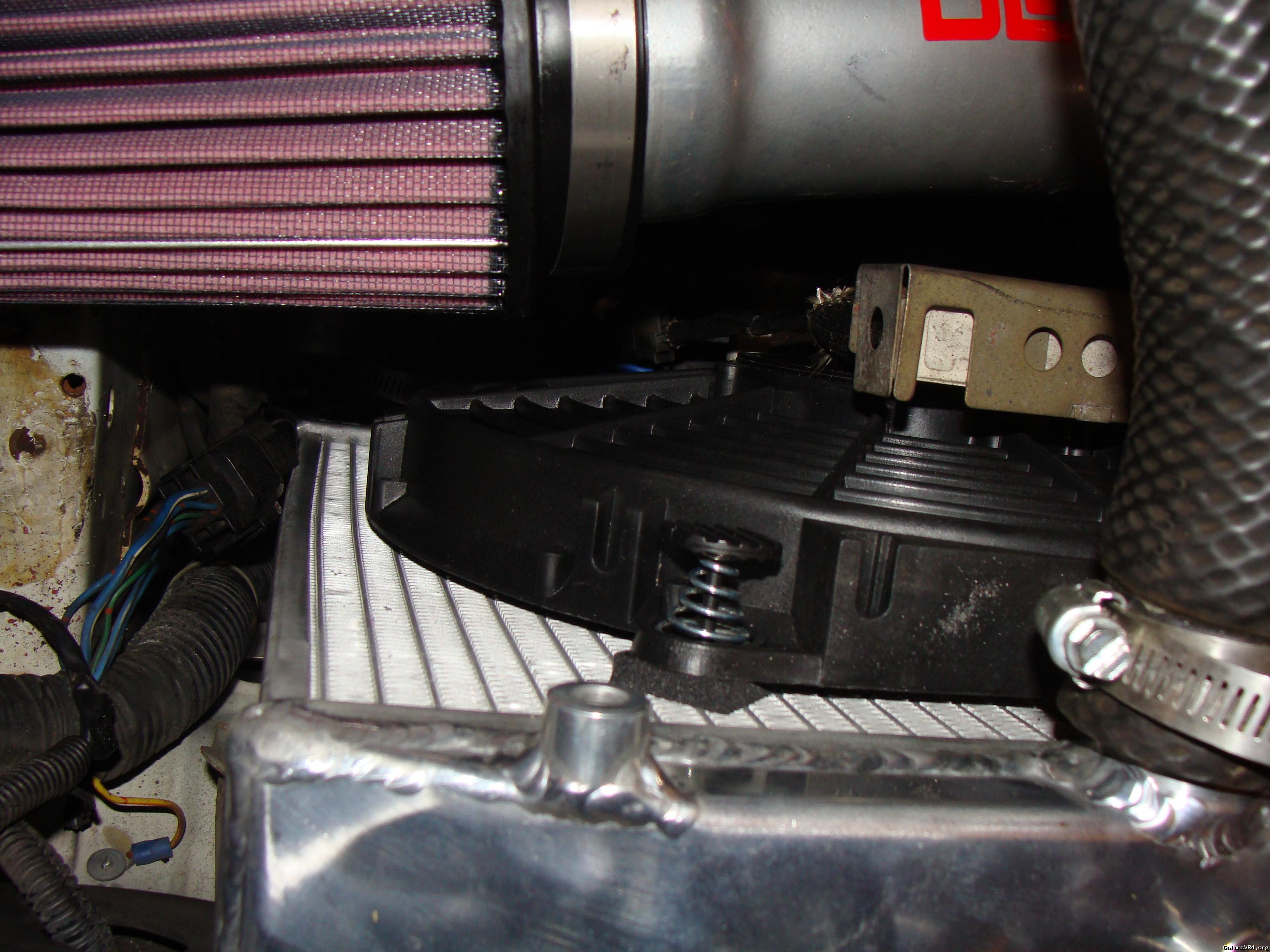

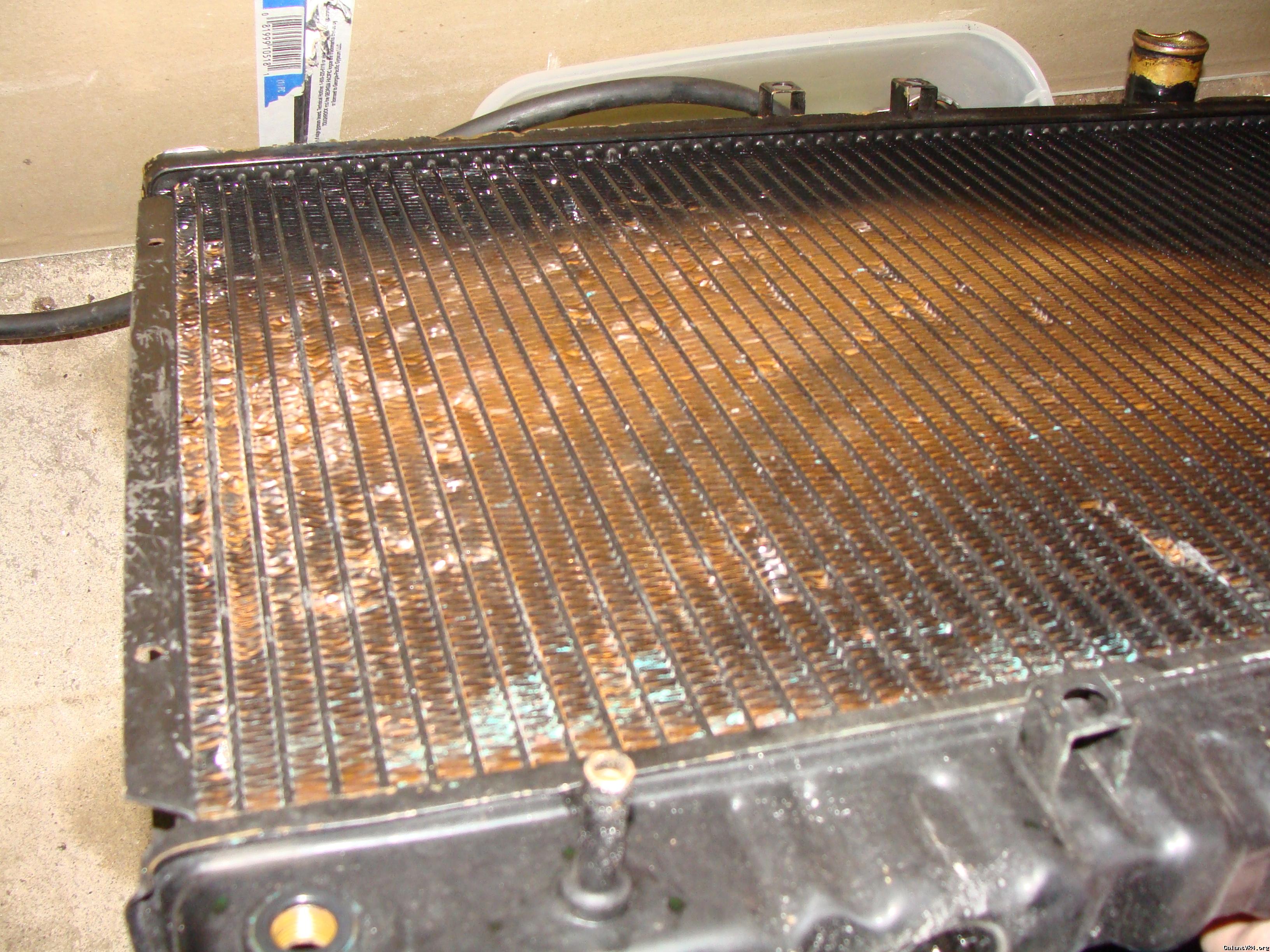

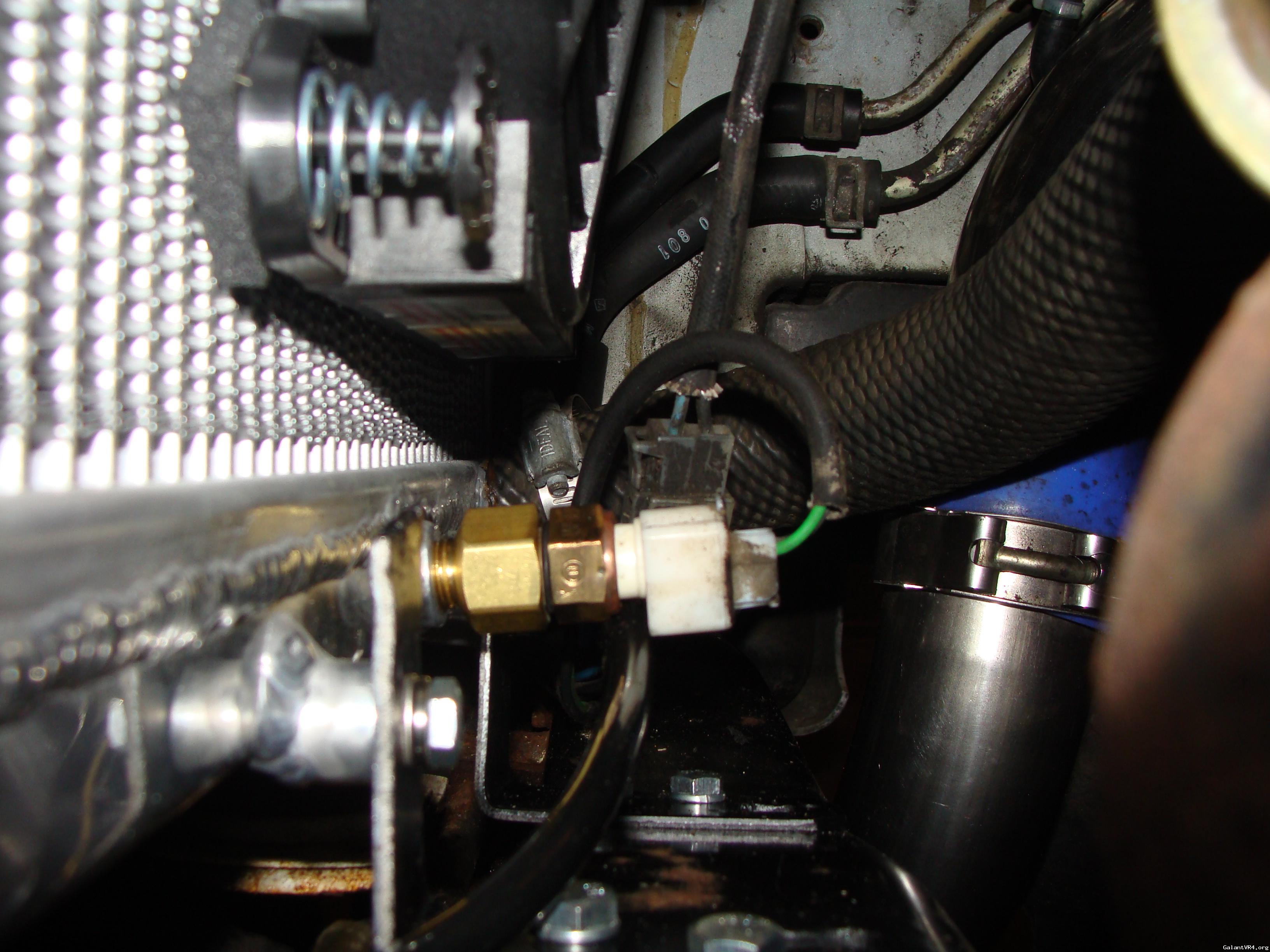

I purchased the new radiator because my stock one was shot. New radiator fan and sensor port fitting. And custom brackets.

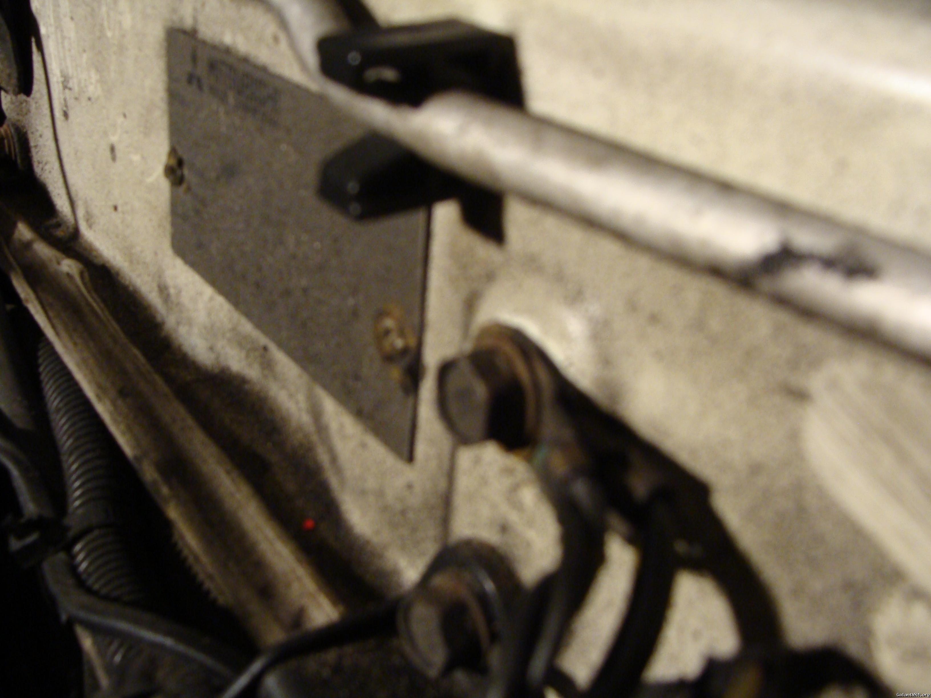

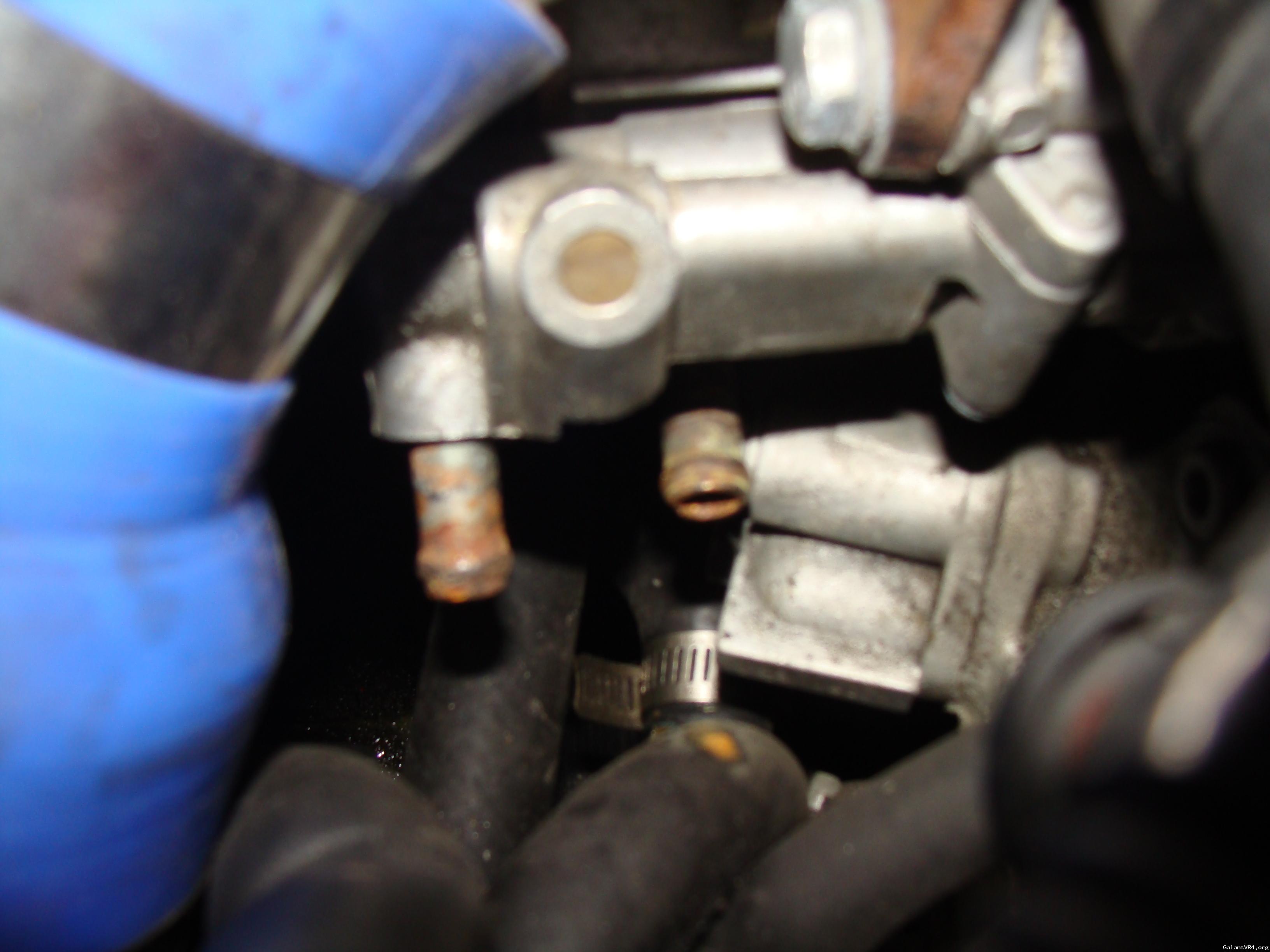

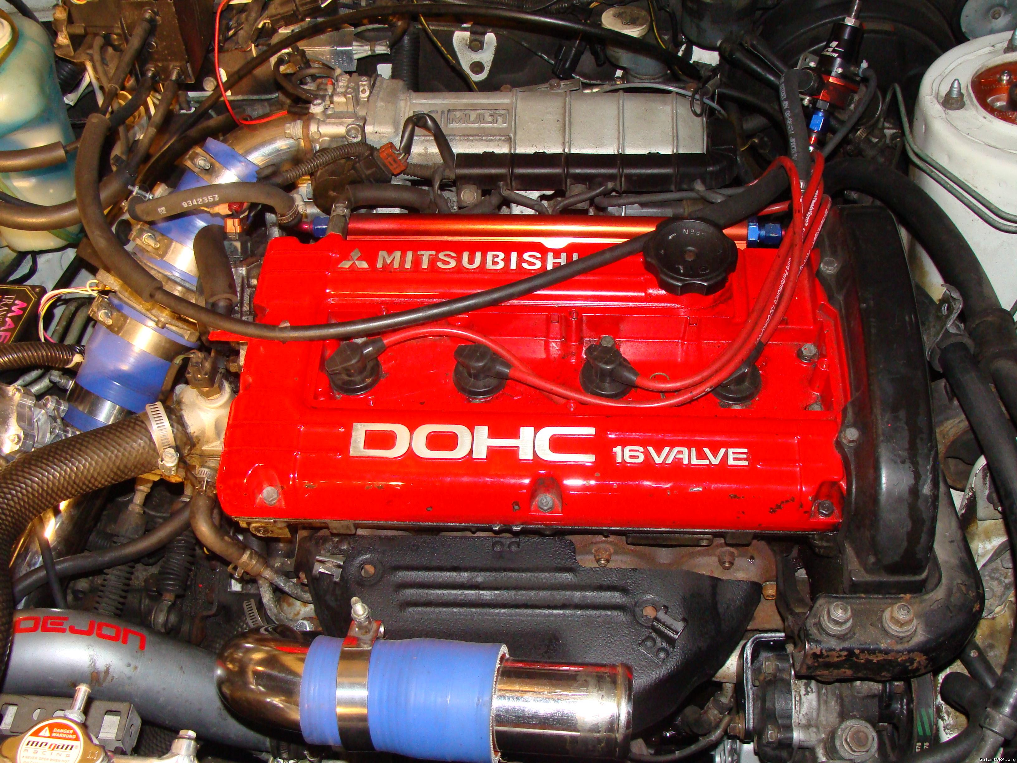

Im stumped on a few things I found in the engine bay like, these ports under my throttle body, Does anyone know what they are?? my best guess would be for coolent..

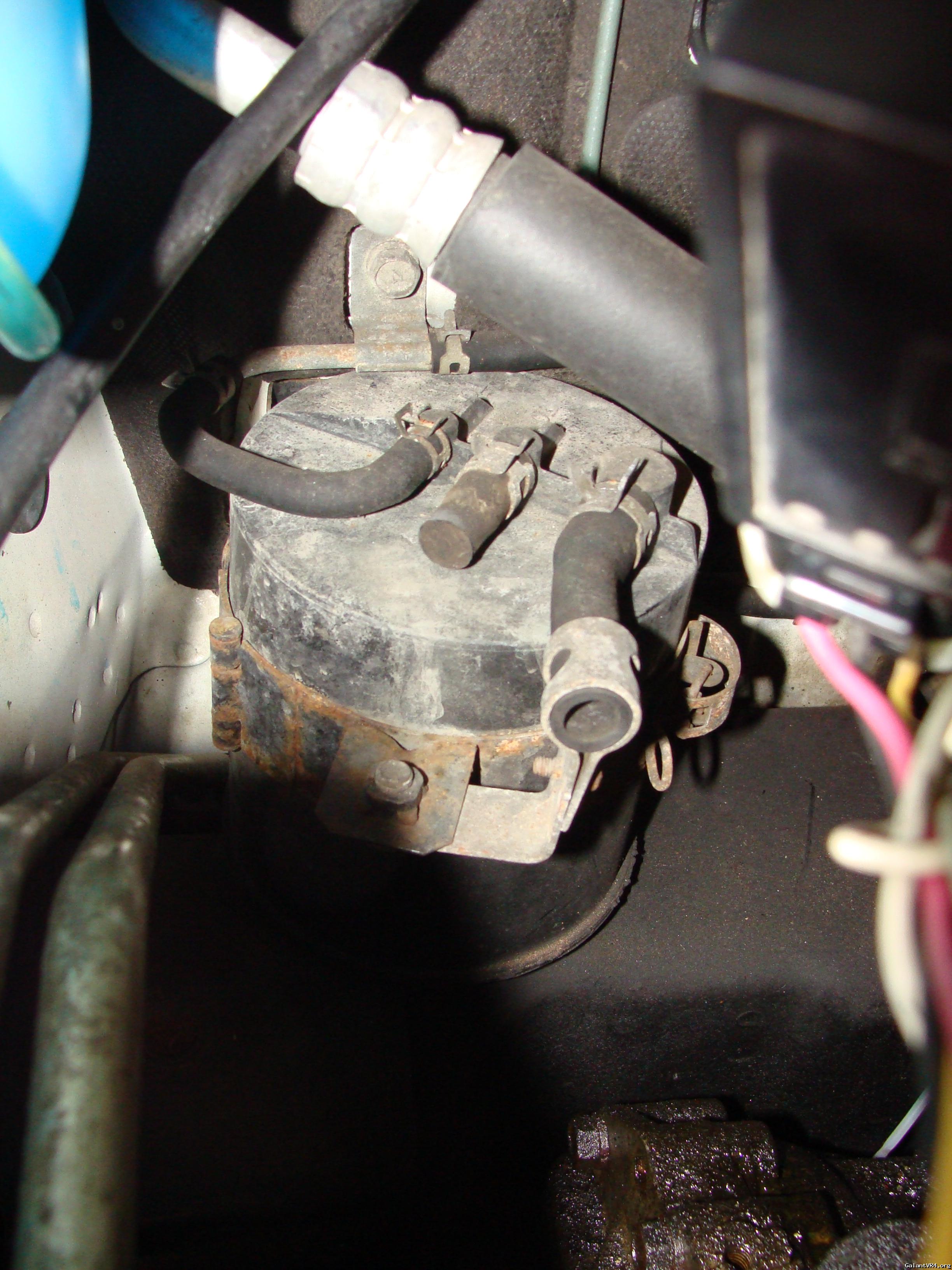

Maybe having to do with this thing? If so im looking to just get rid of this, unless those ports go to here and there needed?

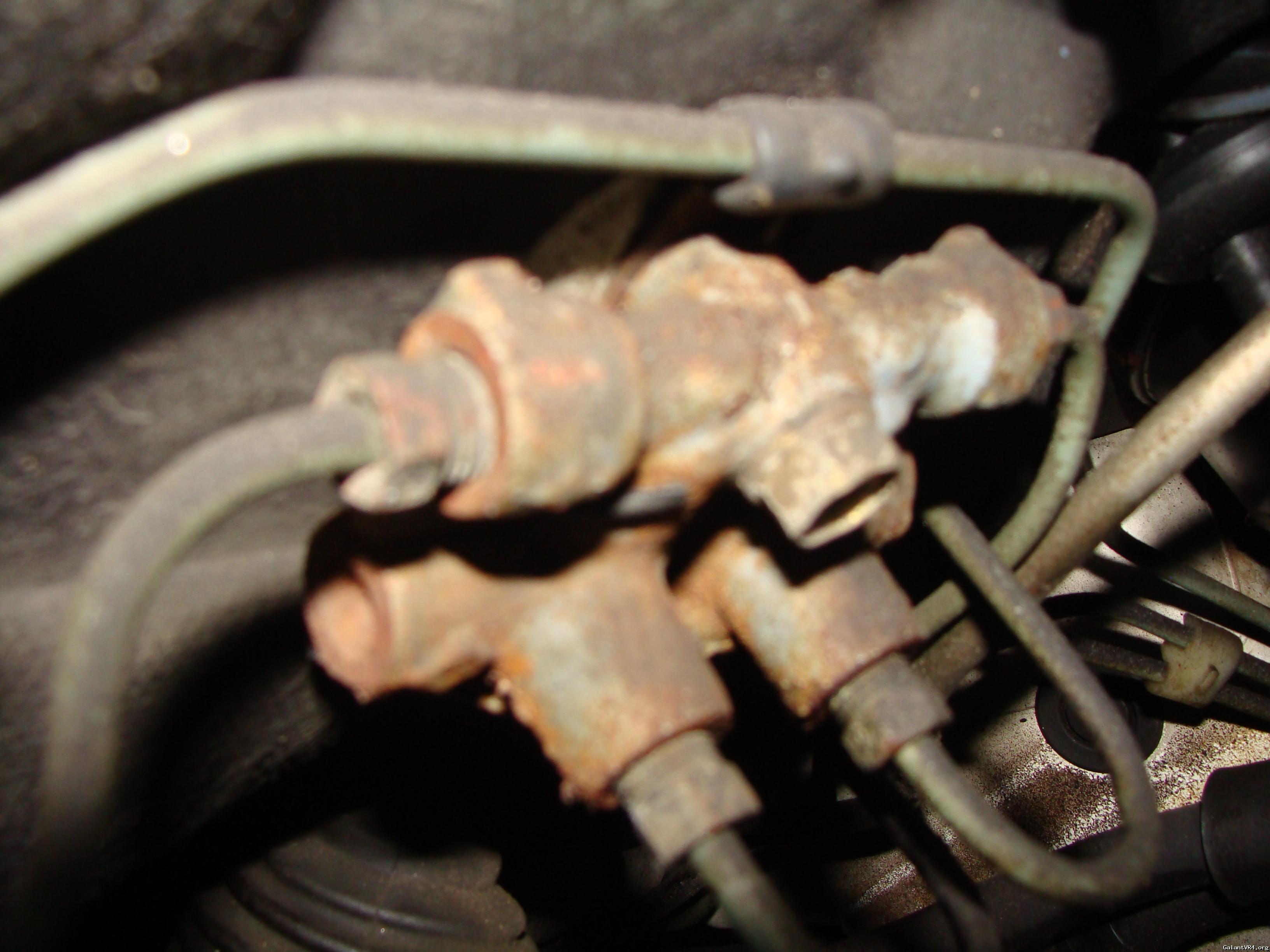

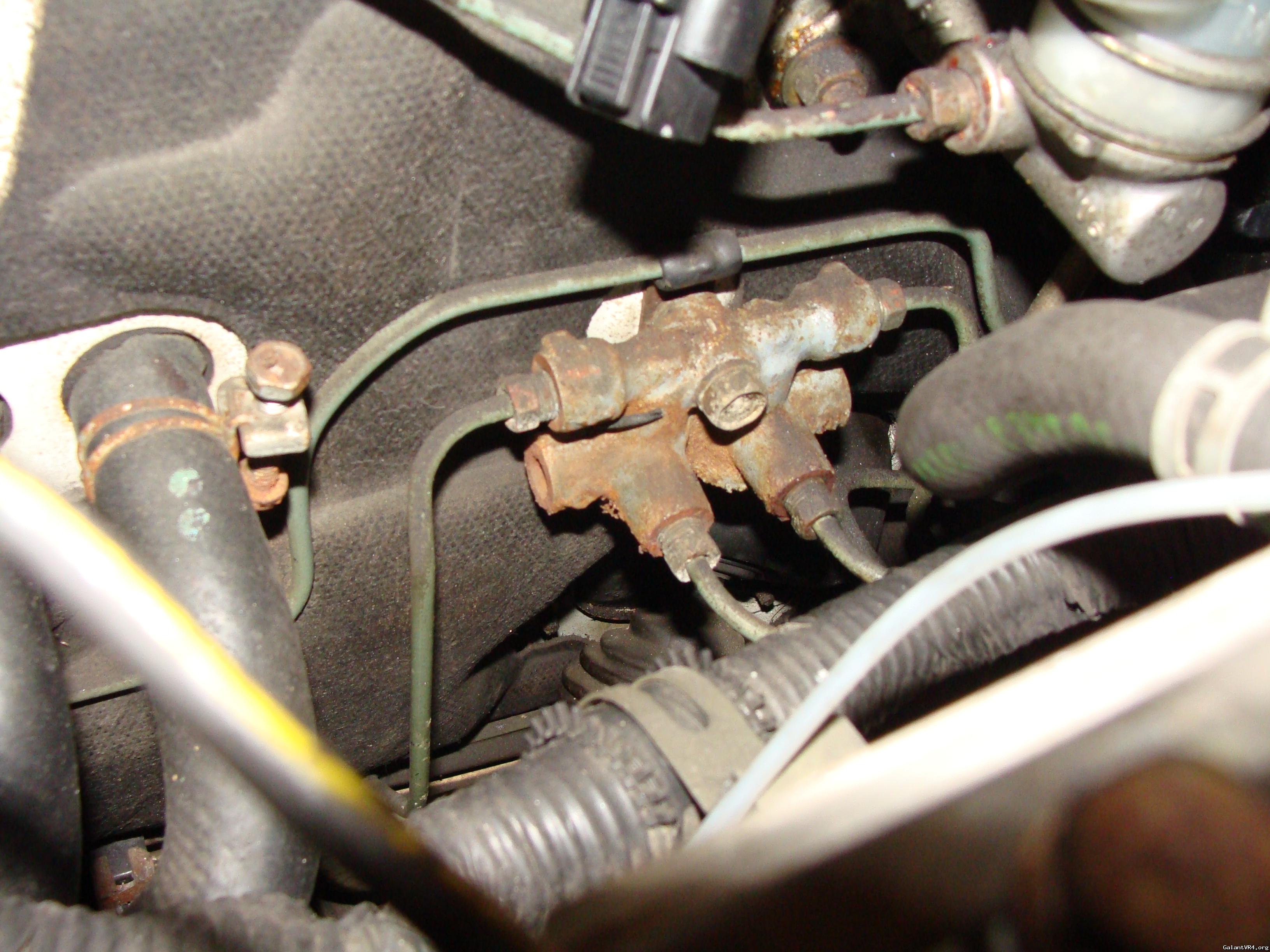

Soo as I was looking into doing an ABS delete and some SS brake lines, my proportional valve looks like this.. both of the bottom ports are blocked and no lines coming up to them. im clueless...
What lines would those be? are there no rear brakes?

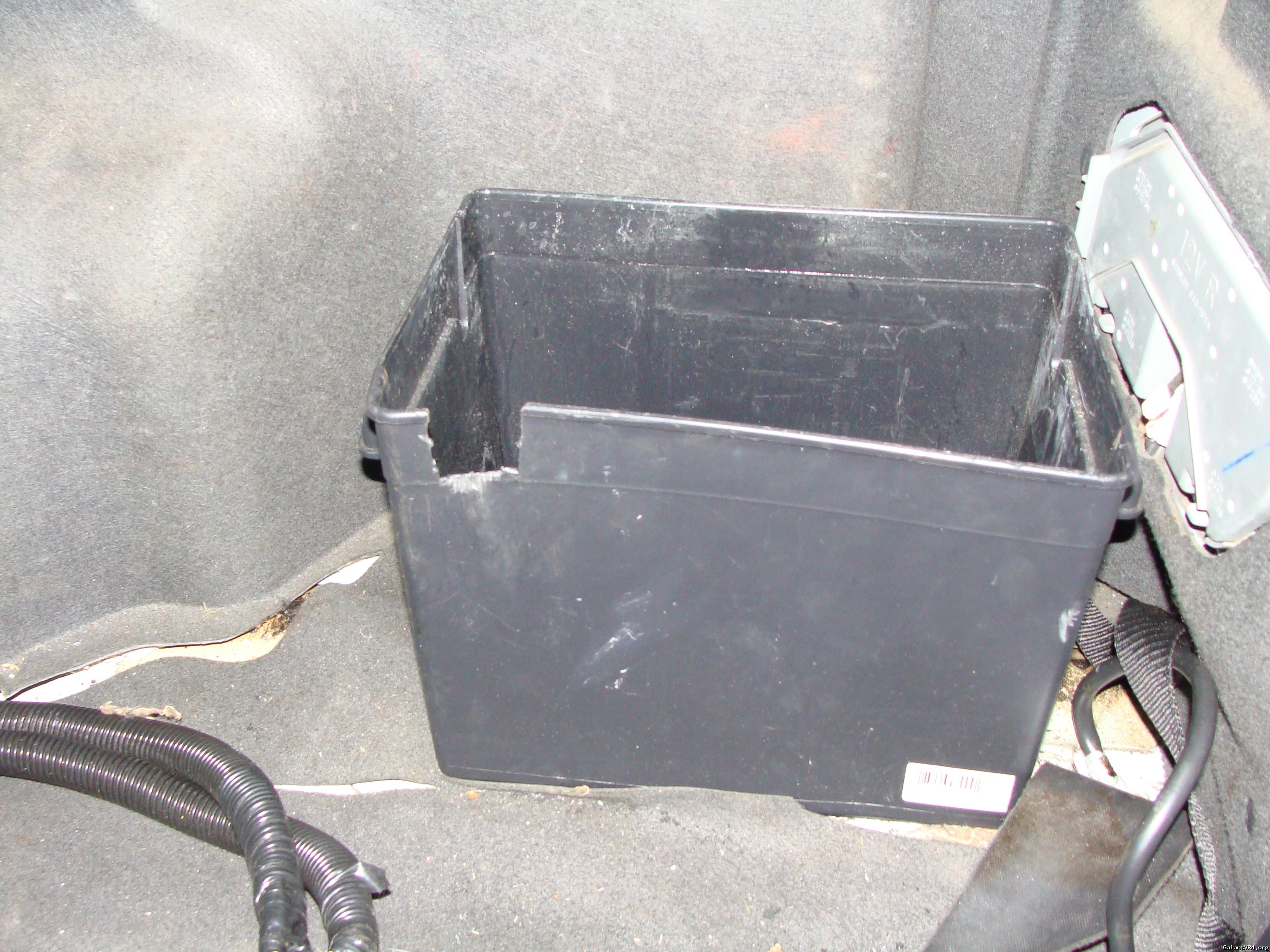

Battery Box and new battery

the ports under the throttle body is a FIAV(Fast Idle Air Valve) which circulates coolant to the throttle body to help the idle during cold starts. The hoses connected to the water pipe which is under the thermostat housing. I would strongly suggest picking up a service manual which is a big help!!
As far as the brake lines, yes there are rear brakes and i would highly suggest ditching the ABS cause its junk in these cars. You will need a non abs prop valve, both lines from prop valve to master cylinder and a line to each of the front wheels. The lines going to the back wheels stay the same and dont need to be replaced. I might have a complete non abs conversion set left over if your interested. Ill check tomorrow and get back to you.
As for the black canister in the Passenger side bottom corner is the charcoal canister which is part of the emissions and isnt really needed. Most people just take them out.

very good to know. I might just pick up a service manual soon now that you mentioned it. And yeah I would be interested in the delete.. do you have the lines, or just the prop. valve? And yeah Im probably going to get rid of that canister.

i know for a fact i have a prop valve and some of the lines, not sure if i have all 4 or not. I have some BNIB ones from Mitsubishi but they are mine /ubbthreads/images/graemlins/devil.gif
Adorsey
Apr 22, 2009
355
mass
so in the picture above of my proportional valve, would the lines missing be the rear lines to the master cyl.? or to the rear brakes themselves?
I wonder if I could just get a non-abs porp. valve, and just buy a spool of new line, and a double flare tool, and do it myself?

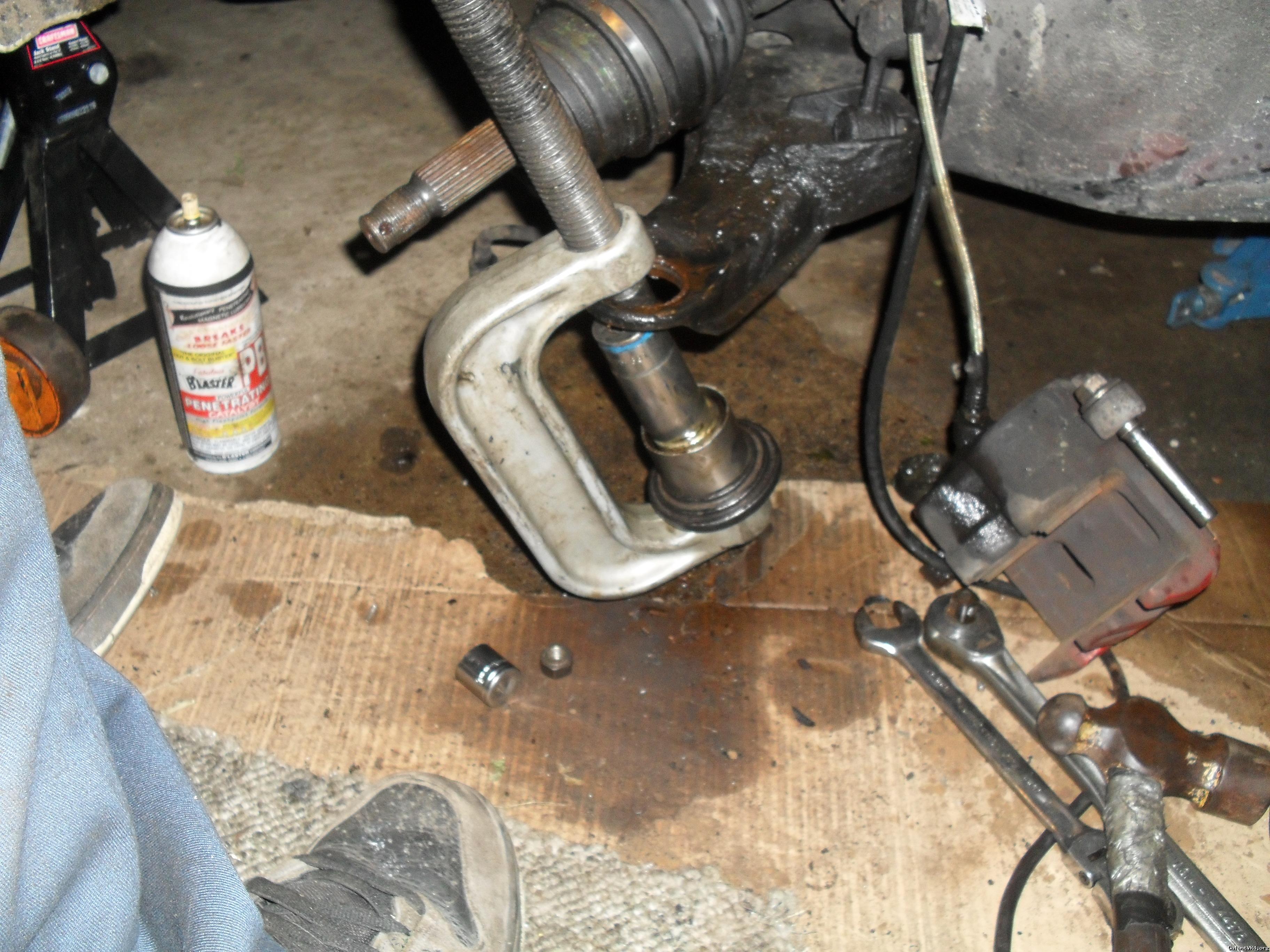

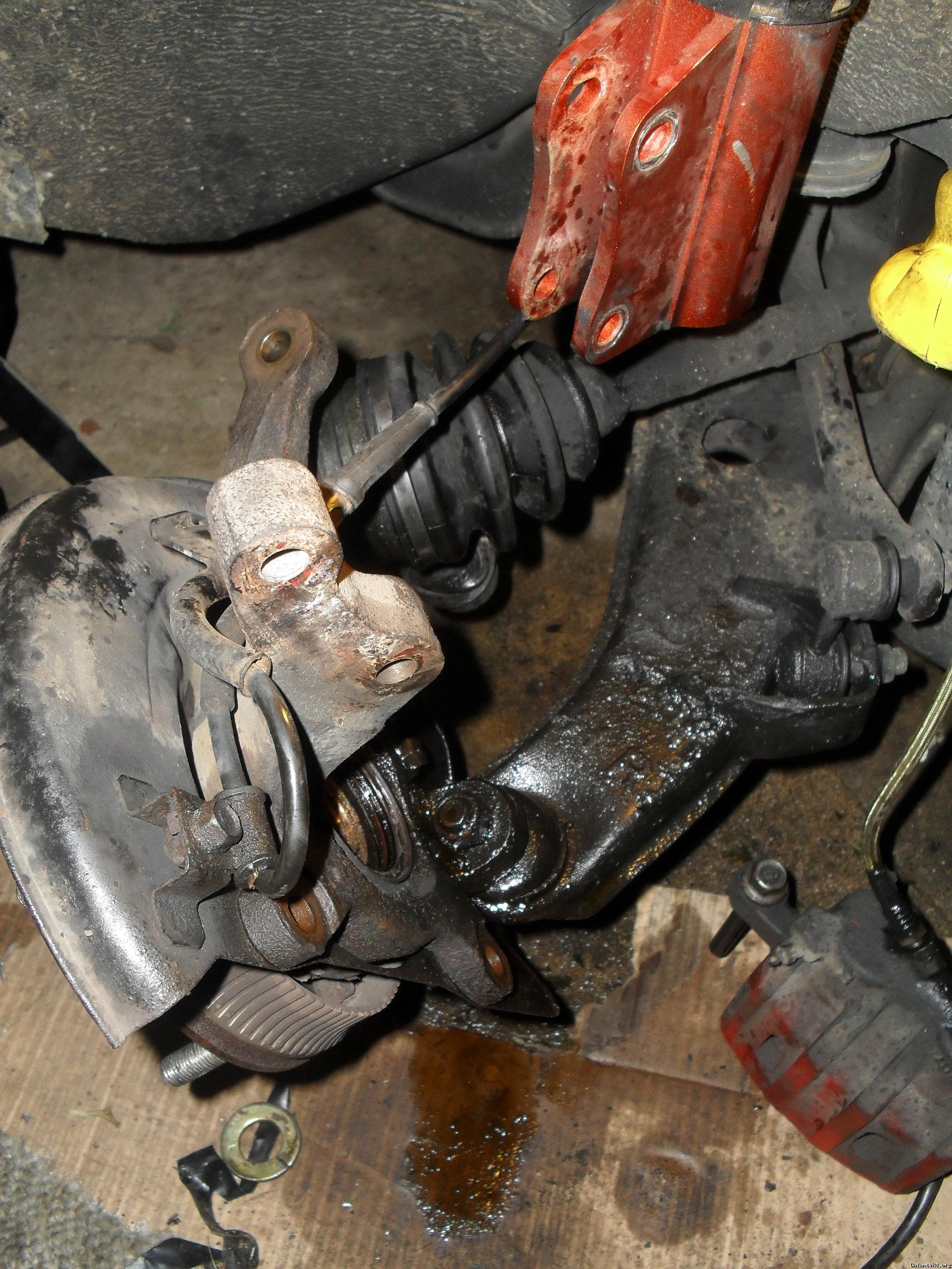

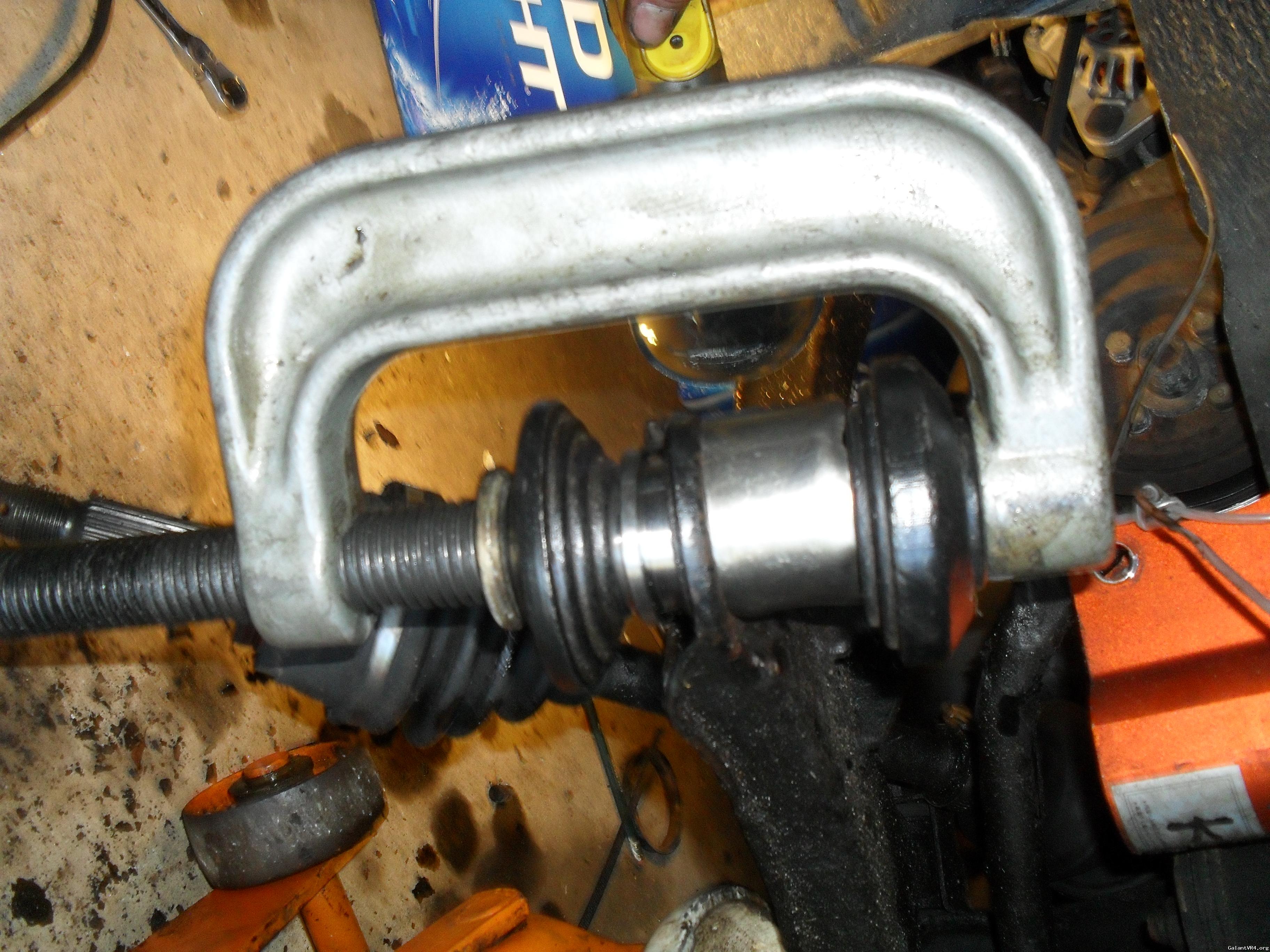

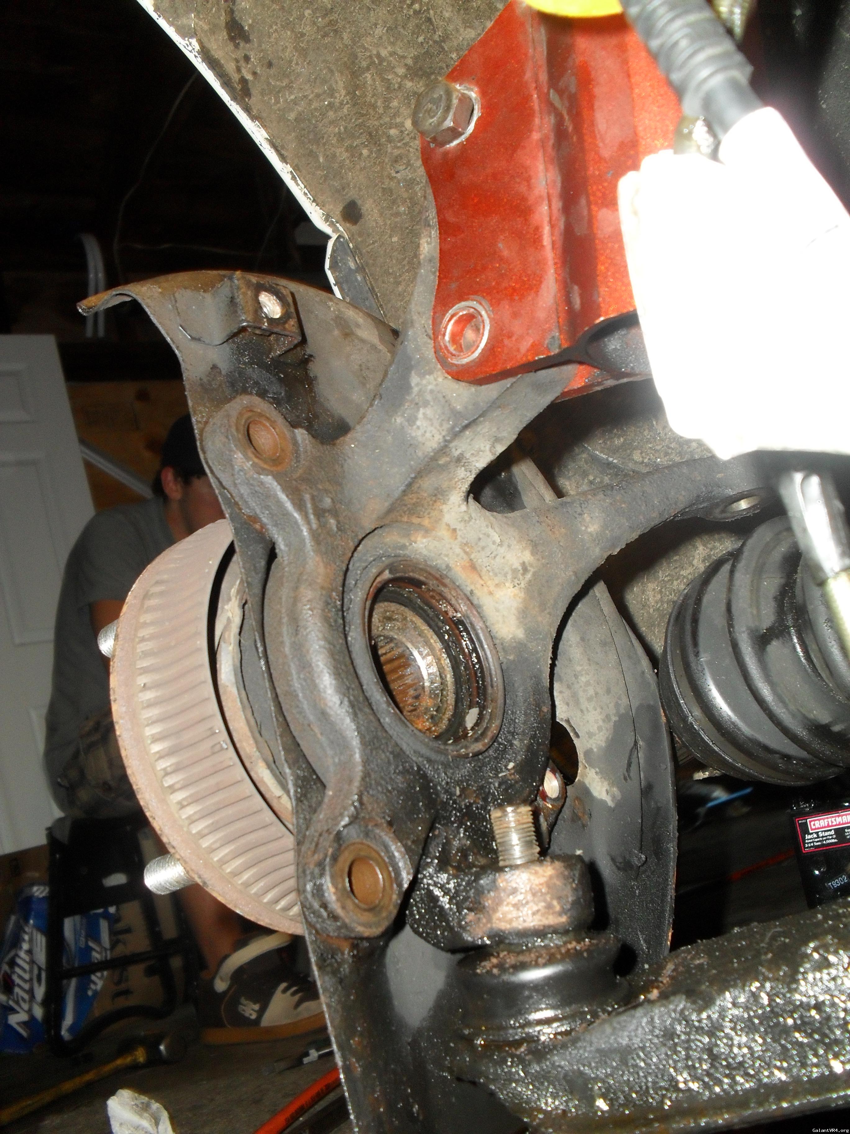

JUST finished up doing some dirty work: all new ball joints, all new wheel bearings, ss brake lines.
Took some pictures to help clear up the job, and just for the sake of the boards to give out some info!

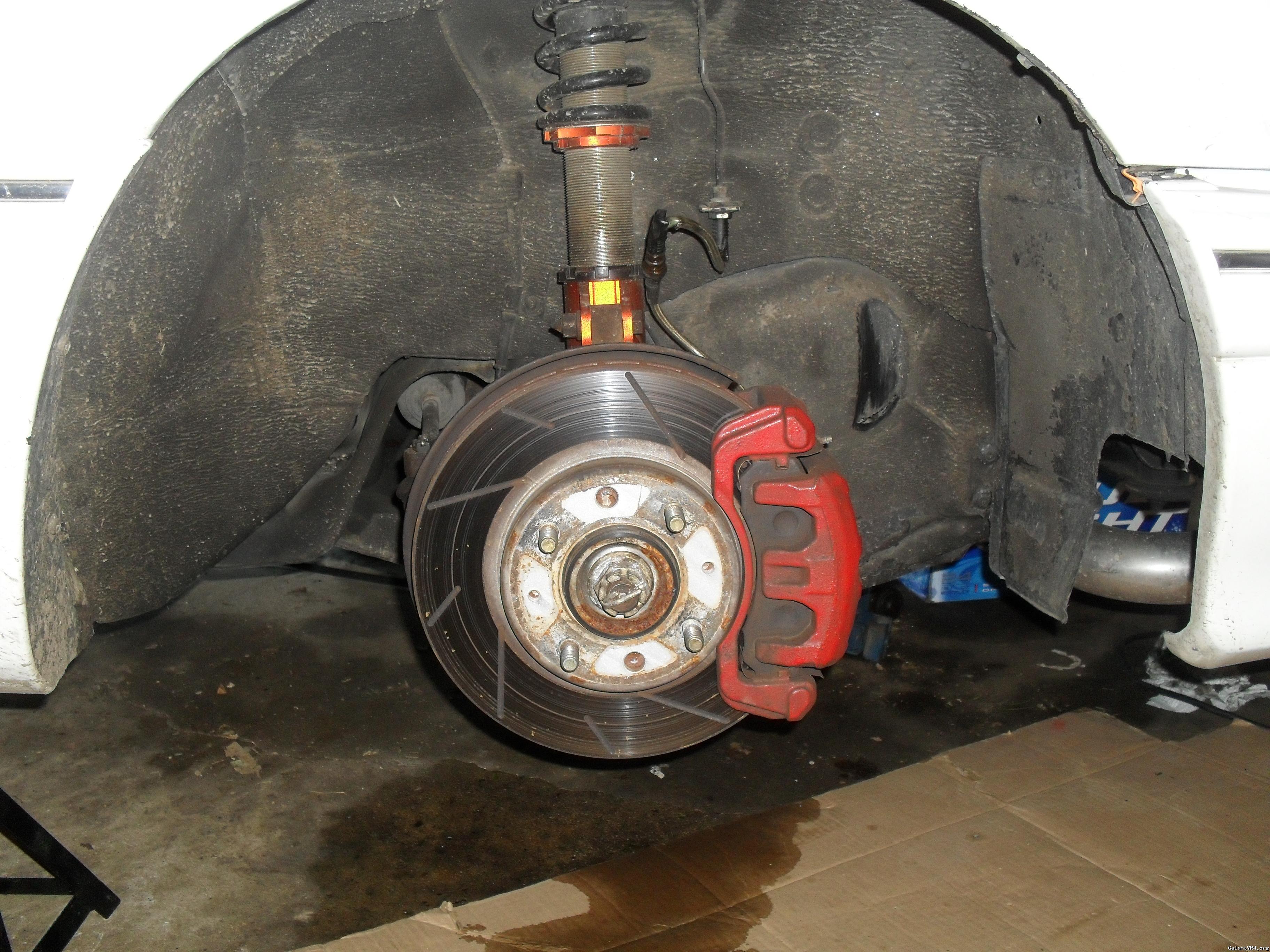

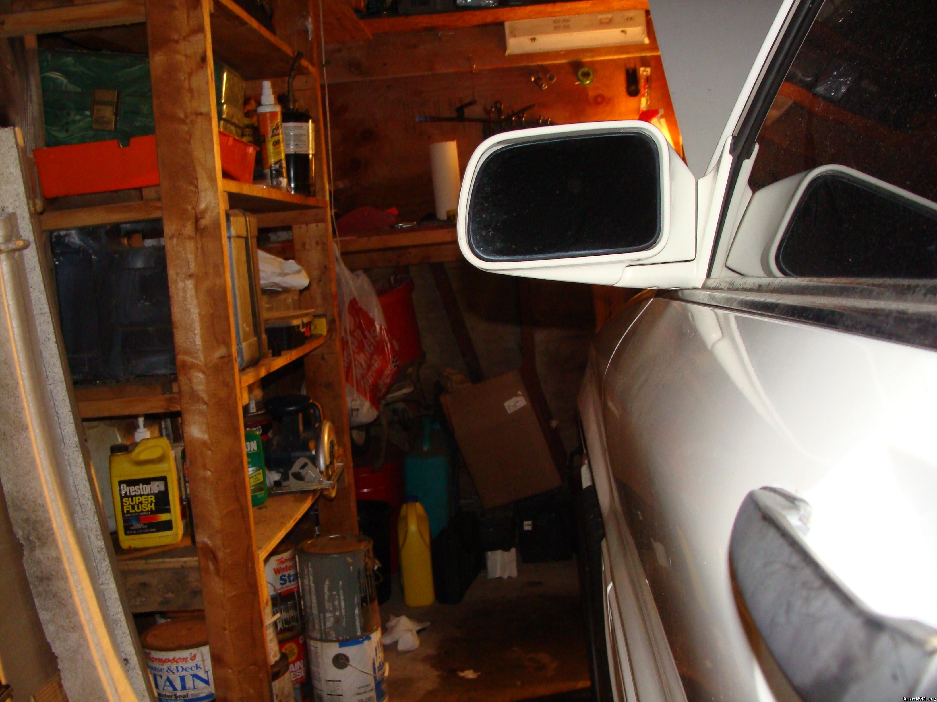

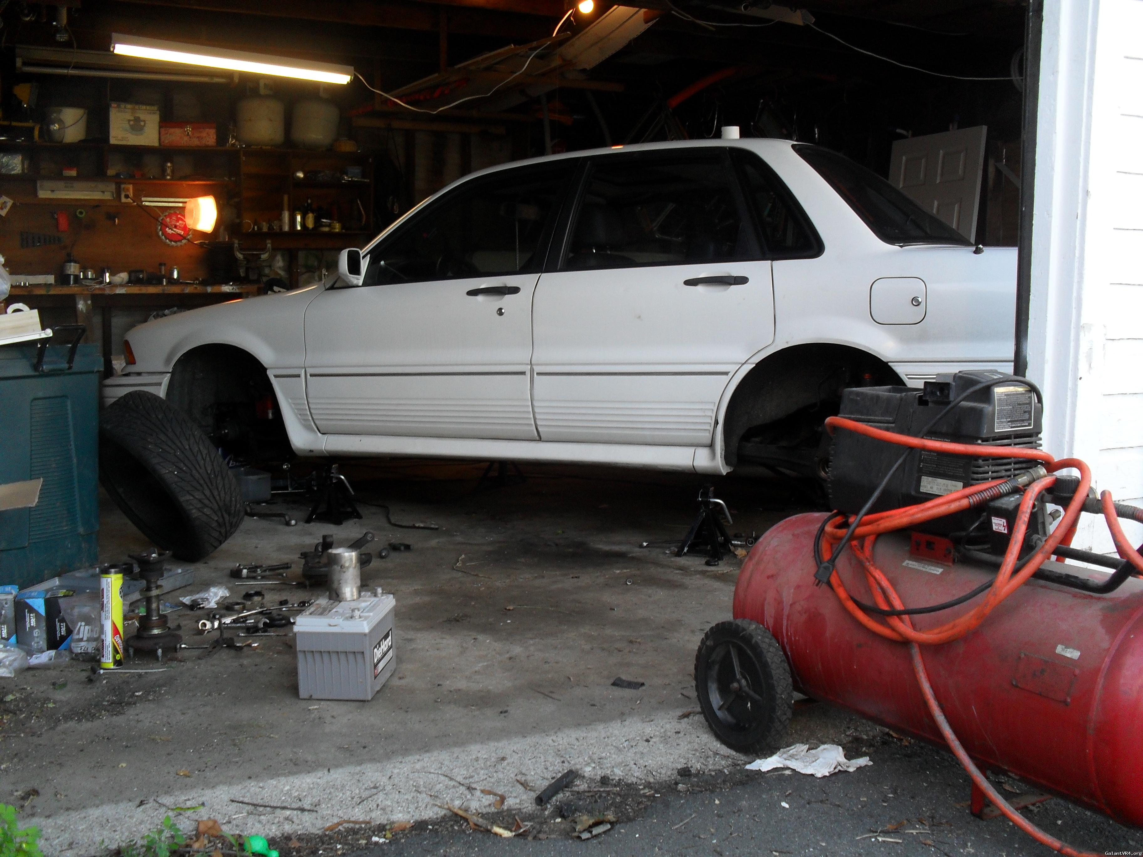

my car sideways in my 2 car garage lol

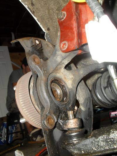

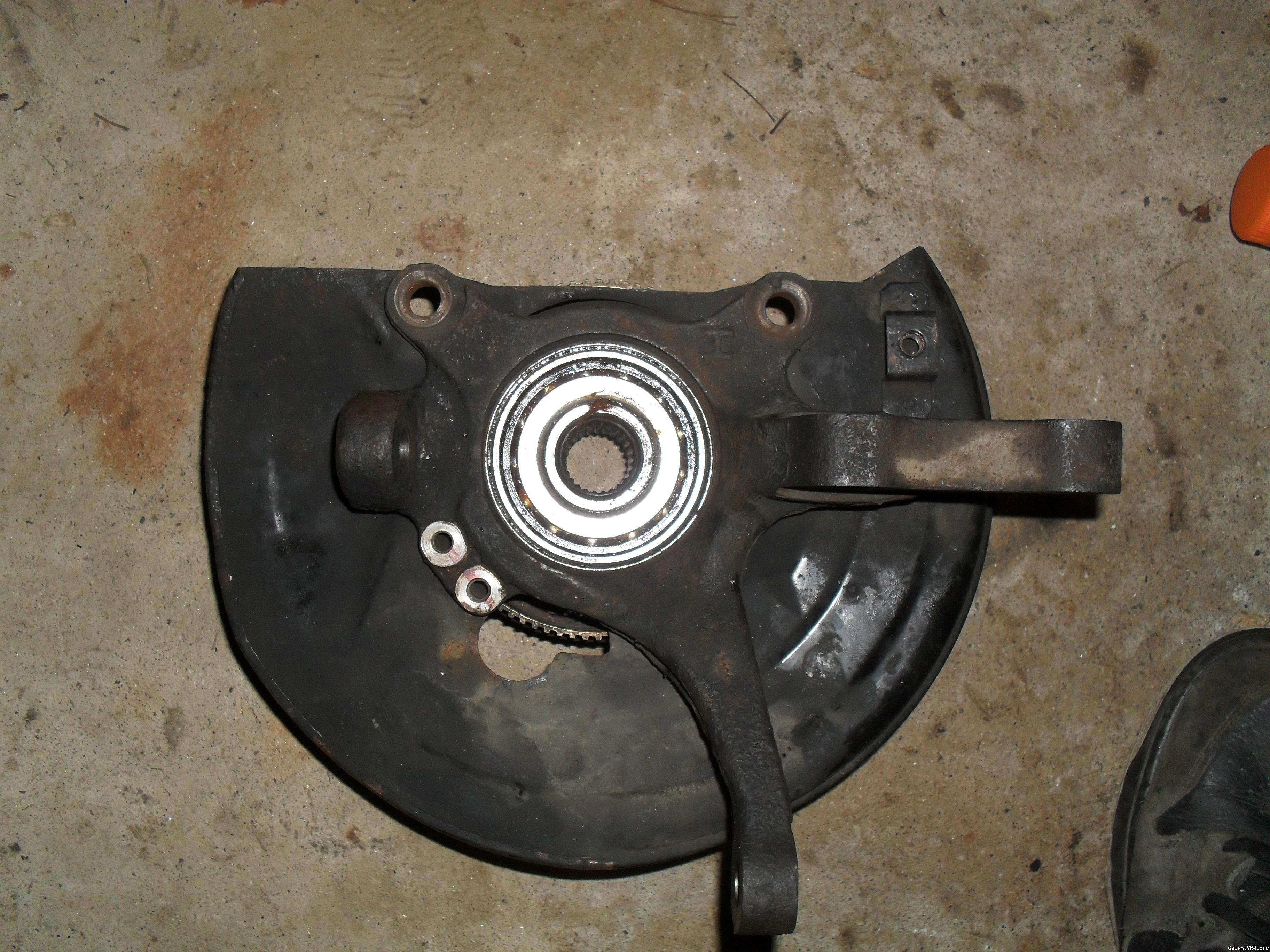

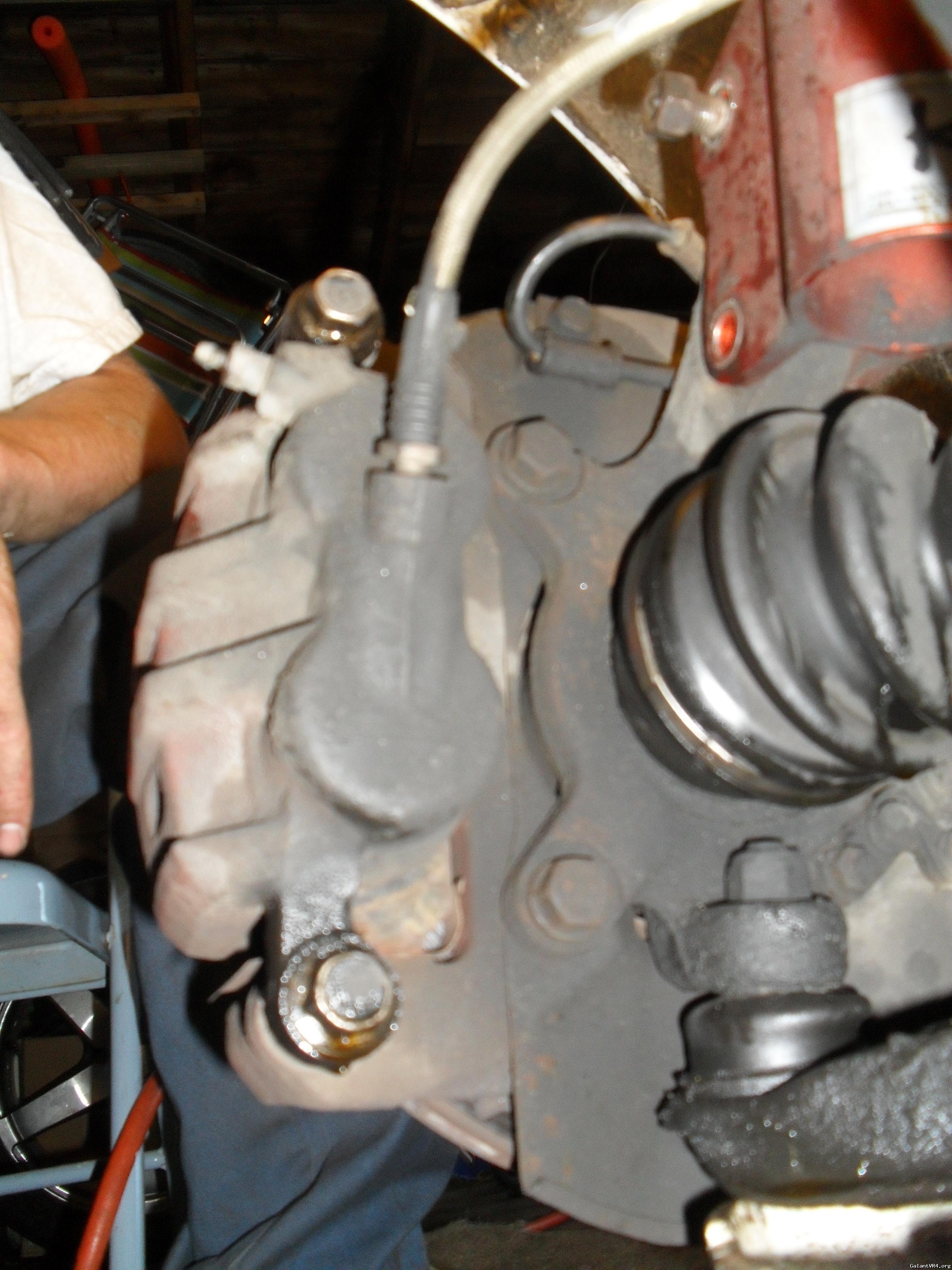

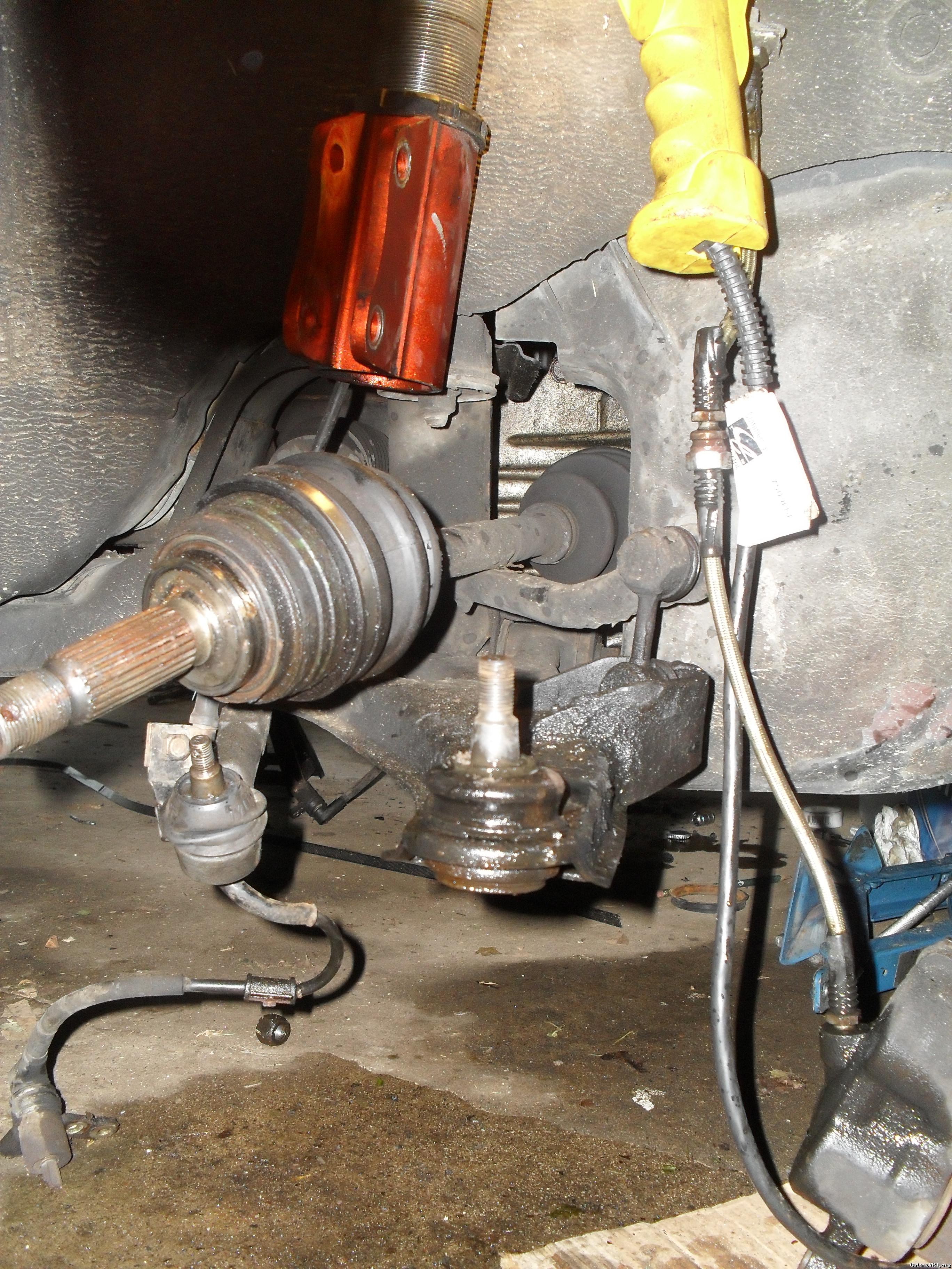

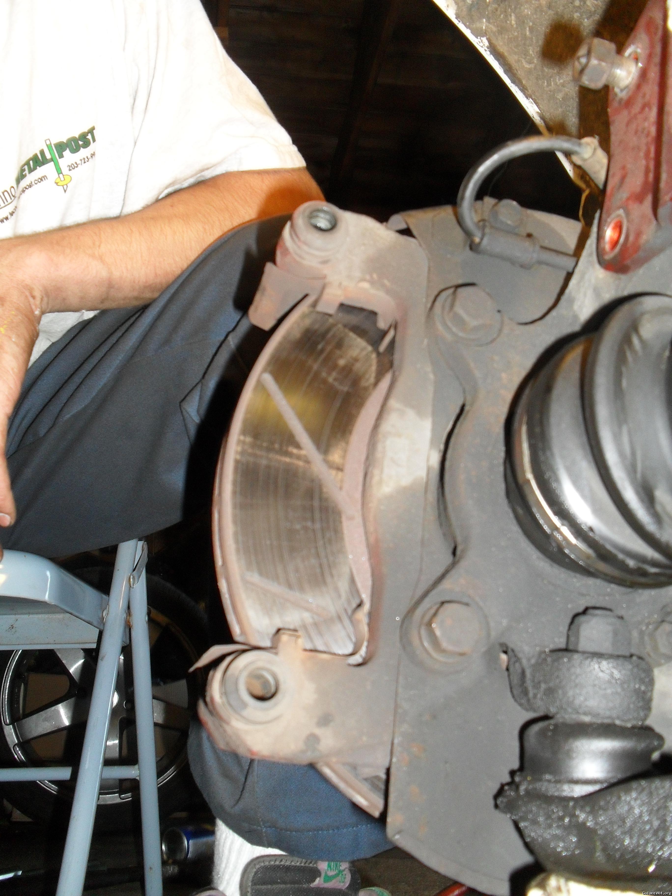

passenger front before: new ball joint, new wheel bearings

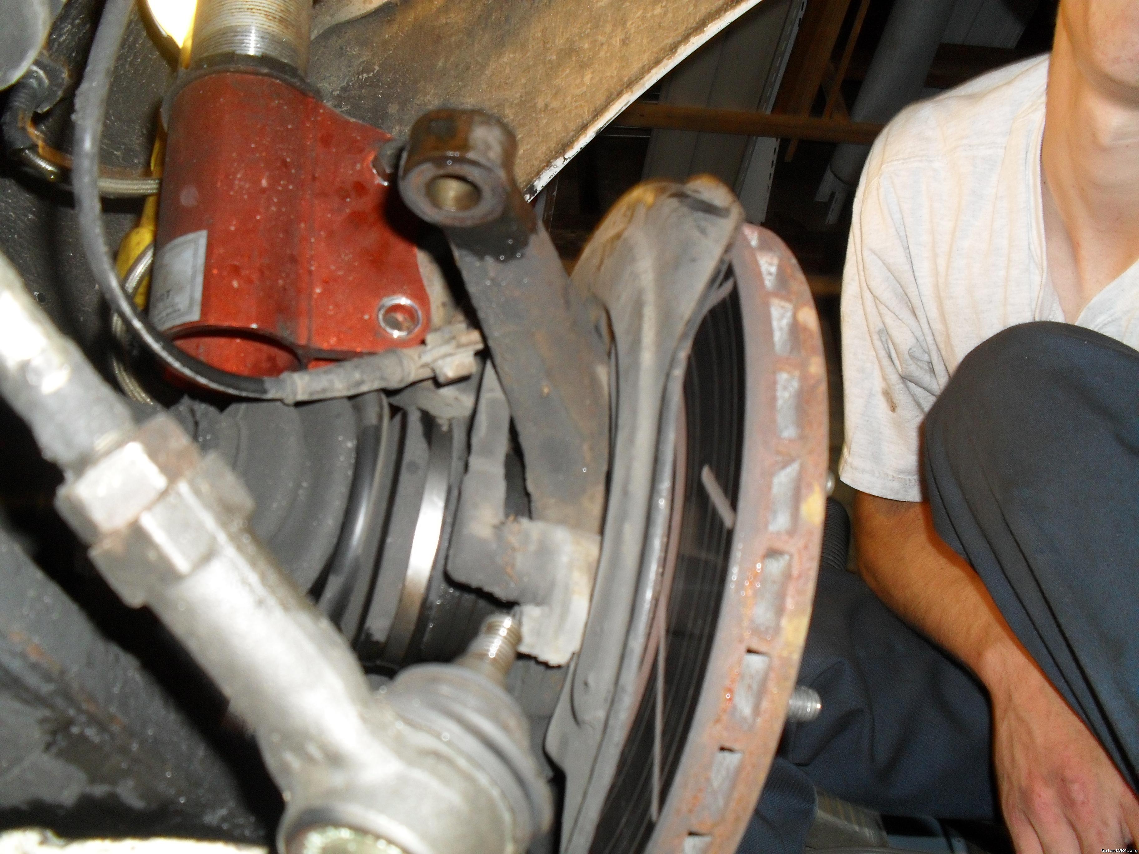

with a few light hits the new tie rods I had done a month before, came right out

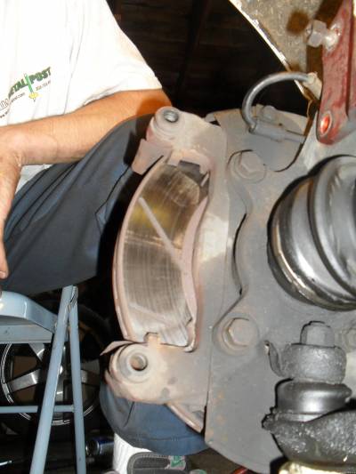

loosen up the bottom bolt on the calliper, lift up, an out
with the calliper out of the way you can remove its houseing thing

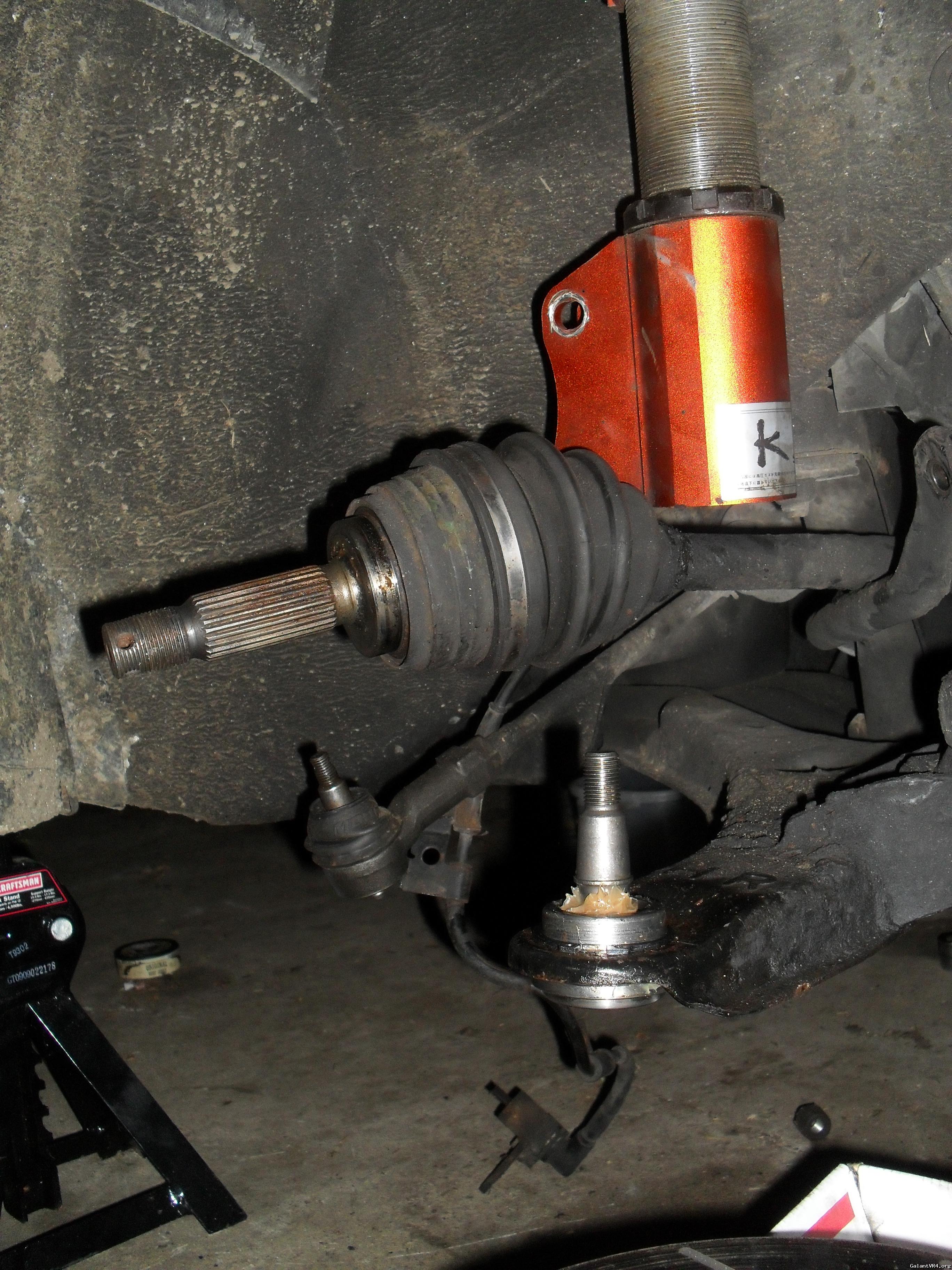

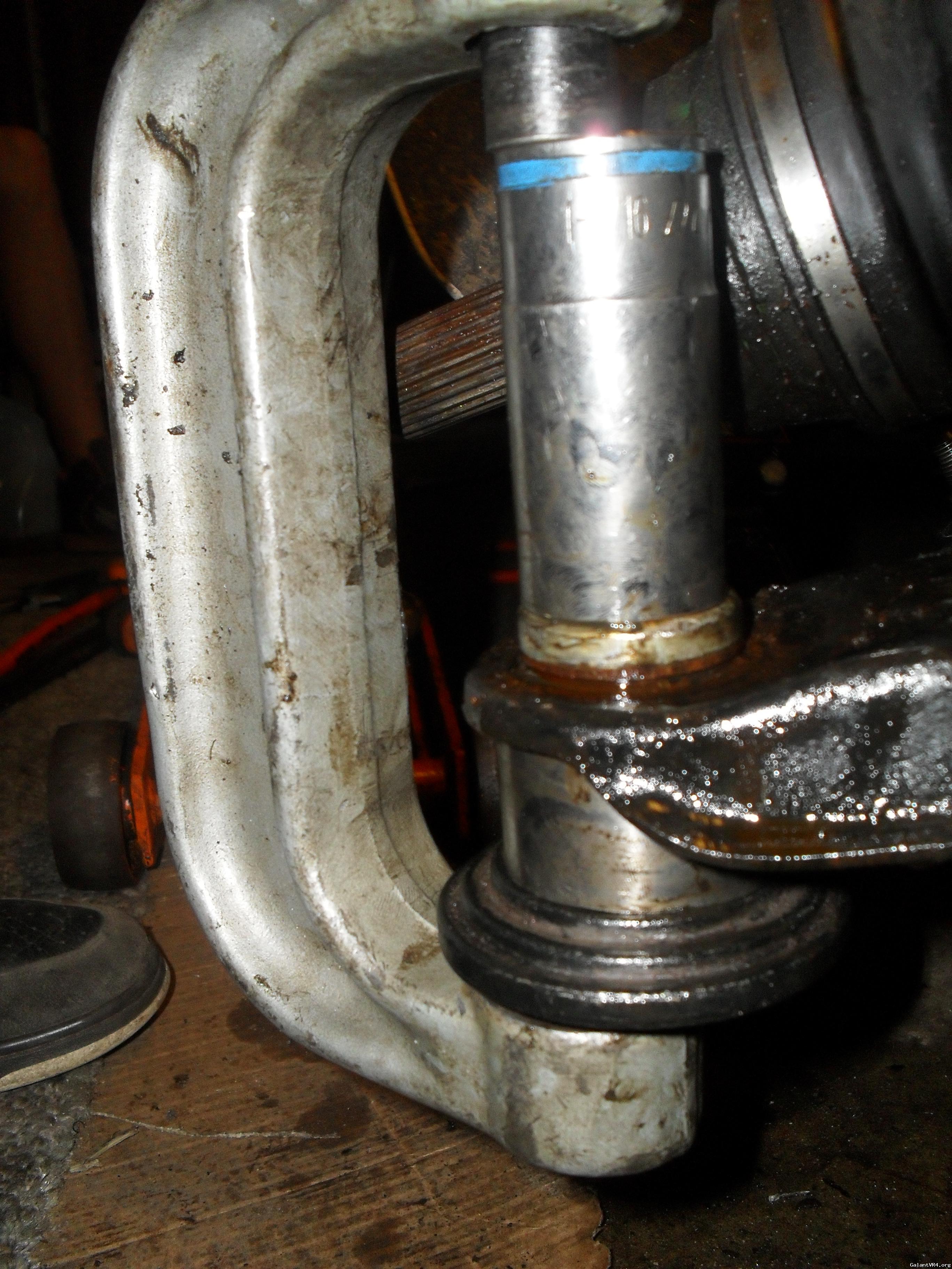

and then prep to get th ball joint out
after some wrenching
after some crazy hard blows at the casting the taper just popped right out

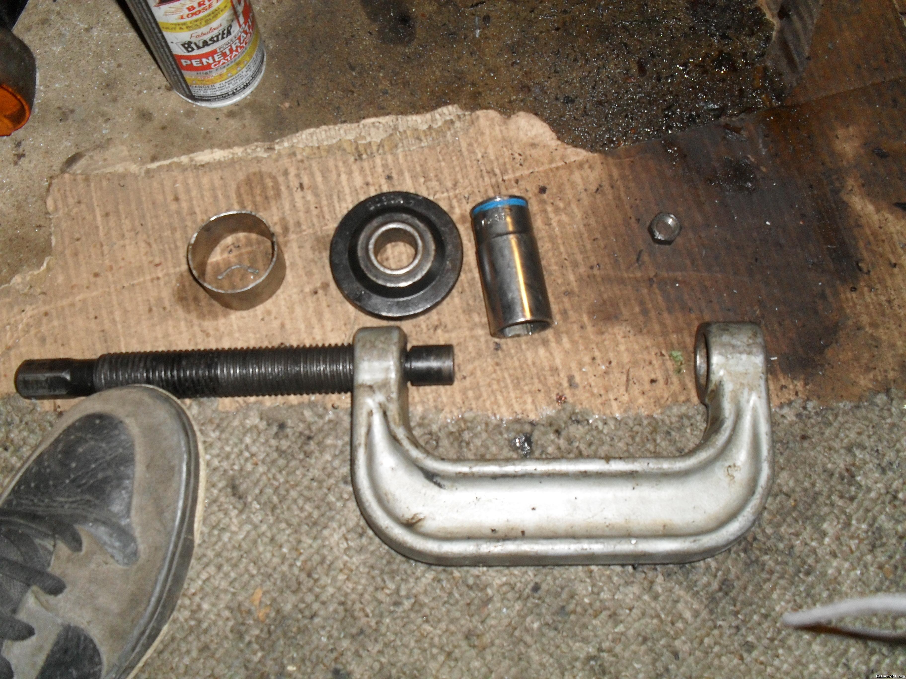

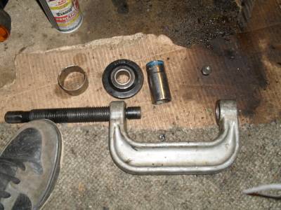

PB blasterrr. and just showing you the tools I use to get the fr ball joint out
came out easy enough, not as easy as the rears tho
AANND reverse, basically the same damn thing just assembling
and there in!
along with its new bearing the front hub can be put back in
Just a little update on what ive been up to out here in mass. im gonna finish up the this afternoon. take some more pictures of the rear setup, and some pics of my ride height I set last night /ubbthreads/images/graemlins/grin.gif
