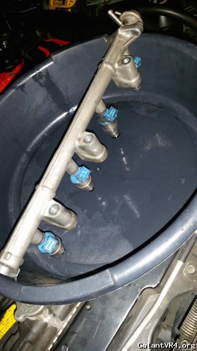

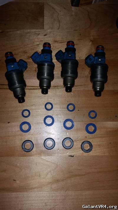

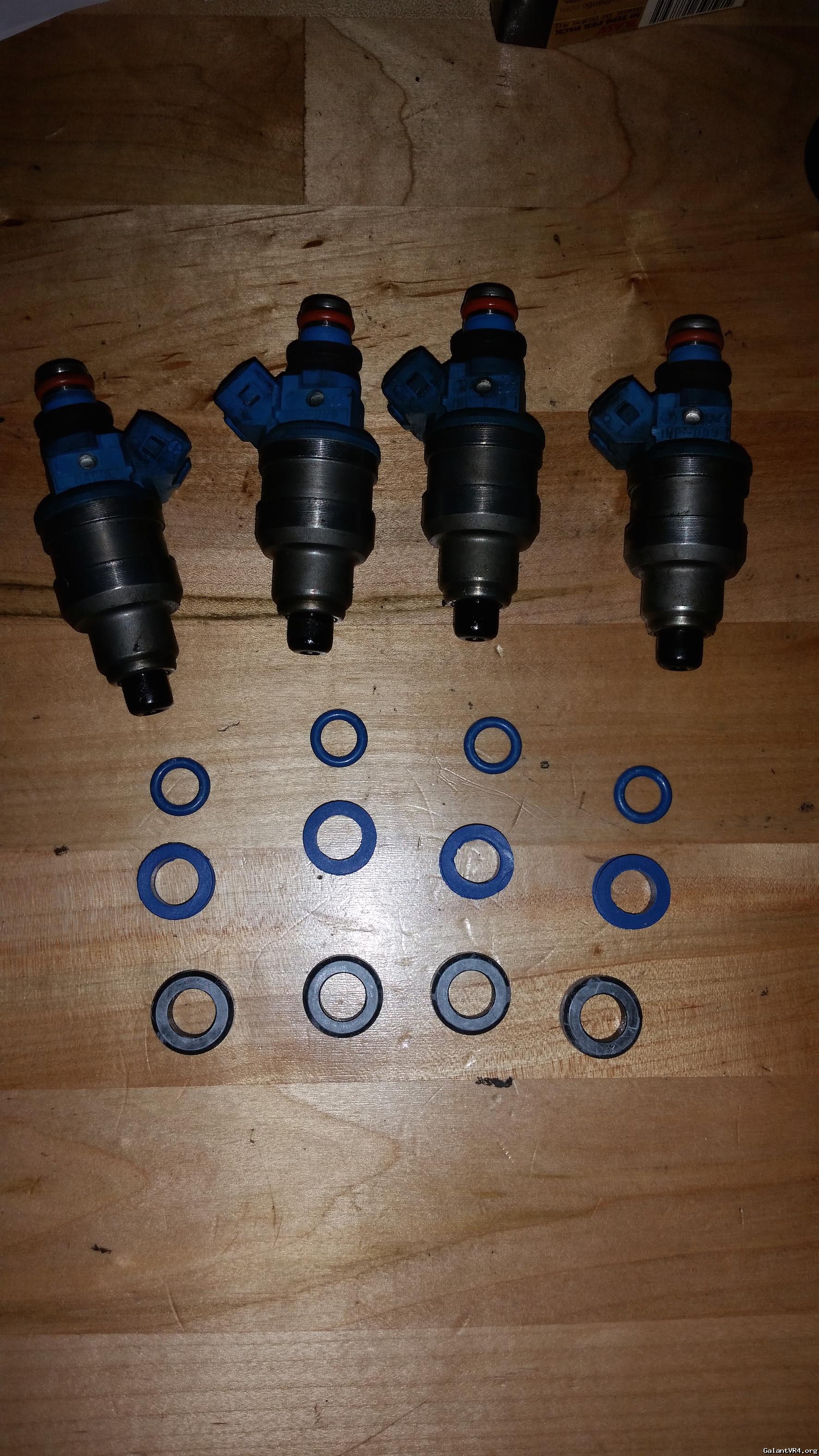

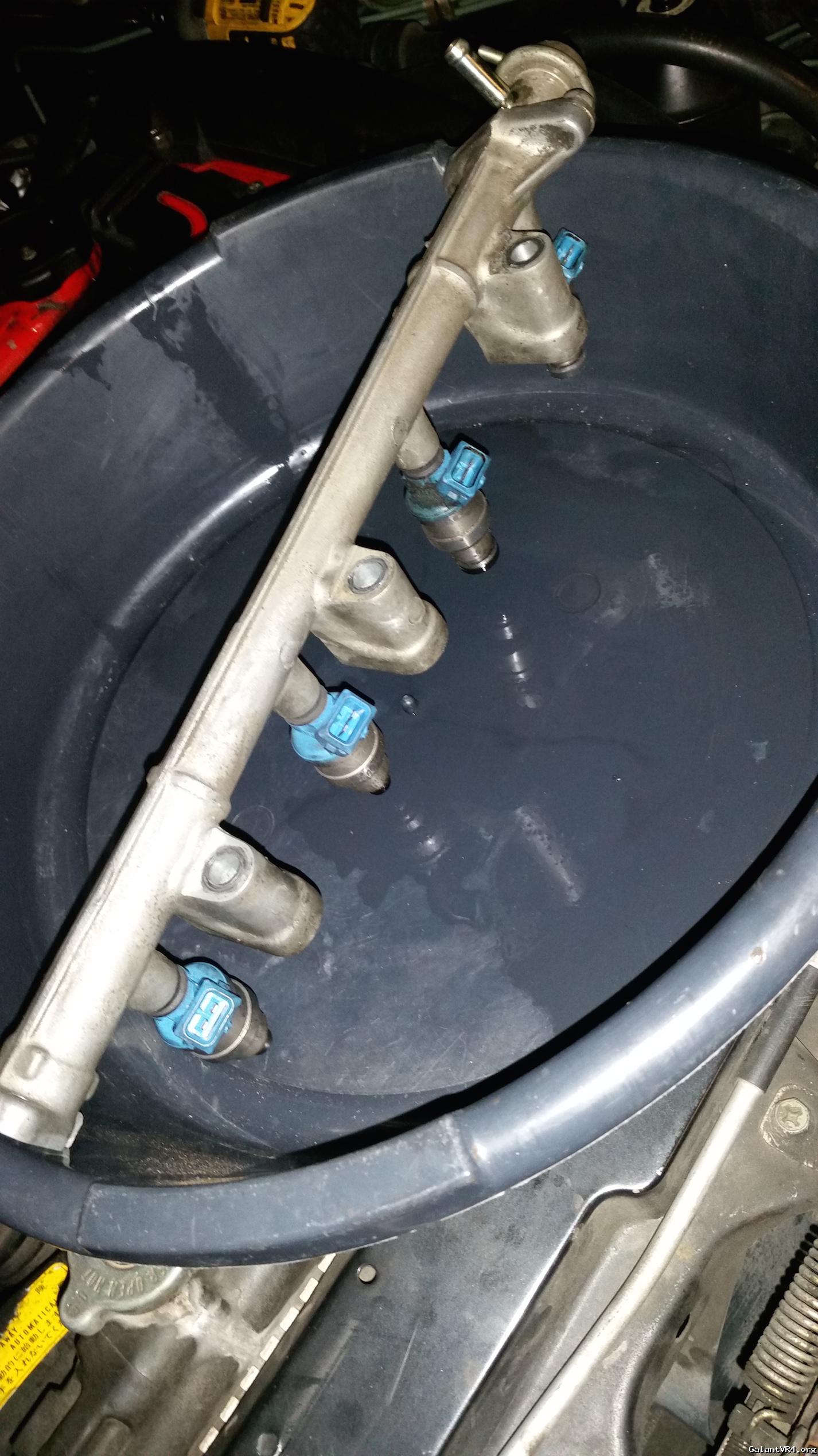

if you haven't put it back together you should find a place or person local to you that can clean the injectors while you have them out.

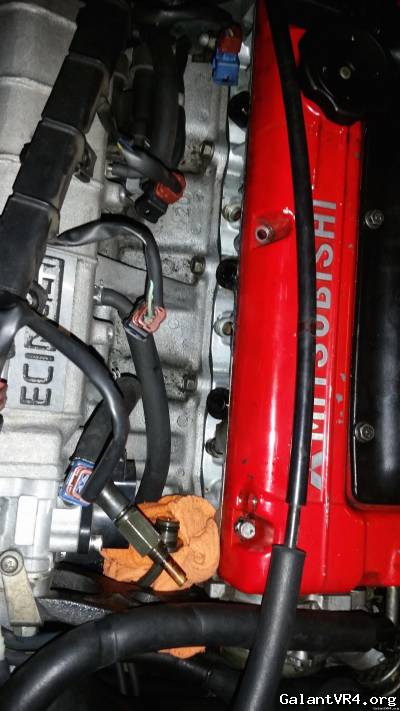

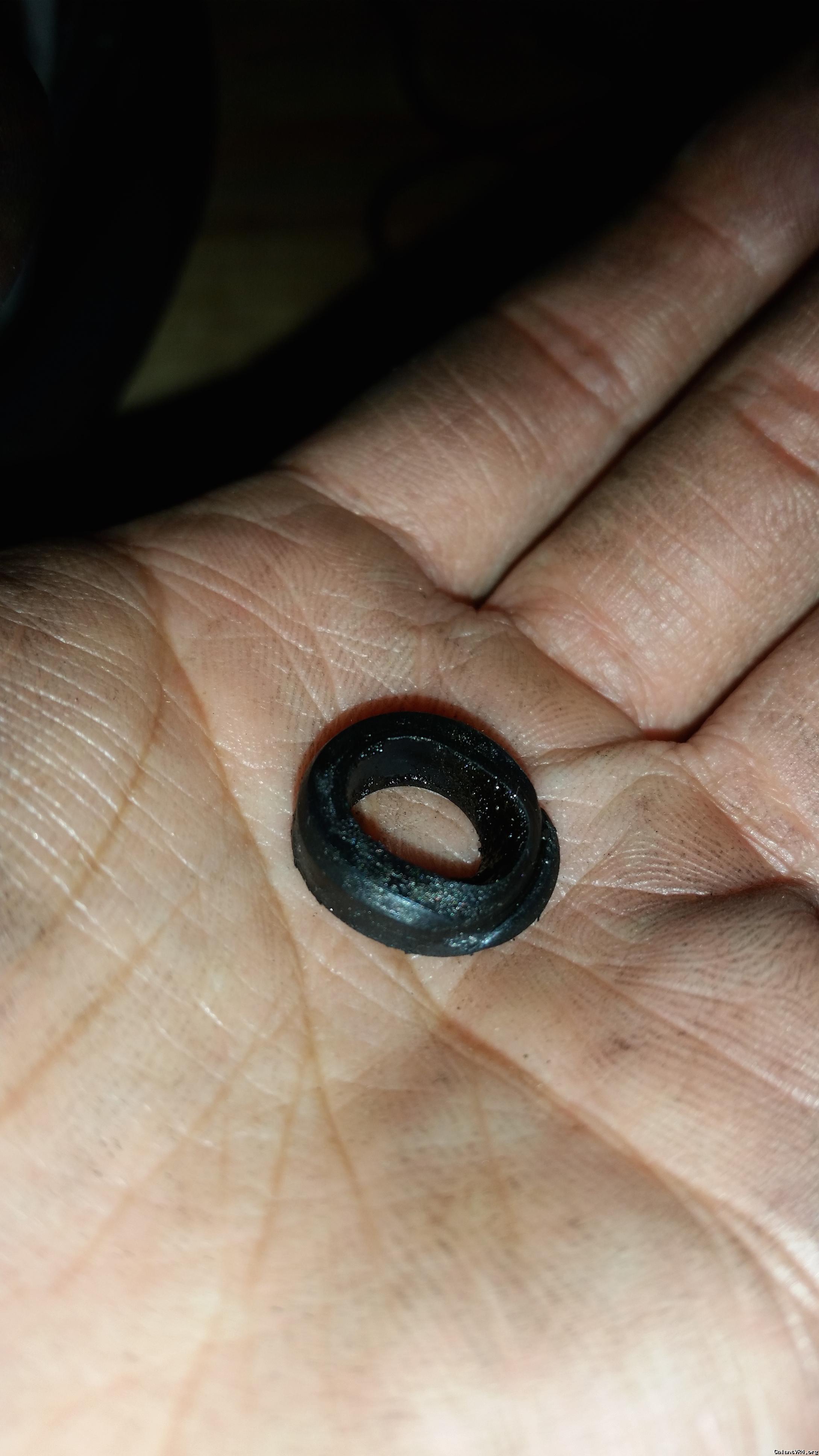

Exactly where my filler hose was leaking when I got mine haha. Nice bro keep at the build! /ubbthreads/images/graemlins/wink.gif
Yeah I didn't think of that until after I reinstalled the injectors. I had to get it all back together anyways since this is my only way of getting to work.
Thanks man! Yeah that hose was puking fuel. No bueno lol

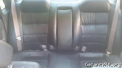

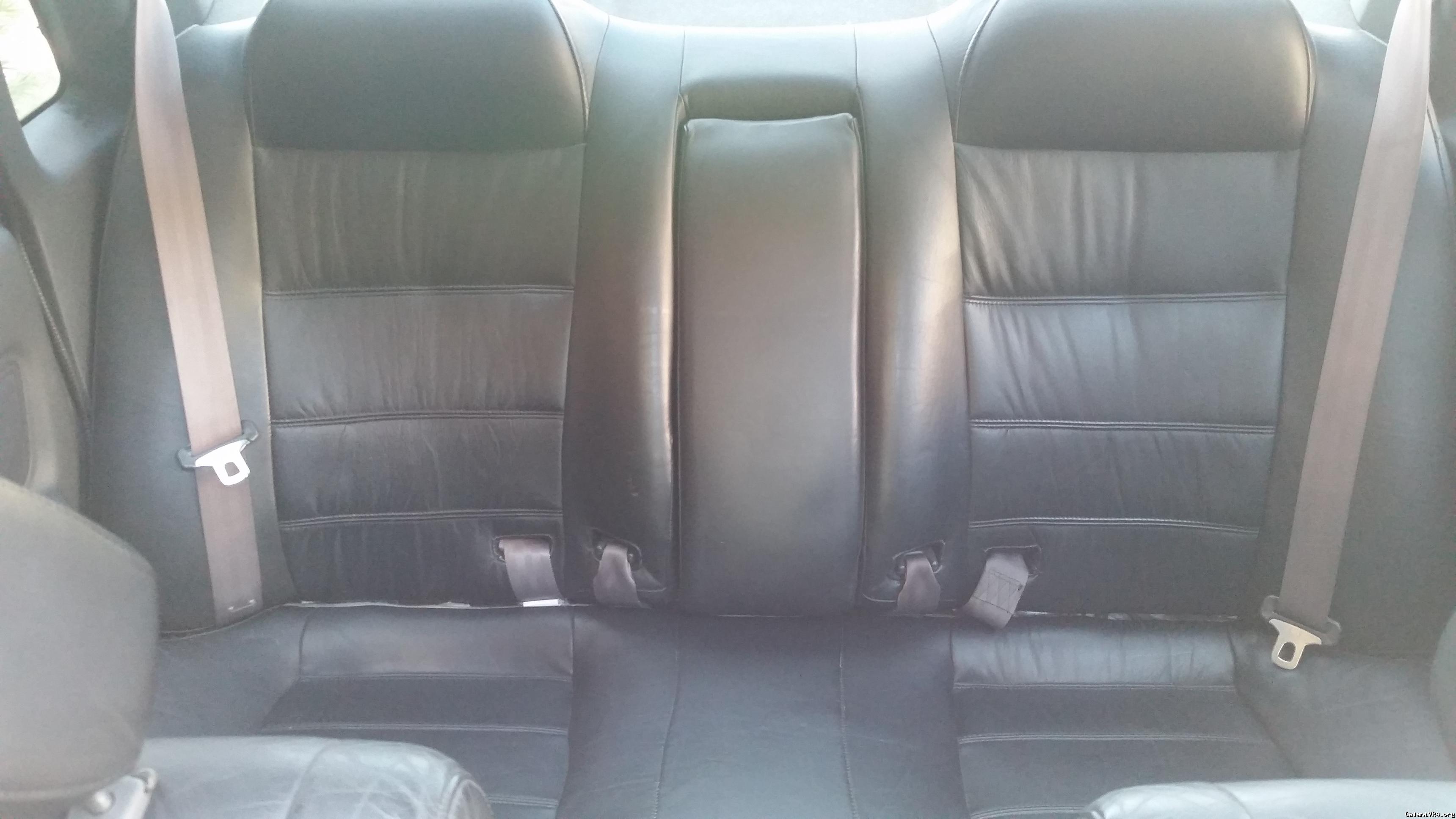

The carpet is cleaned, the front and rear seats look brand new and I'm a happy camper. /ubbthreads/images/graemlins/smile.gif Better photos later on.

Wow, the interior looks so clean. I should strip mine and do some cleaning too, but 2 other downed DSMs currently take precedence. Come up to San Fran and visit!

Thanks bro. Really took my time with cleaning all the trim pieces and panels and what not.

The interior came out great. Looks almost new.
Thank you. Trust me it looks better in person.

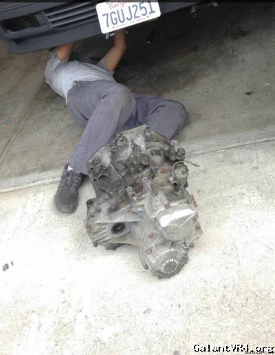

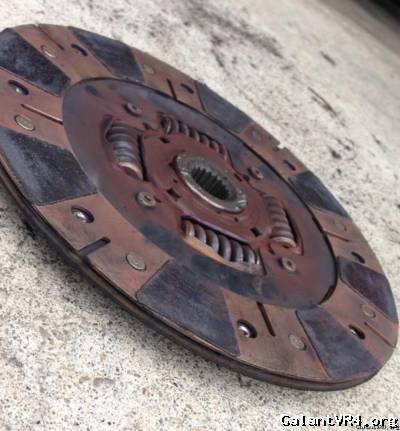

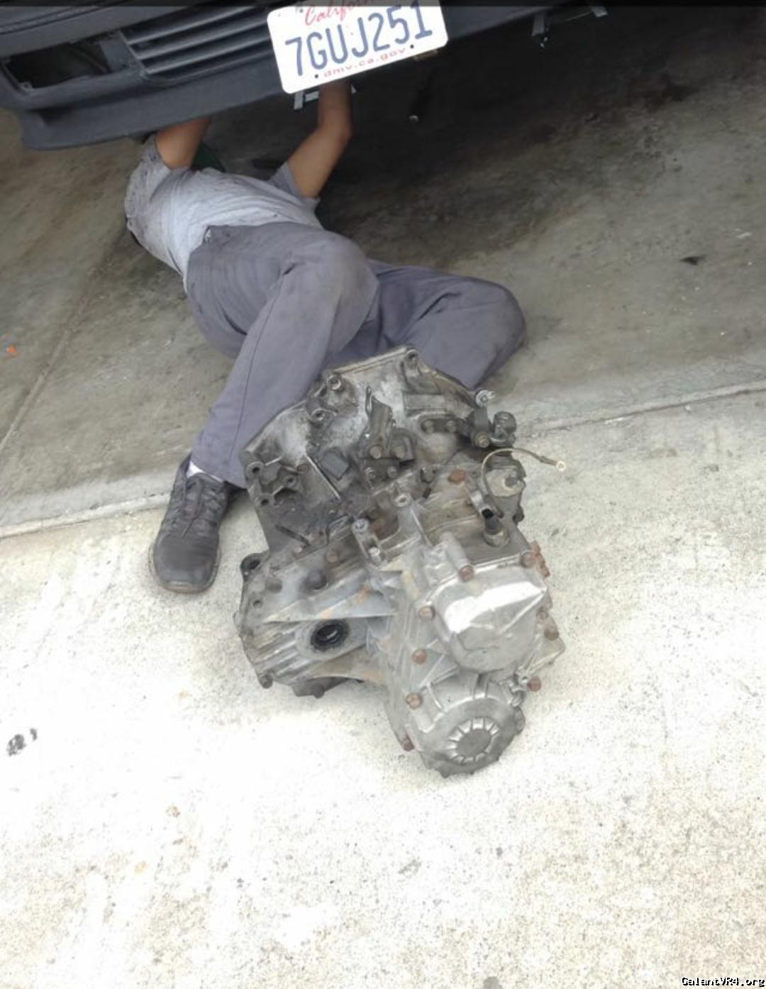

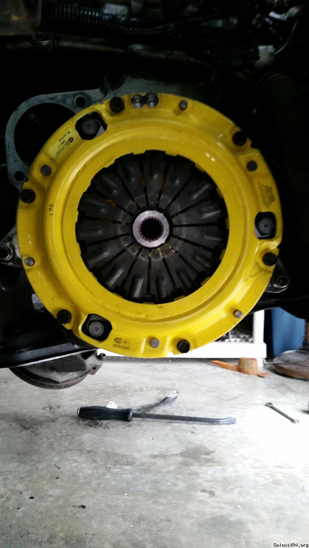

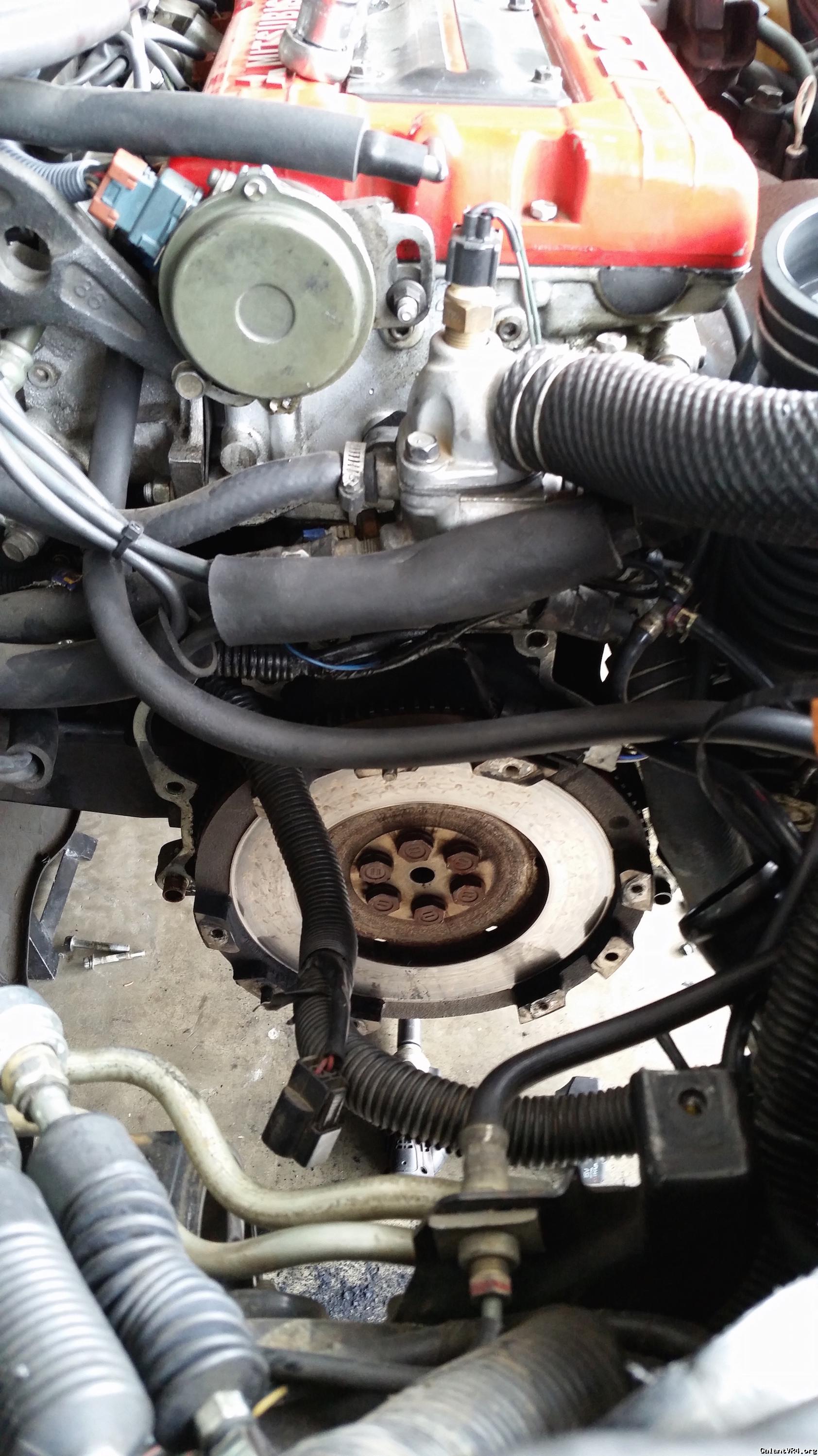

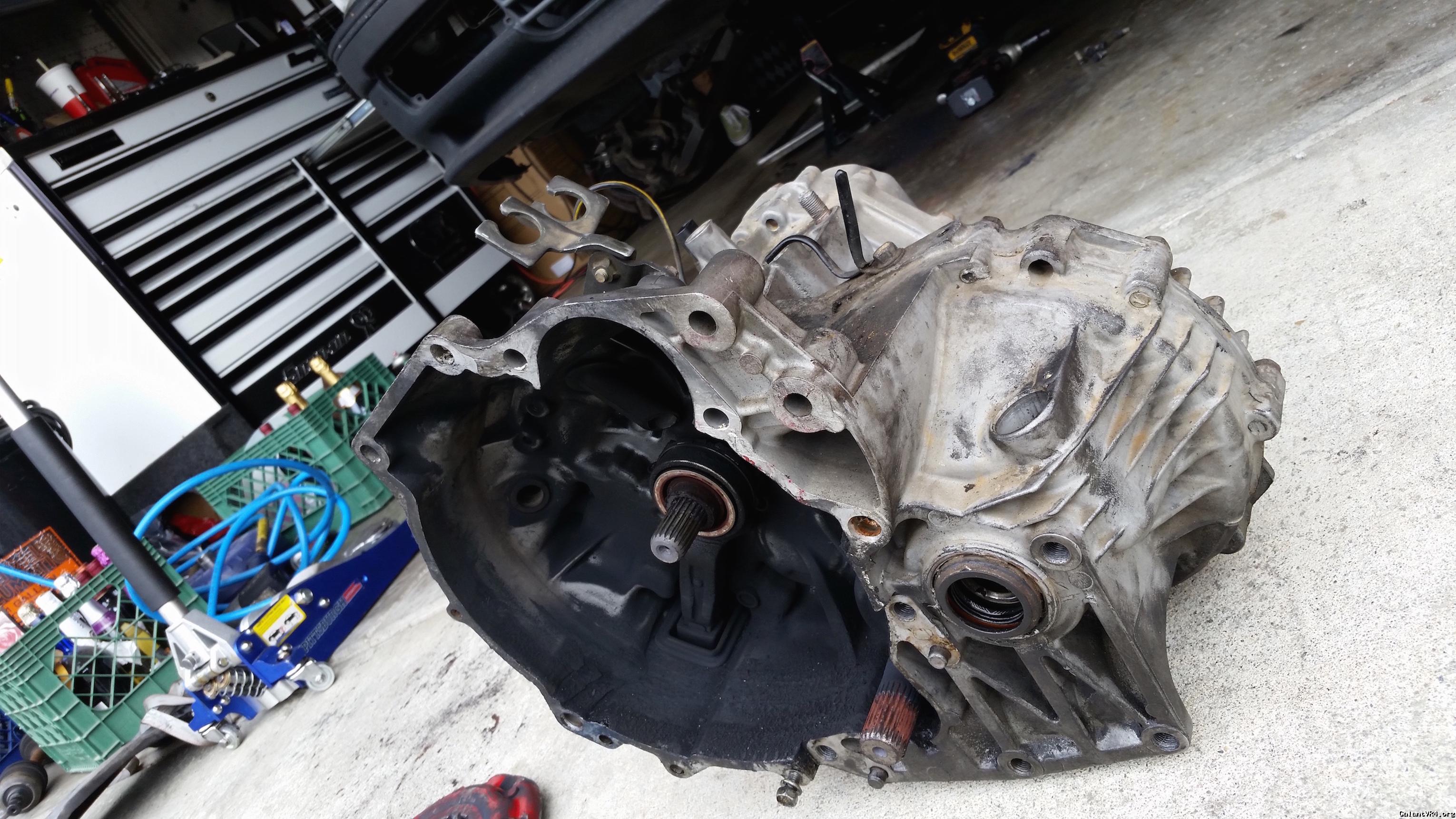

So I've been driving 1736 for awhile now and have been noticing really bad clutch slip issues. Did a lot of research as I was expecting to do my first clutch job. Time to dig in. /ubbthreads/images/graemlins/uhh.gif

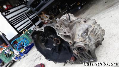

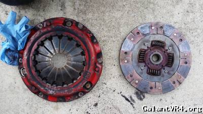

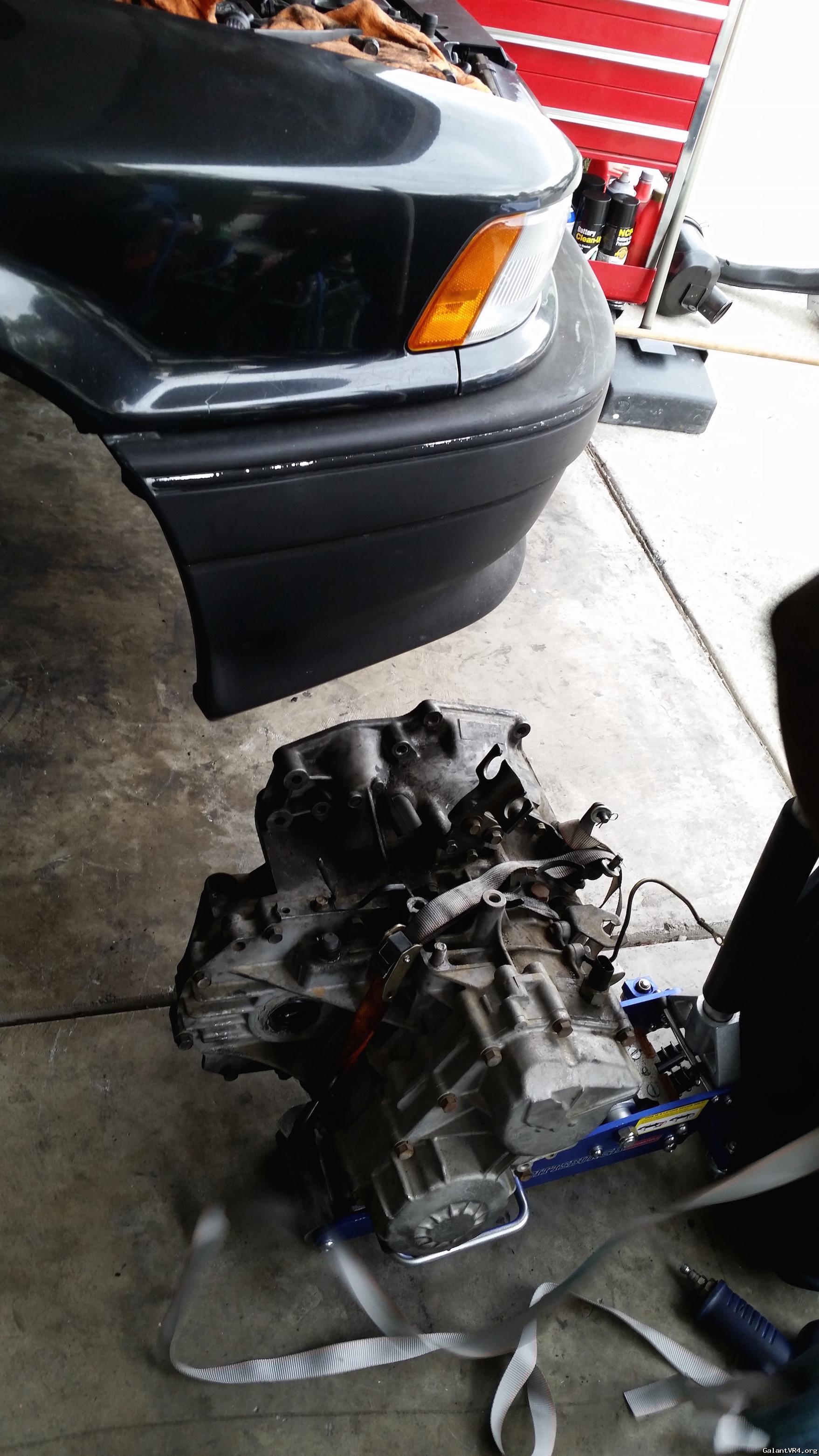

Got the transmission out and this is what I found.

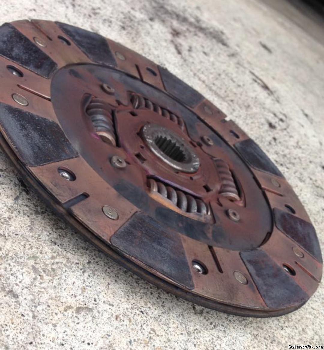

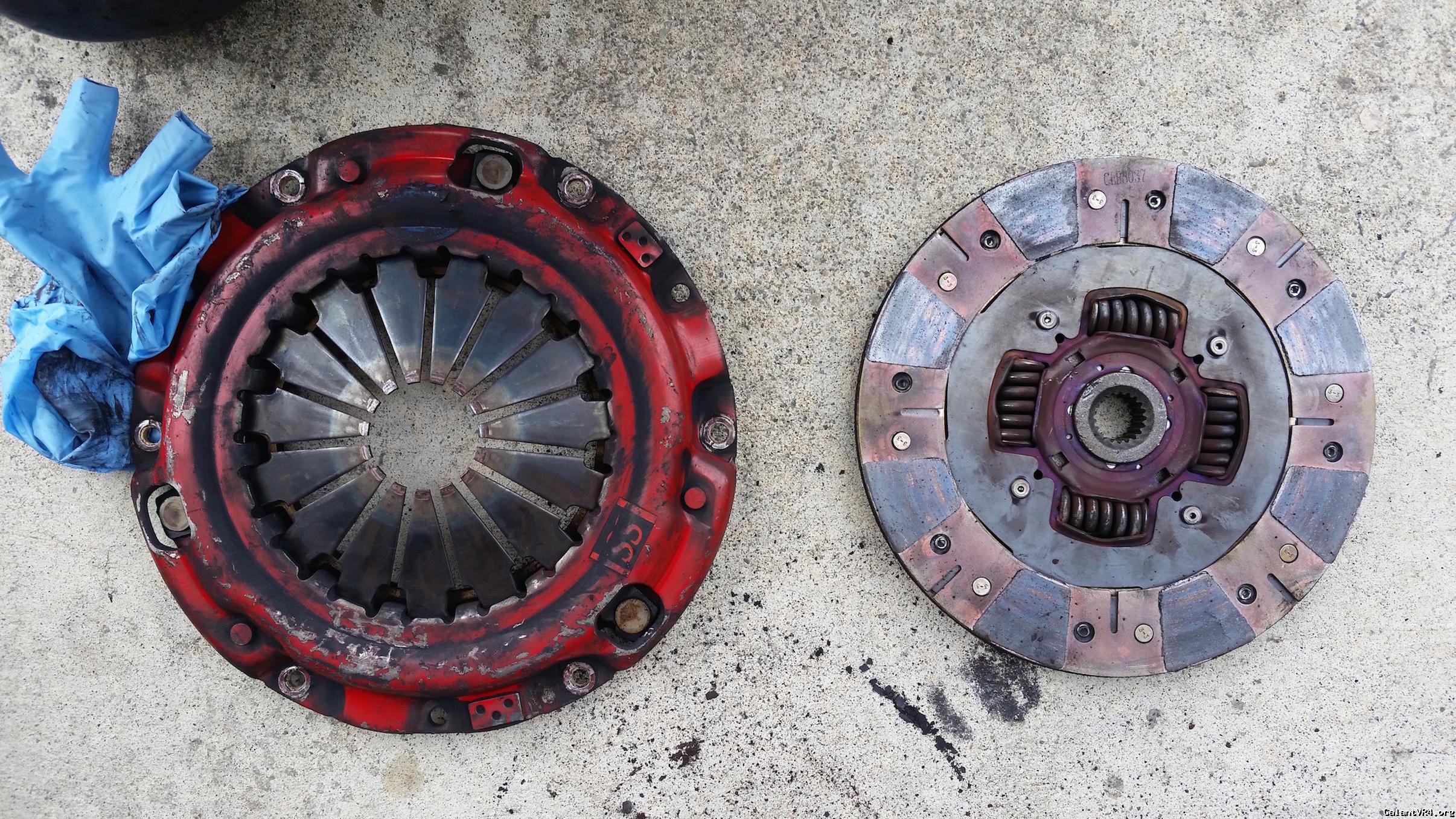

Got the transmission off and found the clutch disc with damn near zero friction material!! /ubbthreads/images/graemlins/jawdrop.gif

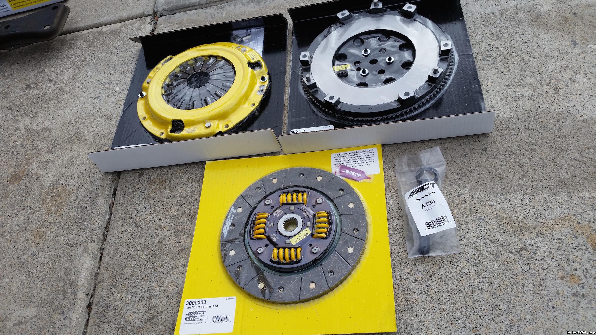

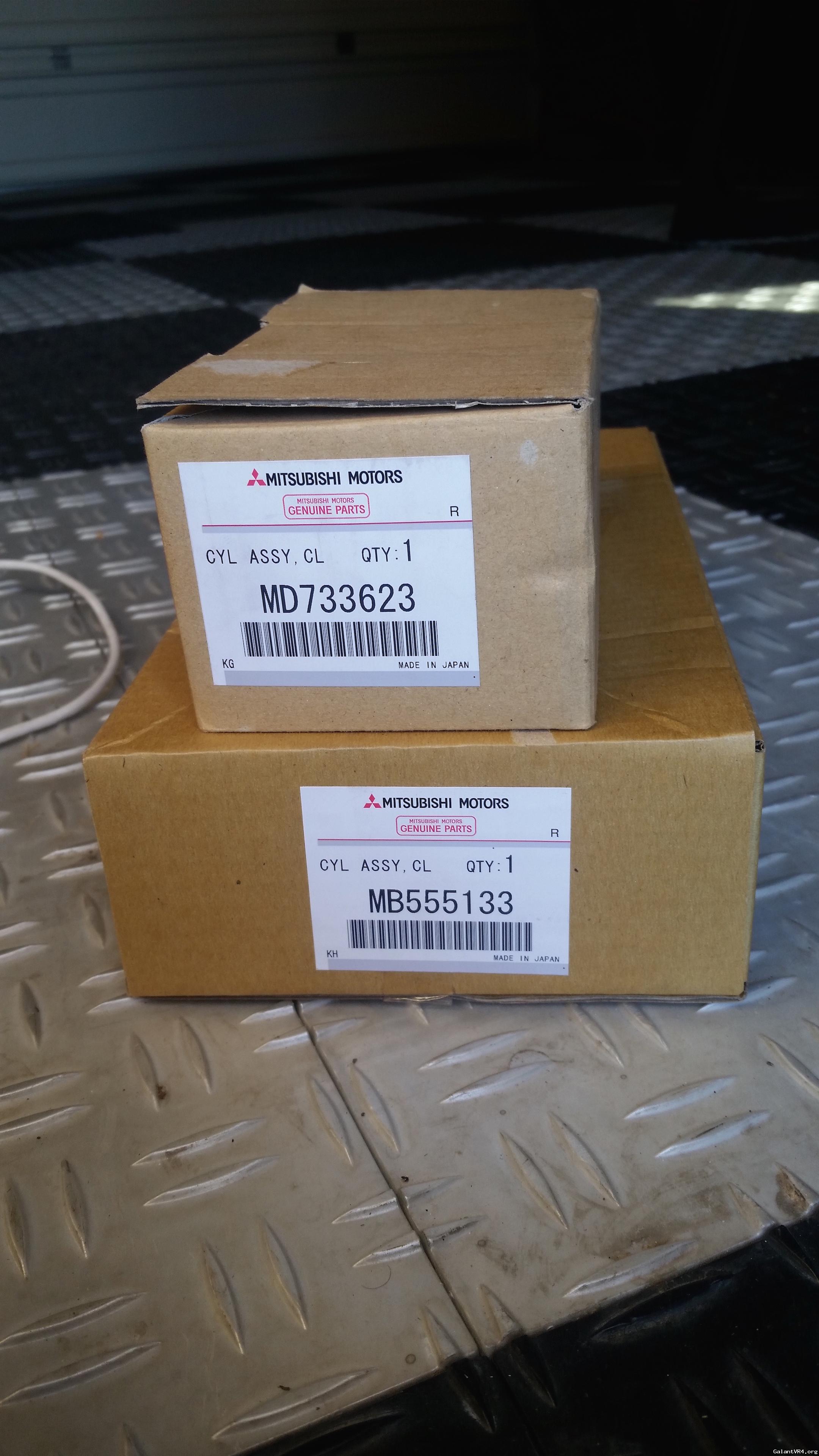

Figured I'd need a new clutch so here it is!
ACT 2600 xtreme clutch kit & ACT streetlite flywheel. Also got new OEM clutch master reservoir and clutch slave cylinder.

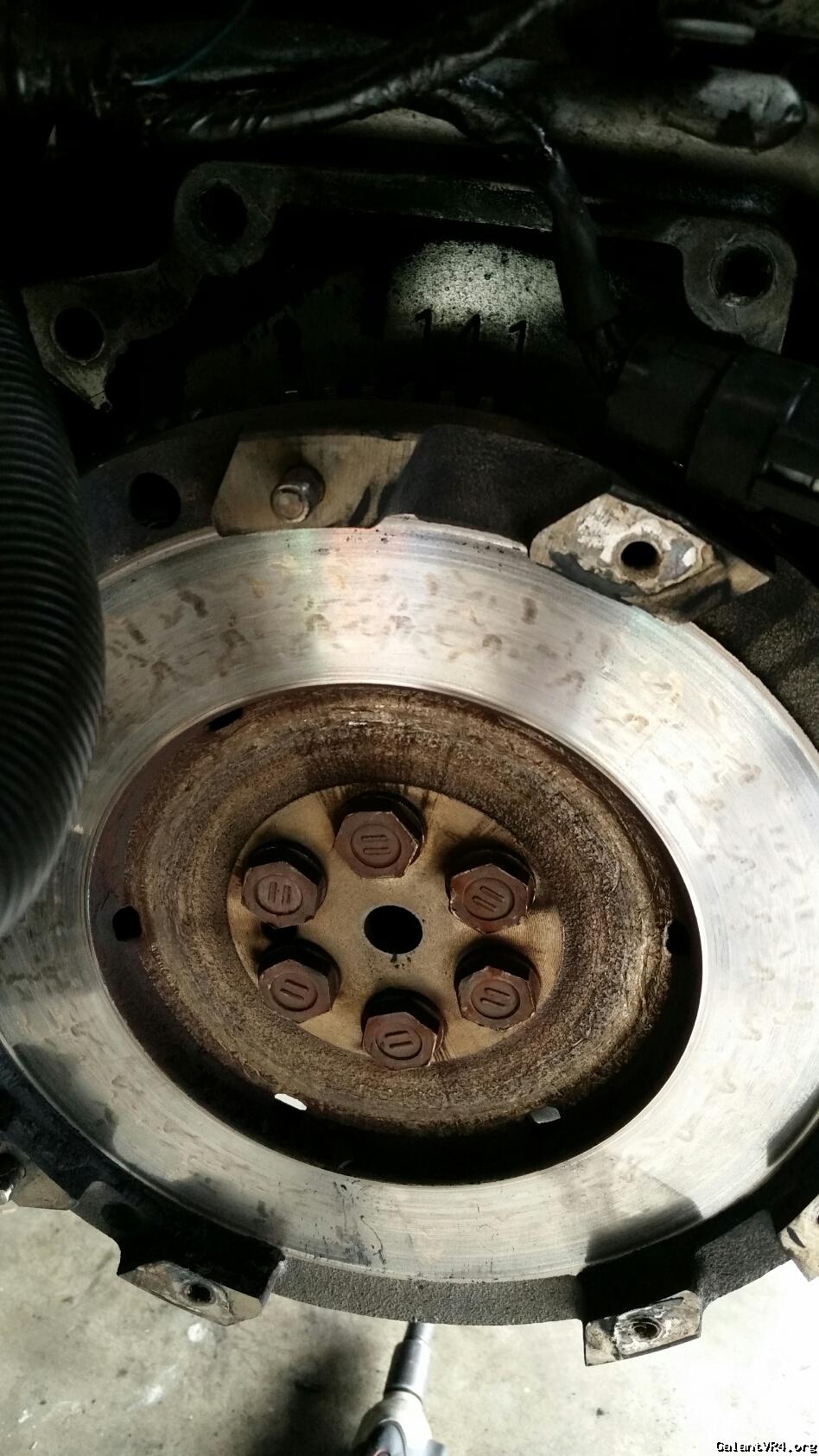

Here's a better look at the clutch disc and flywheel. /ubbthreads/images/graemlins/ooo.gif
Got everything torqued to spec with loctite on flywheel & pressure plate bolts
TRANSMISSION TIME!! /ubbthreads/images/graemlins/grin.gif
Got everything put back together and go out for a test drive down the street. Shifting is good, no slippage etc and everything checks out fine..until I pull up halfway up the driveway. CANT SHIFT INTO GEAR! When the car is running it won't let me shift in any gears. But with the car off it shifts in all gears just fine. Was afraid I had to pull the tranny out again.
Tried bleeding the clutch hydraulics again and didn't help. Next day I do more research and find possible simple solution. CLUTCH ADJUSTMENT.
About a half turn on the adjustment rod and it shifts no problem with car running or off.

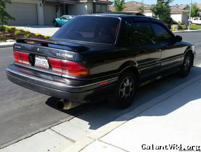

So here is how 1736 is sitting now. With the new window deflectors, new clutch & brake components and no paint on the wheels.

Congrats on what looks like a pretty good GVR4 overall condition wise minus all the stuff you had to replace but it looks like either normal wear and tear and some shotty work from a shop or person.
Either or ...at least its not a rotting rust bucket and still can be fixed and driven again. Congratulations! /ubbthreads/images/graemlins/cool.gif

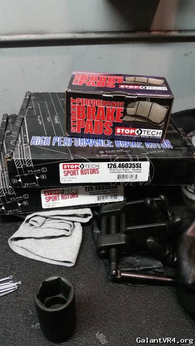

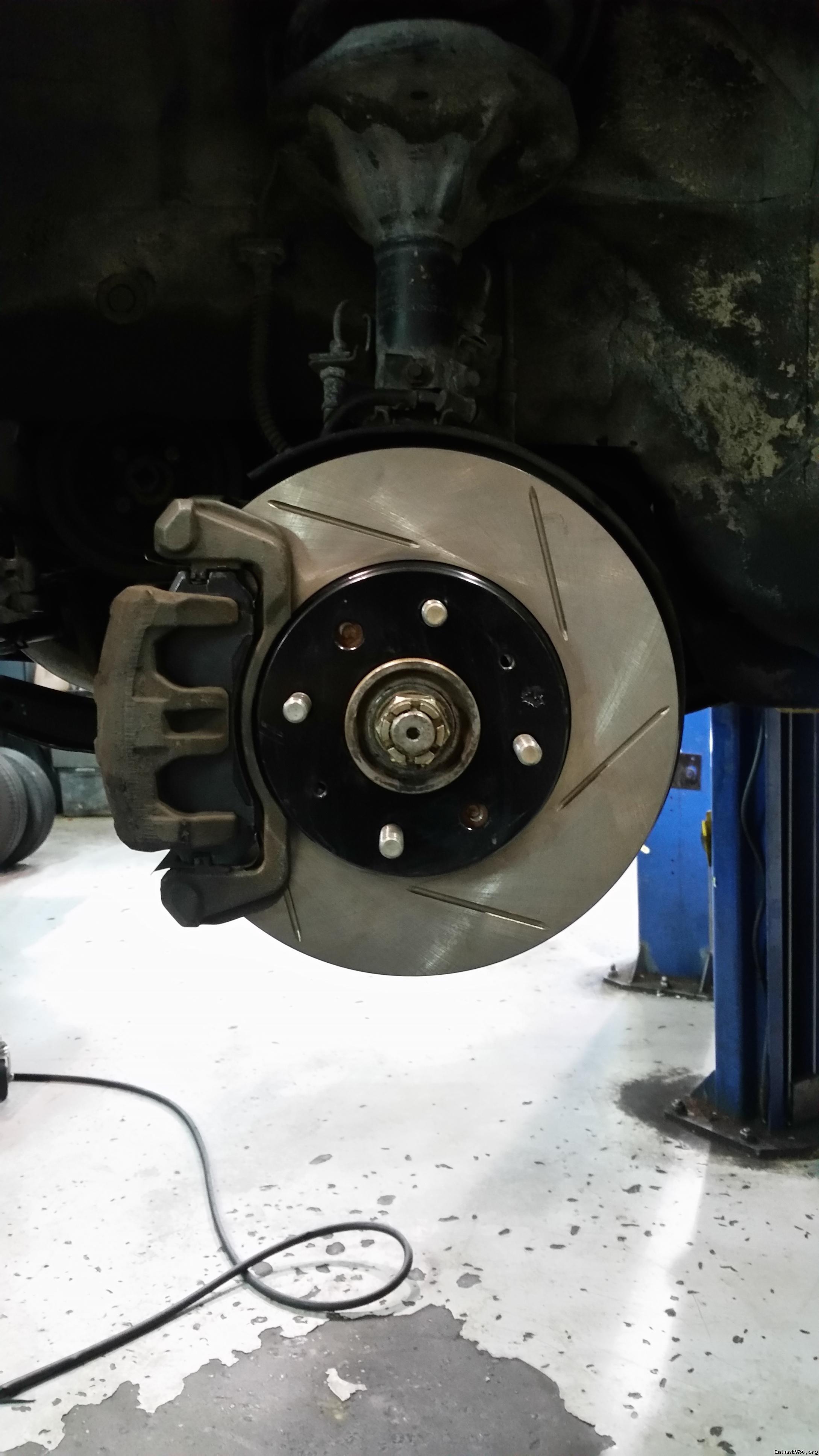

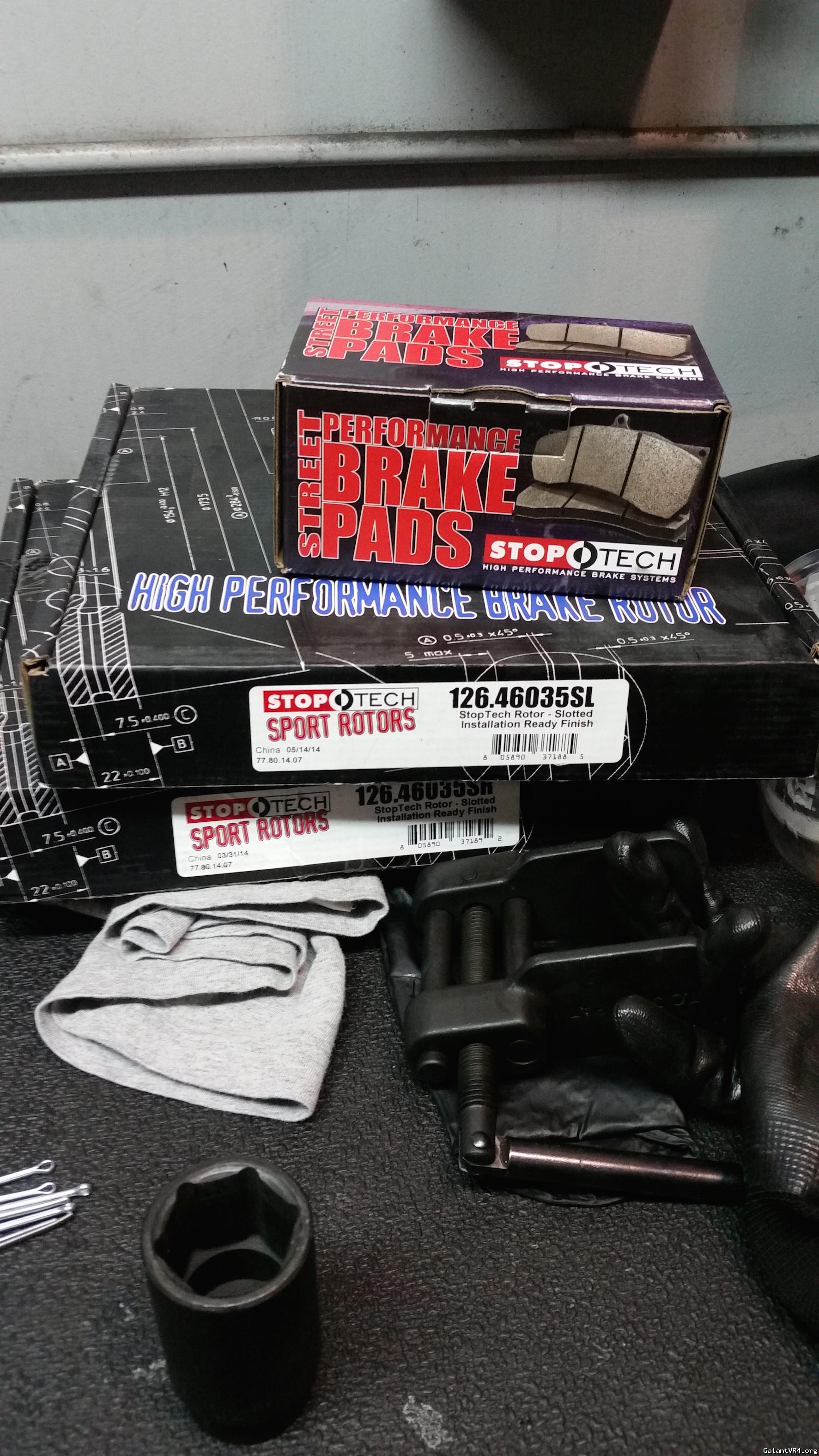

Bought Stoptech front slotted rotors and pads from Charles (bobdole) Very satisfied. As long as I can stop the car safely I'm a happy camper /ubbthreads/images/graemlins/grin.gif
Didn't get much photos as I was in a hurry at work. Wanted to finish as fast as possible before my boss wanted me to do more work. /ubbthreads/images/graemlins/devil.gif
