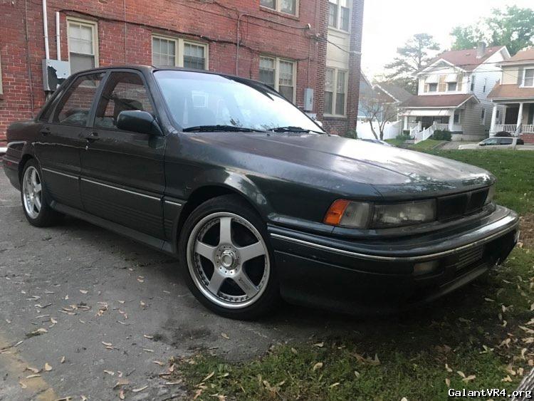

Hello everyone, I am new to the dsm/gvr4 and even new to the mitsu brand.
I have picked up #1519/2000 and have been working on it now for about a month replacing odds and ends, I cannot seem to figure out a metal on metal sound from the front but its still on going. not sure what else to put here but I am sure that I will be looking to you guys for some assistance and am going ahead and thanking you all for the guides that I have already used. And, man this car came with a trunk full of oem spare parts that I am still trying to go through.
If anyone has a C5 center cap.... ooooof I would love you
