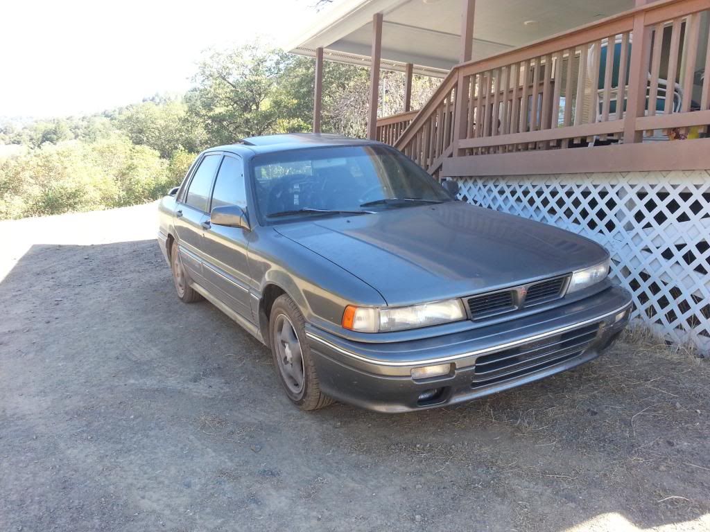

Congrats on the buy man. Car looks really clean.
Where are the pics?
OP, congrats on the new car. I have a 2g MAS, EVO injectors, and a intercooler all listed in my ebay store. PM me if your interested, I should be able to hook you up. No ebay fees, and of course the Galant VR4 owner discount. /ubbthreads/images/graemlins/cool.gif

I'll get pictures up soon, my wife took it out shopping. I have a ton of leftover DSM and Evo parts, so that's where I'm going to start. I already have 2 sets of 560cc injectors, a couple intake pipes, some exhaust components, and tons of other stuff I want to sort though.

Yay for pictures. Thanks for the link. OP, car looks really nice. Kensington Grey is a color that has really grown on me over the years.

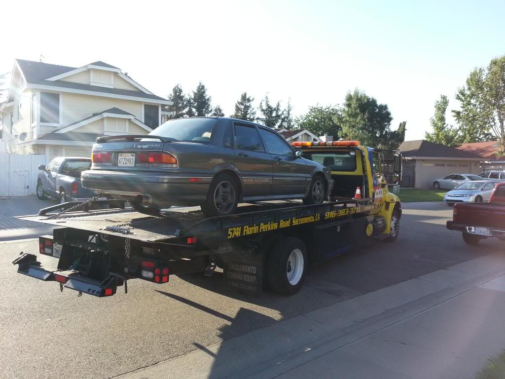

Turbo took a dump on my way home from work Wednesday, but I picked up a 16G last Tuesday.
My GVR4 got it's first tow (in my ownership). 16G going in this weekend, with a MBC.

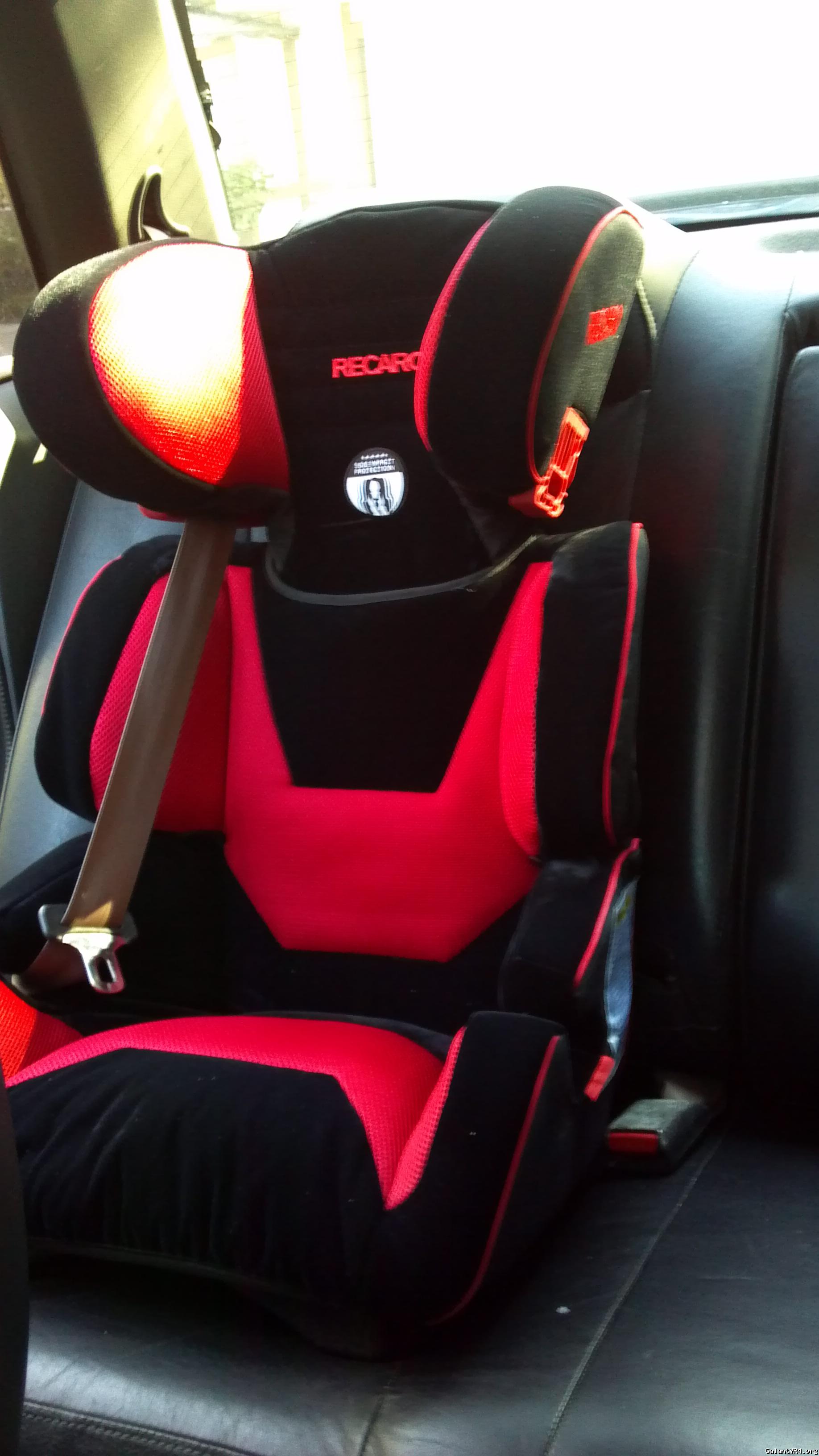

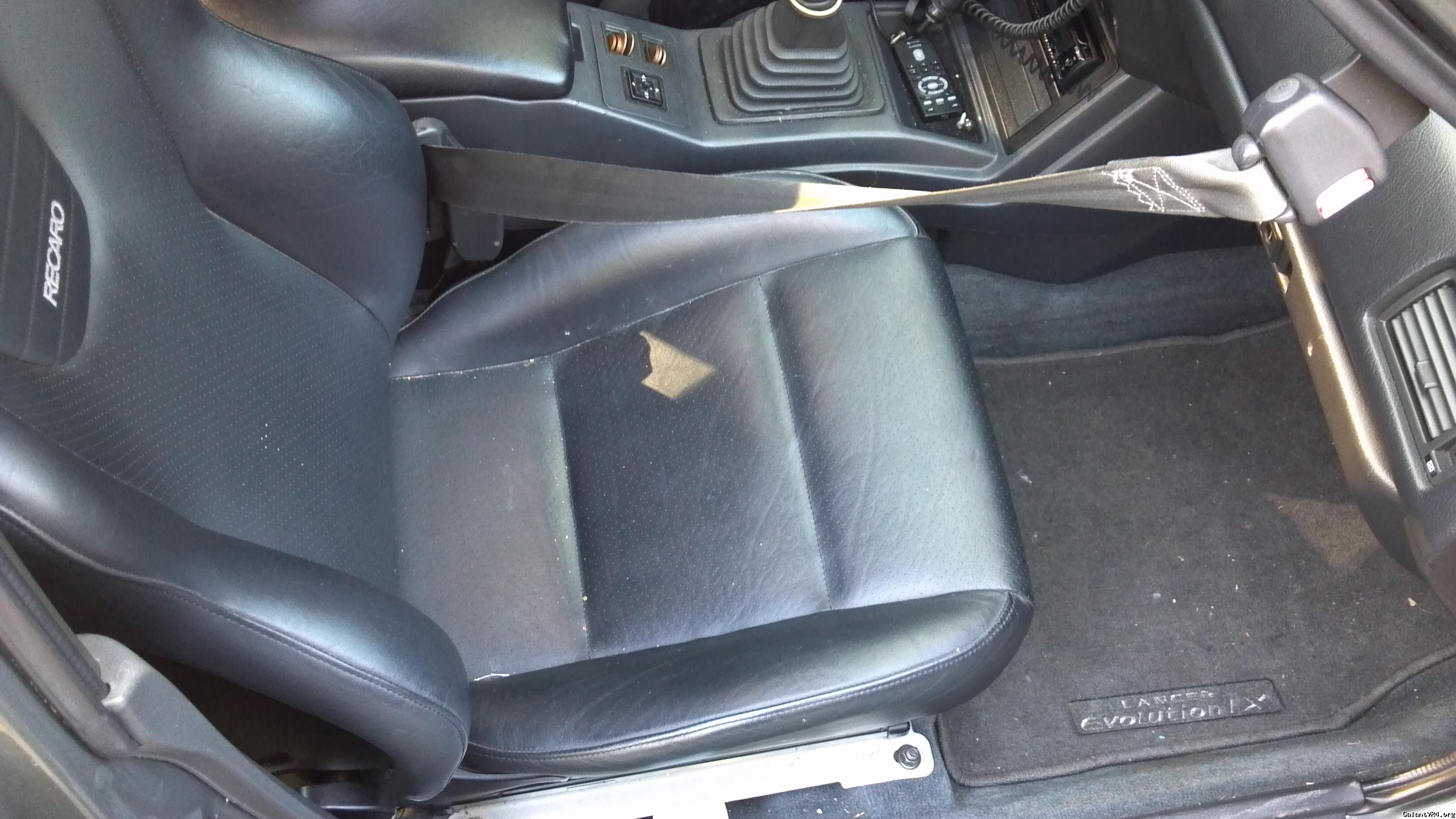

Been busy with maintenance but got a few things in to help on DD duties.

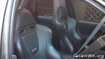

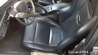

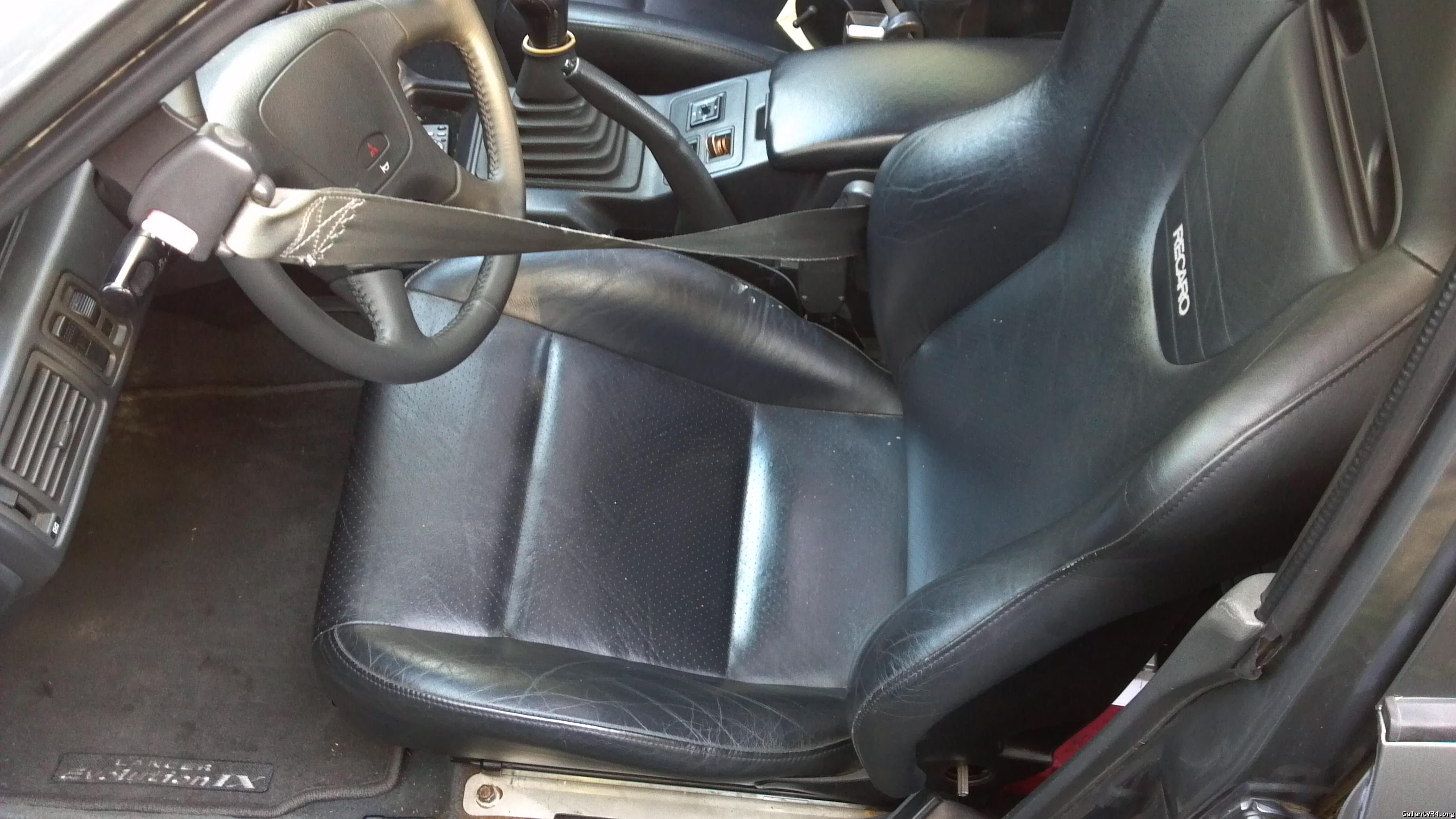

Seats installed:

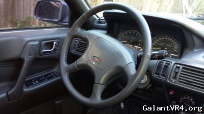

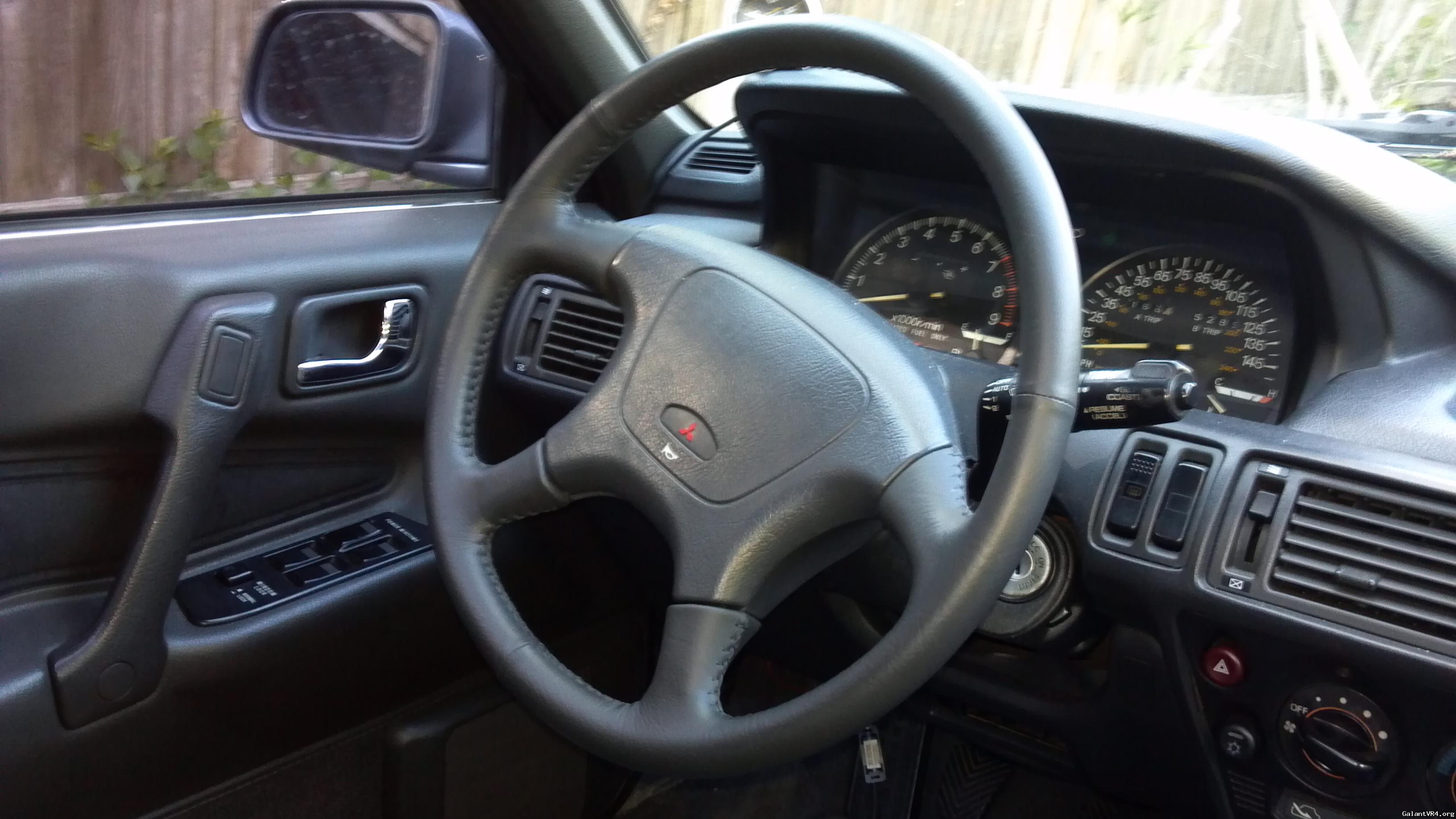

New Steering Wheel installed:

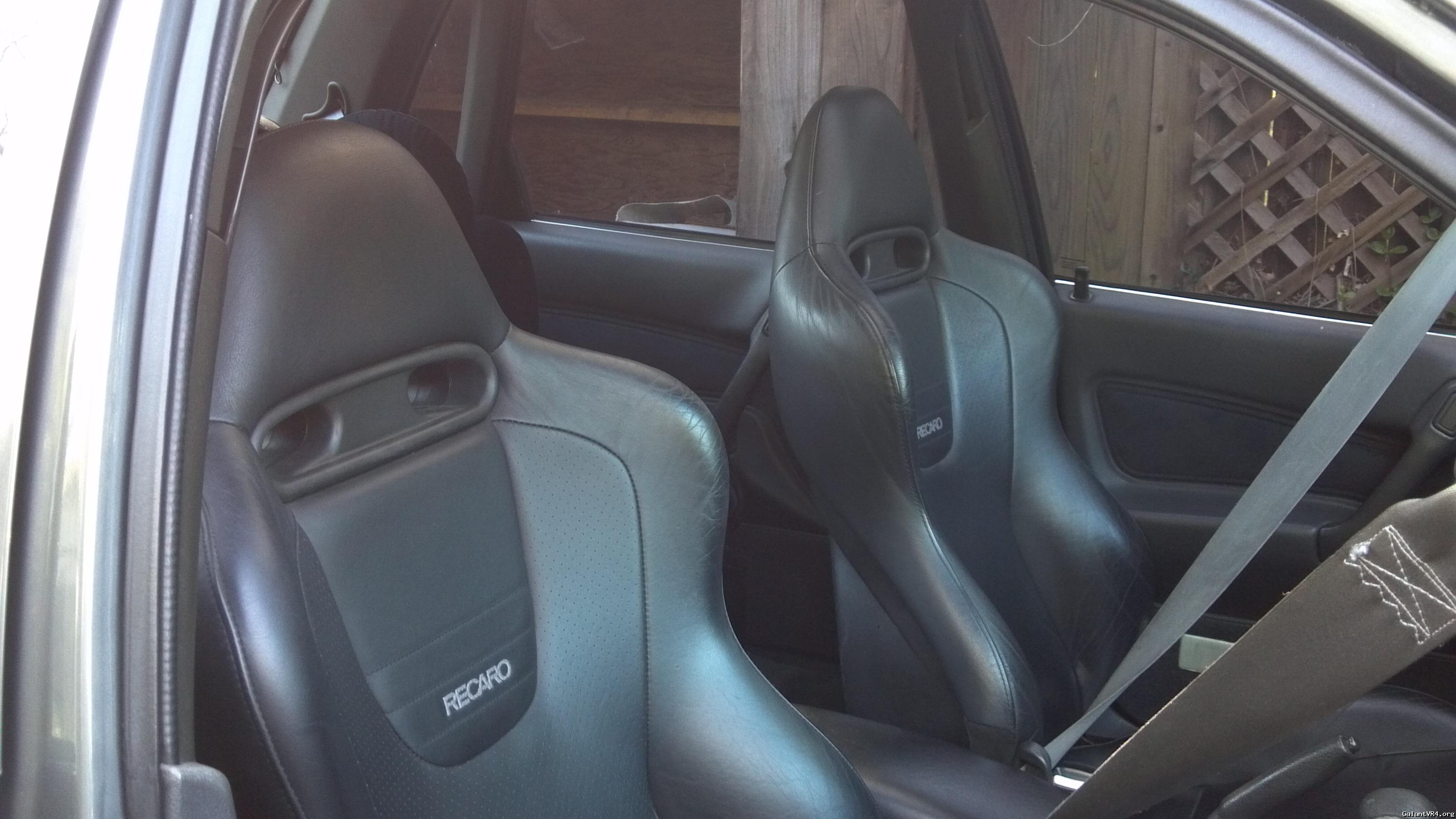

New car seat for my daughter:
My son's car seat:
Also put in a Sony deck in place of the stock CD/Tape decks.

The seat brackets are from the first group buy, I got them from a member parting out. I do like how it lowered the seating position and puts me right where I want to be.

I have the same recaro for my son. I just with i had those recaros for me. Nice!

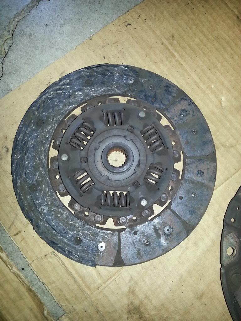

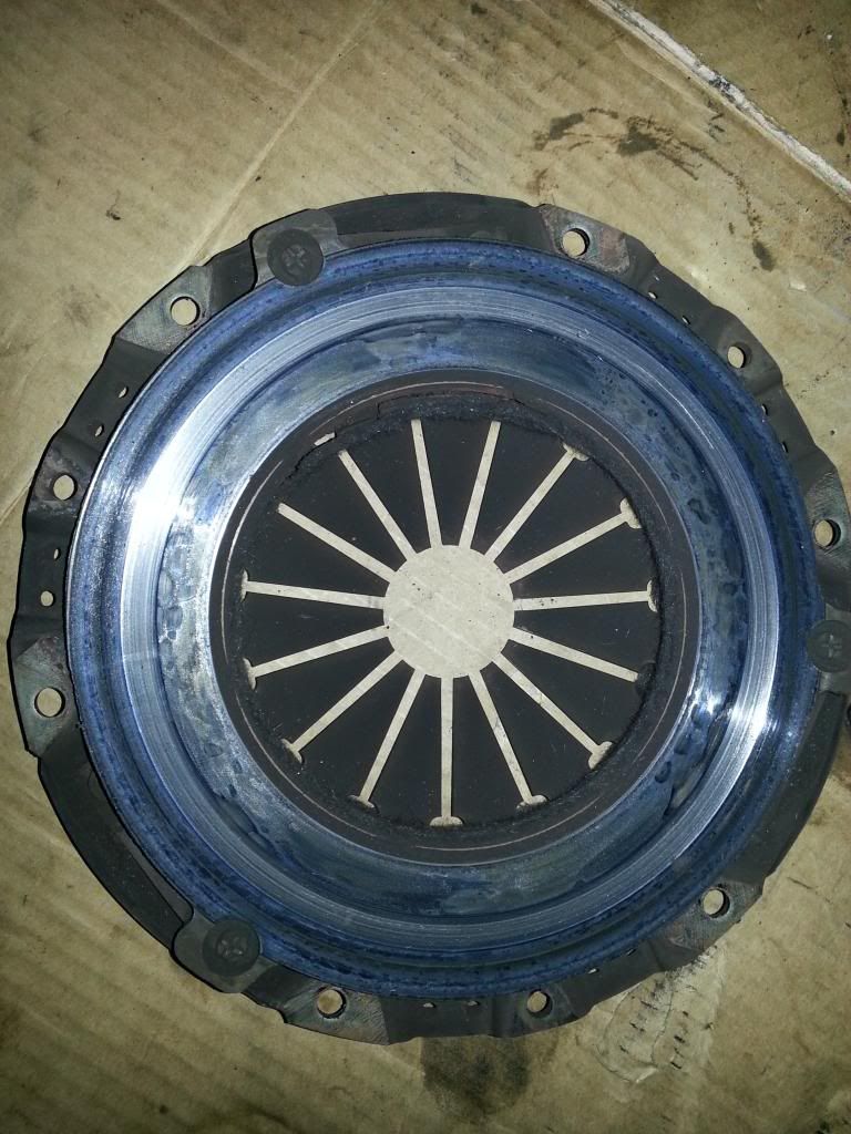

After pulling the transmission and turning my face black, I discovered this:
I think the friction surface is supposed to cover the entire thing... and the pressure plate looked pretty rough:

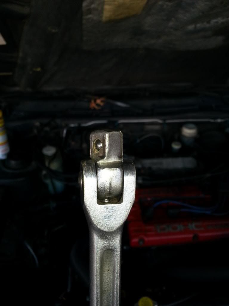

When removing the axles, I had a tool failure:
Yes, that's a 1/2 drive. /ubbthreads/images/graemlins/banghead.gif
But she'll all back together and purring again.
Next up is a timing belt job, clutch pedal assembly rebuild, TB seals, exhaust manifold studs, and finding a nice and cheap high flow CAT.
