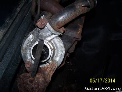

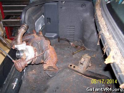

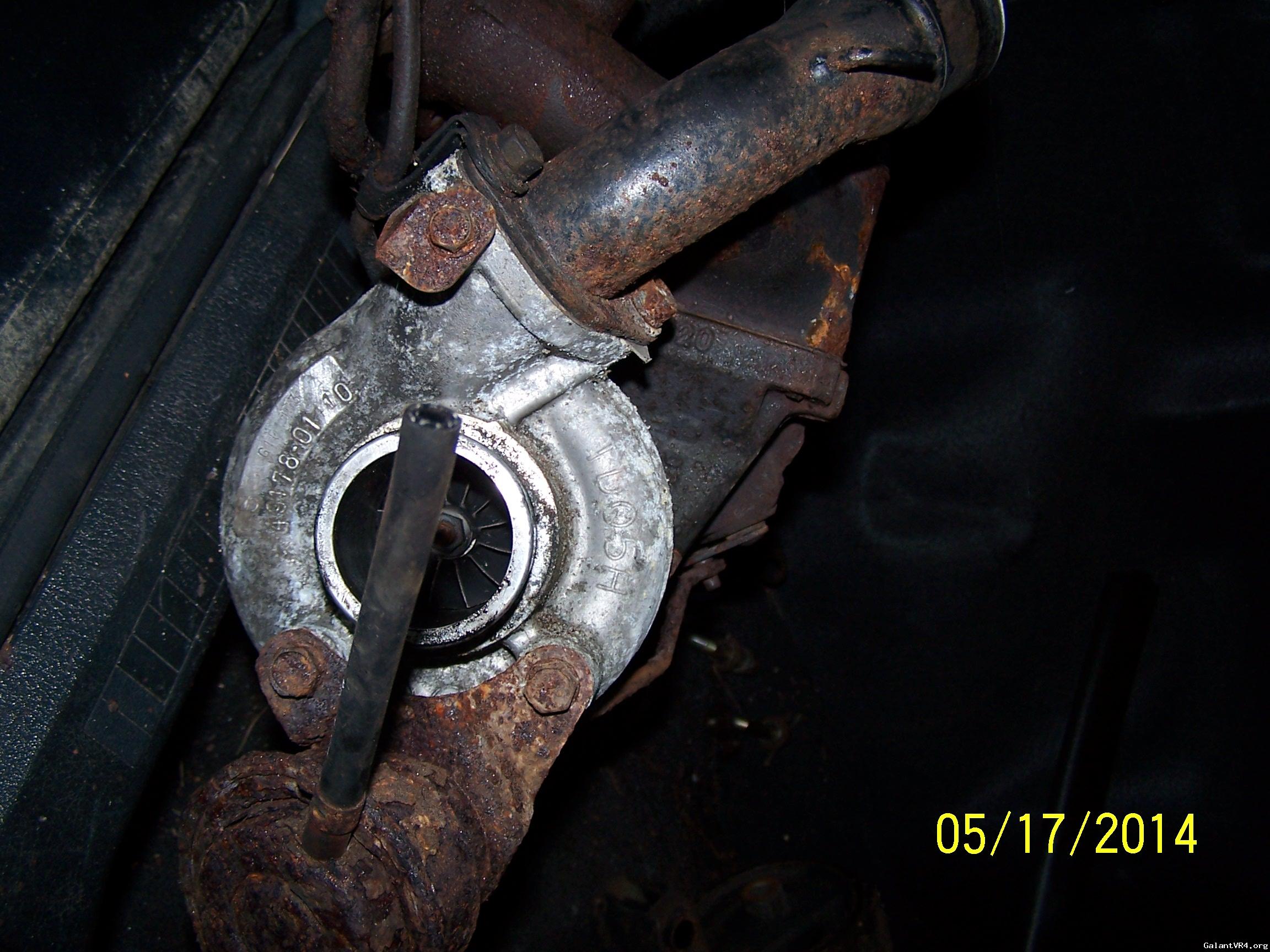

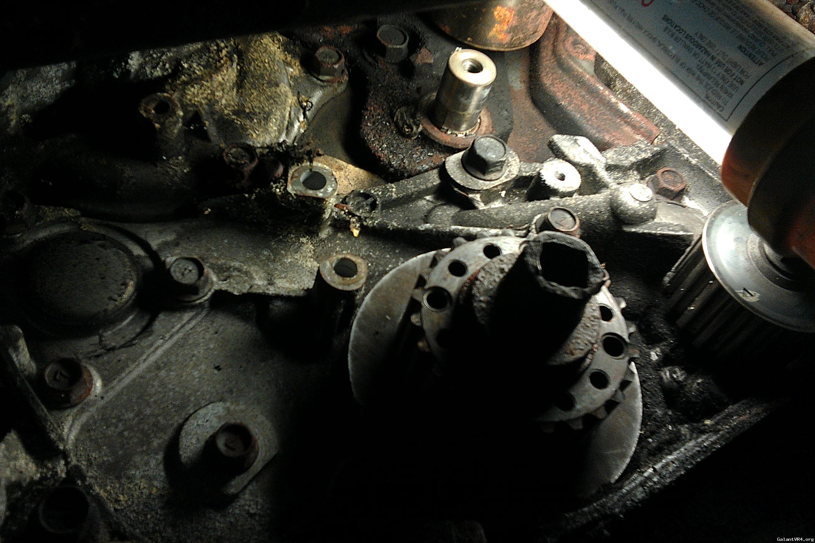

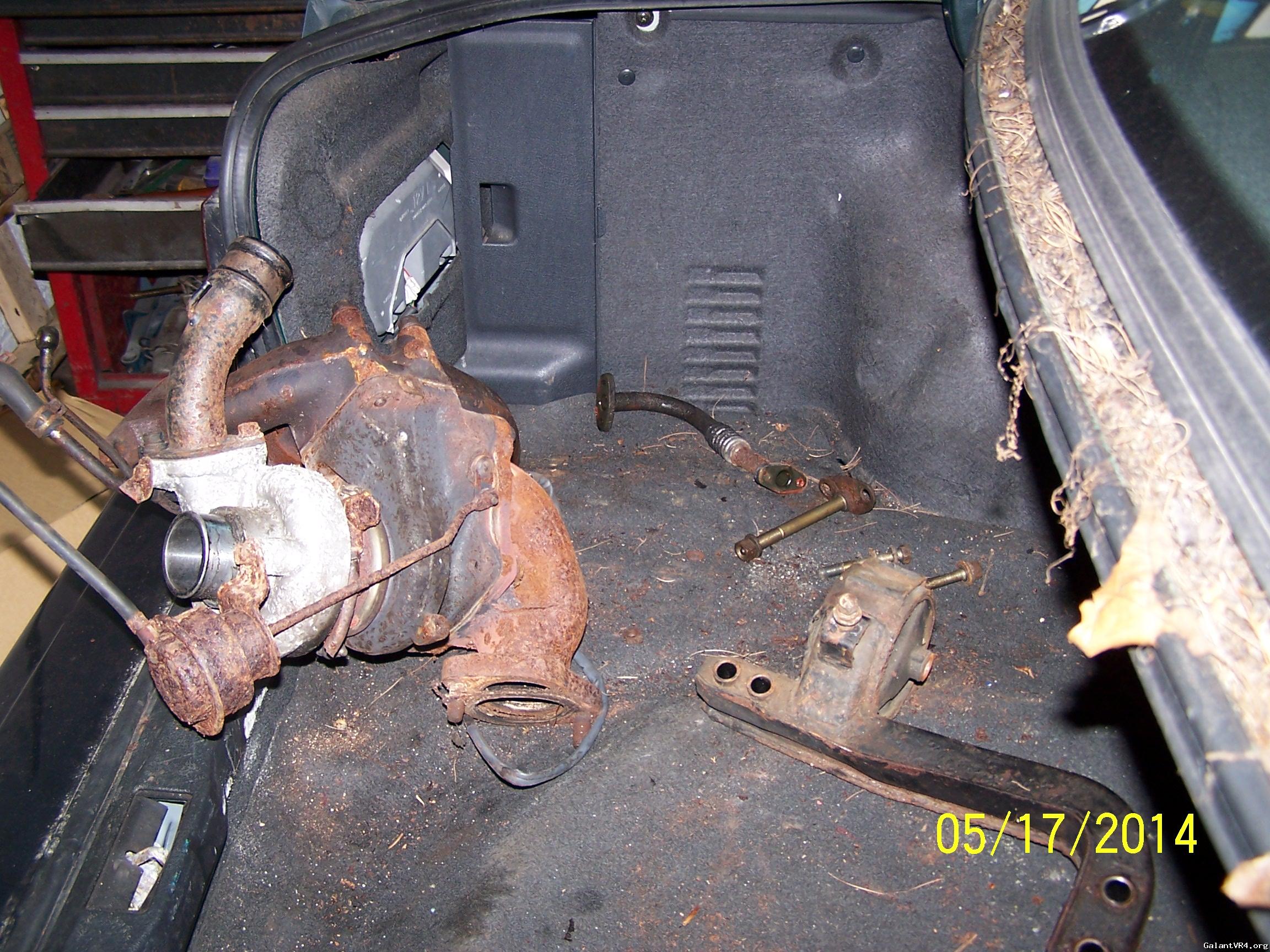

The turbo might not look like much, but when I scraped off the grit and grime, I discovered it was ever so slightly more than I expected...

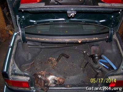

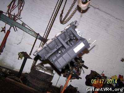

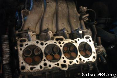

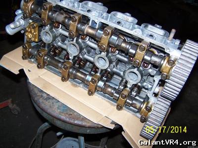

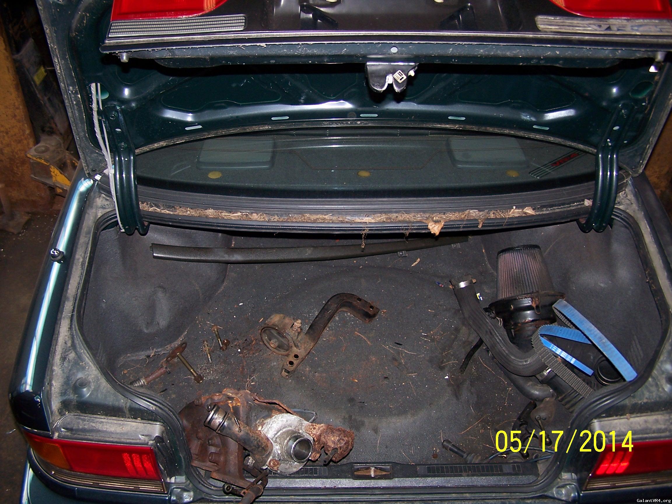

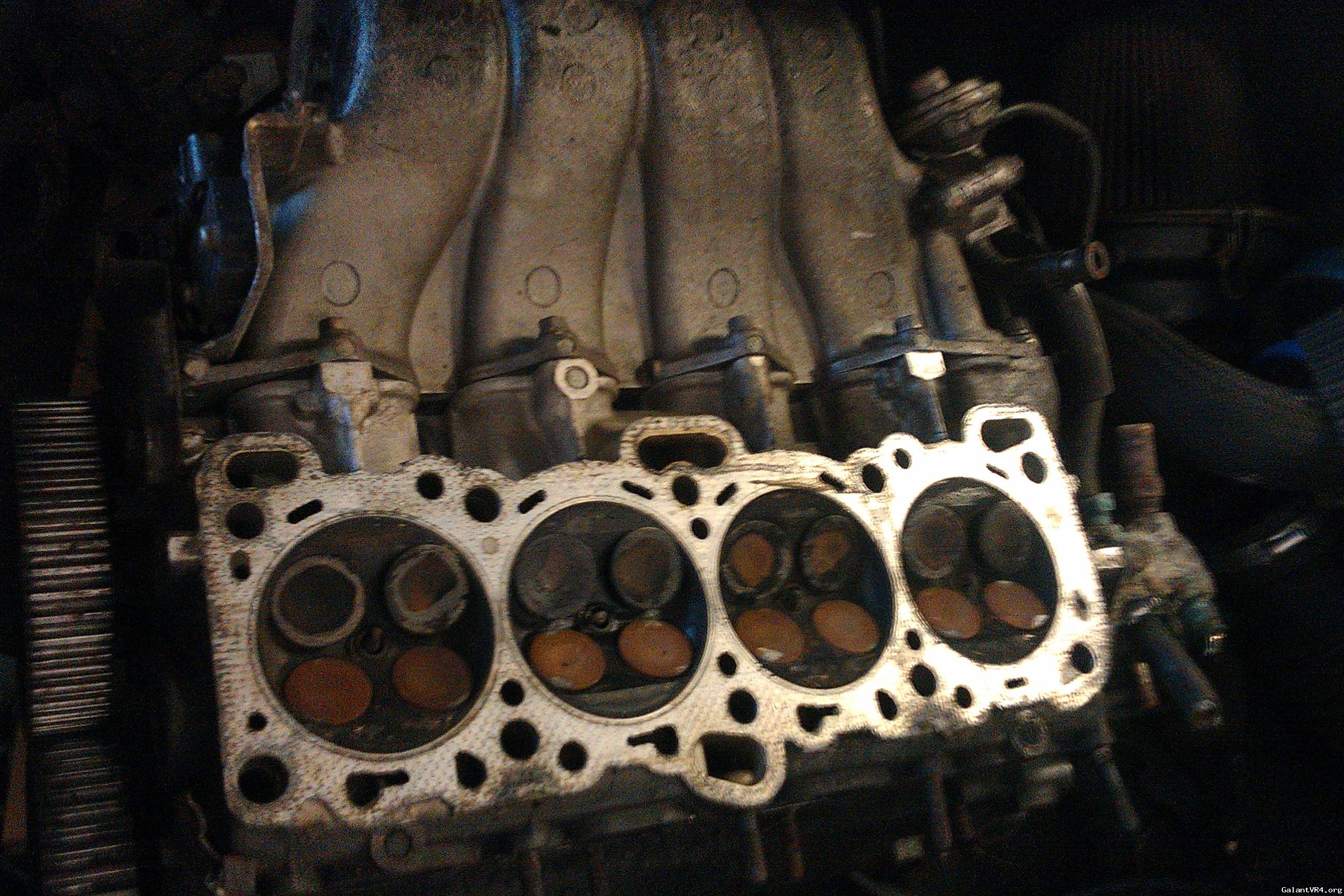

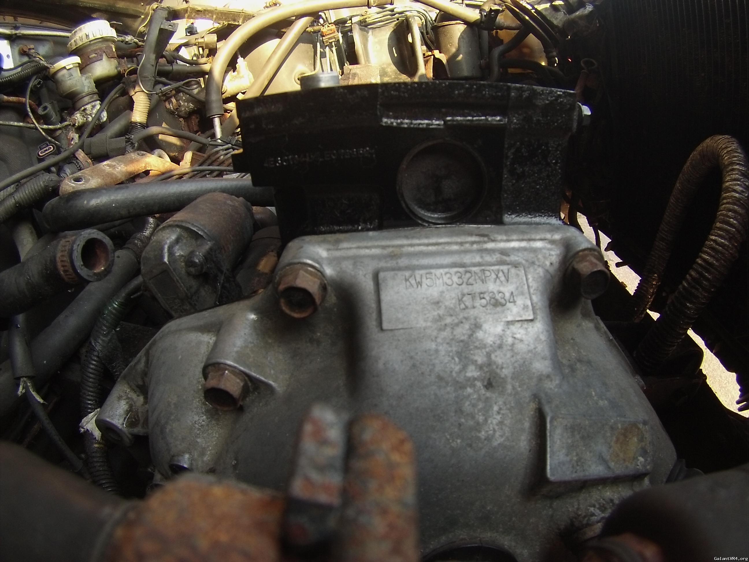

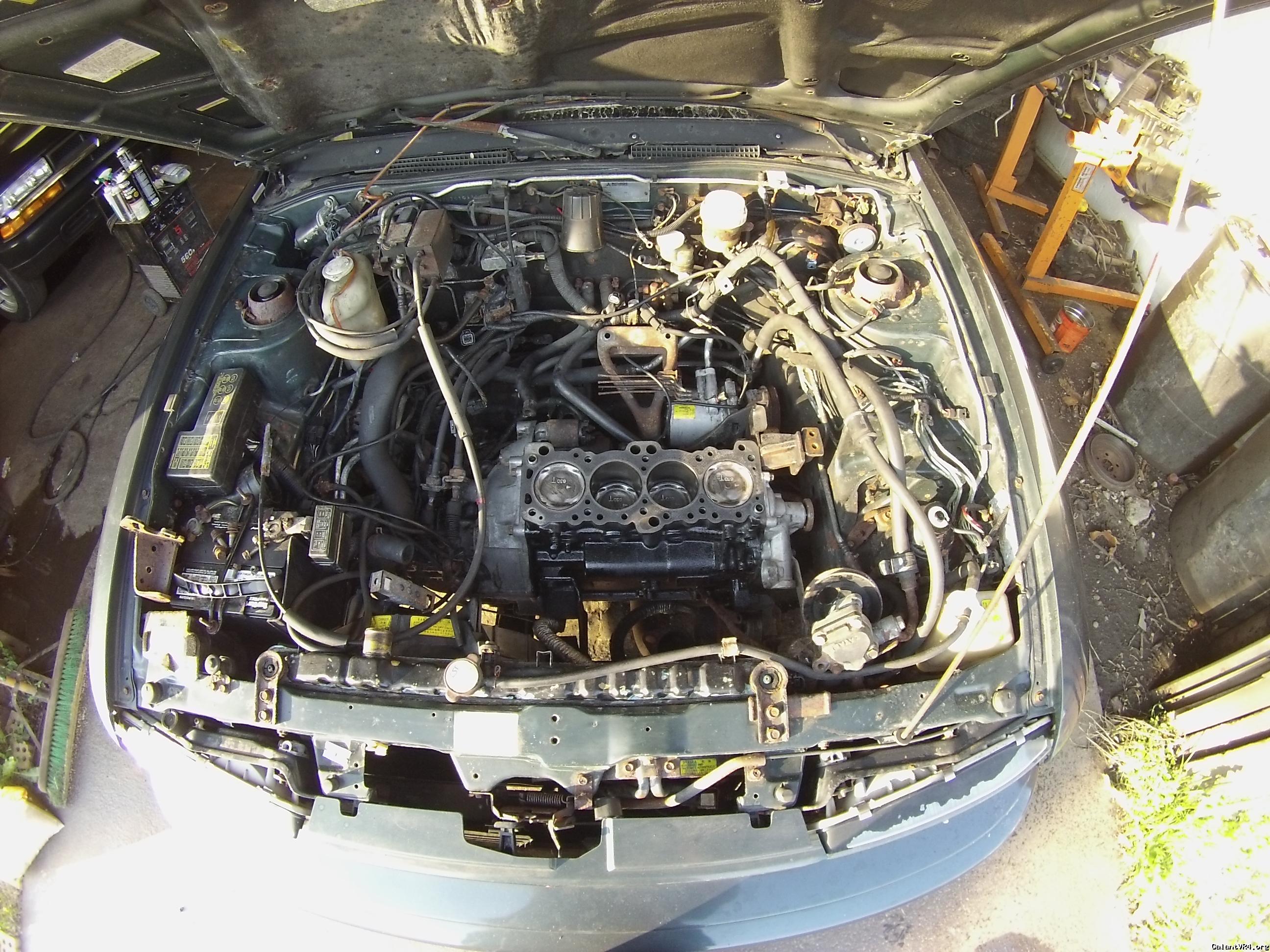

The head was in the trunk, still bolted to the intake manifold, and it seems they managed to bend all 16 valves.
All the engine parts look like they haven't been washed since the manufacturing process.
Clearly, the car has not been run in a while.

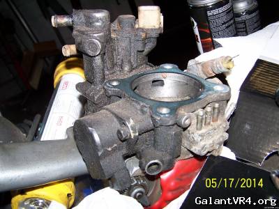

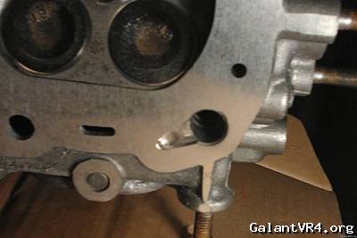

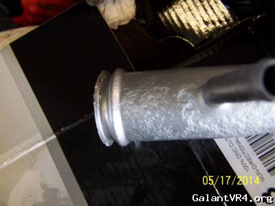

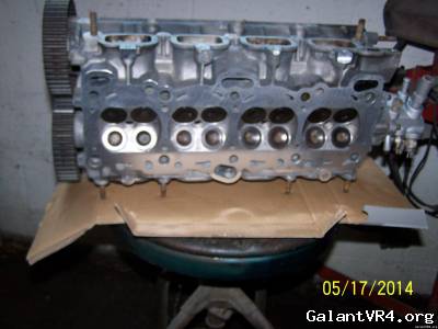

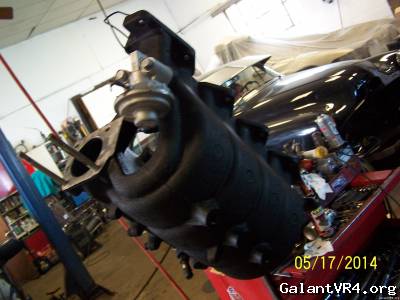

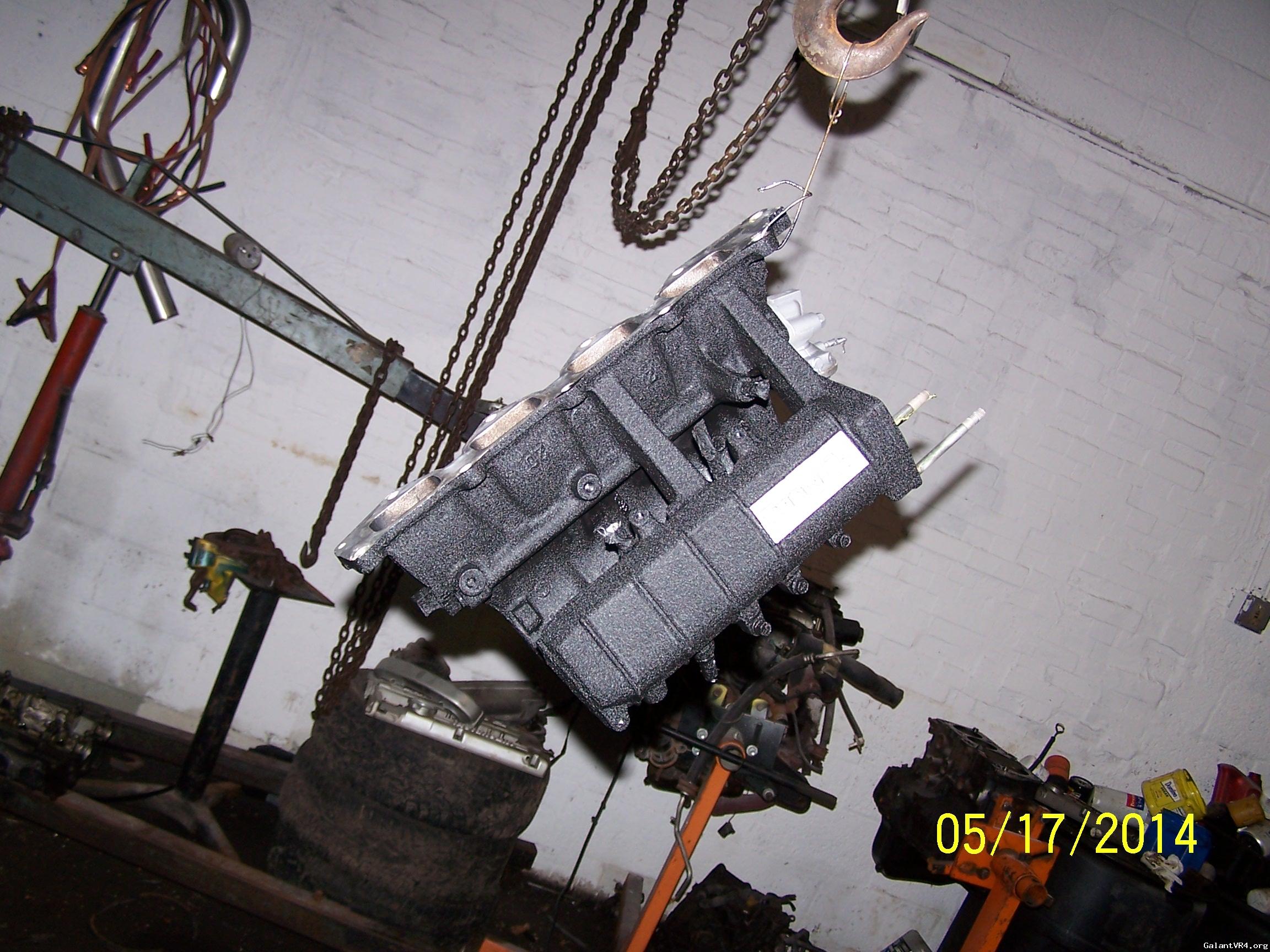

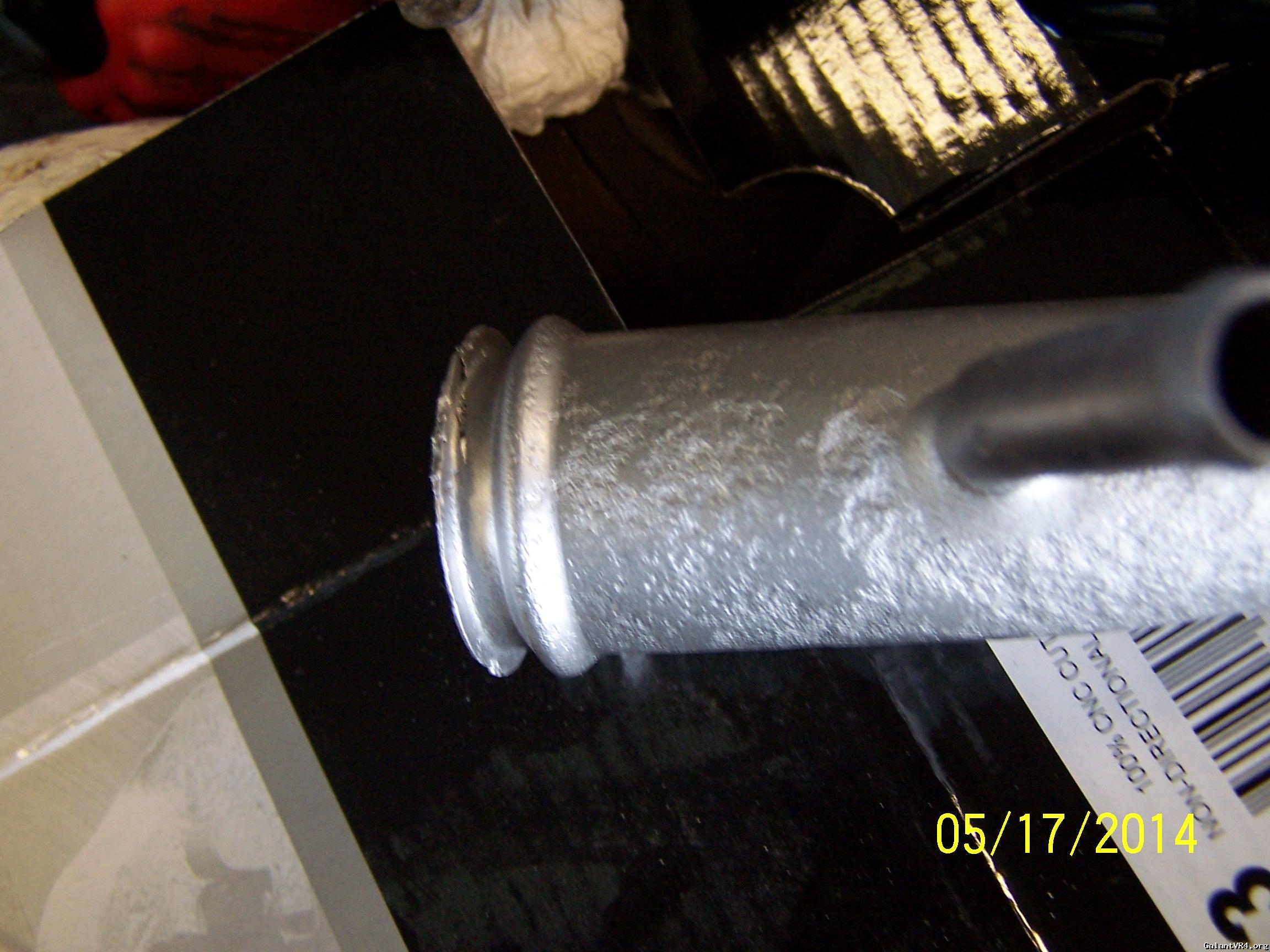

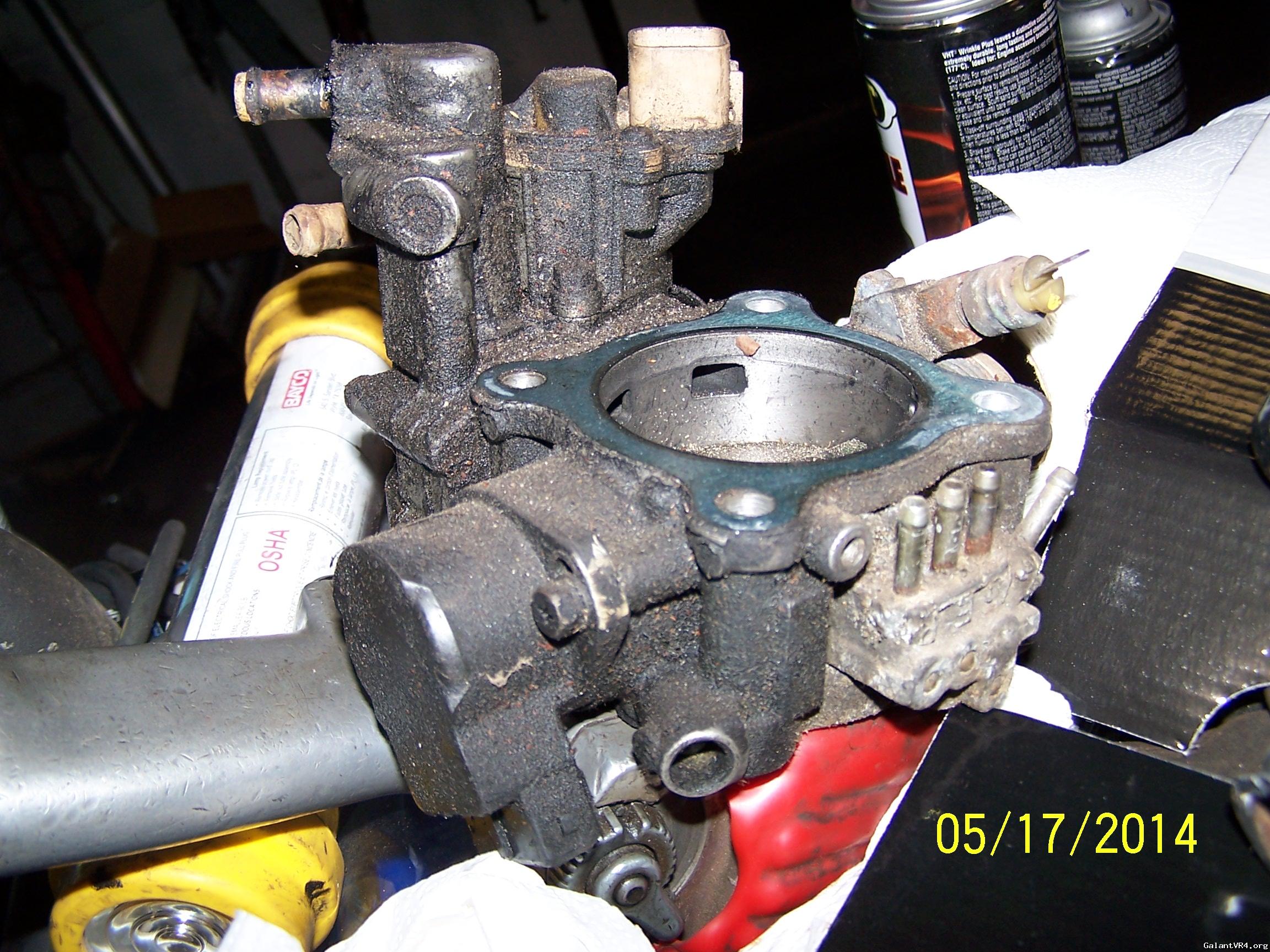

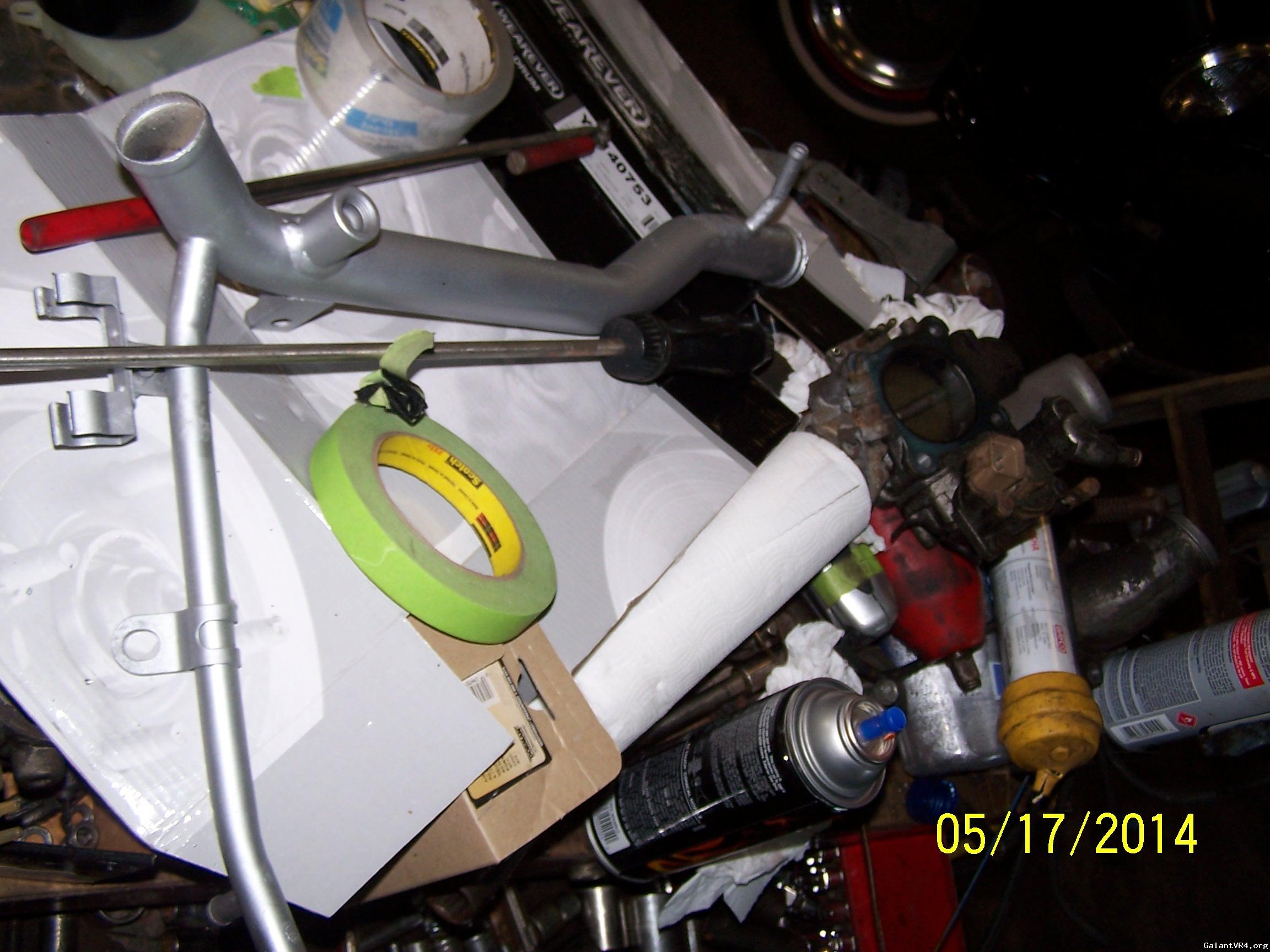

I media blasted this old water pipe, and welded in a missing chunk from the end.

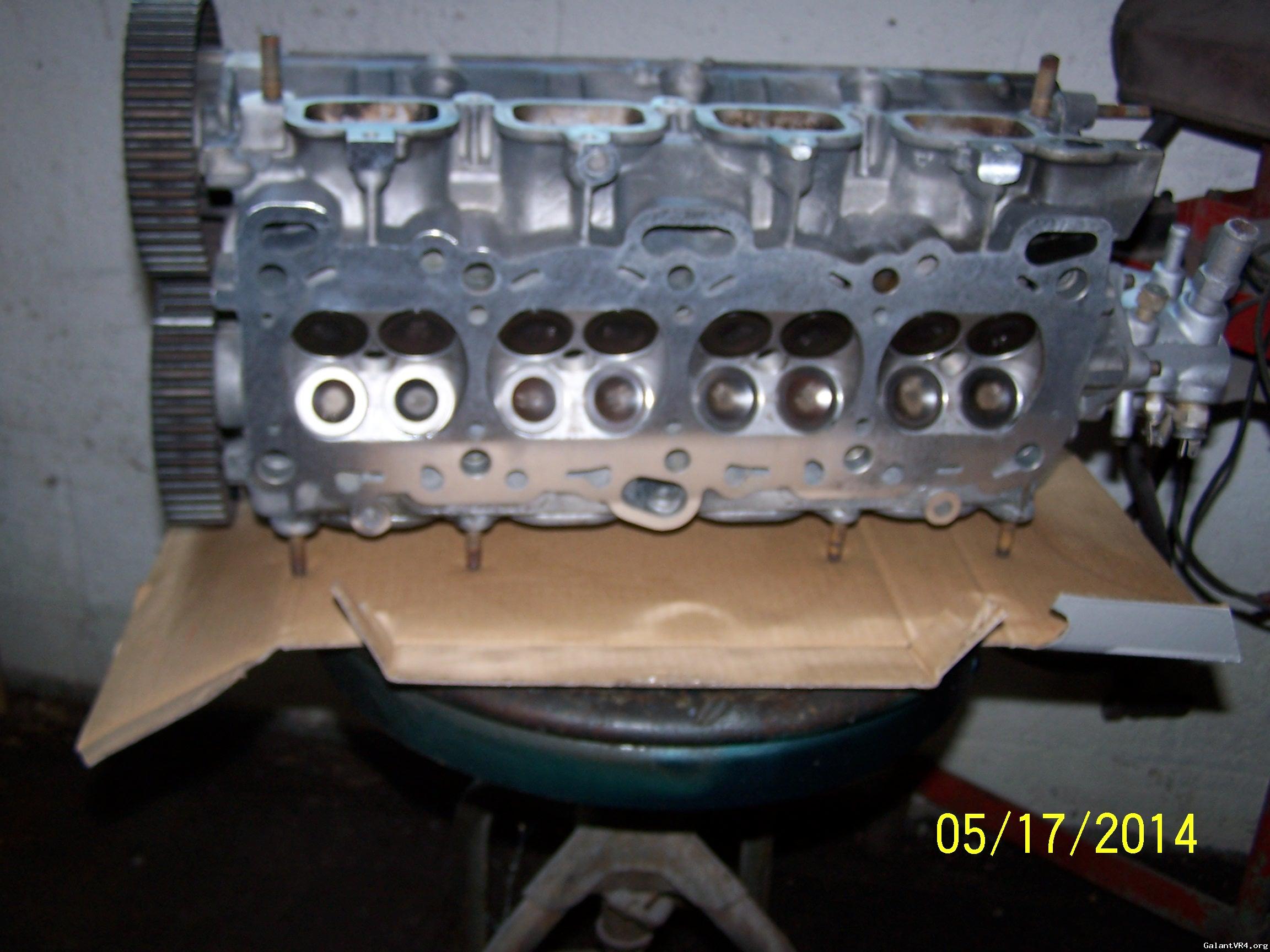

Cleaned up a replacement cylinder head.

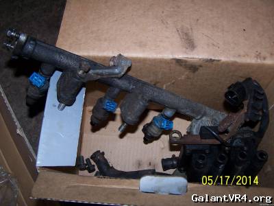

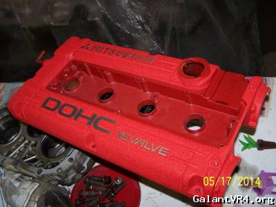

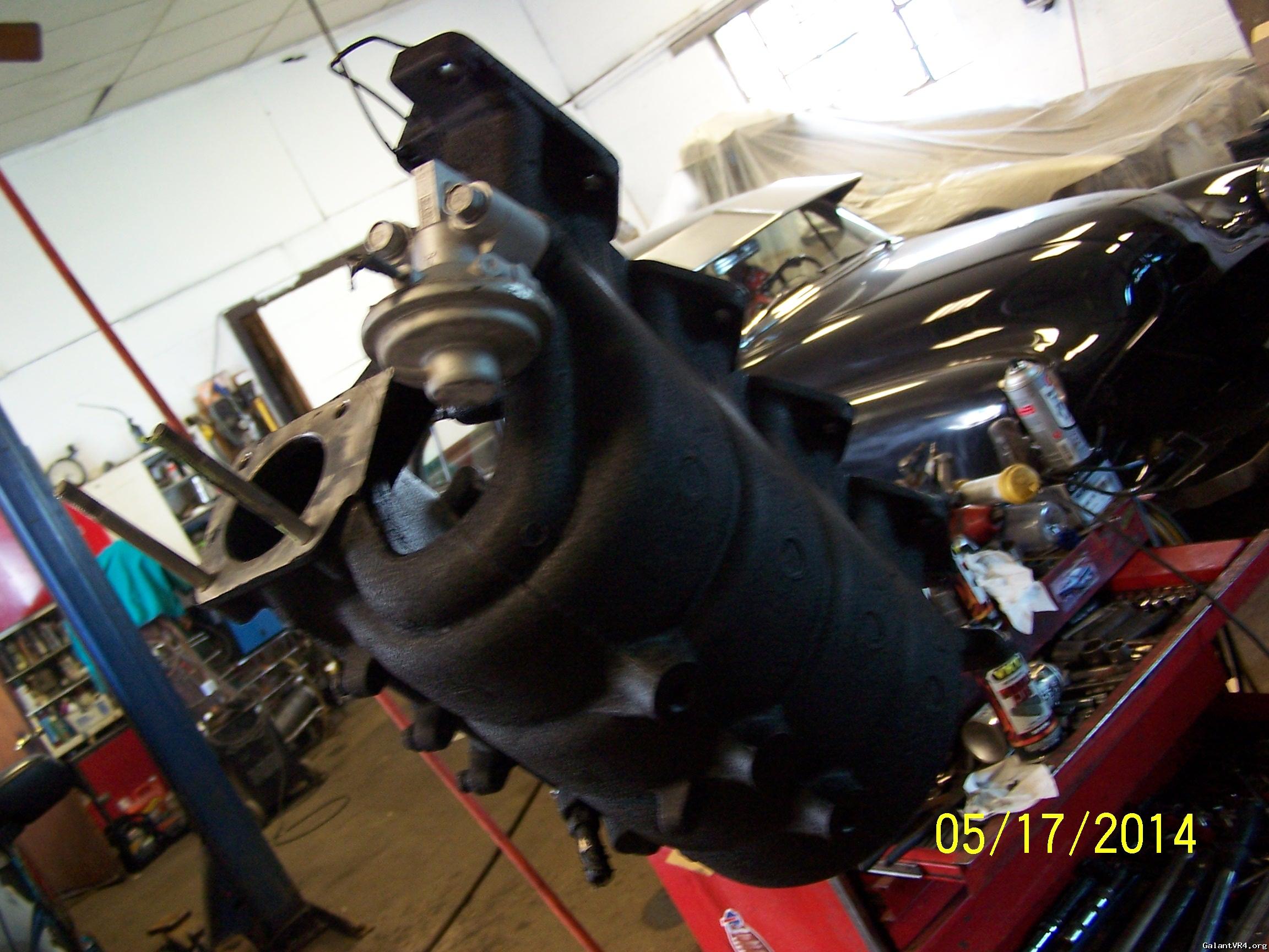

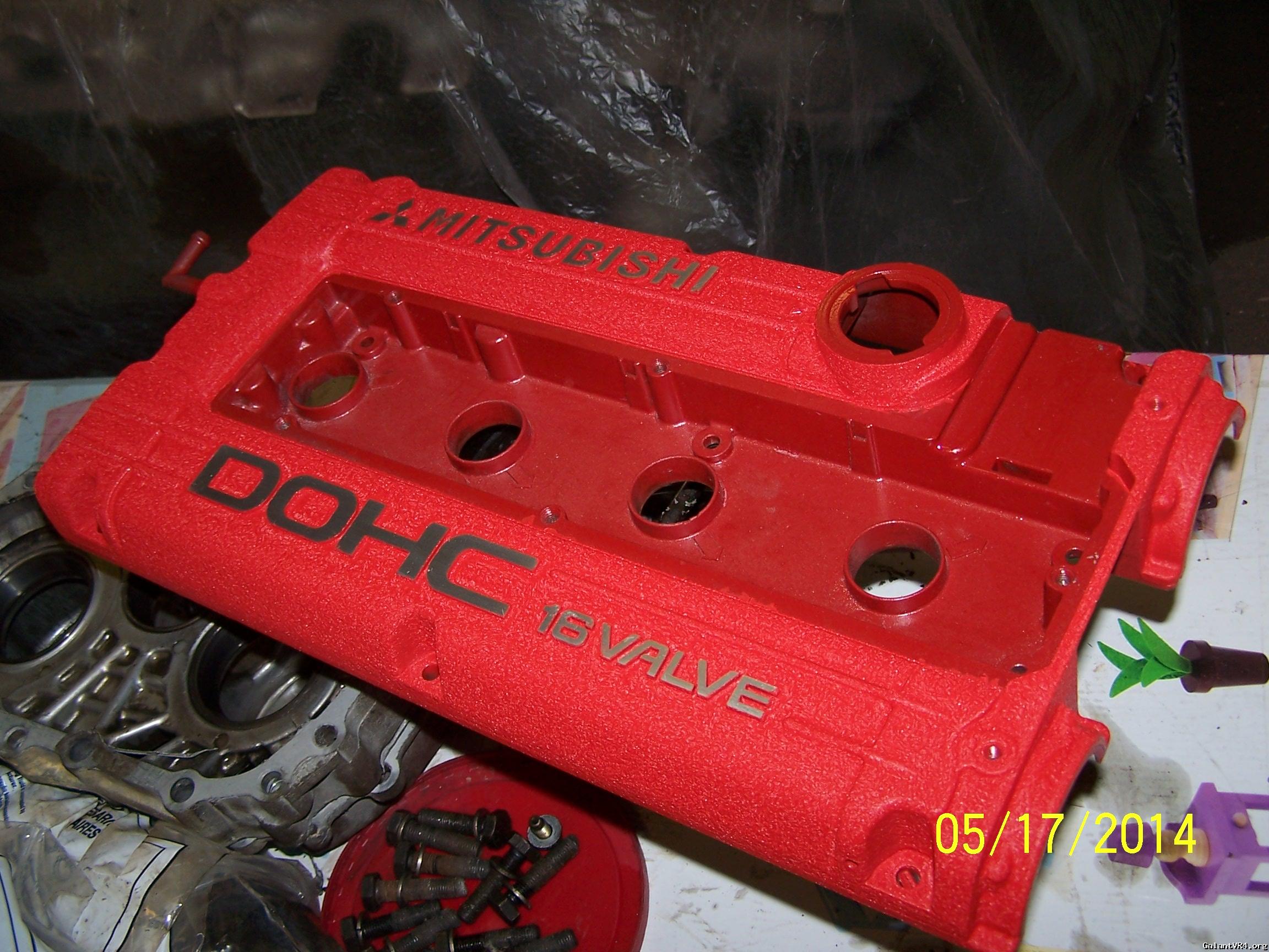

After much cleaning and refinishing, I have a presentable valve cover and intake manifold...

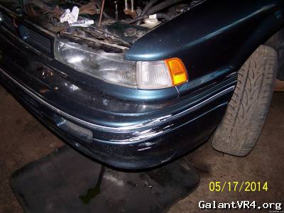

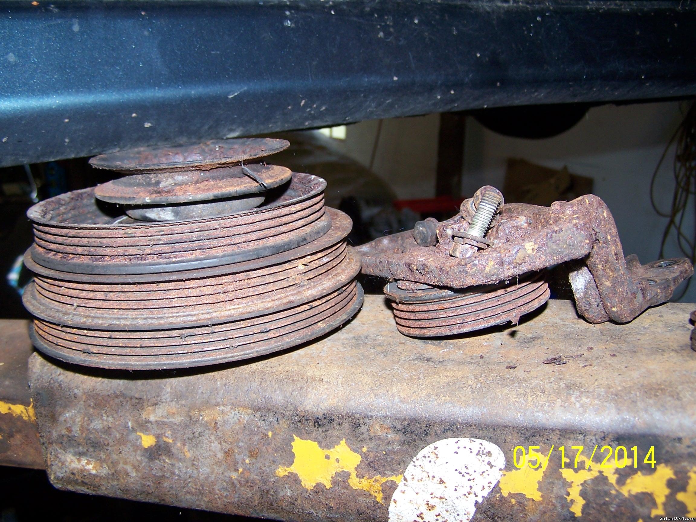

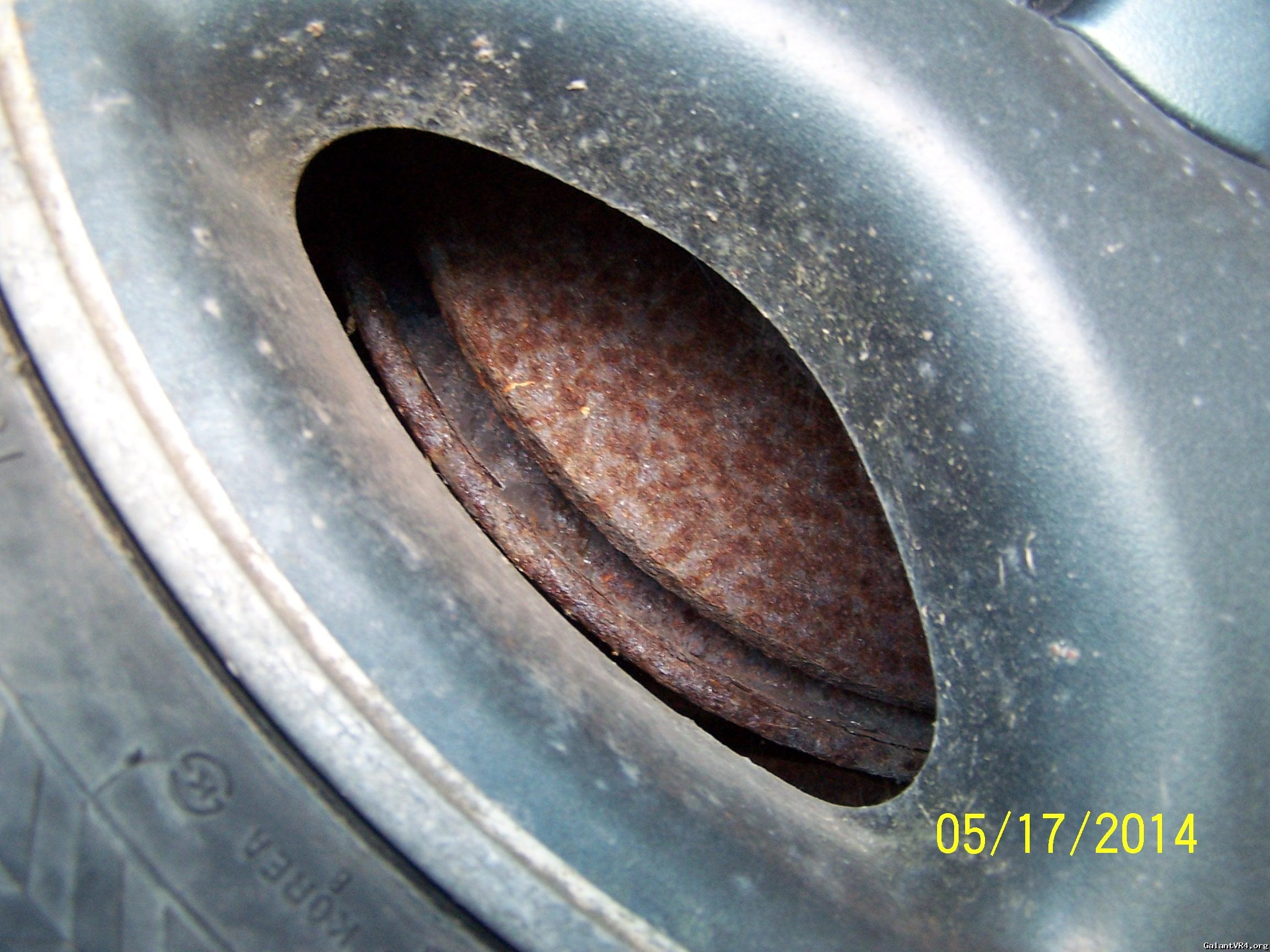

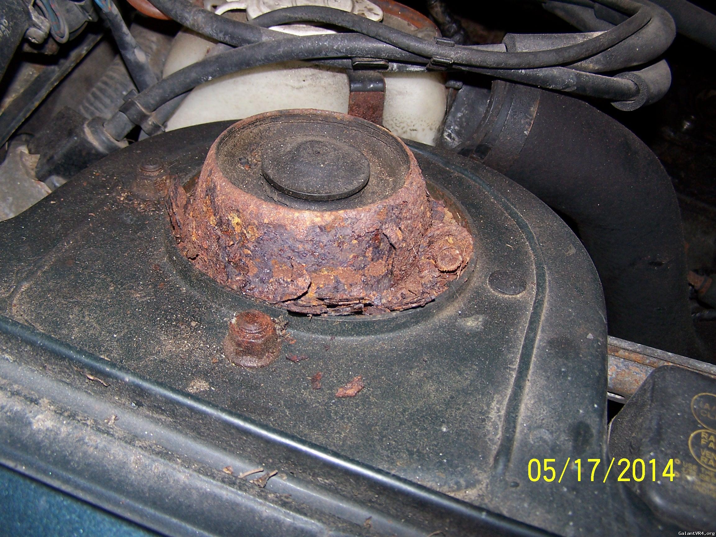

The rotors are all boat anchors.

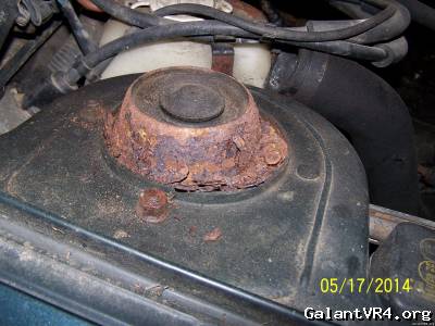

Front strut mounts are dragging down the property values in the neighborhood.
The garage was obviously too narrow..
I have front and rear compost heaps. LOL

Quoting Coltsfan:

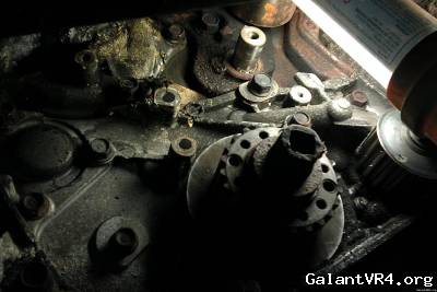

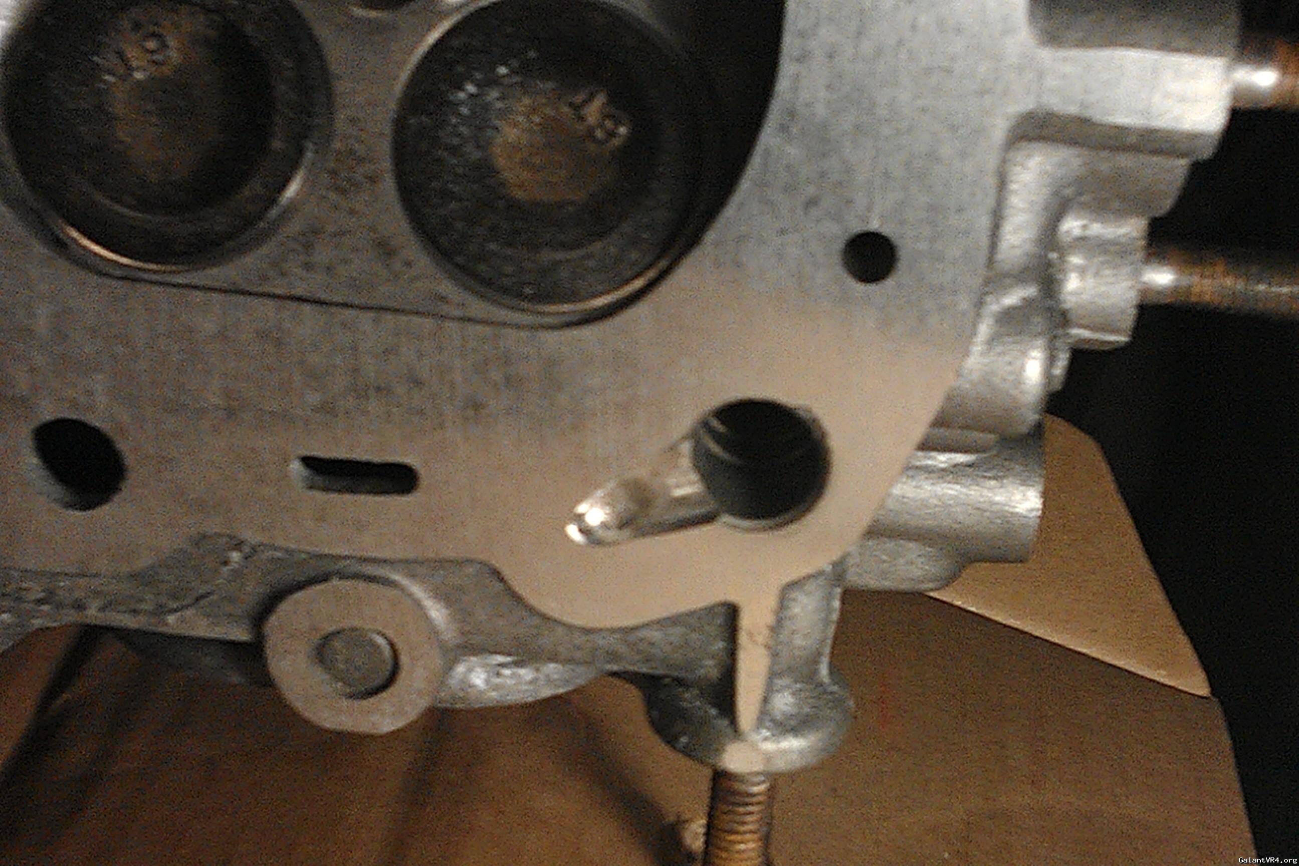

The head was pretty fresh, and they only milled .005" off of it. The oil port still looks pretty hearty, and the felpro composite gasket leaves a pretty good gap so I decided to leave it alone.
Is the big 16g stock on a 92 vr4? Anybody???
You can never grind too much out. I'd do it anyway to be safe. This thing is going to be a winter beater right? Looks like it was sitting on a pile of salt for a long time.

Yeah It does have a lot of rust, but it's next on the agenda after it's running.
I suppose I could cut a little material out of the oil groove, but I'm not sure it really needs it.

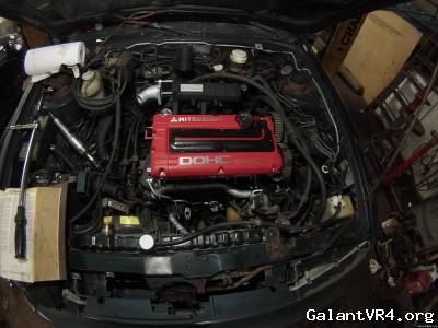

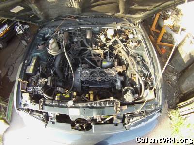

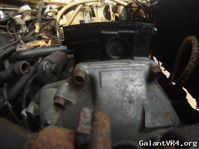

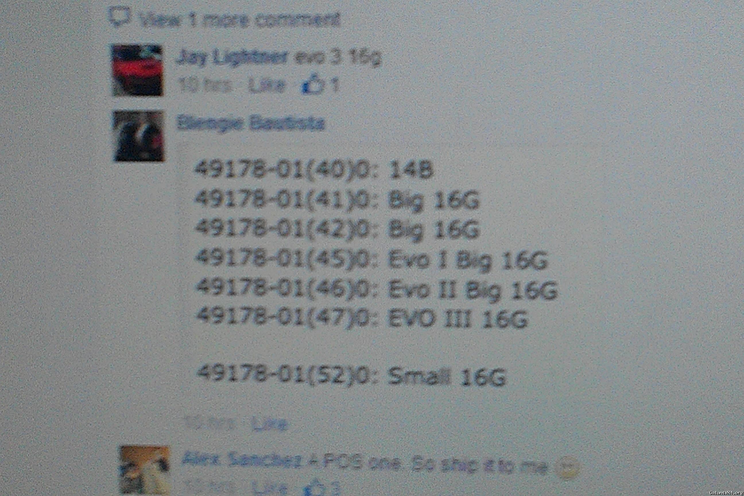

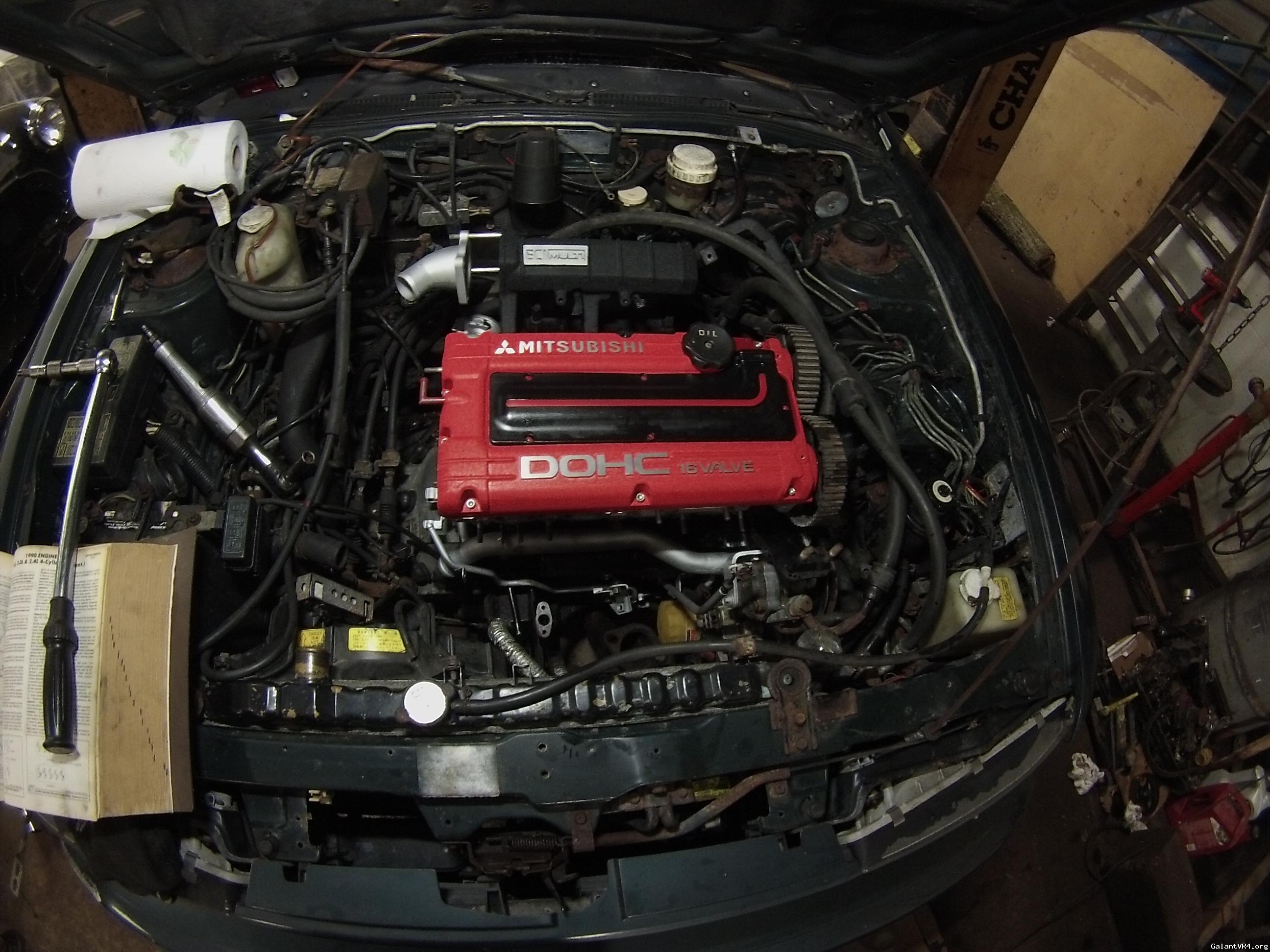

Cleaned up the engine bay a little today, and noticed that I have a 1gb DSM transmission, and a 1ga Talon AWD engine.
3,479
Quoting Coltsfan:
Not to sh*t on your parade, but that's a 14b, not a 16g. Is that the same turbo you were referring to as being a 16g after running the numbers?
Coltsfan
May 4, 2014
200
Tonawanda
Yeah, that's it. 49178-01(41)0 Bummer!
It appears I got some bad information off the internet.

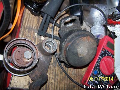

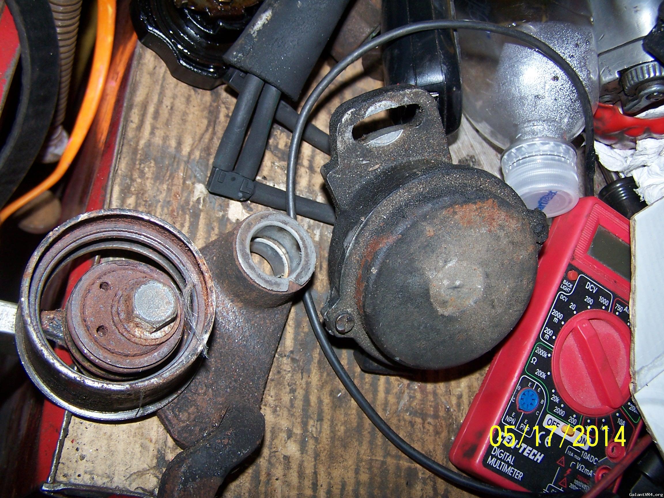

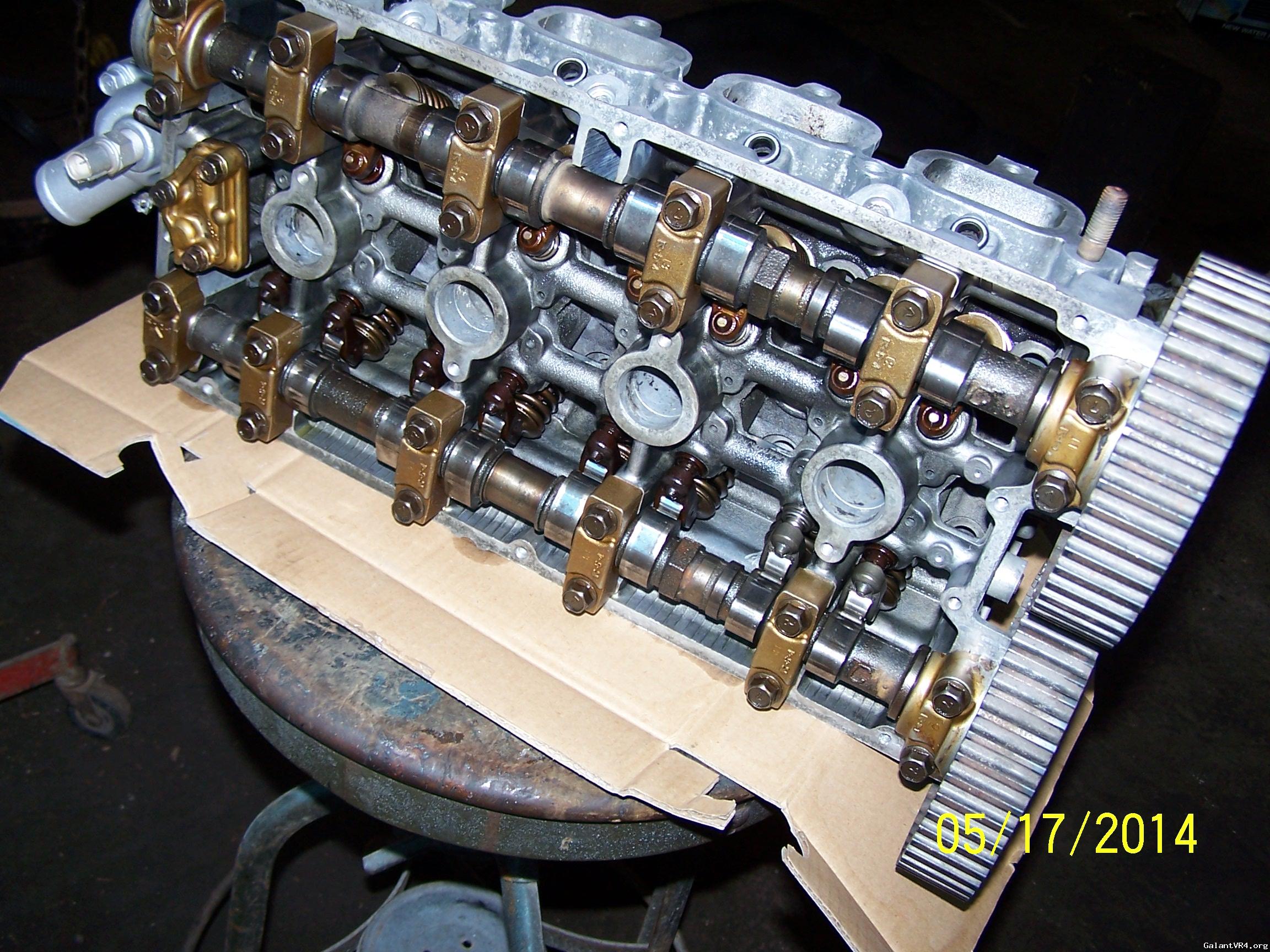

Work has been hellabusy, but I managed to put a couple more hours into the car.
I media blasted the tensioner/bracket, and the manifold bracket, primed the oil system, and put the head on.
With any luck I'll be able to hear this thing run Thursday or Friday.

I can appreciate the fact that your dumping time and effort into a car that isn't mint. I still haven't seen anything that suggests the car isn't worth salvaging. How do the areas behind the front fenders and rear wheel wells look? You'll get a lot of flack about all the rust from some people, but don't let it stop you from saving this car. Keep up the good work.

It also depends on what your plans are. If the plan is to restore it to its former glory I'd pass and look for another shell. If you're looking for a fun winter beater to do awd burnouts in the snow with then this is the car.
3,479
I'm not sure I agree. We really need to see more pictures of the structural areas that are usually plagued the worst by rust to really say if the shell is junk. And, even then, it's really up to the owner on whether or not that holds true. The amount of time, money and the capabilities the owner has really determines what is salvagable and what's not. People here are always so quick to condemn after seeing a few rust spots. What are they going to do when clean shells are a thing of the past? The supply is going to dry up, and repairing rust and such is going to become common practice on these 20+ year old cars for people buying the typical used and abused examples. The days of buying a cheap, clean shell will be a thing of the past sooner than later IMO.
